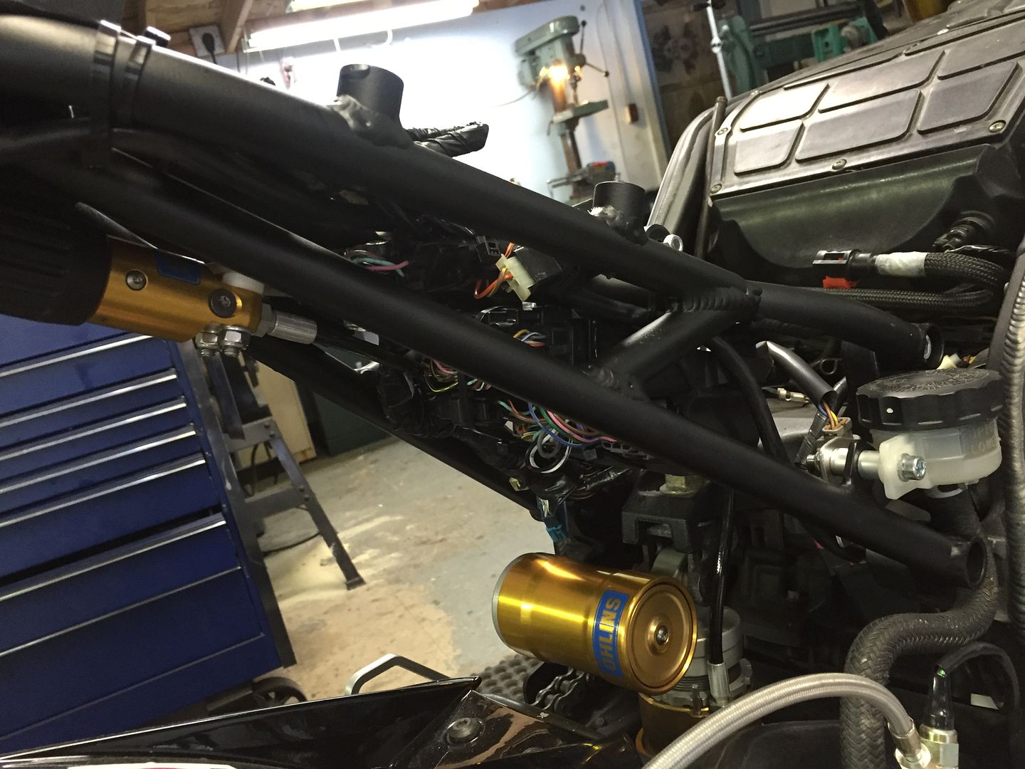

I decided that in the interest of saving space (and a little weight), we're going to use a lithium ion battery. Those things are a little pricey, but I think it's the way to go here. :) Gonna see if we can fit it under the tail. 8)
I'll hope to have a couple of pics for you in a day or 2. :D
Well, it's been more than a few days, but I finally have some progress and pics to share. :D
The sub frame and upper triple clamp have been powder coated. The plan was to come close to the frame colour and sheen, flat or egg shell black. It's a pretty close match. I'm happy. :)
You can make out the Antigravity lithium ion battery that will sit under the new tail. I'll try to get a closer pic. Also, what you can't see is the really smooth shroud that my man pounded out of aluminum that fit's between the tank and the seat. It's black to match the frame as well. It turned out great! Pics to follow. ;D
So, I'm just waiting on the 'tins' which are still at the painter's shop. We hoped they'd be done in time for the weekend, but alas, it's not to be! :P Oh well, summer isn't over yet! :) Hopefully we'll be on the road by the middle of next week. 8)

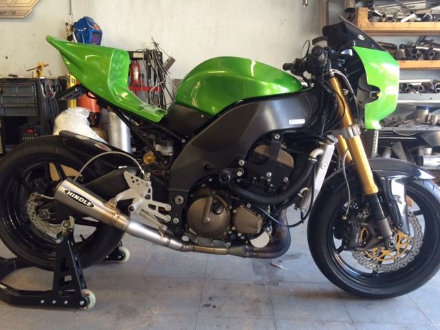

I am surprised how much I like that tail. Not my normal favorite era of styling but looks great on your bike.
Thanks! I think it's turning out pretty good. :)
I've always been a 'race bike' fan. Even though I'm a Kawi Guy, the 'OW31' TZ750 has been one of my favourites since it began crushing the competition 'right off the hop'. 8) I've never had an appropriate project to use that tail on and figured I was running out of time and project options. ::)
