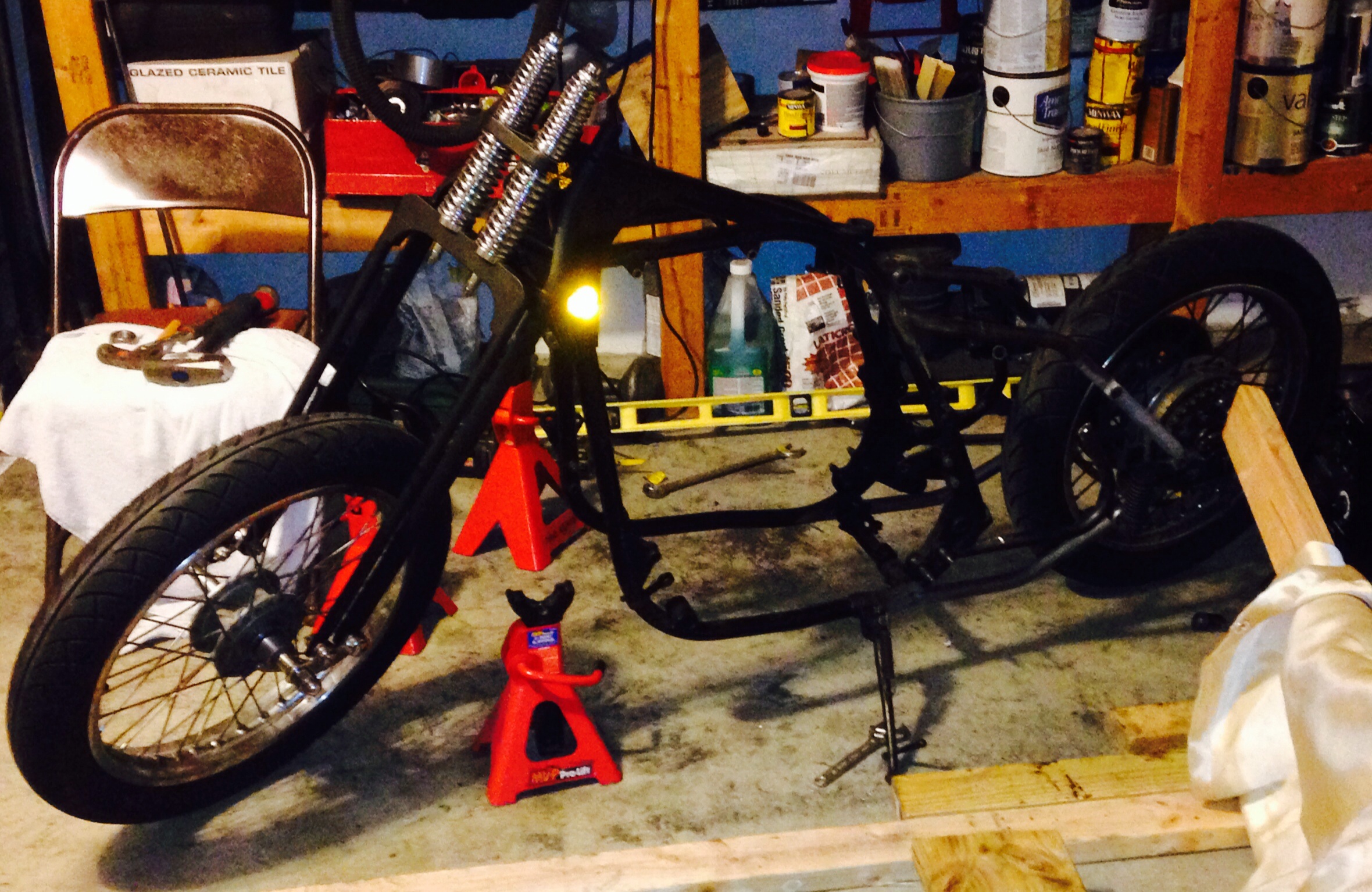

When you say another added at the bend are you talking about running a tube from the top bar to the bottom bar ?
like a truss, bridgework, whatever,i would come in at about the level of the top chain run
what you have going is too flexy the weld joints don't like that
I'm thinking about taking the top bars back off when I get the bottoms welded on . I don't really like how angled they are. They are only partially welded so it wouldn't be hard to remove and reposition . I just need to put the springer and wheels on so I know what angles I'm dealing with now.
Okay I get what your saying . I'll be sure to put some supports in so the bars don't flex as bad or at all. Thanks for the heads up
With bottoms on . Top is going to come down more cuz it's too high for my particular riding style.

Actually doesn't look bad at that height now . What y'all think ? Hardtail still too high?

So I was really thinking about this hardtail and it's going to the shop tomorrow . Like I read in other posts I really don't want to be doing 70mph thinking about my welds and how it wasn't done professionally. Gonna cut the side tubes off and have the guy run the center tube down . Kind of like the voodoo hard tails only the seat height would be lower. Anyone who wants to see the finished frame I will post pictures when it's done

Will post pictures as soon as I can . We ran the numbers today on what needed to be done. Will most likely buy a hardtail and tweak it to what I want only because making a hardtail from scratch would rack up labor hours and cost more in the end . Will keep updated. Thanks for reading
Ordered an mk28 hardtail from voodoo vintage. Stoked. I really like there work and hope voodoo keeps producing for the kz750 twin as well as other bikes! 8)
Nice, I've been eyeballing Voodoo's stuff for awhile. I would love their hardtail kit for mine one day. Looks like you lose the top engine/frame mount and it's only lower rail mounted after.
Yeah I was looking at that top mount thinking the same thing . If the top mount is needed I am sure one can be welded in for support. What is really going to be nice is no more two bars! One single tube down the middle . Simple and clean.
