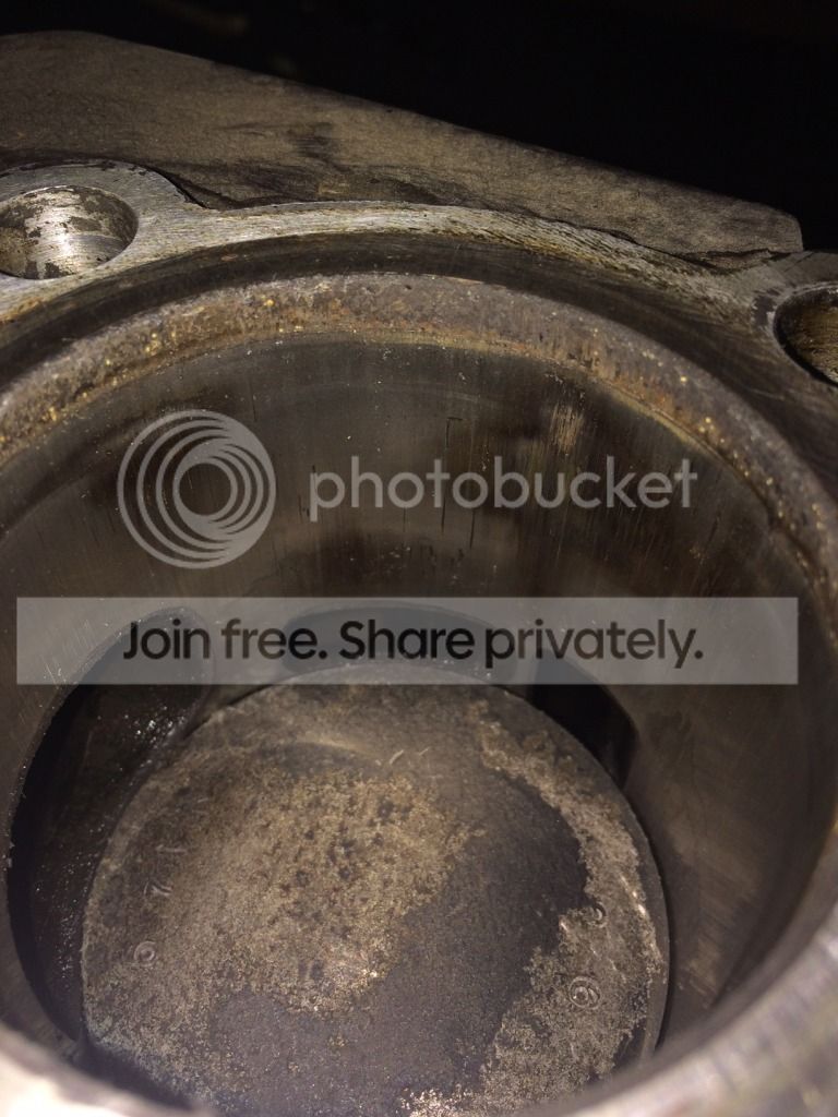

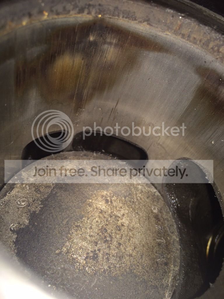

Pulled the head to check the top end and it doesn't look good. So I am using a spare top end that I have for the weekend. I already honed the cylinder and it should be going on the bike tonight. I'll have the original top end rebuilt in the next couple weeks.
Here are some photos of the old top end. Looks like it might have soft seized once or twice ;D

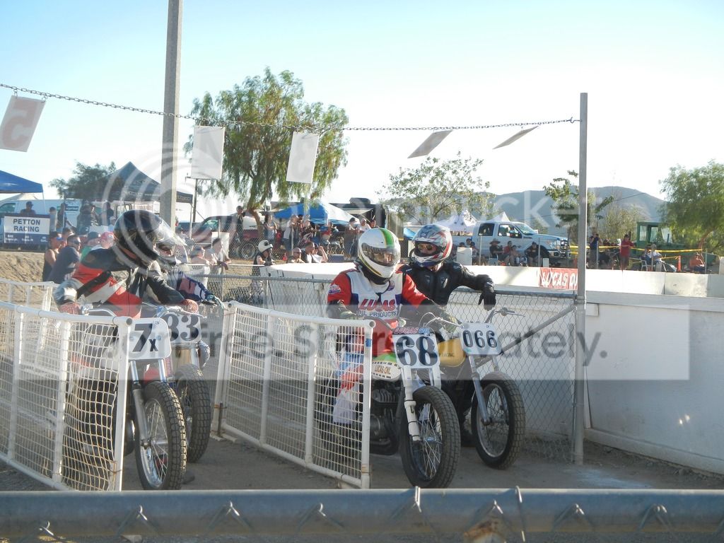

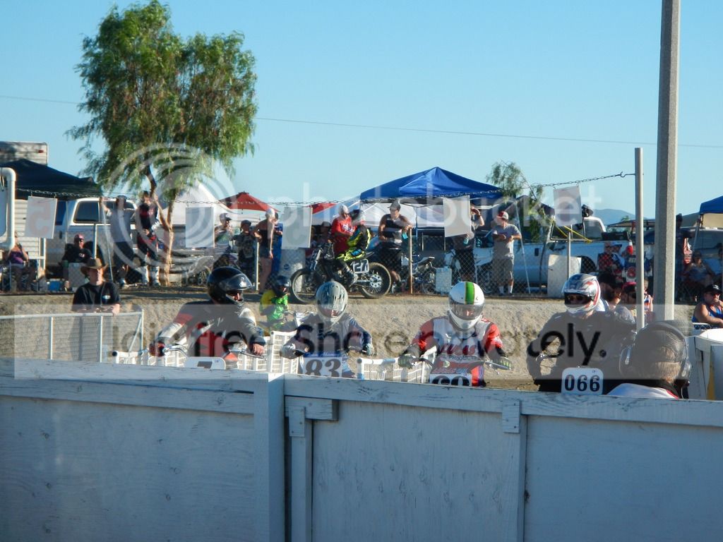

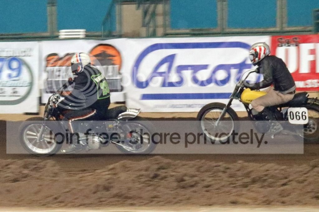

Vintage 250 class
Had a blast racing and I can't wait to get out there again. I low-sided twice, so I'm still learning. I am currently running a K70 on the rear, and I plan on putting a MAXXIS DTR-1 on once I get my 19" quick change rear wheel sorted out.

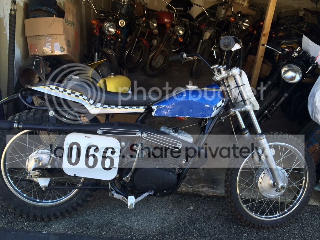

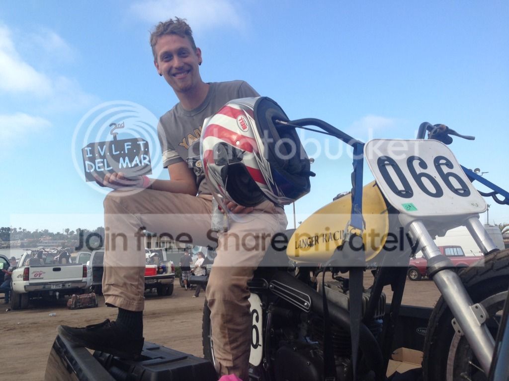

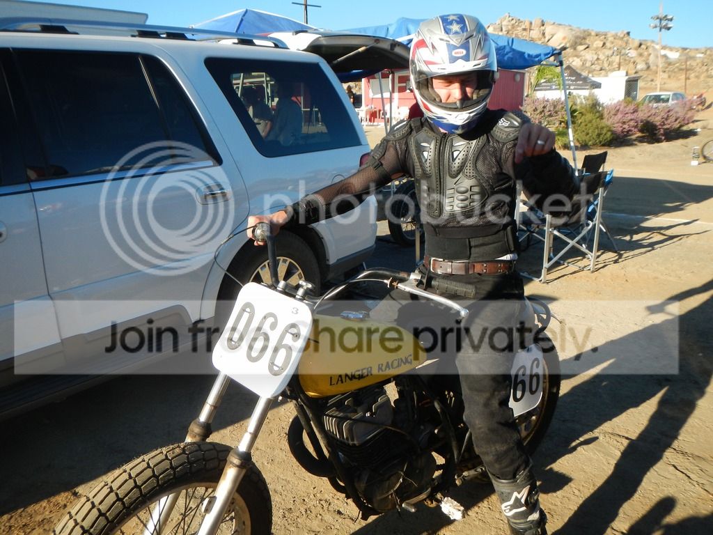

Actually I forgot, a photographer Judd Neves sent me some photos from the last race.
Also a Video of the last race.
You can see my bike at
0:21
0:29
0:51
https://www.youtube.com/watch?v=FQo6s4Isrbo

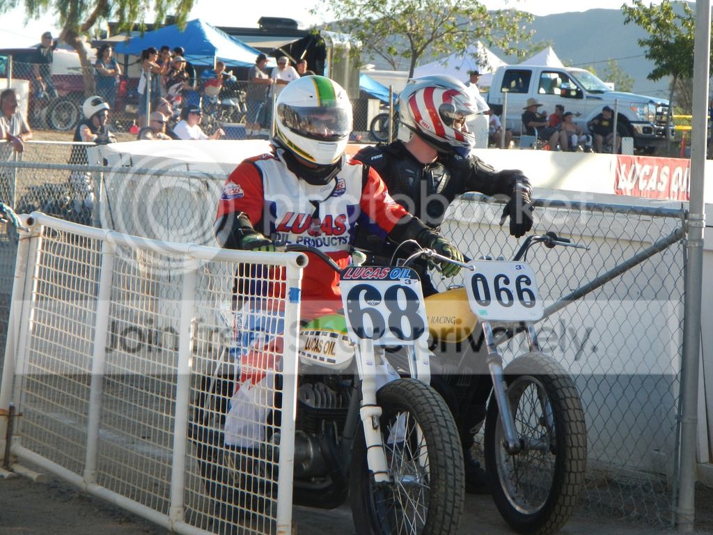

Here are some photos from the July 25th race. I was the ONLY one in the Vintage 250 class :'( I was racing Vintage 360's and a semi modern YZ250. New top end ran great, but the bike kept popping out of 3rd gear for some reason, so I have some work to do before the NEXT race on the 15th >:(
I did get some video, but it is pretty embarrassing, so I wont post it. Once I have a 3rd gear, and I get a little better at racing I'll post a video or 2
Are those guys running a smaller rake on their bikes than you are on yours? It seems like you have a much larger rake. I'd expect the short wheel base would do much better on an oval flat track, taking some load off the front wheel and allow you to throttle into the turns better.
Yes they do. I think the optimum rake for flat track is 26 degrees or around there. My bike it stock rake.
