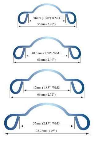

1.4" and 1.6" are nominal sizes. They don't indicate the actual rim width. It's dumb, I don't know why Honda did it but they did.
Grab a measuring tape and measure the rims for yourself. You'll find the front is actually about 2.1" wide and the rear is actually about 2.3" wide (reference: http://www.dontai.com/cb125s.htm, see the section about tires).
3.00" is the nominal tire width. Again, nominal doesn't mean actual width. Here's a good write of tire sizes explained: http://www.revzilla.com/motorcycle-tires-101-guide
