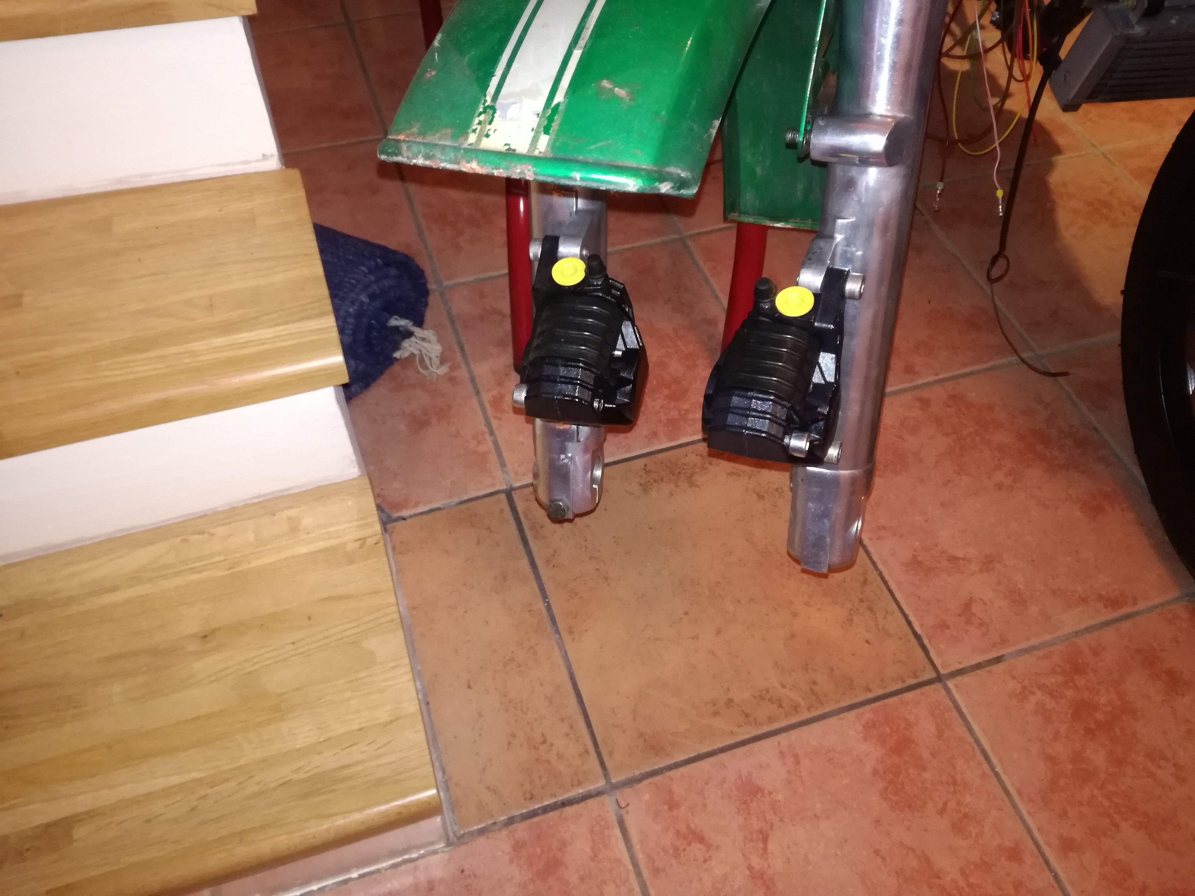

So anyway, fixed one of the brake calipers. Two parts was missing from kit for the other caliper so it has to wait until I get some new ones.

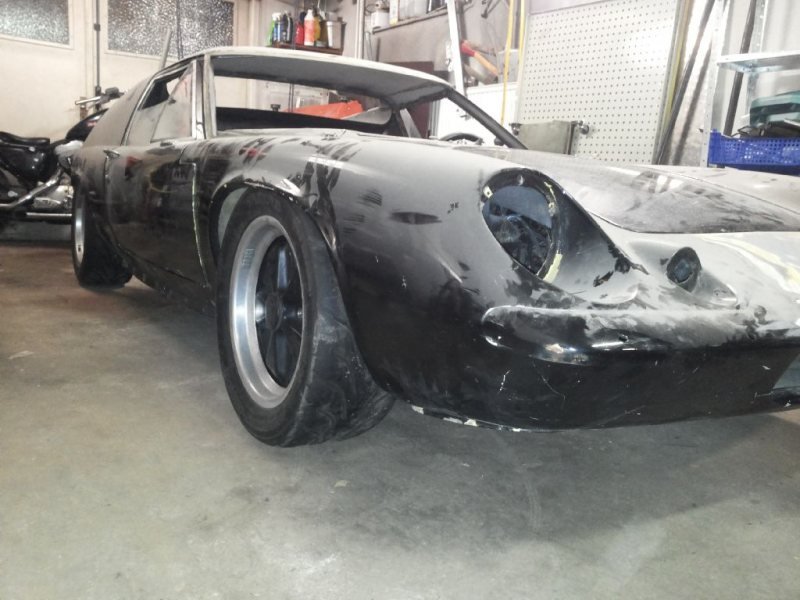

Looking great. Whats the car? ;D
It's a Lotus Europa S2 from 1969.

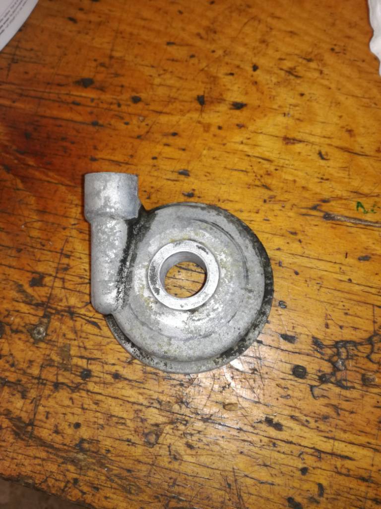

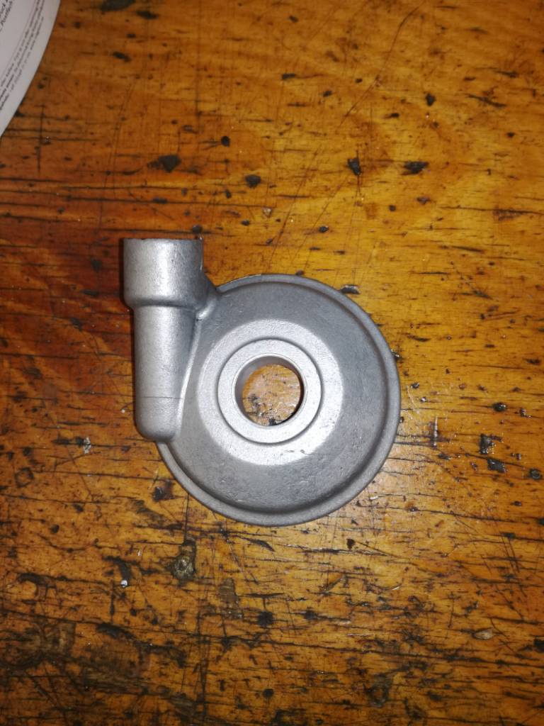

All the aluminium parts are heavily oxidized so I'm doing some glas bead blasting. Here are a before and after picture of the speedo drive.
Sent from my HUAWEI VNS-L31 using DO THE TON mobile app

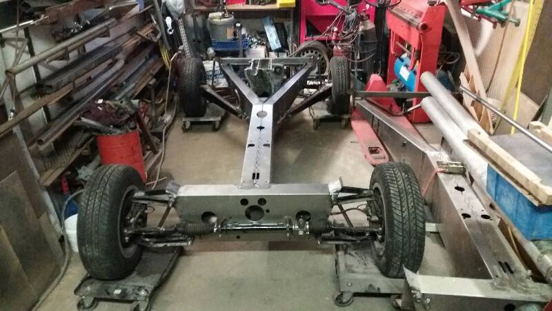

Yes. Alot of measuring. 18 hours to weld one up.
But it was a nice project.
One frame was made for a friend but he gave up with his car so I'm stuck with an extra frame.

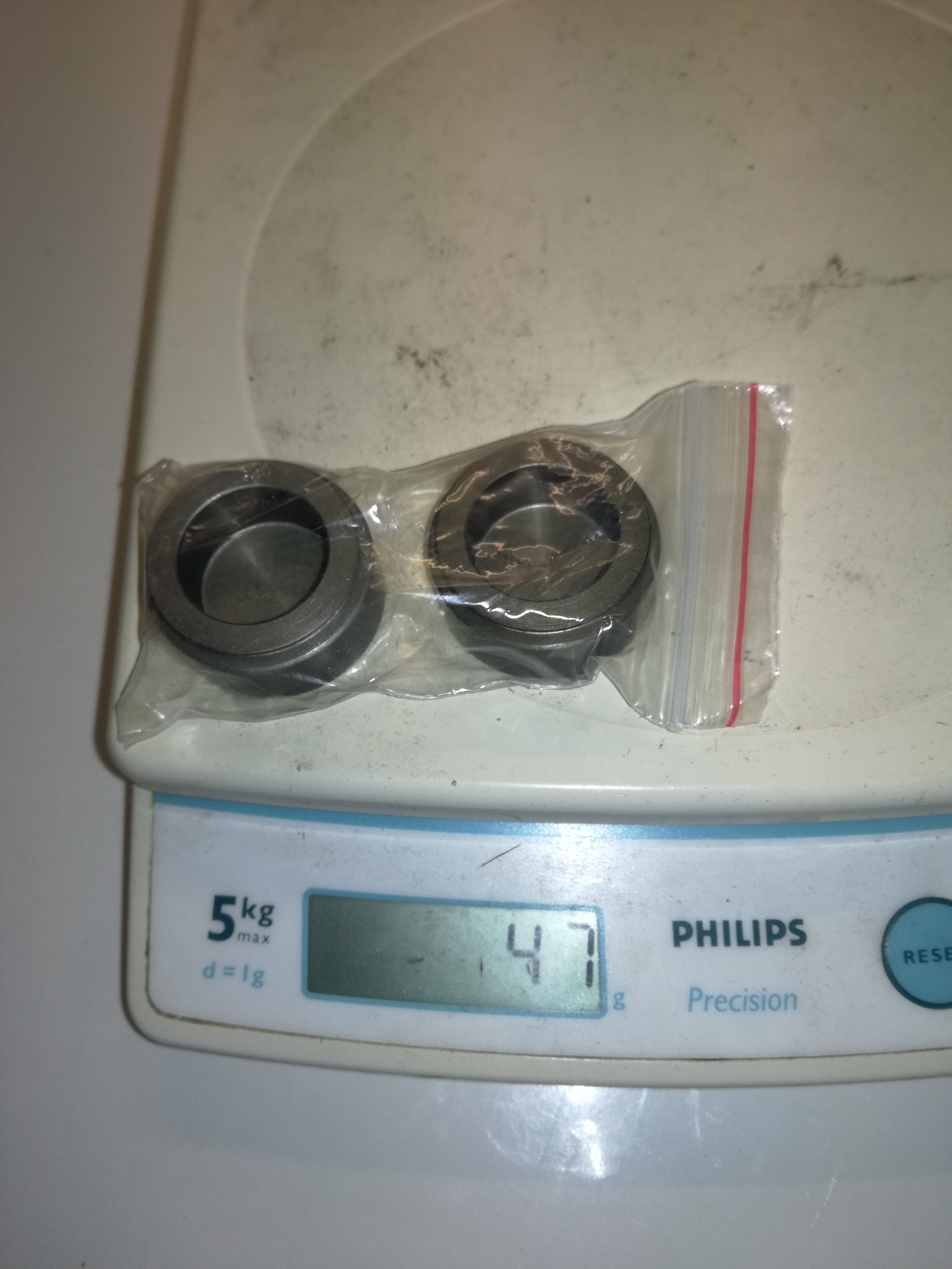

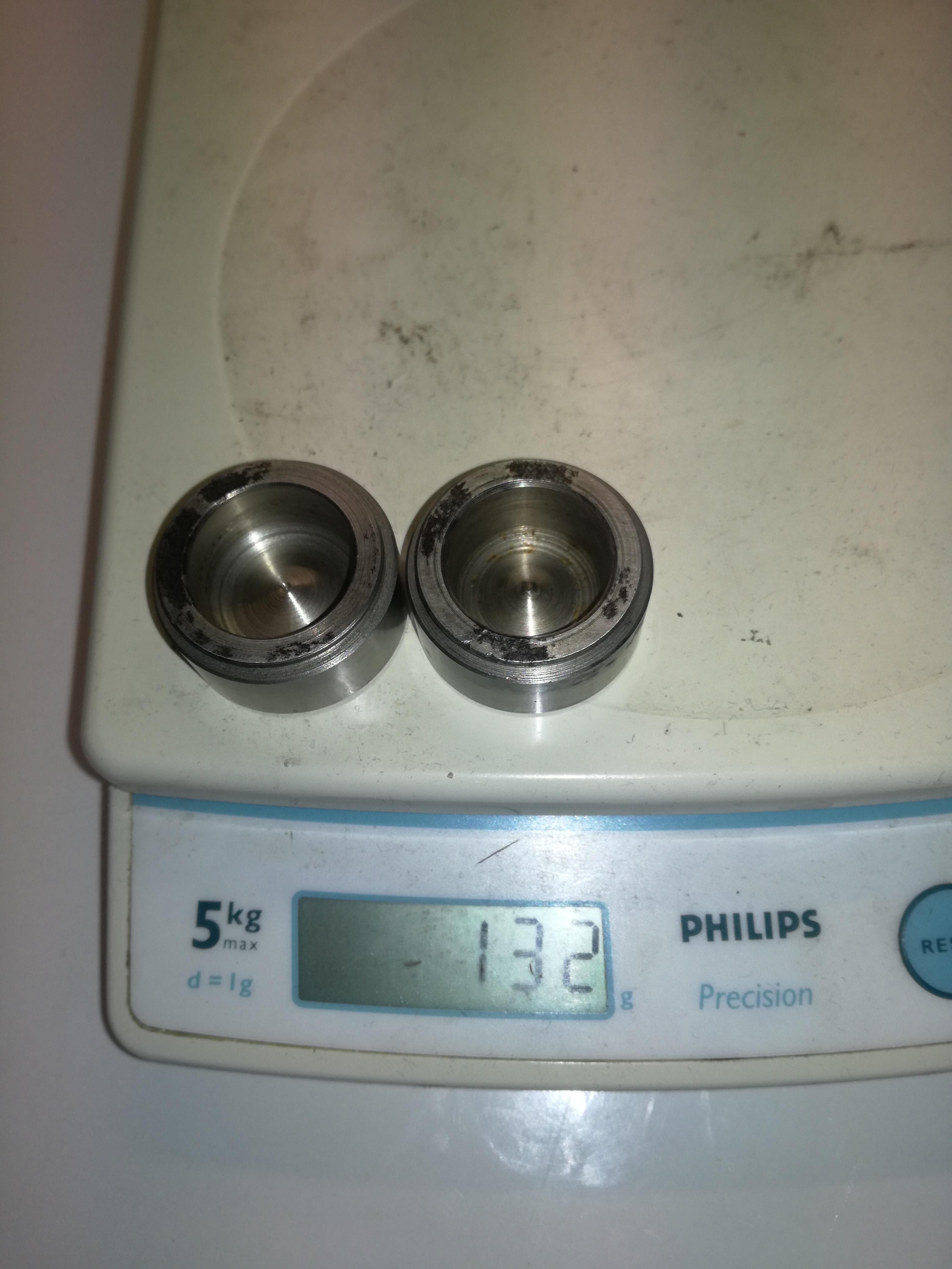

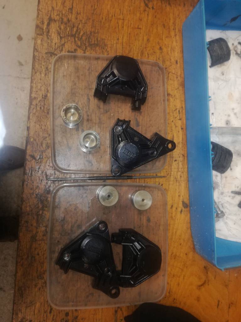

A month ago when I went through the front calipers two parts was missing from the one of the repair kits. So new part was ordered.
Yesterday I got a box filled with new parts. :)
Also I changed my mind as I had cheated with the one caliper I did. The pistons was a bit pitted, not too much, but enough to be annoying. So decided to correct it.
New pistons for the calipers was ordered too.
Fun fact, 2 new pistons weighs 47grams, 2 old 132grams. Saving 85grams per caliper.
Soon I have to change tread from restorations to cafe racer ;D

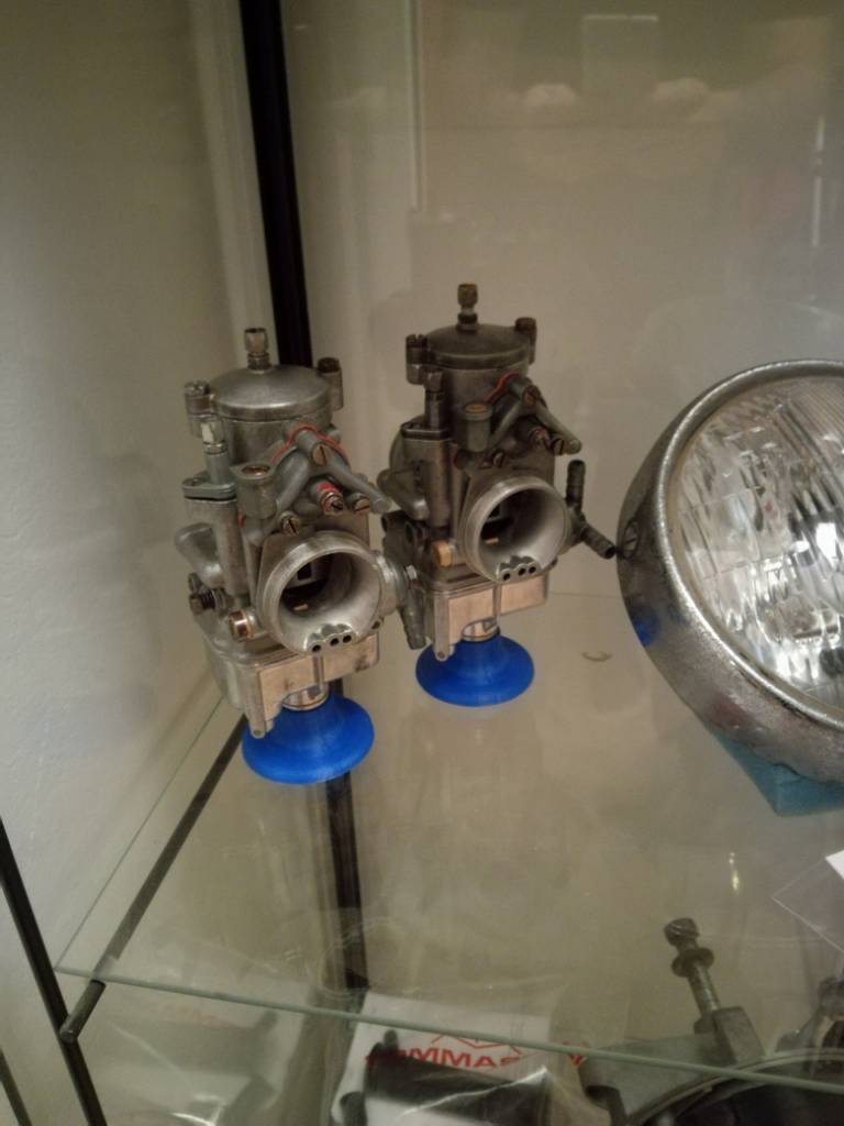

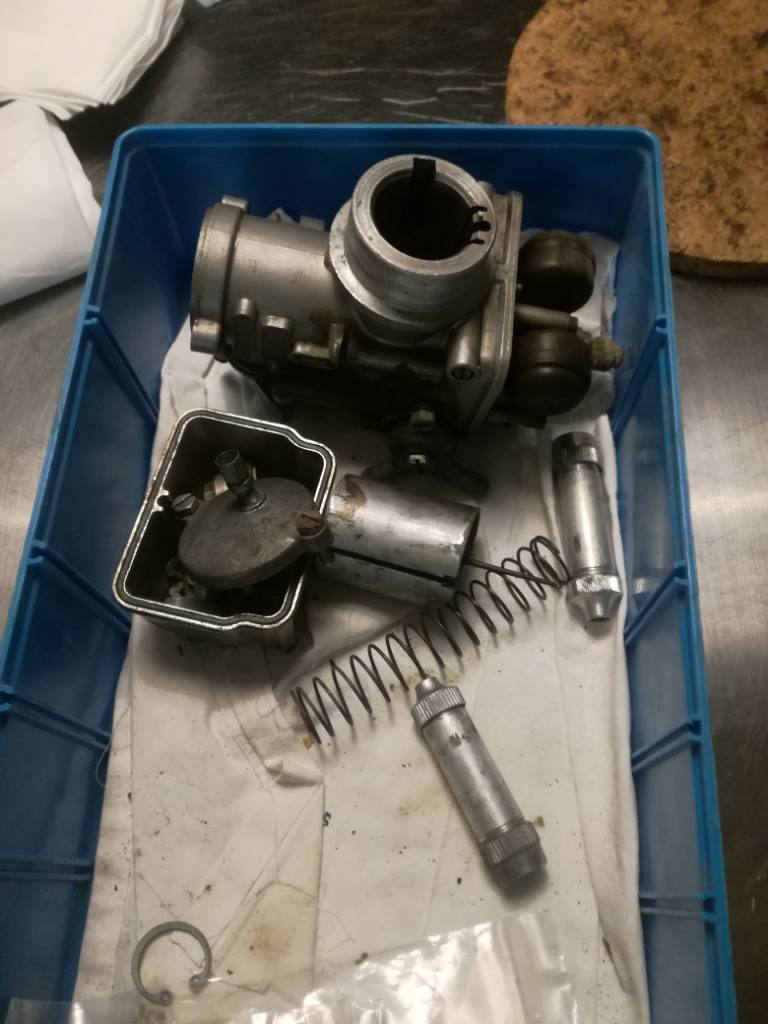

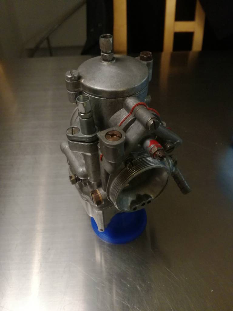

One carb done, one to go.
Both where completely stuck and I have been soaking them in degreaser for weeks. Then they have been in the ultrasonic cleaner for a long time. Soon both are done with new gaskets and seals.

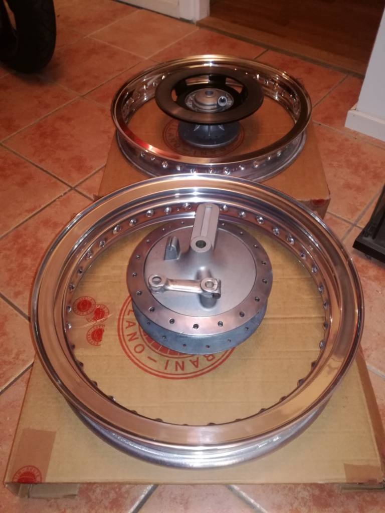

Minor hickup on the wheels so you have to wait for an update on them. However I promise the end result is going to be good.
Both carburetors are done.

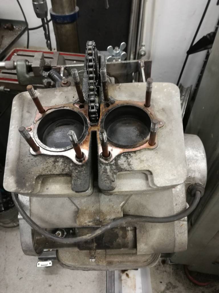

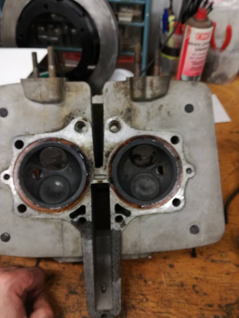

Today I removed the head and cylinder.
I think this is going to be an expensive engine rebuild.
At some point someone got the camshafts out of synk. I found a valve imprint in the left piston.
It's just a small one.
Hopefully the conrods and crank survived.
Rockers doesn't look to happy. Some pitting in the chrome, but cam shafts look okay.
"It's like a box of chocolates. You never know what you might get"
Also one spark plug thread is not looking to healthy.
Other than that it looks good. Nothing really broken yet.
I'm looking forward to open the crankcase.
