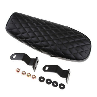

Sorry but I don't see the style matching- what about :-
That might work too. I found a Duc with the tracker seat but when I tried to paste the link it kept crapping out.
How about something along these lines?
Cafe style sportster seat could fit the subframe lines of your bike pretty nicely.

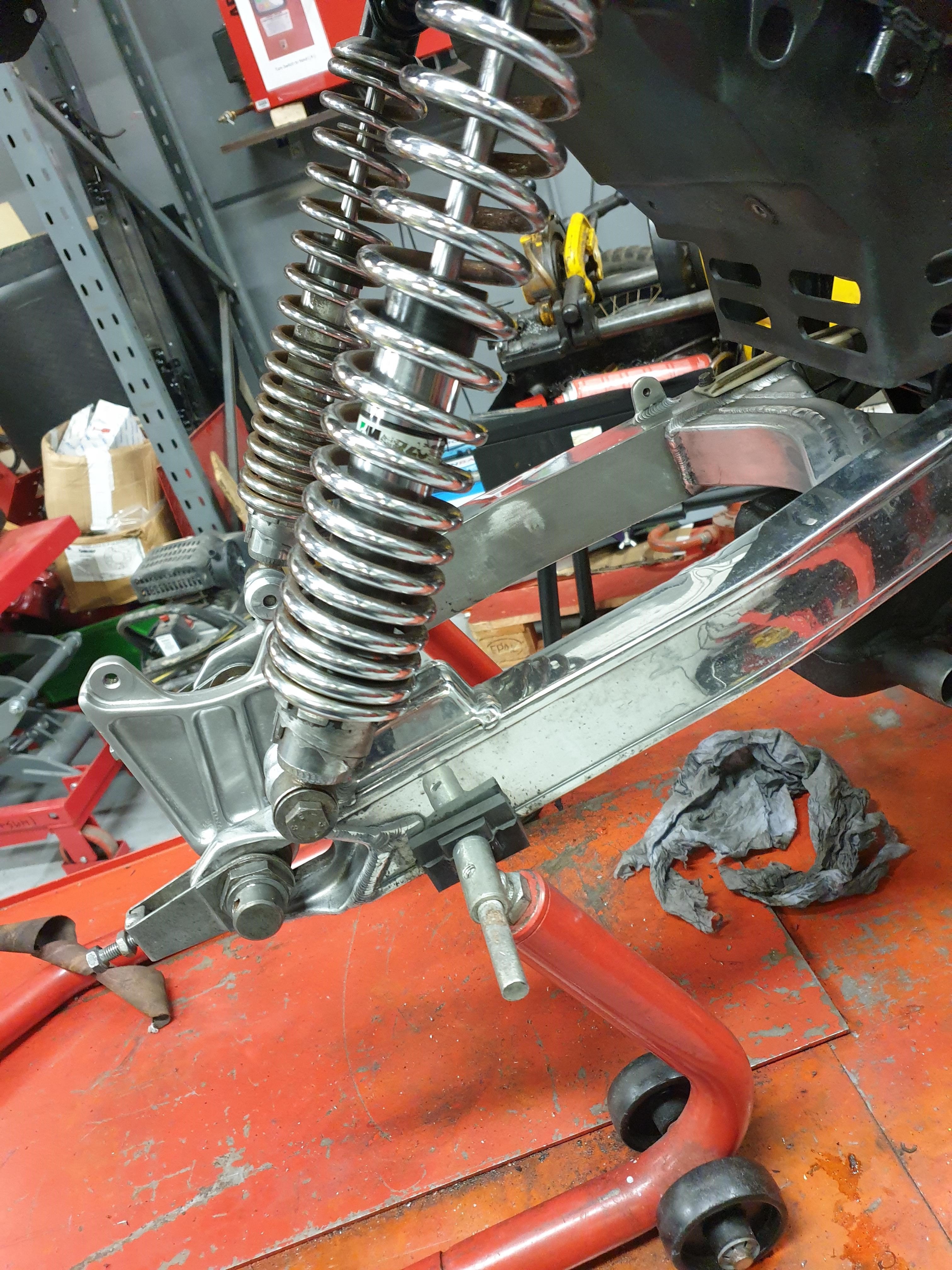

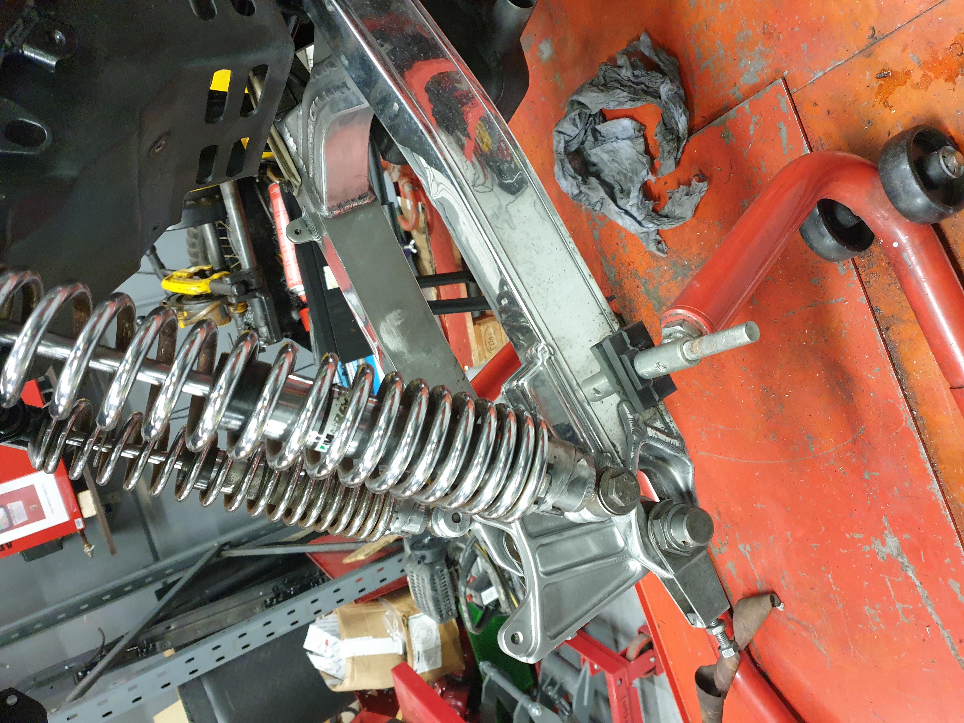

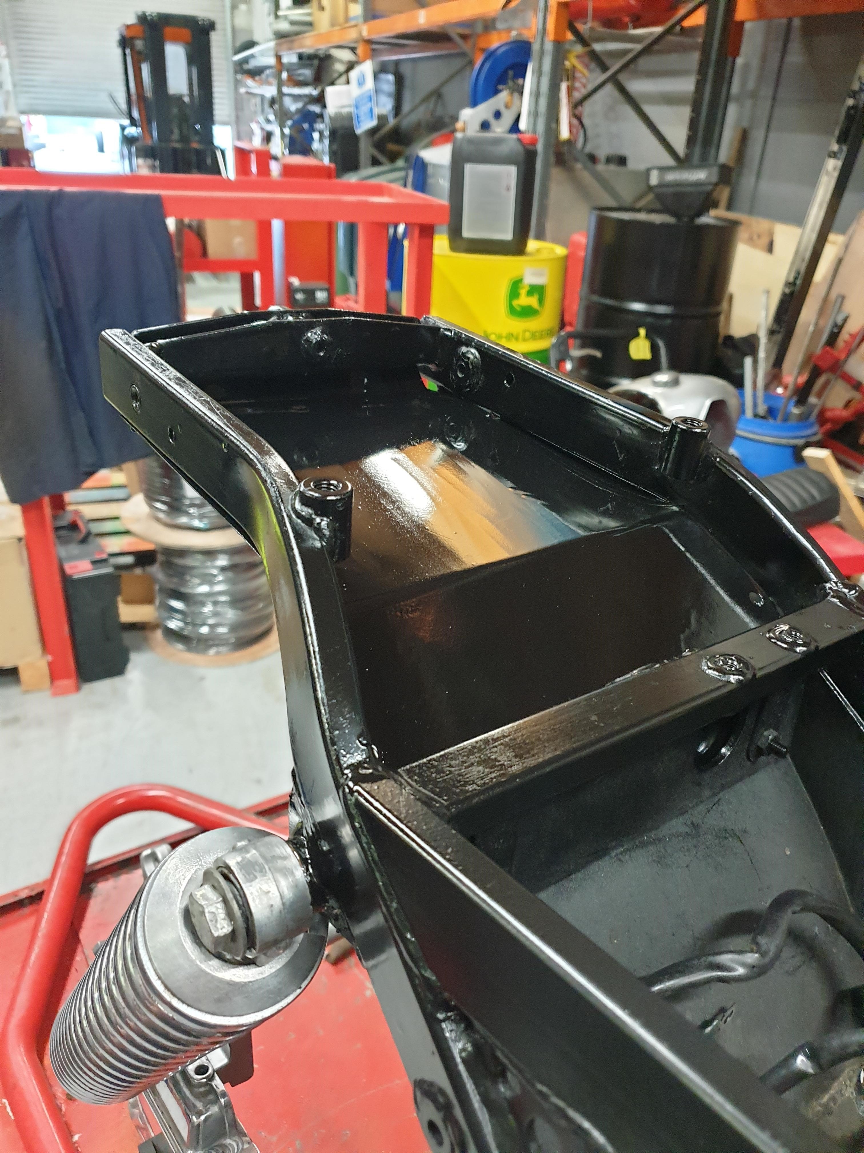

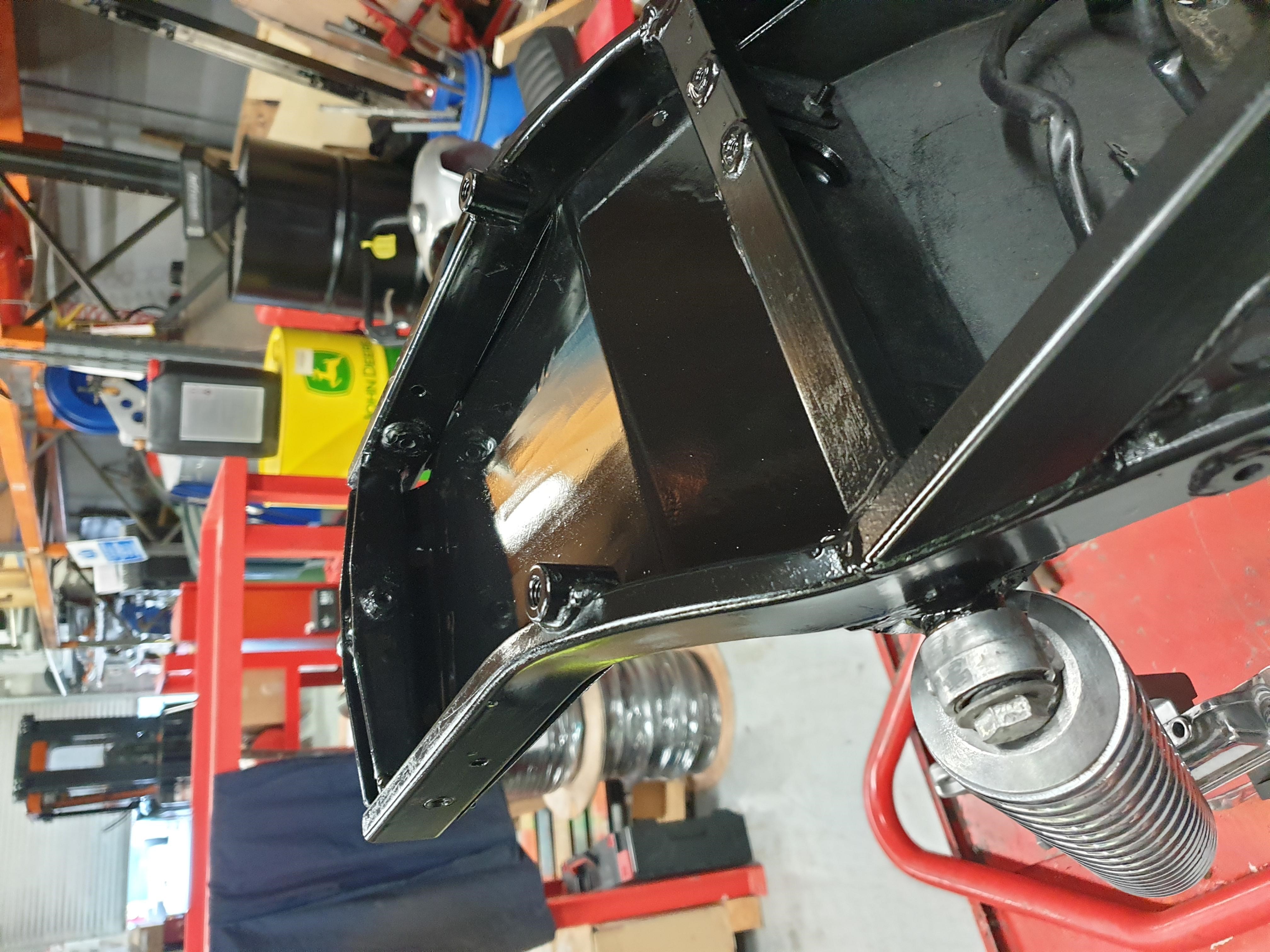

I've decided to go with a tracker flat seat, I've made an under tray and I've got an SS750 rear hugger on the way- so I can't build it up much more until these get here. I'll concentrate on the wiring and the hydraulics for now

Apologies - right way round
