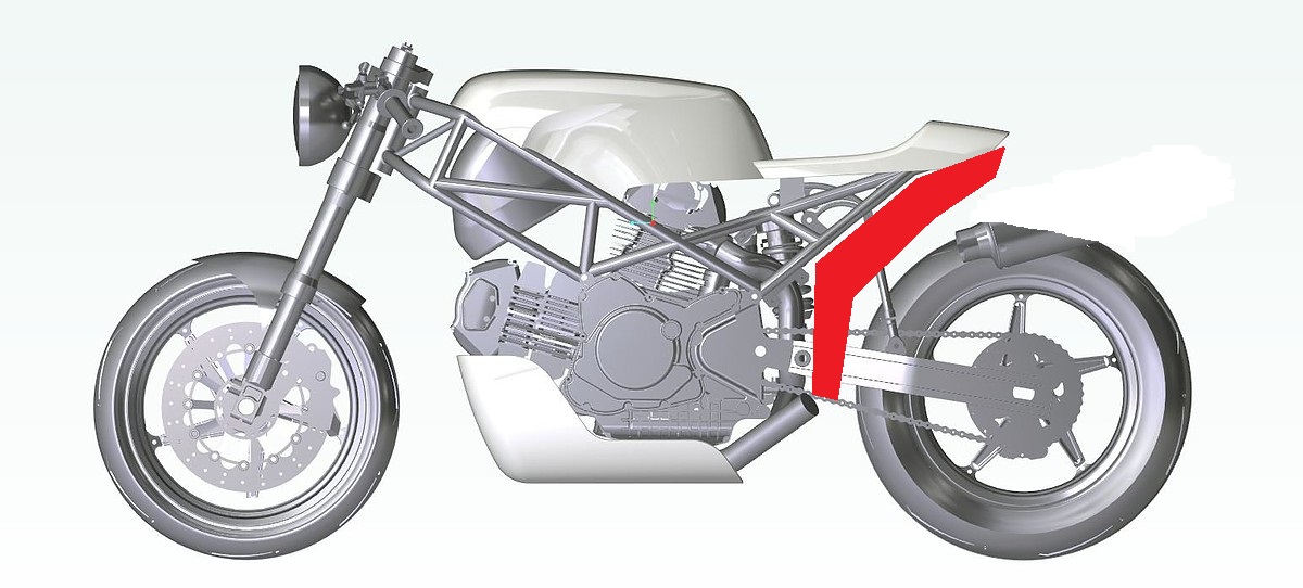

And I couldn't resist photoshopping on my CAD to check it looks like I imagined..
Thought I'd throw this in too. I'll admit this shot is a bit staged.. but I have gone through probably close to 100 prints, sketches, and overlays to get to a design I'm happy with:) This is just a few
