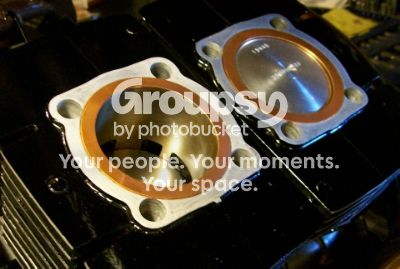

Jessica, Dad, and I all worked in the shop together today and we finished assembling the top end of the engine so we took some new photos for you all to enjoy!

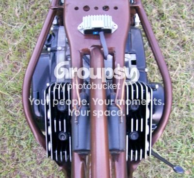

Today I started to install some of the electronics including the ignition coils, voltage regulator, and the voltage rectifier which are all mounted under the fuel tank so that we can keep the bike looking really clean. I also mounted the new exhaust manifolds and installed the stainless steel exhaust chambers!

I love how this project is coming out Joe! This is truly turning into the world-class bike we hoped for, when we started. You are a perfectionist and I am benefiting from it! BIG TIME!
I’d swear that even the two voltage regulator mounting screws are lined up at ’12-oclock! Lol
No really! They are!

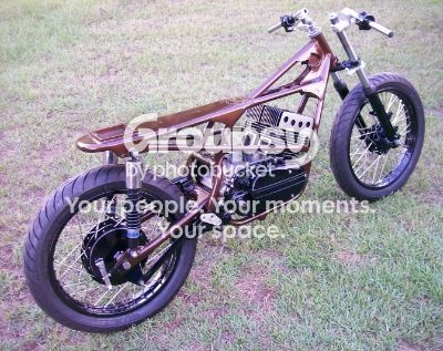

This afternoon after I took the bike off of the lift so that we could set the fuel tank on the bike and turn the handle bars so that I could mount the new steering stabilizer and check for clearance.
While I had the bike off of the lift I set the tail section we built on the frame and took her outside to take these photos and I thought you all may enjoy a new photo of the whole bike so you could see how she is resting this evening!
