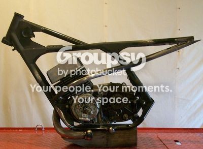

Dumb question are you running pipes out the front i just glanced at another rd your real close to where the exh ports dump there. But i guess if you reverse the jugs and run a single carb.
We are going to run the exhaust in the stock location Brother, I set the engine in the frame before I made the new cross brace frame rail that connects the front down tubes to check for clearance and we have a lot of room. I put the bottom end of the engine in the frame today and set the cylinders and heads on to check the clearances again, we are not going to use the stock exhaust however I bolted the left header on so that I could take some photos for you.

Brother neevo that is correct, as Brother bluesmokey previously mentioned we are going to weld the loop to the end of the top frame rails. When I designed and built the new side frame rails I left extra length on the end of them where I welded them to the top frame rails as you can see in the photos so that when I build and weld the loop to the end of the frame I can weld the loop to the factory top frame rails and the new side frame rails so that all of the frame rails will be welded together.
The area where the top frame rails, new side frame rails, and the loop all meet is also the area of the frame where I will be mounting the new top shock mounts that I am building. The plan for the shock mounts is to build plates that will be welded over the area where all of the frame rails meet on the outside and inside of the frame on each side of the bike, for each individual shock mounting post I am going to drill through the plates underneath of the frame rails so that I can run each post through the plates and weld them in. Basically the top shock mounts will be box sections on each side of the frame with a post running through them for the shocks to mount to.

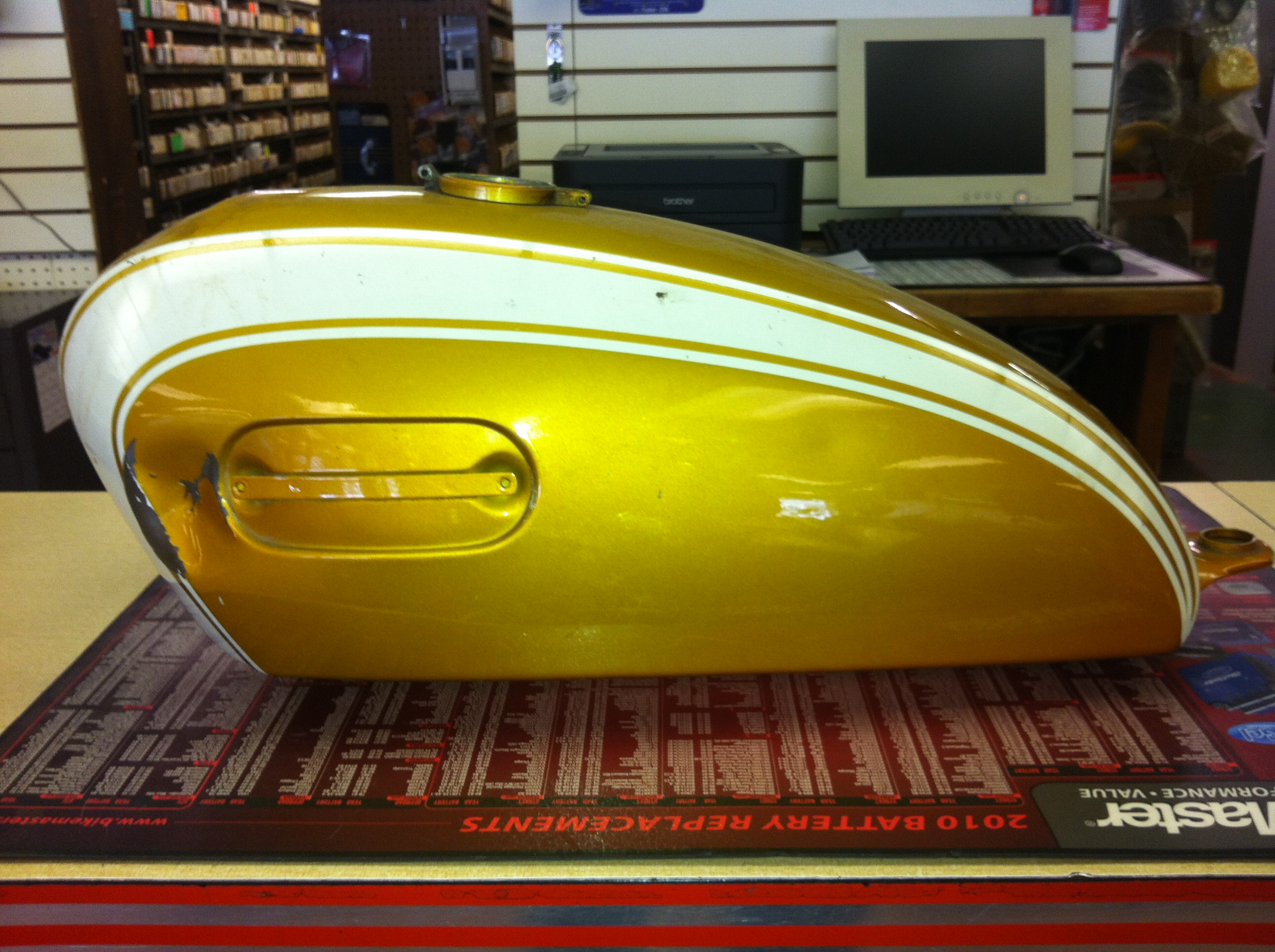

I finally scored a nice steel gas tank last weekend and it's on it's way to Brother Joe so that the magic can continue!

We have been playing with different ideas for the fuel tank and after test fitting the other tank we decided to build a full one piece body that will incorporate the stock fuel tank, the body will be one smooth piece from the front of the tank to the rear of the tail section!
I am going to go ahead and start building the body and now that I know how long it will be I can also go ahead and start finishing the rear frame work and build the top mounts for the rear shocks.
The steel seat pan I build will be welded to the rear of the tank so that I can fully enclose and smooth the area where they join. We are going to utilize the stock front tank mounts and build center and rear mounts that will have rubber dampers between the body and the frame to absorb any vibration.

The bottoms of rd tanks are flat on the sides and thin due 40 forty years of holding fuel dirt rust what ever. ive seen spotless insided tanks get pinhole leaks so be carefull hanging a seat off of it. there often not up to the task of holding fuel much less being the hinge point on a 2foot lever on a bike that shakes like crazy. just somethine to think about , ive welded on every single 350 r5 rd tank ive ever had so becareful
Re: DWMS Racing RD350 Build! We Are Building A One Piece Body!
Brother Brad I really appreciate your concern however the way I am planning on mounting the body there will not really be a hinge point or a lever effect, the flat seat pan itself will be steel and it will have several mounting points between it and the frame to absorb all of the weight of the rider so the tank itself will not have any weight on it at all and I am also designing all of the mounting points to have rubber dampers to help absorb vibration. I like to seal the inside of all the tanks we build and will be sealing the inside of this tank with Caswell tank sealer. Basically this is the same design that we use on drag bike bodies I just have to be careful with the mounting and make sure there is no flex where the seat and tank join.
