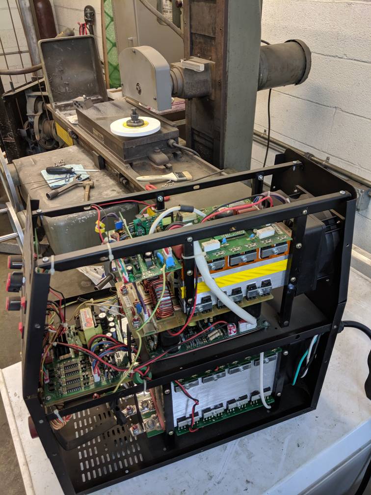

And, after four faithful years, my Tig200 AC/DC has shit the bed. Like it just lost all power. It'll arc, but won't create a puddle in anything. Weird.

I'd bet you it's the same caps that went bad in mine.
Since you already replaced it it can't hurt to tinker with it.
Pull the boards out and look at all the caps and solder joints. Likely you'll see an exploded cap or a burned joint.
Will do. I e-mailed Eastwood, asked if they repaired them, or had certified repair centers. They e-mailed me back earlier this week, said if I could find out the issue, they'd sell me the parts.
And, I just remembered how much I hate electronics.

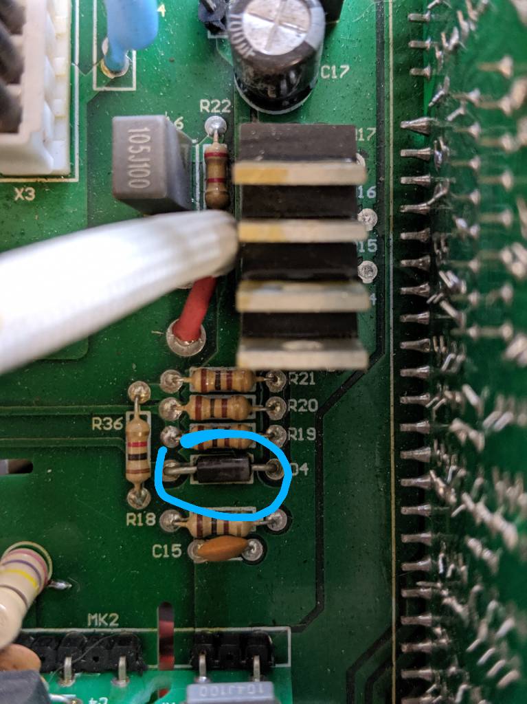

Quick glance. That doesn't seem to look right.
Any idea, Sonic, if that is right, or not?
Sent from my Pixel 3 XL using Tapatalk
Mine blew a cap on this board
