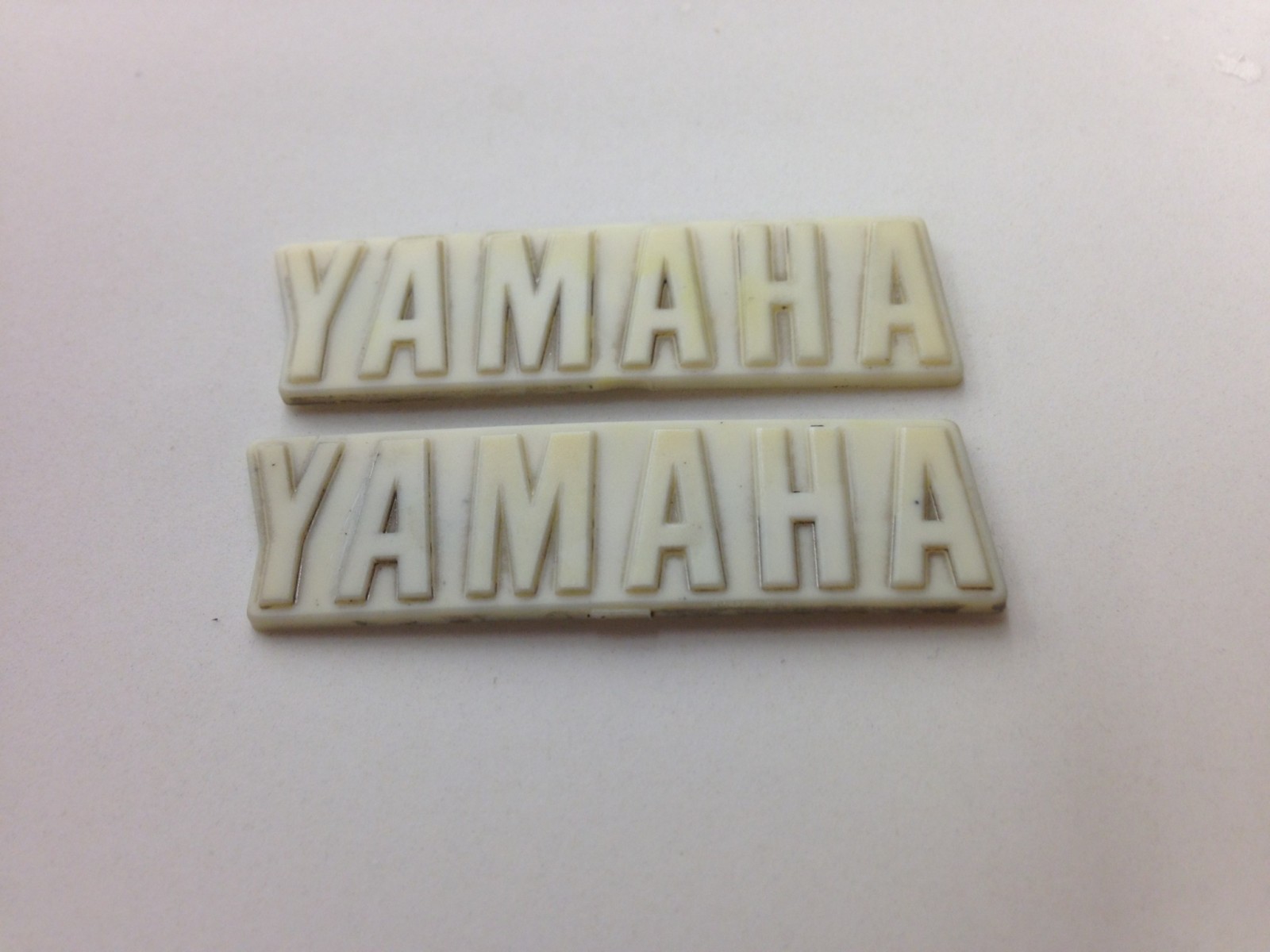

On my SRX600, the finish on emblems with the word “YAMAHA” were damaged. I would have replaced them if new ones weren’t so damn expensive. List price for one of these plastic emblems is $55.00 each (or $36.00 mail order). I decided to try refinishing them and am happy enough with the result that I though I'd share.
First, I stripped the old finish.
I then painted the emblems gloss black and restored the chrome finish to the letters using Bare Metal Foil, a product designed for model builders.

What did you use to strip the emblems? I am getting ready to do this myself and think that yours came out great!
I turned the air pressure way down and bead blasted them.
