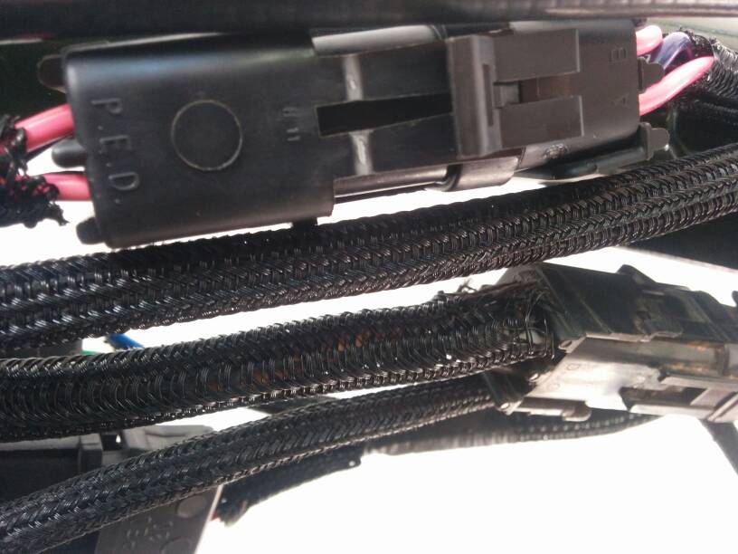

Got a bunch of re-wiring done today while I wait for some head nut washers to replace those I lost along the way. (booooo.) The bulky weatherpack block connectors are no longer awkwardly cramped between the tank and the bars, stressing the wires as the bars turn. Got them tucked up under the tank now, with nice smooth wire runs. Hopefully engine heat doesn't kill them...doubt it will...but we'll see. Waiting on some slick-looking woven split conduit from McMaster to clean it all up.

Wire sleeving looks cool. Block connectors now hidden under tank.

If you use a little marine grade shrink tubing (the kind with adhesive inside) over the ends of the braided wire wrap it won't fray and bunch up over time.
Thanks!
I planned to, but in a lot of cases I couldn't because of the multiple terminals to try and slip it over, even when they were pulled from the connector block. I've used silicon self-fusing tape instead in some places instead. I've also used a match to melt the edges a little.
Edit: This is side-split braided sleeving, not the expandable chinese finger-trap woven stuff. I needed something that I could install where I already had terminals and blocks in place; I had cut off the tubular vinyl sleeving I'd installed first go-round. It looks 89% as good as the fully closed sleeving, but has the ability to come off and on easily. That's good for someone who fucks things up as often as I do.

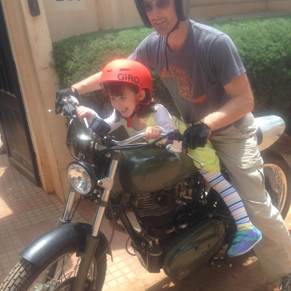

And test rides commence!
