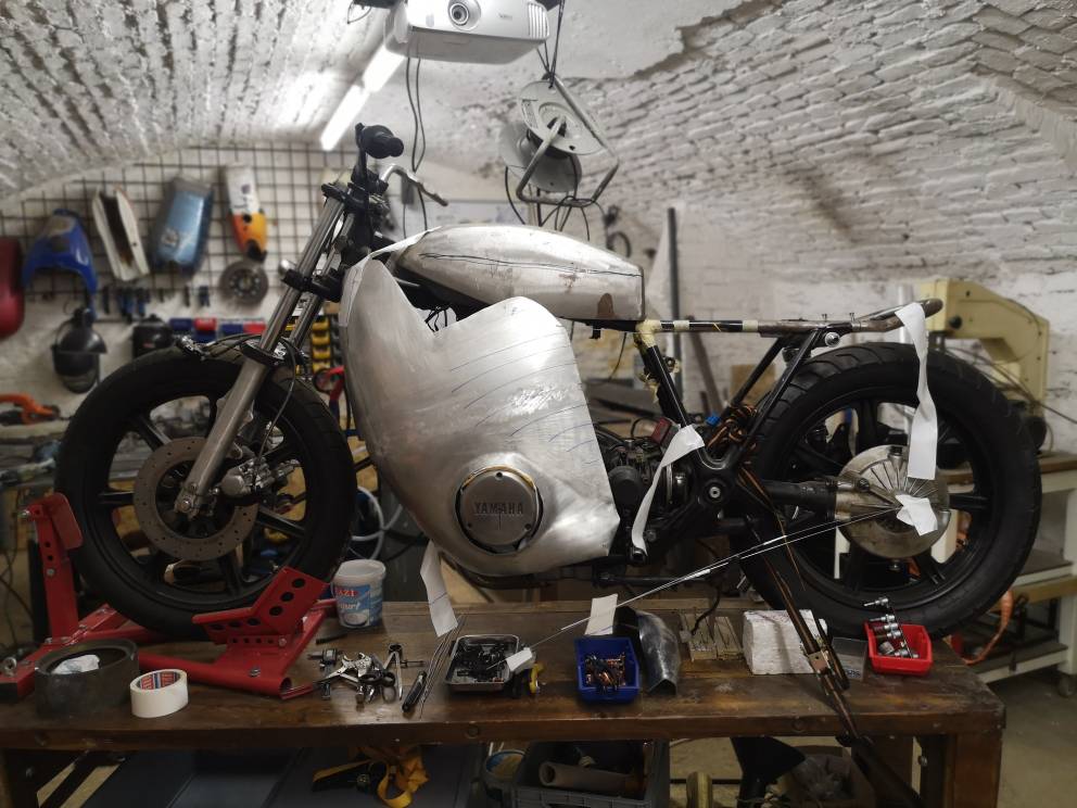

Long time no hear!
Well I had no time and resources to mount my fiberglass fairing but it looks like I´ve got a alumnium fairing for my xs 750 project coming along.
Pics below.
Is there a difference in mounting a fiberglass then a aluminium fairing?
If yes please elaborate!
Still a lot to do, just basically beginning but I want to collect info so I dont drill the wrong holes and such :-)
Where would you advise the mount the fairing?

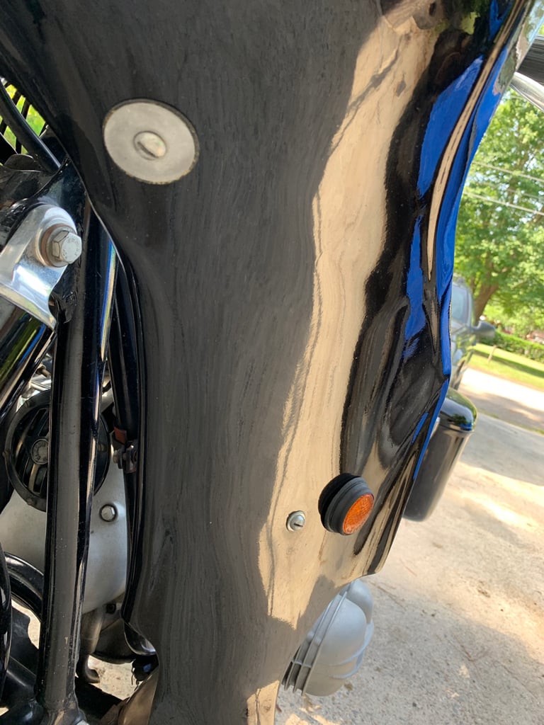

I have an R69S with a fairing in my shop atm. Here’s how it’s fairing is mounted...

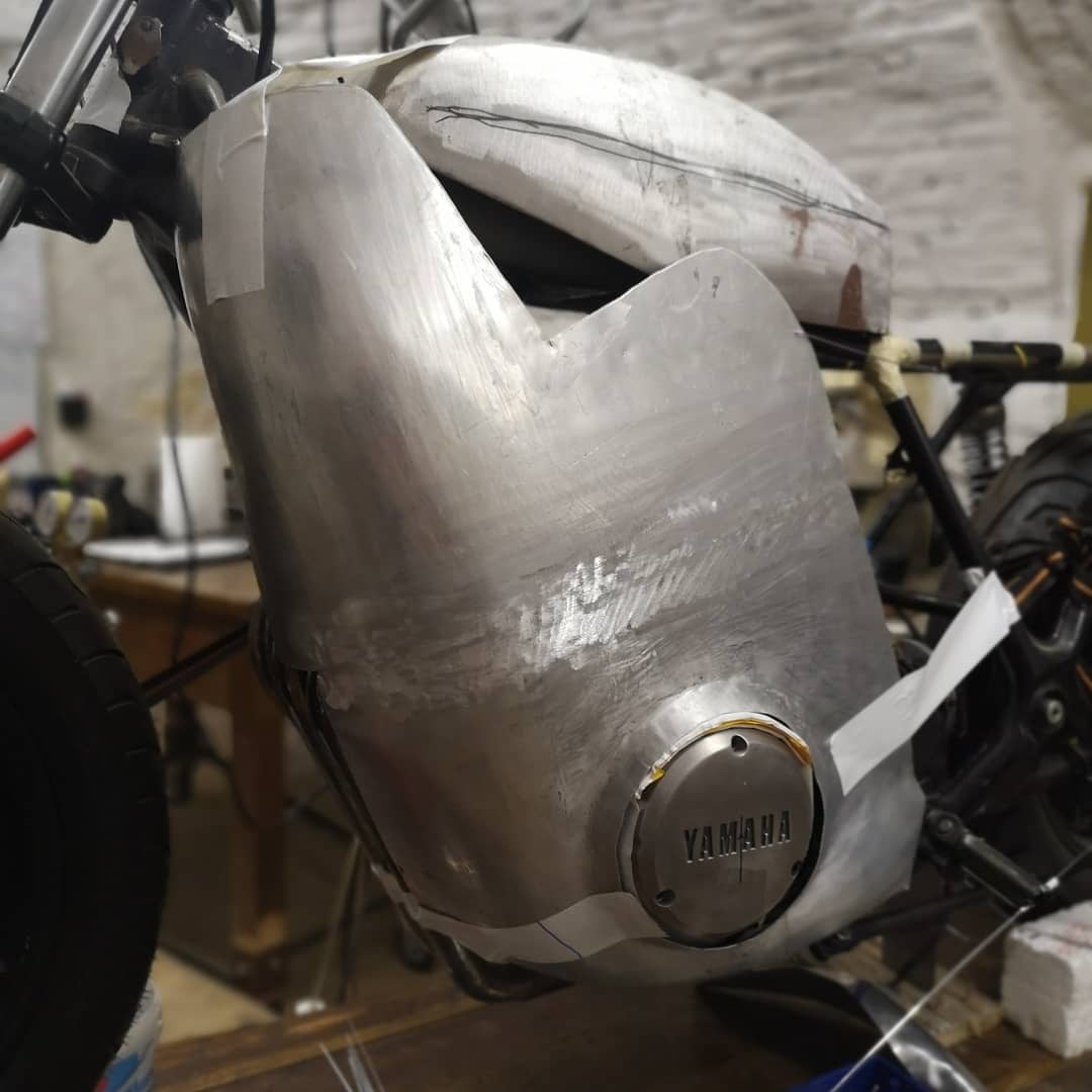

Thanks guys for the input!
The fairing is slowly coming along.
A lot of shaping sanding and all the good stuff.
I need to figure out how to finish the edges of the fairing. I had a chat with the engineer that will make the registration and told me that the edges need at least 2.5mm 'rolling diameter'.
I ordered a big set of mounting hardware from ebay let's see what I'll be using.
