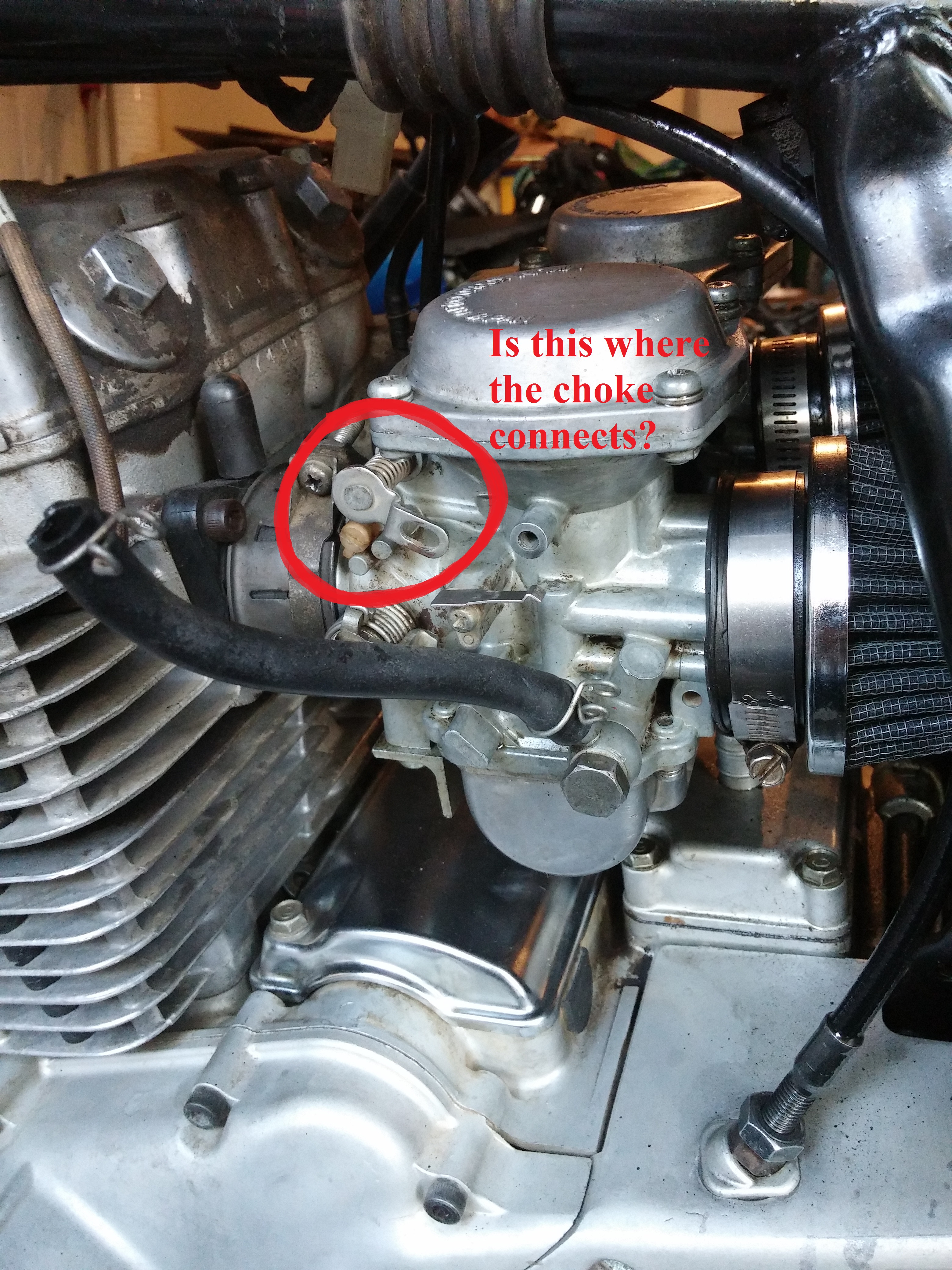

4. Connect a cable to the choke so it functions
- Any help on this is appreciated, I'll post a picture of what I think the choke is. That way I know I'm not hooking up to the wrong thing.

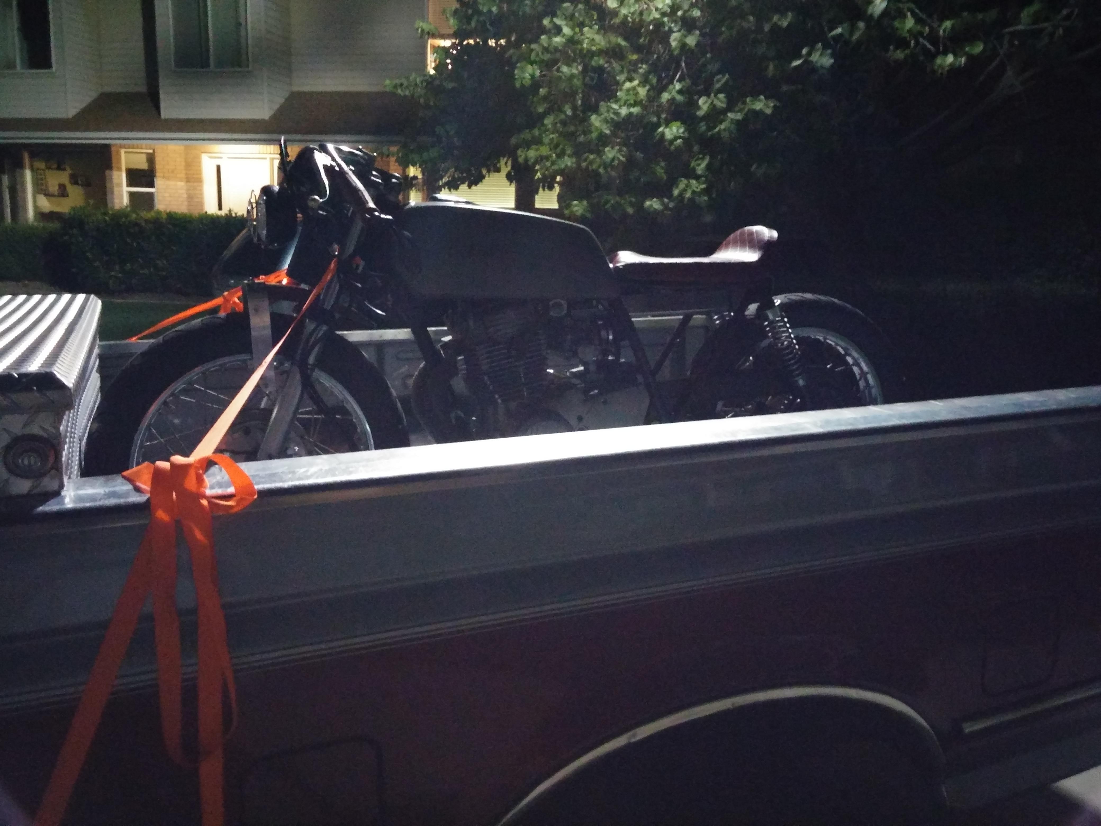

yep tuneup is in order get some mufflers on those pipes ,and you need to have the pipes and mufflers out as long as the rear axle
you will have to redesign the horribly concieved rear of the bike the tire must not hit anything at full travel, stiffer springs are the wrong way to fix that you simply must have the clearance
get rid of those awful clbman handlebars they are the worst thing you could do to any motorcycle and actually make it a hazard to ride for a novice
put some standard type handlebars on there
get some fenders and find a stock airbox it will never run right with pods
you have a shitload of work ahead of you, best thing would be to sell that turd and buy something that is not hacked up so badly or just be prepared for a thousand hedaches ;)

Yeah I forgot to mention that, I'm planning on getting some clip-ons and I'm already looking for an air box to put on it. I've looked online and I'm pretty sure I can pick some up for about $30, I'm just not sure if they're the right part I'm looking for. Why do the mufflers have to come out as far as the rear axle?
clip ons are no good for a novice street rider either, they are for racing and posers, just get some superbike bend bars or low mx type bars so you can actually ride and control the bike in traffic ,please
the way the streets are these days the last thing you need as a beggining street rider is to have your arms locked straight reaching down to clipons
or to be hunched forward in a position that is only useful at high speeds on a track
and does not allow you very good control or vision in and around traffic
as far as the muffler length it is to make the engine run right short pipes don't work with the design , you can make it run with short pipes but not as good as it should
