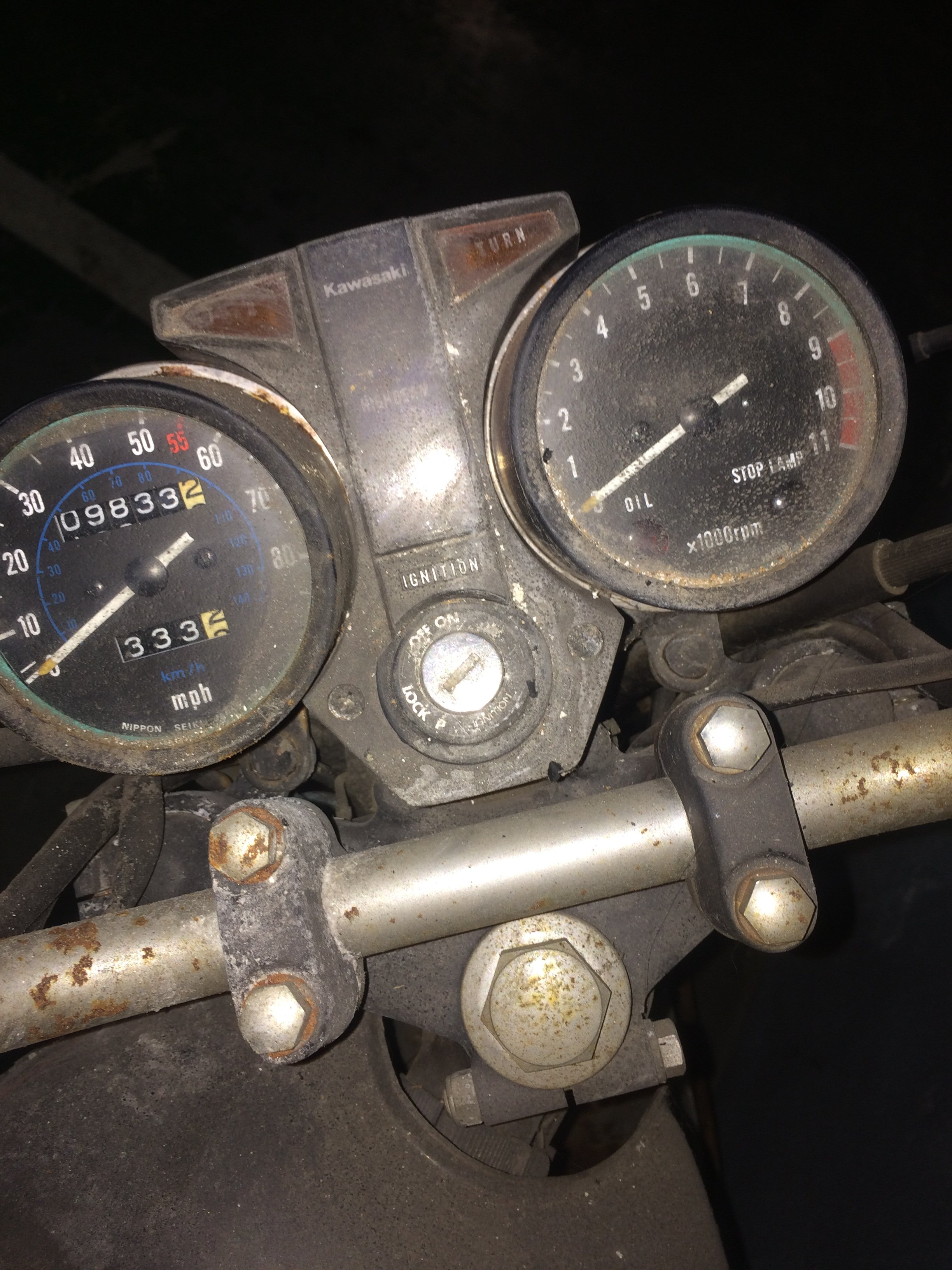

Hey guys im new to the site here and just got this KZ440 ltd and im not sure what to do with it! i got it for free ive never had a bike before but im an auto mechanic so i have some knowledge of how shit works.. OK first things first! I HATE THIS FUCKEN SEAT! its gotta go! second this thing has been sitting since 92.. tell me what i need to do first again i need help guys! im on a budget so bafre with me.. i have ordered the service manual on ebay so thats comming.. anyways any links or anything that i need to know please help me out guys! im gunna attach some pics., its still at the place where the guy has it stored its got rust and corrosion all over it.. :)

you guys rock! cool! yea i just got the bike to my house had to rent a uhaul and bike trailer and pick it up in hollywood where it was sitting.. im waiting for daylight to come up so i can start fuckin with the bike! yea no snow here for me buddy! lol and the only thing i really wanna change right away is the fucken lame ass seat! what should i do to get it running? its been sitting since 92..
Check the tank. It is possibly rusty and/or varnished up.
New fuel lines and rebuild the carbs.
Check for spark, oil level and valve clearance.

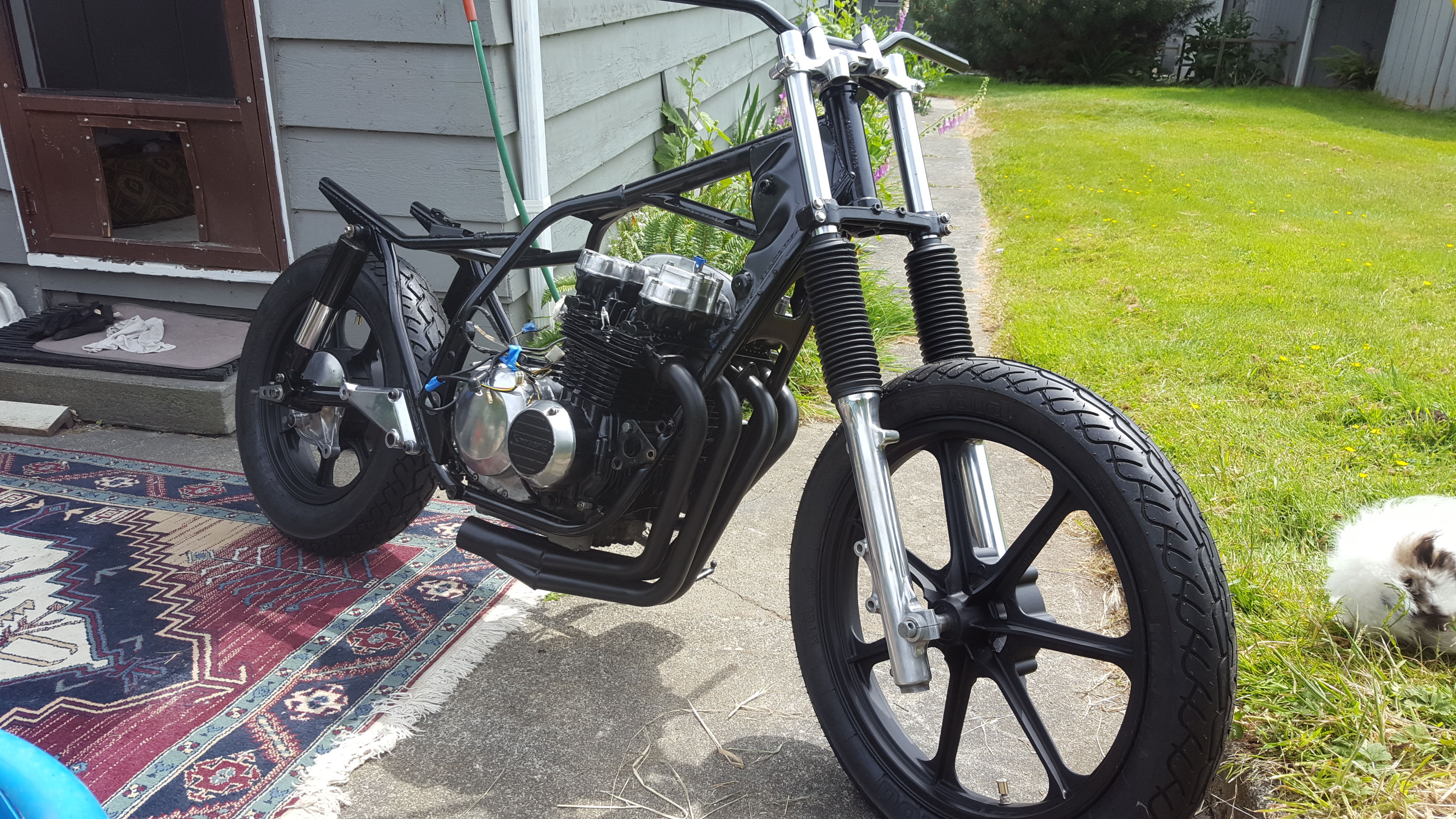

Congrats, I am building a KZ550 right now, lucky it was barely running when I got it. order a carb bowl gaskets, drop the bowl and carb clean the f out of it, be careful not to bend the floats. Get a new fuel filter and put it in between the petcock and carbs, take a bunch of screws put the in the tank (after taking it off) and shake it up to remove the rust, unless it's really bad, you can buy a kit for like $100 that you pour in and seal the rust. once that is done or I bought a fuel bottle and use that hanging from the bars so the gas is clean. New battery (bought a gel so you can remount later at any angle) look at the coils under the tank, if either is cracked you need a new one. Use eBay (I work for them :) once it's running then go over the brake system, remove the dot fluid completly then fill and bleed. drive it around a bunch and make sure it's a runner before you waste money on anything else.

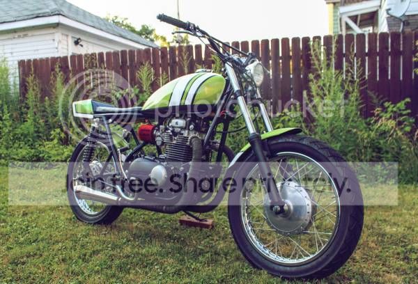

Plus you could take off the rack, remove the vinyl from the passenger area and roll it back, then chop the seat pan behind the driver seat and tuck the vinyl under and rivet. then you have a cheap single seat till you get some more bucks.
