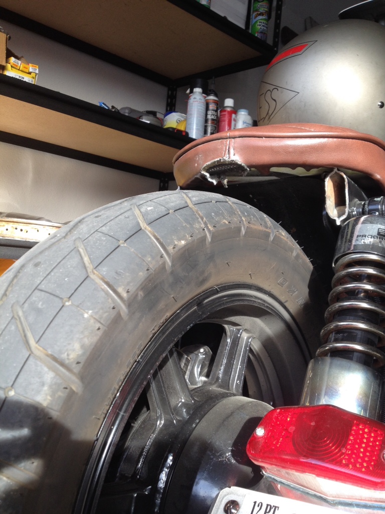

Clearances? Crazy, you must be getting a little up there in the years to not appreciate the new hot look.

I actually rode a CB650 which got VERY interesting on the first dip in road. Luckily I was only doing about 25mph :o

Probably. Stock shocks are about 9-7/8"~ 250mm fully compressed center to center of studs.
When mocking up, it's a good idea to drill a bar to bolt into shock position with shocks removed.
That way you can get 1/2"~3/4" tyre to fixed parts and know tyre won't act as a brake when suspension compresses
As I said,several bikes had the same problem a few years ago, some ended up being completely transformed into something different, others -no idea what happened
Thanks - one thing at a time. I'll check clearances this week (which will require some reassembly...Uggh...) better now vs final assembly.
I do still think that the rear fender is high enough, but I don't want to find out that you're right. (The very hard way).
It helps that you use the correct wheel and rim sizes. I wouldn't go over 2.15 rim width with a 100/90 at the rear. Including the Goldwing I posted above, I can show you some grossly over-sized tyres I have the pleasure of replacing now ;D
Want to know what it feels like when your tyres are too damn wide? Let the air out and have a rip.
Shit. As much as I hate to admit it, it's hard for me to not think of this bike as a static object in the garage in a controlled environment. Back to the drawing board?...?...?we'll see. That's all for now. I'll come back with my game-face on.
I think your clearance is fine. I'm 170 lbs and run 110/80VR18 and I get bump just below the bottom of the frame tubes. I also run the suspension a little stiffer front and rear. I feel like the stock 360 suspension is spongey as hell, anyway.
I failed to mention that I weigh 140lbs wet, after eating a large pizza. Food for thought. I also plan to upgrade my rear shocks...
Either way, it doesn't change my plans for the frame so I'll forge ahead.
...I can always change the mounting bracket for the rear fender if I need to without changing the newly powder coated frame...
I knew I had pics of CB650, sent them to builder - ended up putting 2-1/2" longer shocks on it
