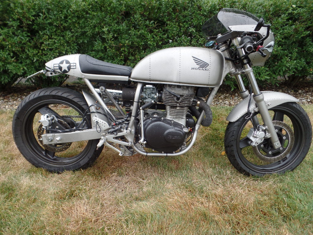

Hit my ankle joint while kickstarting one too many times. Does anyone know where I can find some foldable m8 foot pegs? (for dcc rearsets) I've only been able to find spring loaded ones that stay down, looking for ones that are able to stay up.
my buddy @ridesolo had the same issue on his 378. Idk what your mounts are like, but he put this little loop to hold the peg up. Simple solution that worked ok, maybe worth doing at least until you track down the ones you really want.
Yep, he's right. I've got some rolls of 550 Paracord laying around so I just knotted a loop into one of the heel guard holes and when I was going to kick it I made sure to put the peg up into the loop. The kick lever cleared the foot peg but my heel may not have and I could envision pain or breaking parts w/o it.
