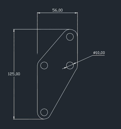

did a solidworks caliper bracket and hopefully have that water cut soon. will have to piss off the 90 series front tyre at some point and fit an 80. it just looks like a balloon.

caliper mounts cut! i like this waterjet business.
now i have to make up some "nuts" to go behind the original holes on the fork legs to mount the brackets to. individual nuts i'm not so keen on because even if i lockwire the bolts holding the brackets to the forks - more as a visual reminder to "don't undo these" i guess than a real safety concern - the nuts are another degree of freedom again.
last one i did i had some threaded blocks cnc'd up. you can see them with the cnc'd caliper mounts from the yellow monster. i can either get that done again, or maybe just weld a little plate between two nuts to make them captive and call it done. the price last time equalled the impressiveness of the part. it was somewhat eye watering overall getting a heap of stuff cnc'd

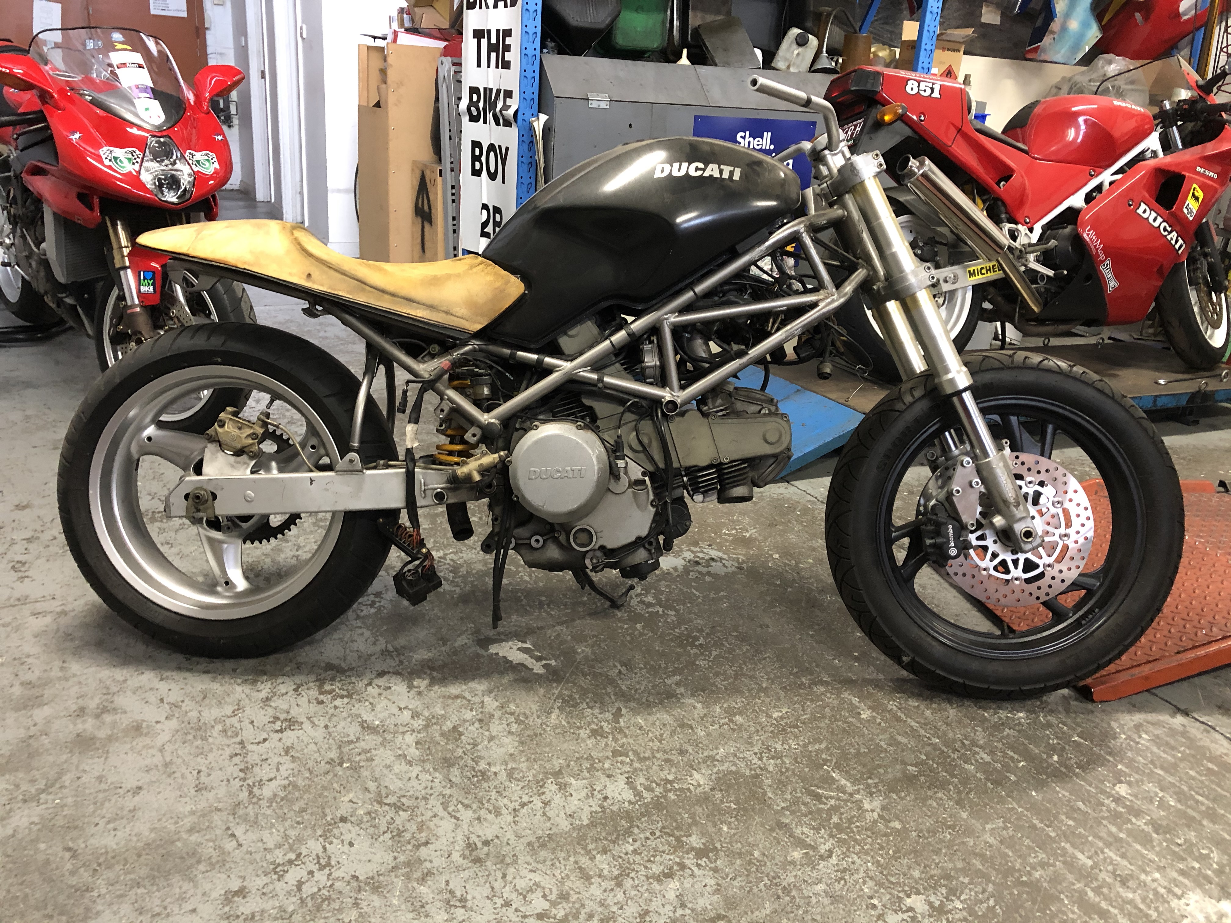

i finally got the shock back, shortened by 20mm. i found a spring that calculated at 13.7 in my stash so fitted that. it's got 9mm of preload fitted with the adjusters all the way up against the top section. sitting on it it didn't feel outrageously hard. i guess i'll find out at some point. it was pretty nice paint wise when i found it, but i was adjusting my press to get it in and compress the spring to get the lower retainer in and dropped the whole lot (bending my thumb back) because i was too impatient to just put it on the bench and make it easy for myself. so i've had a week of not being able to grab things too tight, and now have a scuffed up spring. yellow probably doesn't suit it anyway.
also fitted a caliper for a test. not sure if i like the look, but it's in there now.
the bottom of the seat doesn't follow the frame or tank line, so i think i'll hack some more off there too. will have to try to be neater there though, given it's visual.
heaps of work to do on it, but the 400ss is nearly done so it'll give me something to chip away at. i'd kind of like to leave it a bit ratty, but the lh engine case is cracked at the front engine mount, so it really has to all come apart and have that welded and i know it has a noisy 3rd gear and if all that is happening then it might as well get all painted / powder coated. i won't really have an excuse to run a black front wheel and silver rear then if everything else is refinished, but i'm kind of liking that combo. never been a fan of black wheels. not sure about the swingarm either - i'd like to leave it silver, but it might suit the overall better in black when the frame is black. and the frame really needs to be done - not sure if a clean up and spray will hide the fact it's been fairly seriously reworked at the front.
i'd really like to know what hard anodising looks like too, so was thinking about having the fork tubes done - that'll get rid of the gold and sun faded variations thereof. maybe the lowers as well - they've got some crash damage i could rub off and hide that way. but then it all has to be nice, and that always costs me a heap the way i do it.

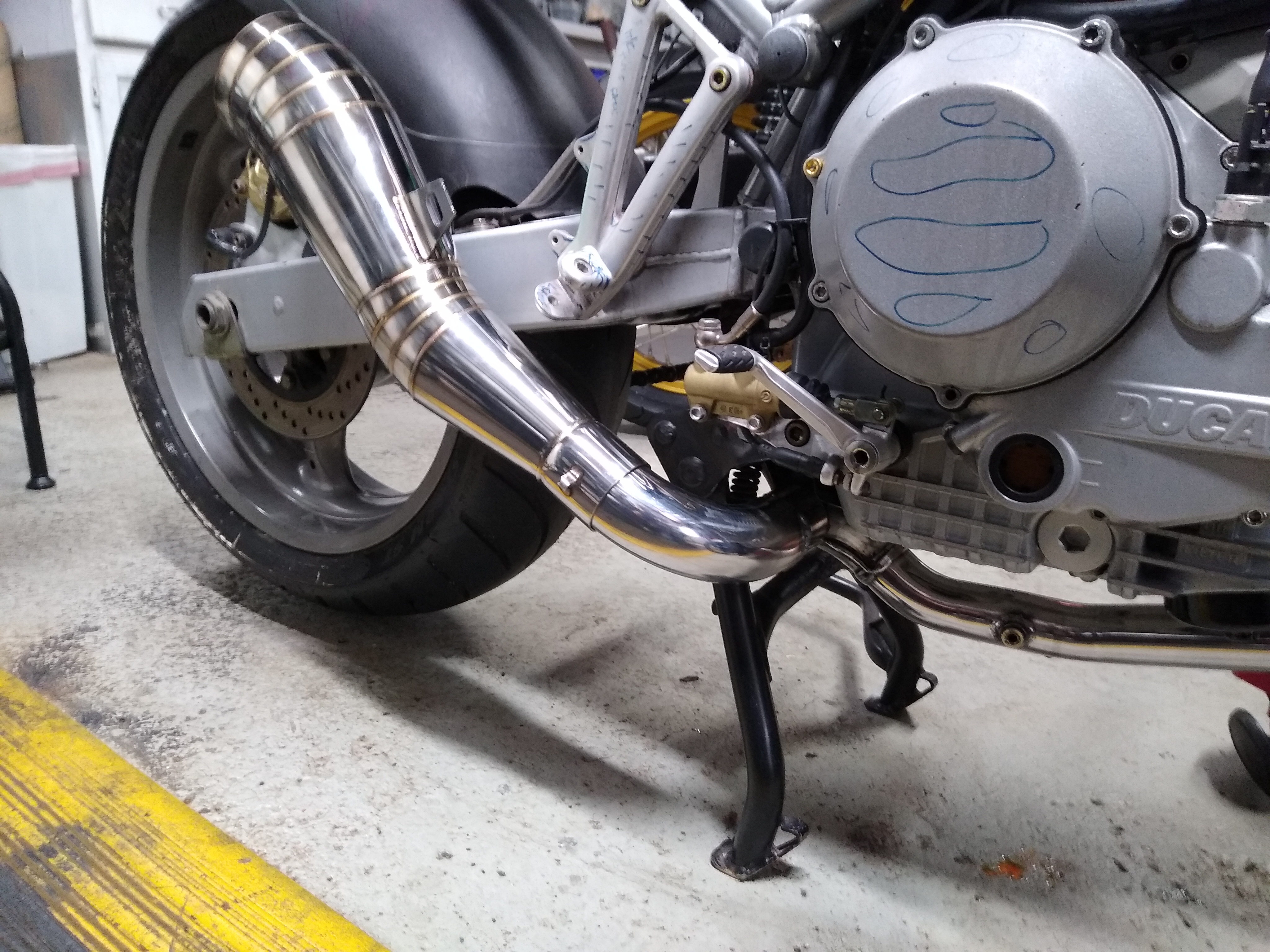

got an mts 620 exhaust system, with the horizontal header that runs down the rh side of the engine under the primary drive cover for a starting point. not sure if i want to run mufflers below the swingarm or angle up past the swingarm. and if it'll be one each side or 2-1 on the right. might be easier than working around the stand on the left. and if i run the mufflers horizontal and below the swingarm, maybe i should go to a low rear caliper so it hides behind the muffler. this is sort of the inspiration -
used a clamp to try footrest positions too - seemed ok at the flat bar section. round adjuster was too high.
