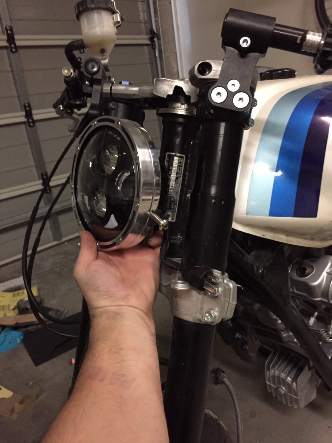

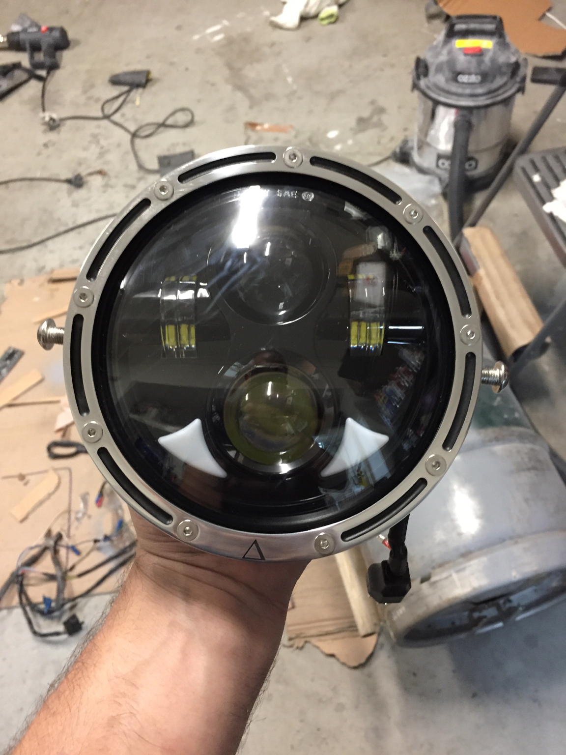

Well I’ve got myself a sweet light but I’m still need an old school bucket to house it, I think it will be just a little too sleek without it

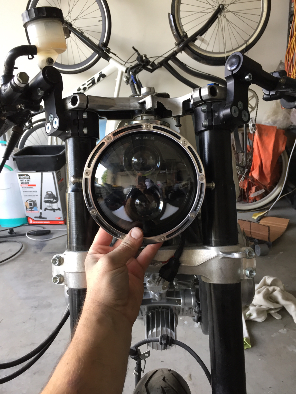

Love that light and I love the custom faring but curious and always been a fan of a simple fly screen
Hell yes to that light. Does it have a halo ring around it? Or integrated indicators? I'd love something like that for my CB750 one day, would you mind sharing where you got it, or what brand it is?
Edited - Doh, clue was in the photo :-X
Is that the 7" light you got there?
And yes on the bucket!
Or set it into your rectangular fairing?
It was actually the 5 3/4” I was going to get the 7 “ but after seeing that and speaking to Jimmy at Kustom Kommune I decided 7” would be too big for what I wanted.
There is no Halo, and what looks too be inter grated indicators is actually two little directional driving lights that shine down on the road directly in front of the bike.
I have handlebar indicators, still to be installed.
The brand is purpose built moto, Kustom Kommune stock it also, and their stuff is really high quality but far cheaper than say moto gadget ( the range is a little small but I dare say it will increase. I actually saw their handlebar switched just after we had made ours and they are really cool, maybe on the next build) was
Unsure bucket or fairing leaning towards bucket of I may powder coat the outside ring of this light as it comes off, potentially gold like the rims or I may even see if I can sand it back to silver

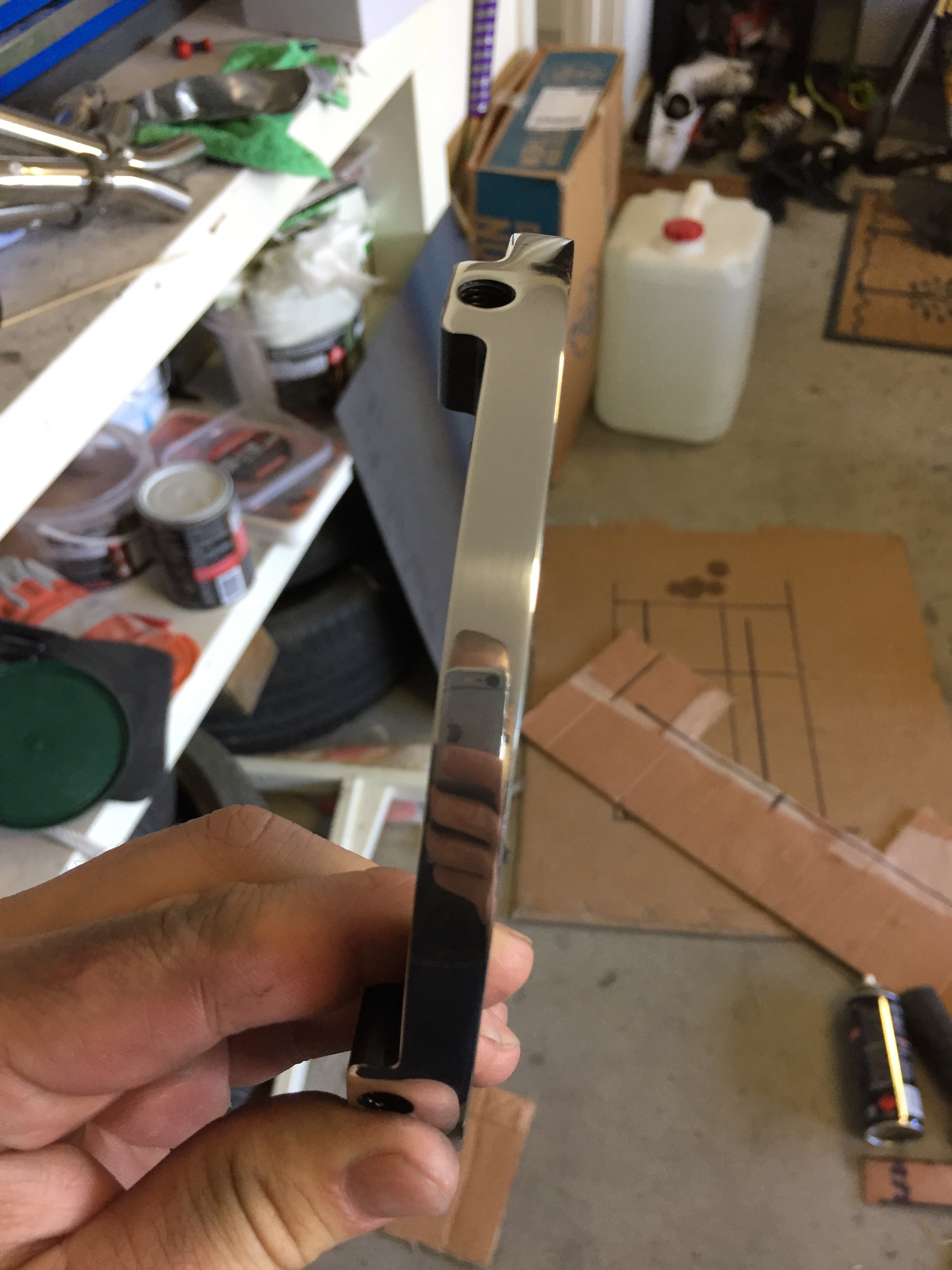

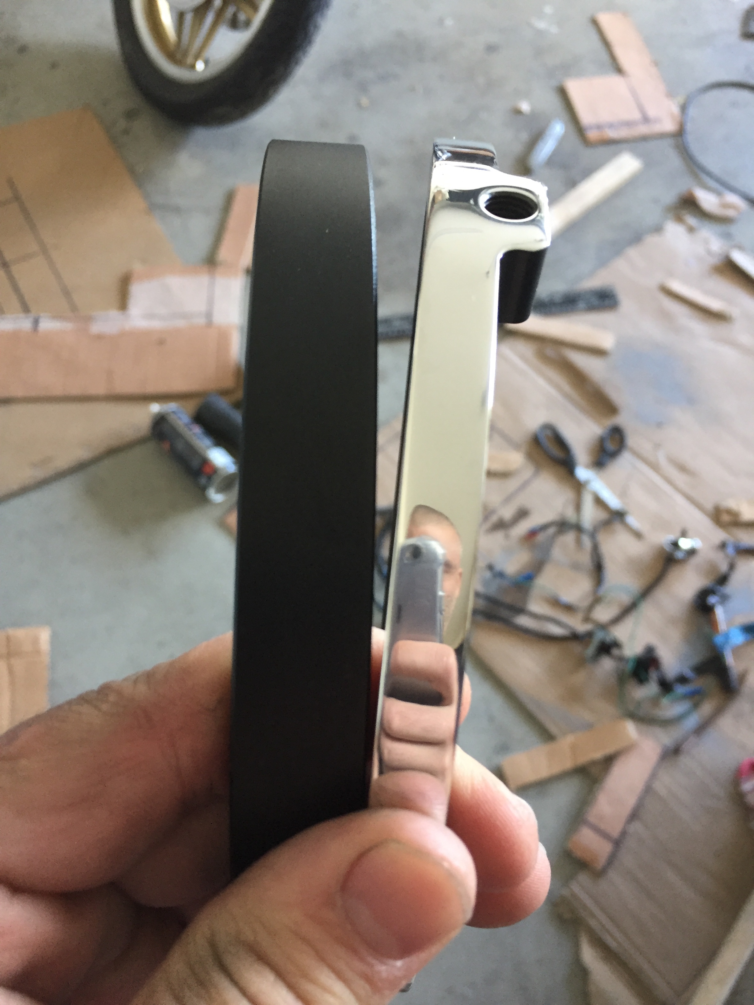

Just ordered these brackets, unfortunately they will arrive while I’m at work.
Oh well it will probably be a final day of cleaning the shed up and packing it all away for another 6 weeks

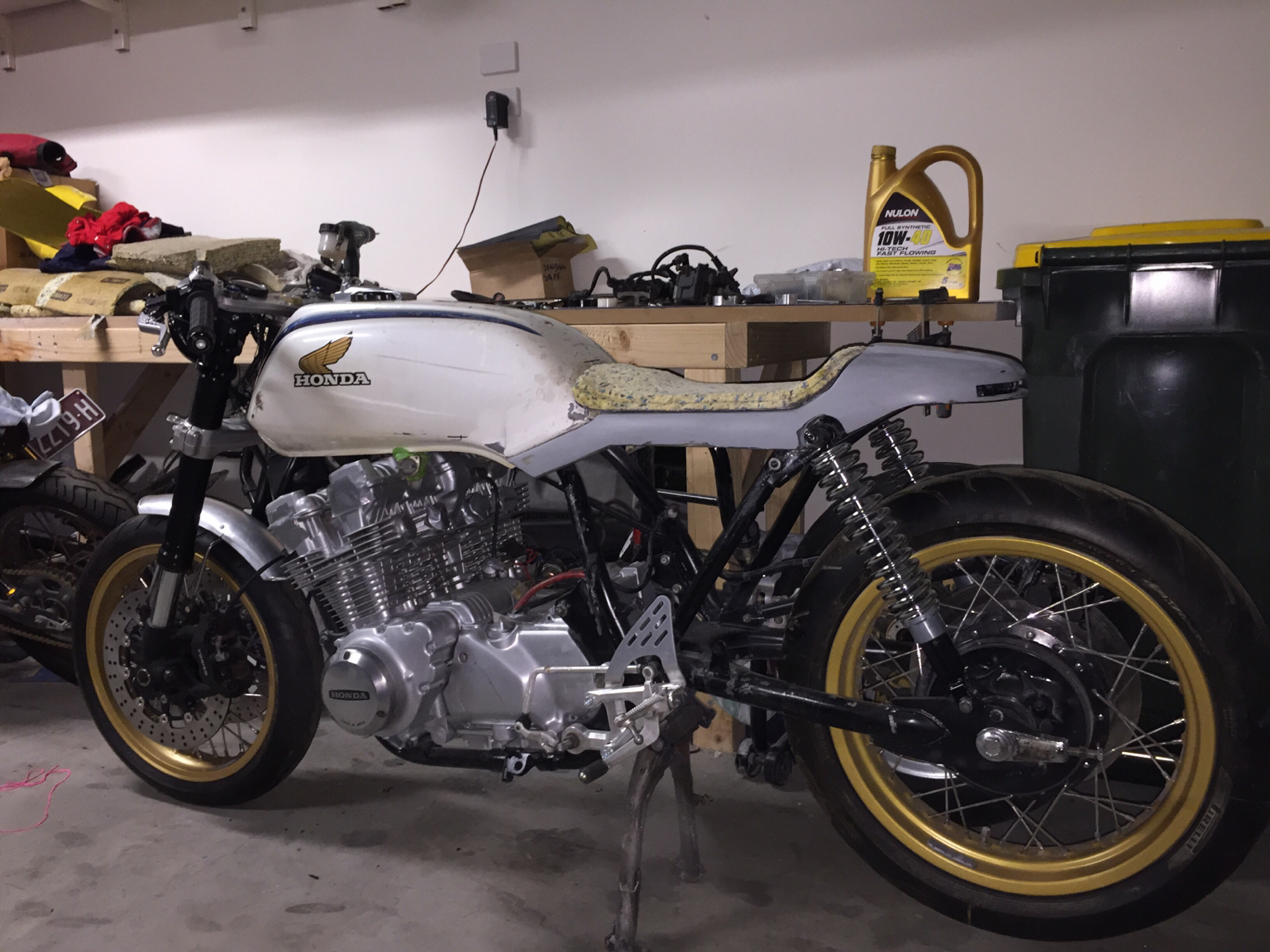

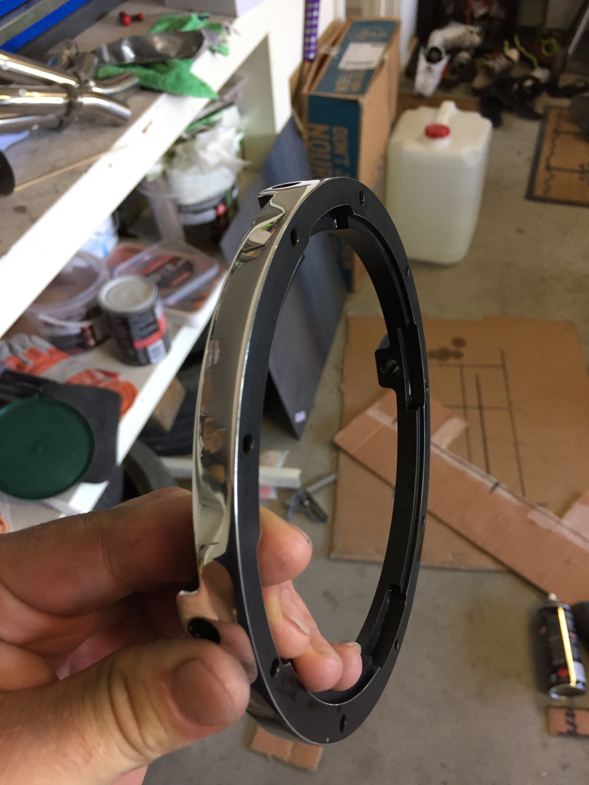

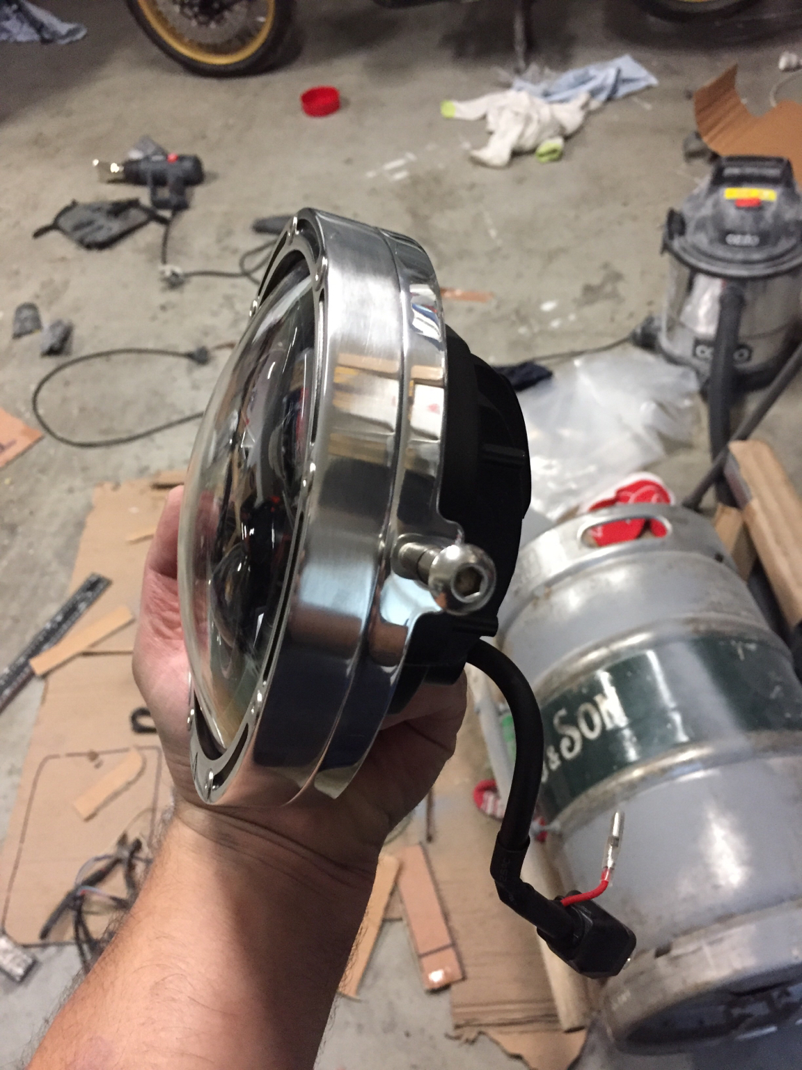

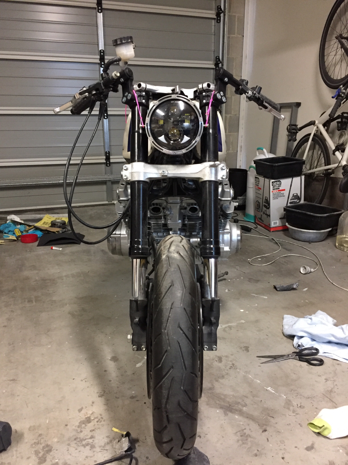

So with a whole help of sanding and polishing, I managed to make a good thing better (in my eyes )
I started by sanding the backing section of the headlight mounting ring to see how it would come up silver
Then I gave it a polish came up alright so I continued with the front section
Once it was all done I did a little mock up with some pink string which I thought looked rather sporty

stroker crazy said:
Looks much better, but I don't know that the pink string is on trend …
Crazy
Pink string is making a big come back I’m sure of it, a lot of quality bike builders are realising the true potential and versatility of pink string... won’t be long now and you’ll be seeing it used on all of the BOM winners bikes

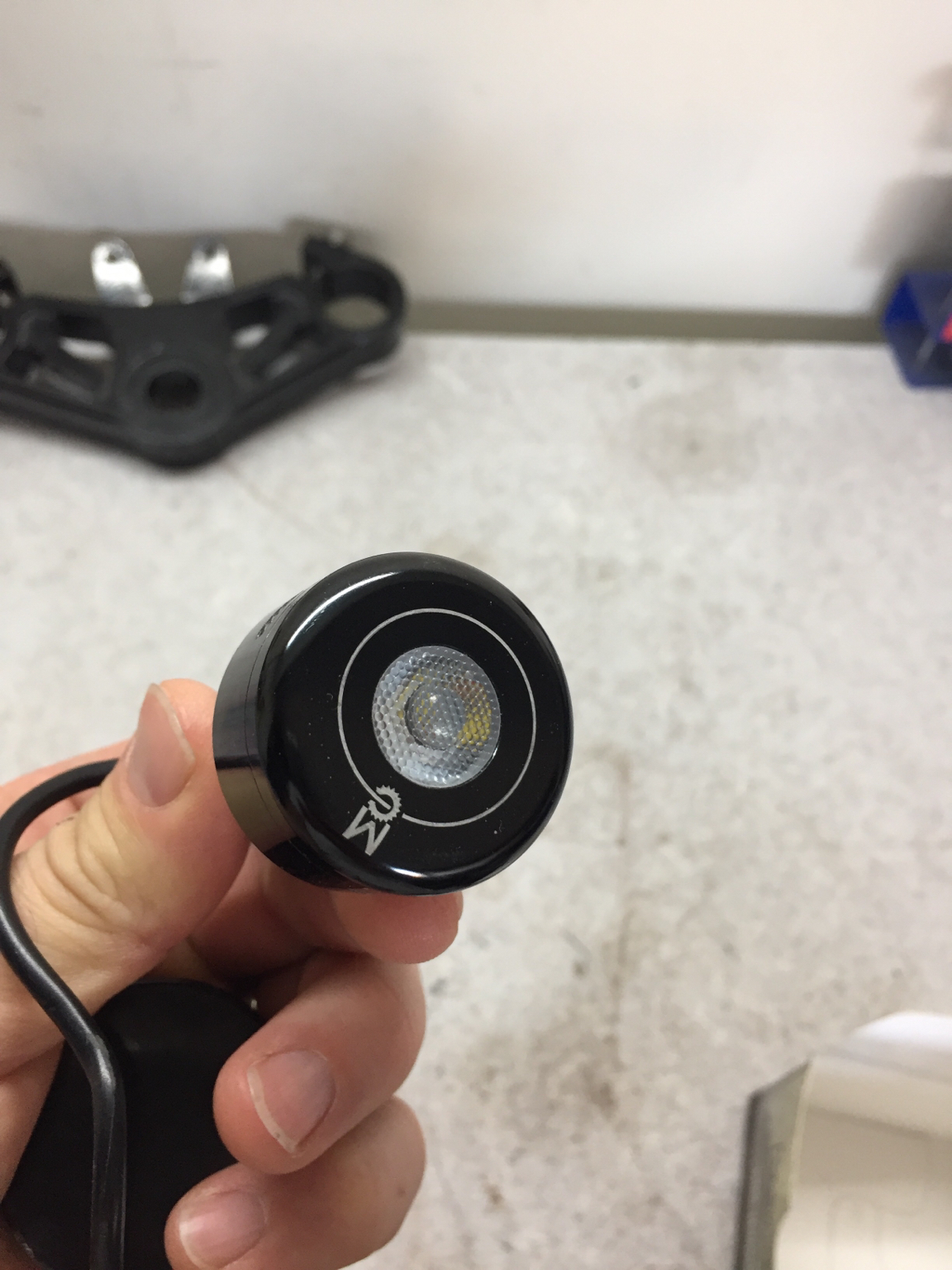

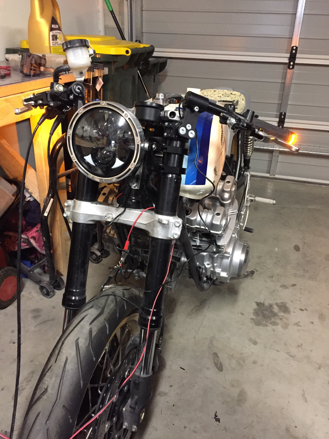

So I thought I’d try to install the Morimoto led handlebar lights.
While I love the moto gadget gear I wasn’t prepared to sell my kidney just yet to purchase it.
So my plan was to drill out the plastic stopper in the bar end and insert a rubber Gromit then run the electrical wire through the bar end.
Unfortunately what I didn’t count on was the fact the plastic stopper was about half an inch thick
So I had to run with plan B, which was to install the electrical wires without the rubber.
I cut some string and ran it through the hole with the intention of using it to pull through the electrical wire. Being a little slow, I forgot to tie the other end off. So as I tied one end to the electrical wire i pulled the other end of the string back through the handle bar end.
That was the first time, as I attempted to pull the first one through the electrical wire slipped out of the string so I repeated the process until it was successfully through.
Then once I attempted to do the same with the right hand handlebar I realised the rubber tubing that was provided to wedge the handle bar end in was a larger external diameter , I searched the garage only to find one that was too small.
After a quick trip to the auto shop the guys they gave me some hose on the house I was pretty stoked. Then I finally completed the instal
I hooked up some power to see how she looks came up alright

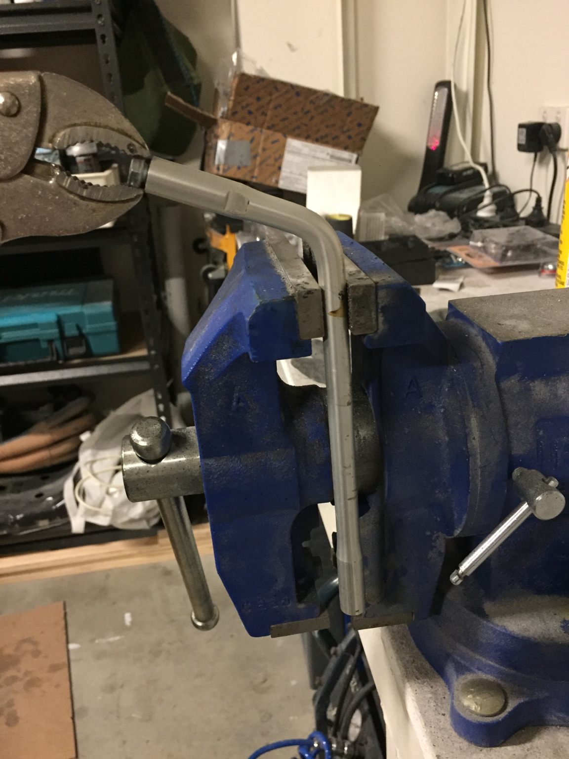

So next on the list was to bend the original R6 gear linkage to marry up with the gear selector.
I got out the MAPP gas and gently heated the aluminium before bending an angle into it
After two bends she was ready to fit
FYI it doesn’t take very much to get the aluminium hot enough to bend

The constant gotcha moments of custom building :) Nice work on the turn signal install!
Rearsets and linkage look really good. Does heating aluminum enough to bend affect it strength wise? Not that pushing the gear position up and down is a lot of force, just curious.
I don’t think overheating it is particularly good as it can result in cracking, aluminium doesn’t change colour like steel. I would say I heated it for a minute maybe two before bending it.
Like you said the force to change the gears is very low.

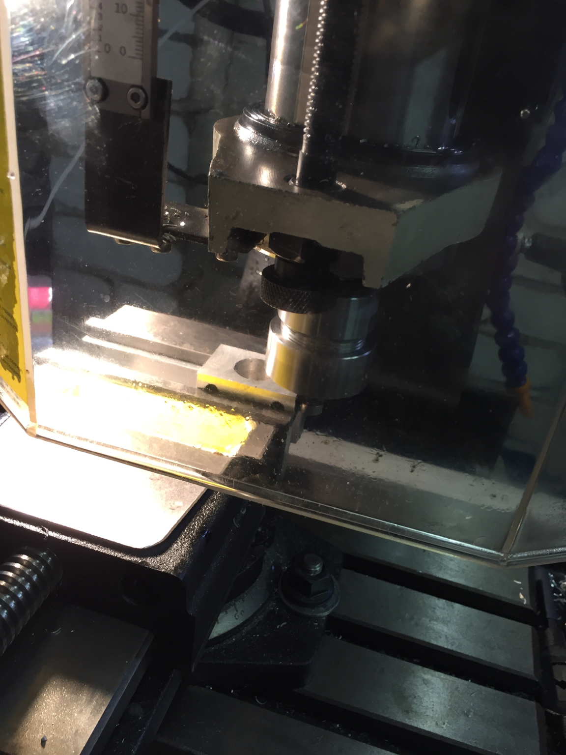

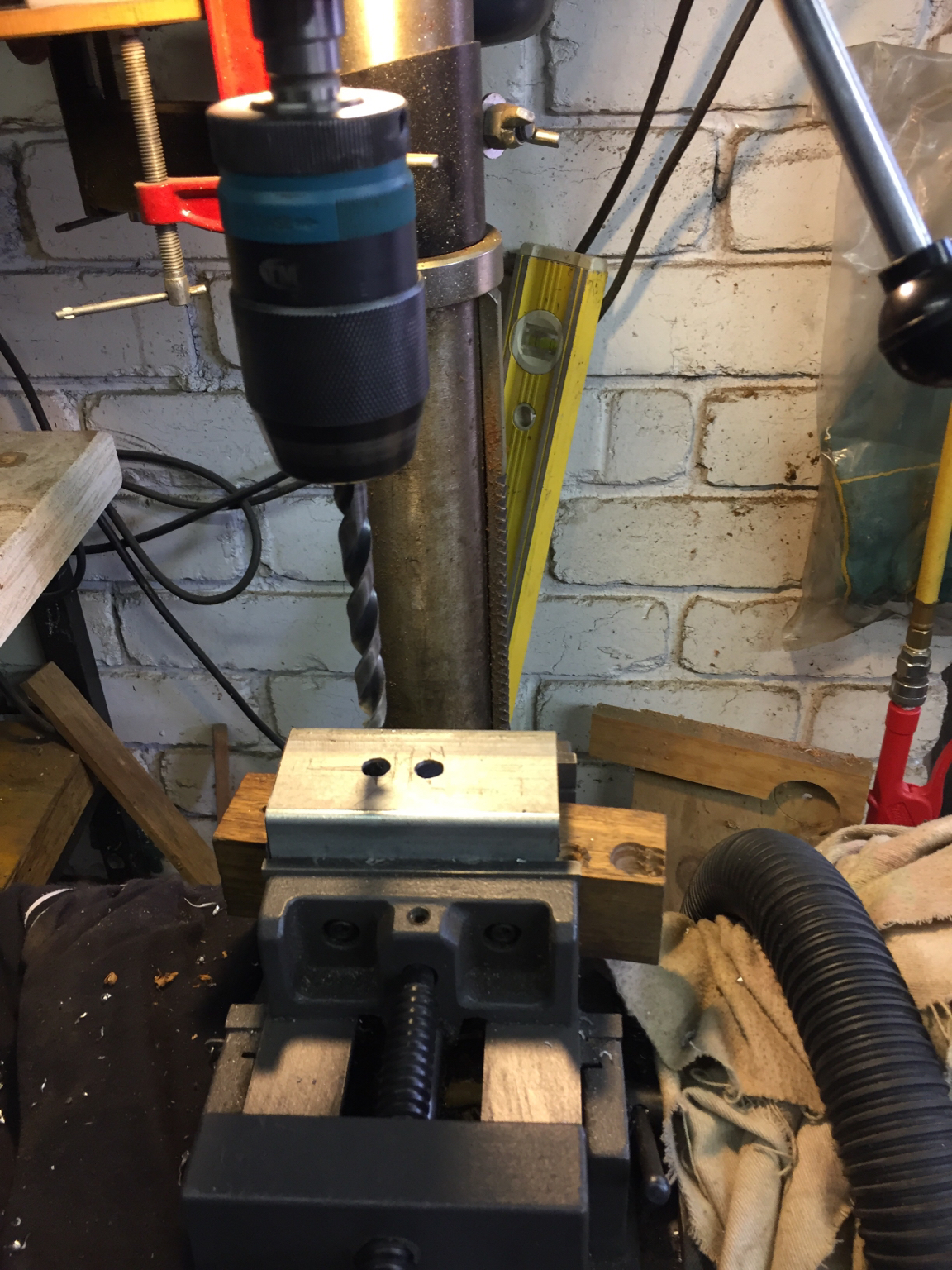

So today made a few more runs in the shed with my old man.
I removed the front end and brought it with me along with the tank, seat cowl and right handlebar

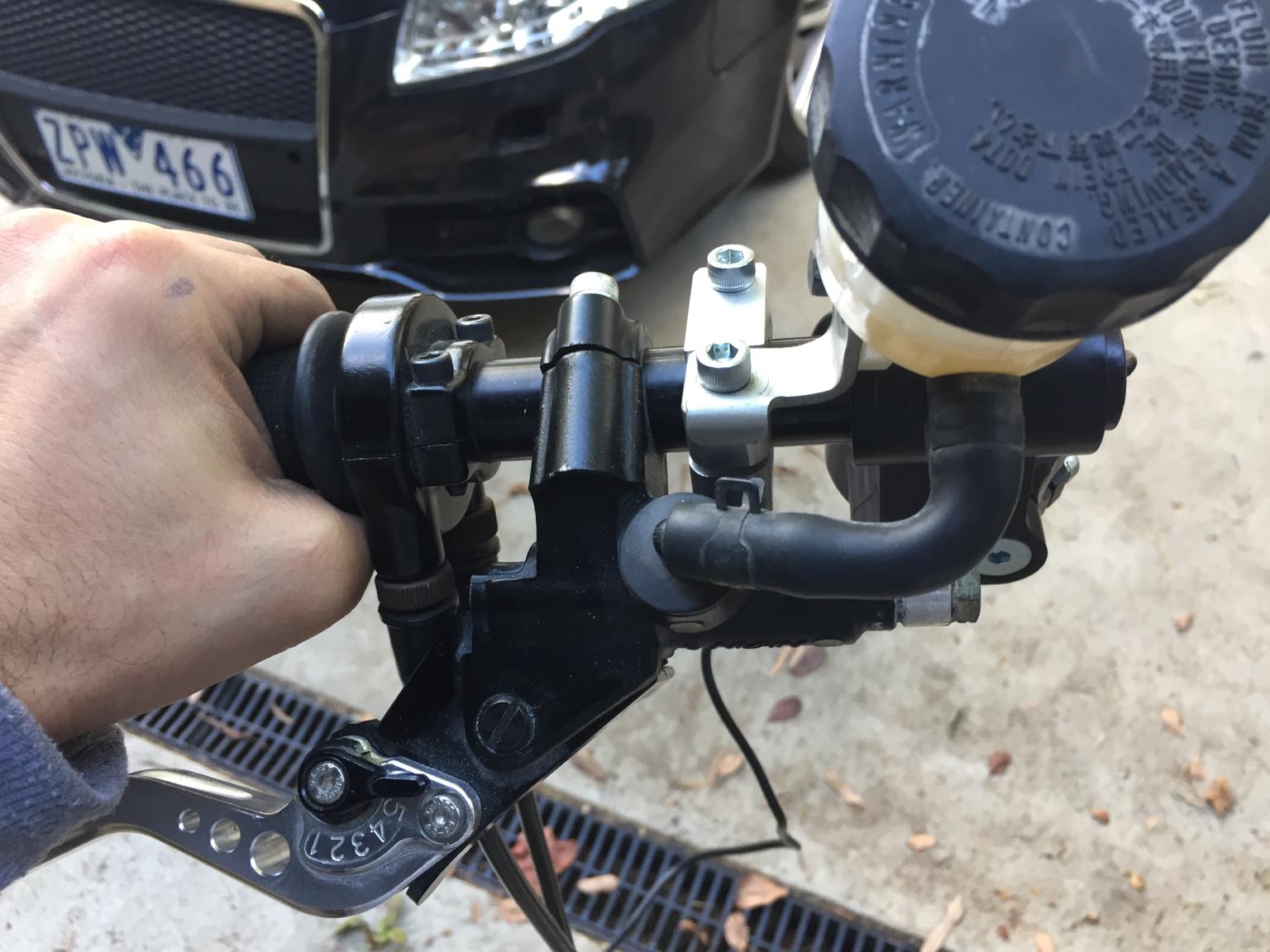

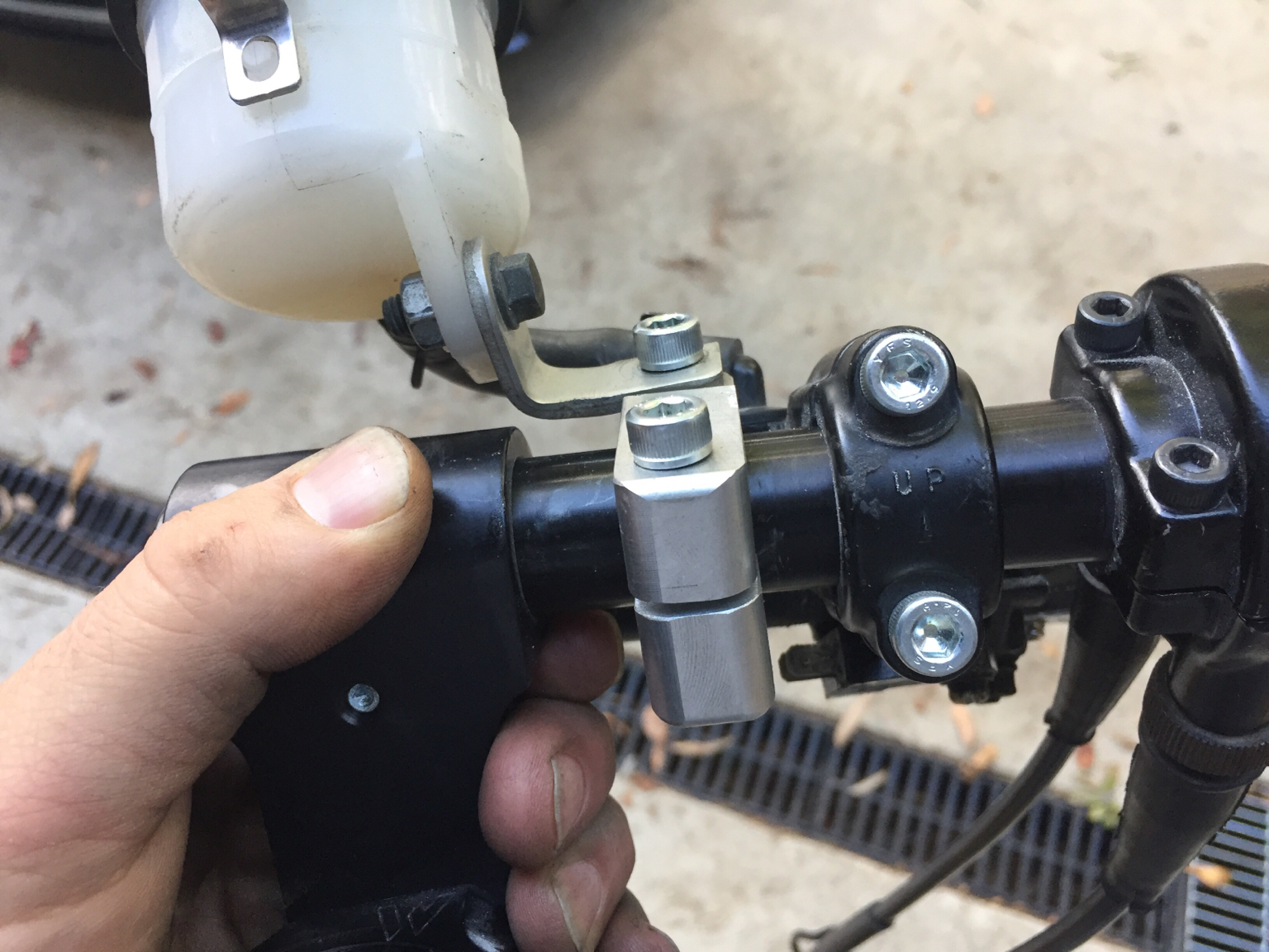

First job the old man turned up a bracket for the brake reservoir

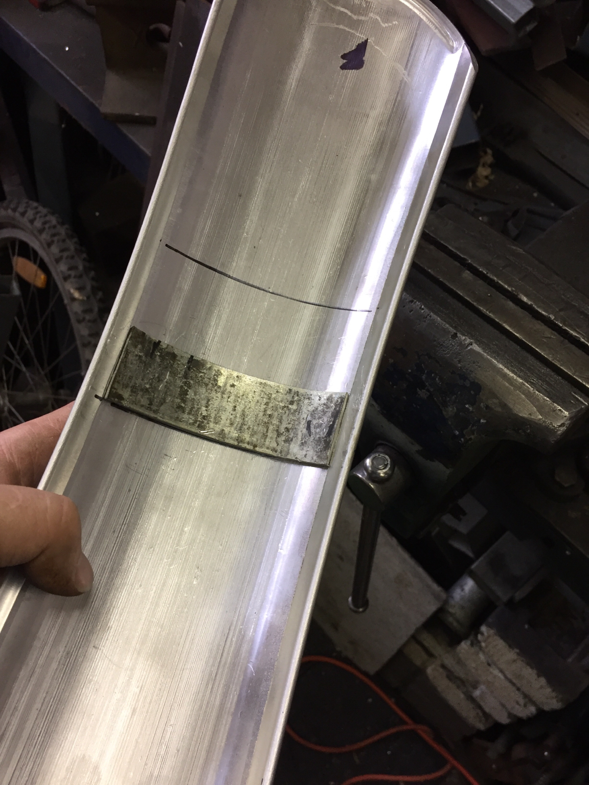

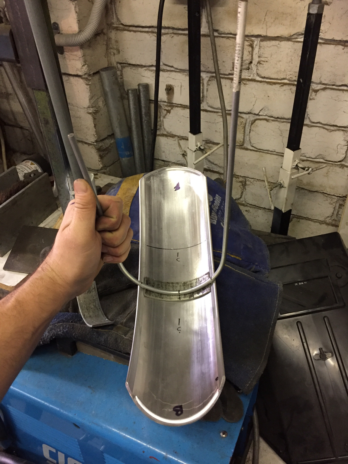

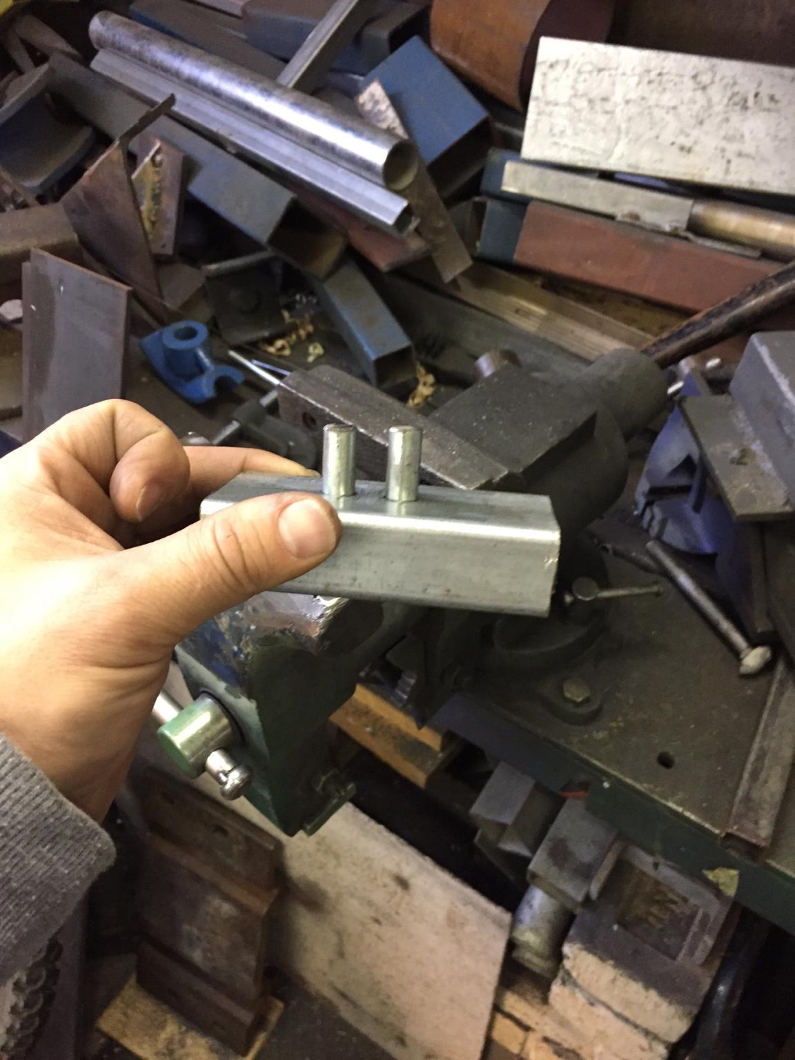

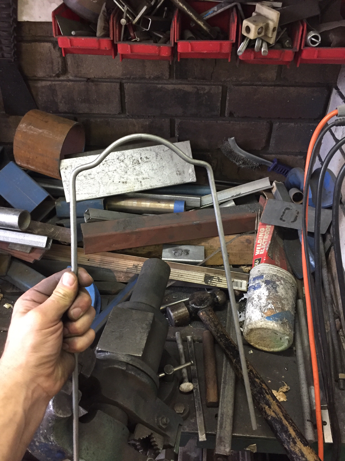

The next job I tackled was fabricating the bracket for the front mud guard.
First I bent out the flat bar that would run along the inside of the mud guard. Who would of thought bashing out the flat bar would be so challenging, probably would have helped having the right tools. But a builder must Magyver when necessary so a piece of railway iron did the job.
Realising that I was going to need to bend the metal rod. I made a jig using some box tube and some 10 mm rod in hindsight I should have put in 3 pieces of rod.
It took a while to get the rods bent into the correct shape once done we tacked it on to the flat bar, then dad turned up some round mounts to weld on the ends so we could run bolts through.
Once done we drilled through the bracket and mudguard and put one pop rivet through, then I had to head home to put it back in the bike just to make sure the guard was straight. Tomorrow I’ll finish off the rivets. I’m thinking once it’s done I’ll spray it all mat black

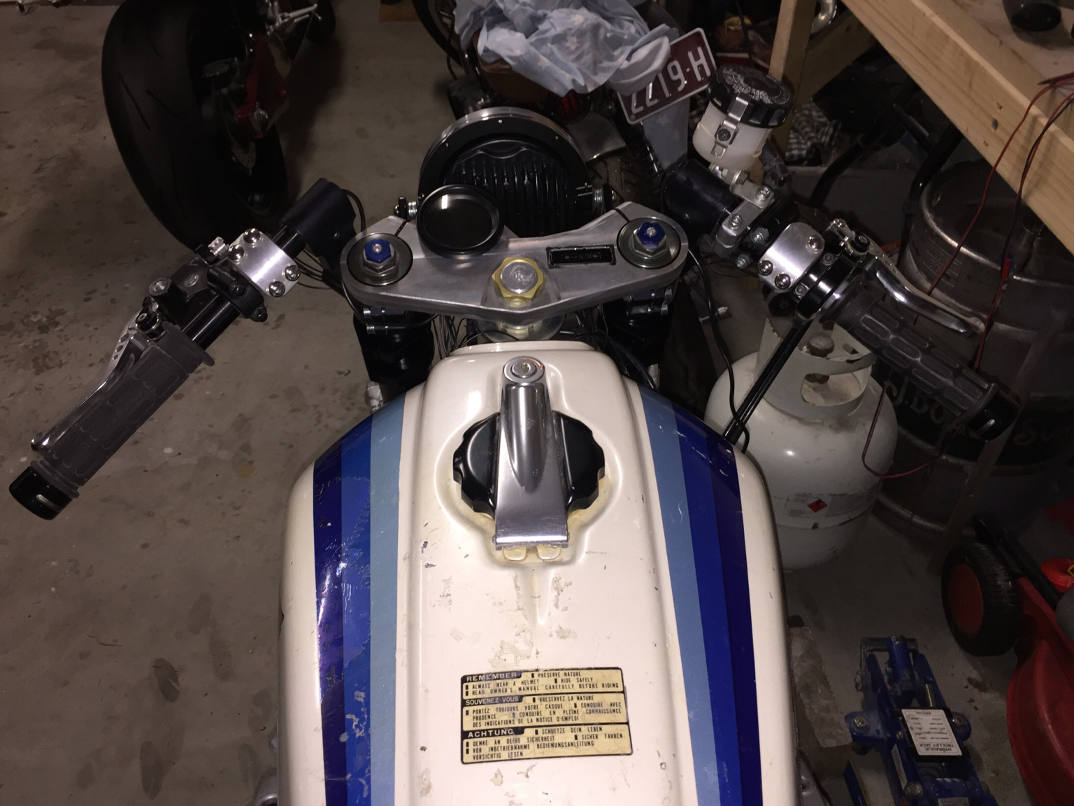

My brother made up some prototypes for my stickers.
Still need to make up and fit the blue stripes before making the proper decals, probably take about two weeks before it’s all ready
Looks like the respray will happen next break, should give me plenty of time to strip and prep the tank.
