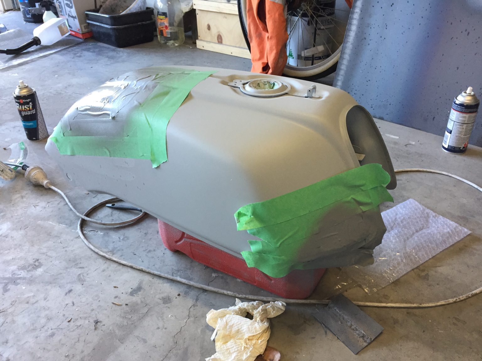

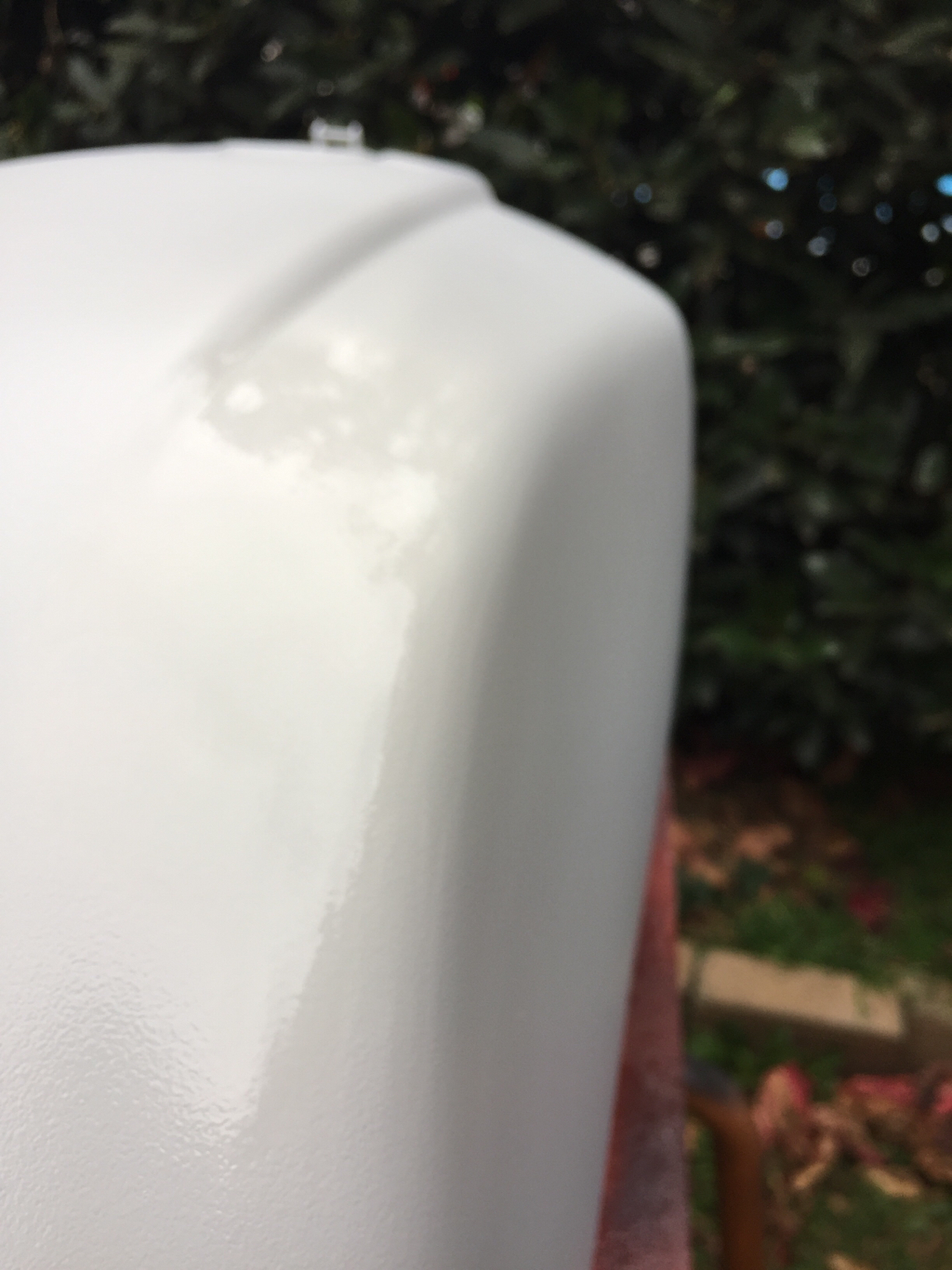

If you've got your tank dents very close you might just want to try some high-build primer on them. Much easier to sand than filler and with it all being the same material it's very easy to shape it correctly. I would, however, be a little concerned about the etch primer behaving that way, something not right there. They don't look like humidity blisters though...
Edit: sorry, half asleep last night. Etch primer should be just a light coat sprayed over the whole surface, you need to use normal primer from here on in.

I hit it with some light sanding, cleaned the area, prepped it with wax and grease remover let it sit. Then I hit it with the etch primer then it came up good, go figure.

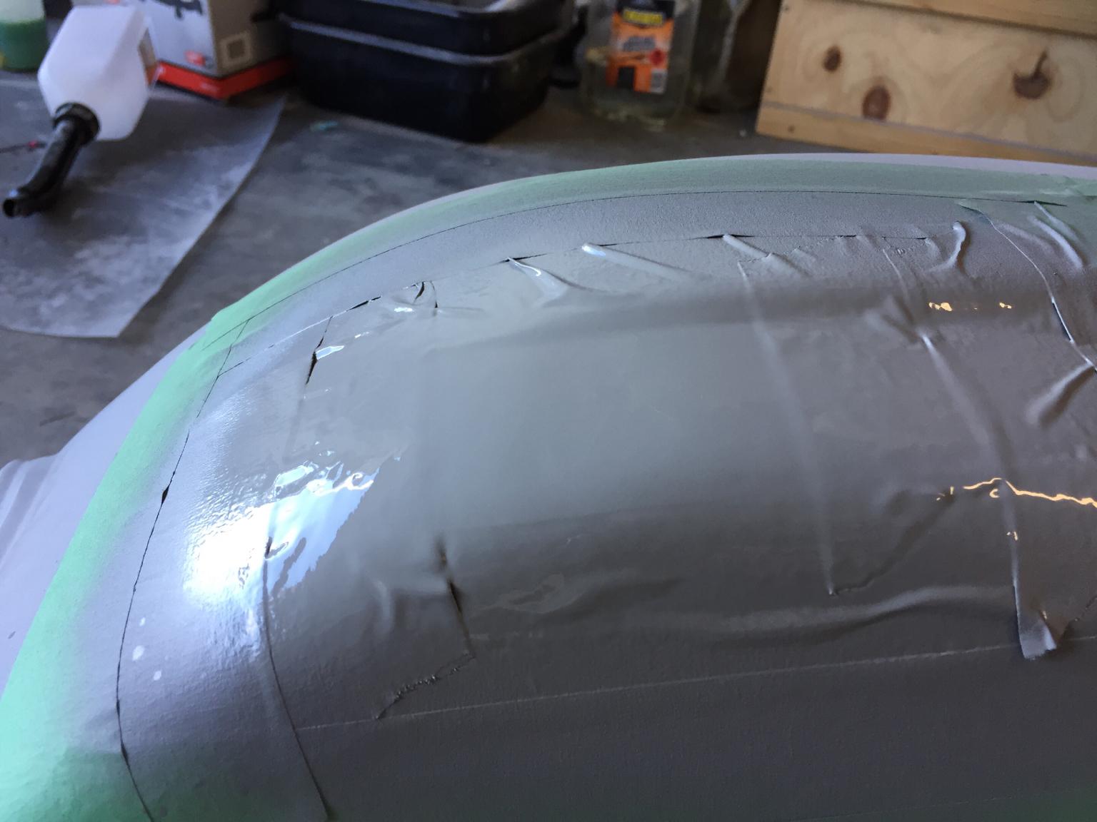

I masked up the two other areas of concern, including my east west dent and then hit it with coat after coat of spray filler.

Yep, I'm thinking tears too.
Just a question, why did you mask the repair areas? You'll have a big ridge that you'll need to sand off flat afterwards. Not a problem at all, just more work for you.
Well my mask and spray filler attempt was poor at best. I think there was not enough time left in between coats, this caused it to laminate.
Bit of a catastrophe resulting in me having to take it all the way back and in the process I’m pretty sure I took even more off the east west dent. I then used normal filler to build it up and pretty much got back to the place I started from kid of like catching a bus on a round about and getting off where you got on.
I even used a long block hoping it would be touching both high sides of the tank so as not to sand the filler too low, but somehow I managed to do it.
The little dent I’ve managed to save so that’s one less thing to deal with. Tomorrow I’ll wake early and try to spray the filler a little at a time see how I go with the notorious east west dent.
In hindsight, I probably should have just sprayed without it why is it that these things are so clear in hindsight?
Haha, everything is clear in hindsight.
You should put your spray putty over the primer, and in very light coats with plenty of drying time in between. I think you're better off with primer/filler, or high build primer, if you can get some tomorrow, and lay that on once your dents are close.
I usually get it close with bondo/filler, then use a little spot putty/glazing compound if there are pinholes etc, then sand that out then finish with high build filler primer and can usually get it spot on. That is when it's for someone else, when it's for myself I give up at "that's good enough" LOL.

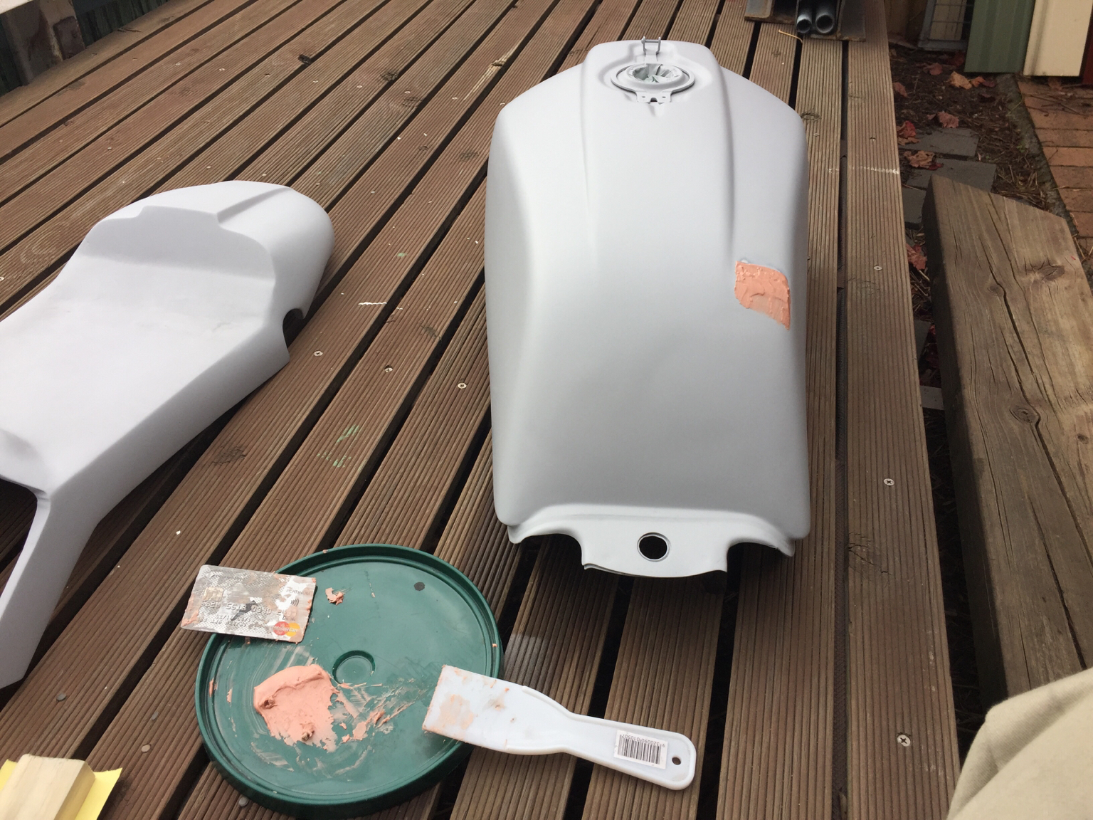

I'm no means an expert, but I have successfully done some rattle can painting. I think etch primer goes on bare metal to chemically etch it for adhesion. I think it's an acid that creates the etch and I don't know how this would work in layers. I think it's etch primer to the metal and then regular primer after that.
For body work, I don't rely on my eyes but on my hands. When I get close, I close my eyes and try to "feel" the dent. If I can't feel it, I stop sanding immediately regardless of what it looks like. I repaired several dents in a car fender like this and then painted it dark red. You couldn't see any remnants of the repair.

So this is what the east west dent looked like,
So after I put some dianese leather treatment cream onto the upholstery I packed up ship and headed to the old mans.
I had a funny feeling things were not going to come together how I wanted today. I was late away this morning, a major arterial through the city, causing me to take a “short cut” through the city where there was a protest going on. Making a 45 minute trip into a 2.5 hr trip.
After arriving I once again sanded the tank back then put some filler on, in my eagerness to make up for the hour wasted I began sanding too early. The filler was not yet fully cured making it come off in chunks, so once again I sanded it all back
Then I followed the advice from jpmobius and used a 240 grit paper instead of 600, then PDub I used my finger to feel her out once she felt good I hit it with the primer and boooom
I felt as if I had cracked the Da Vinci code, unfortunately by this time it was late afternoon, the winds had picked up and the grey clouds began to come in so we called off spraying. No point to rush it and stuff t up now.
