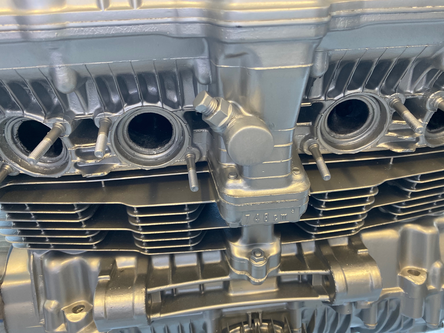

If you aren't going to use the tach drive anyway, why not get OMM to remove it from that cam cap and make up a plug for the valve cover. BTW, I had a similar looking plug every 20 miles on my GL1000 and it turned out to be the needle jet wallowed out.

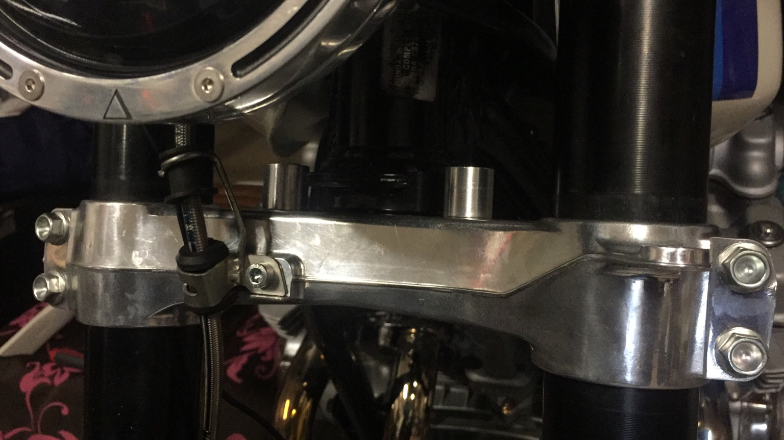

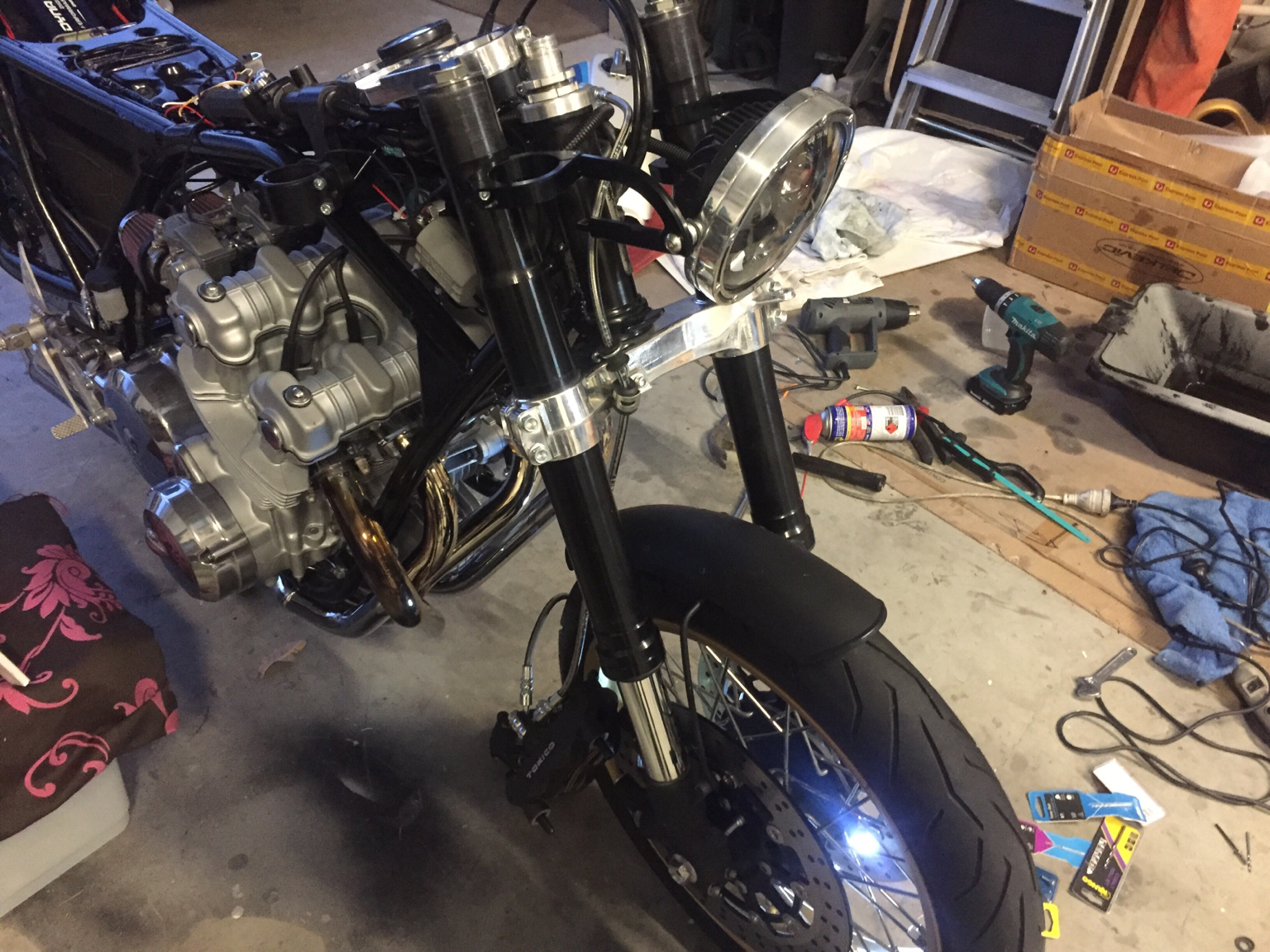

After a failed attempt to cut a slot across the too of the Allen bolt, I ended up getting the bolt with an easy out.
Once that was done I was able to remove the light mounting brackets, triple and handle bars to allow me to slip out the forks and gain access to the lower triple.
When I slipped it all out and looked back at the bike I felt as if she was all undone, I turned my attention to the lower triple. After using a centre punch I drilled a pilot hole into the triple unfortunately the drill bit broke in the second hole. As luck would have it about 1.5 mm was sitting proud of the hole, after a few swear words I was able to use some pointy nose pliers to persuade the drill bit to come out before drilling with a 6.5 mm bit.
Once that was done I tapped out the two threads and then installed the steering stops before putting everything back in its place.

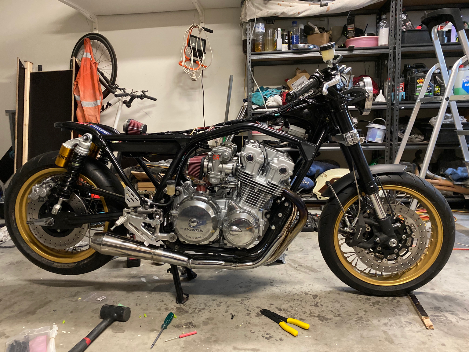

Did a test run with the tank on and the work as intended. I’ve called it a night tomorrow I will go over the whole front end and re torque everything up before taking her for a proper bust... here’s hoping for more good weather

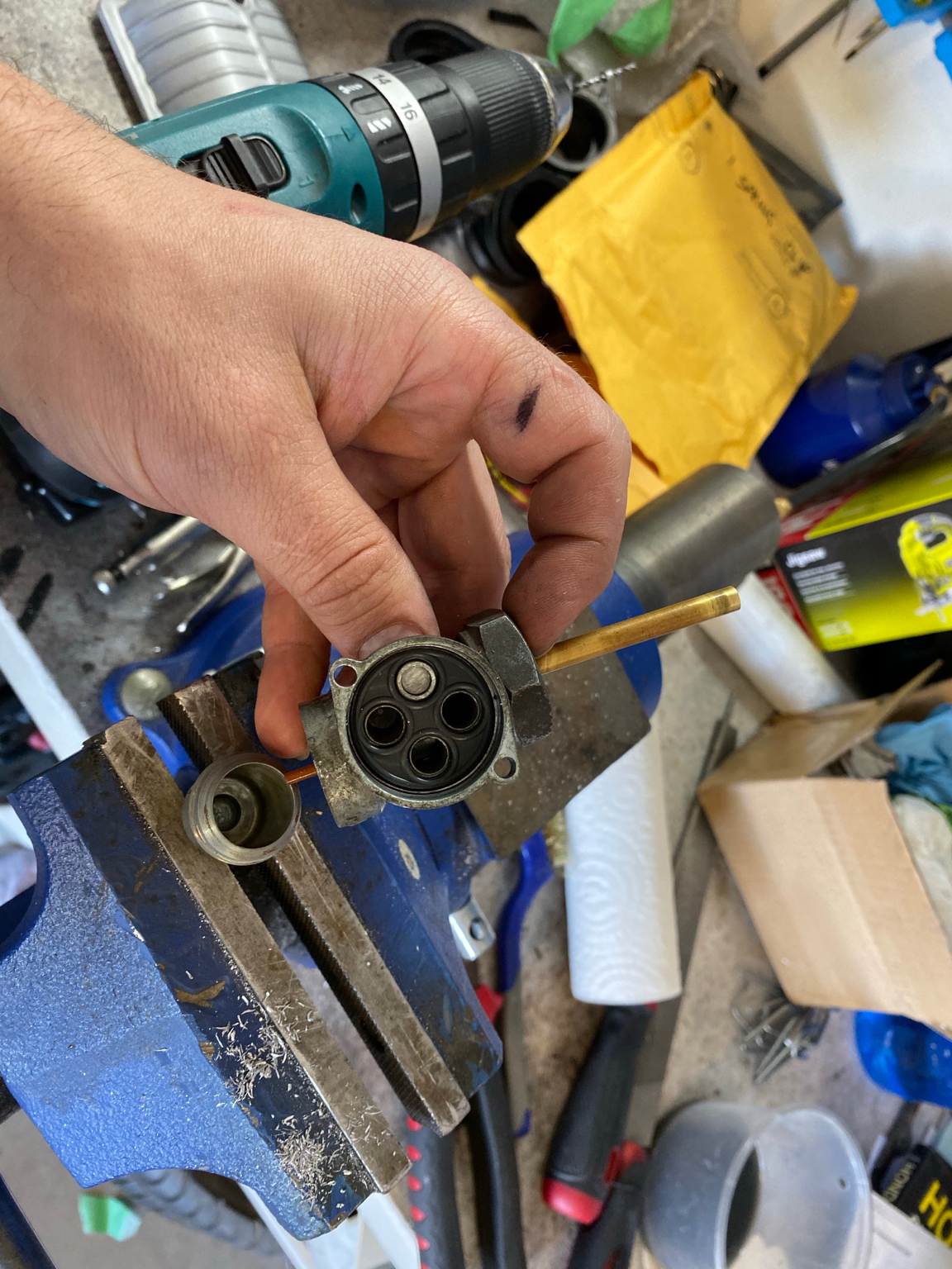

Well turns out the petcock wasn’t closed properly yesterday and it filled the carbs to the point of it leaking out onto the gearbox and then onto the floor of the garage.
That was inconvenient but the worst part was realising the paint for some reason hasn’t cured and petrol ate straight through it
So after a series of F bombs and C bombs and some more F bombs and some pacing and a few more F bombs. I mopped up any residual spill, and have now resided to the fact, that when I come back from work I’ll have to take the motor out; to first strip the paint then repaint it.. also I’ll be ordering a new petcock argh nuts
On the flip side I know that a petrol soaked rag should strip the paint right off, other than brooding over it there is not much else I can do this break as I fly out tomorrow morning.
As long as I don’t Dilly Dally around when I come home I should be able to get it all done in a week. I’ll have to get someone to help me with getting the motor in and out as I don’t want to add to the scratches I put on the frame last time I put it in.

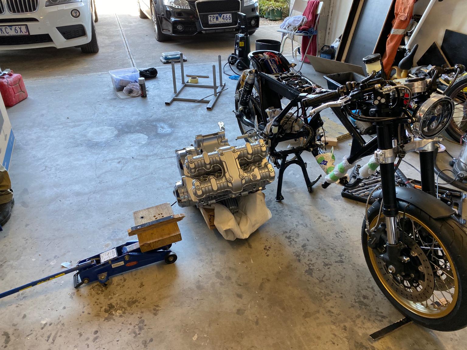

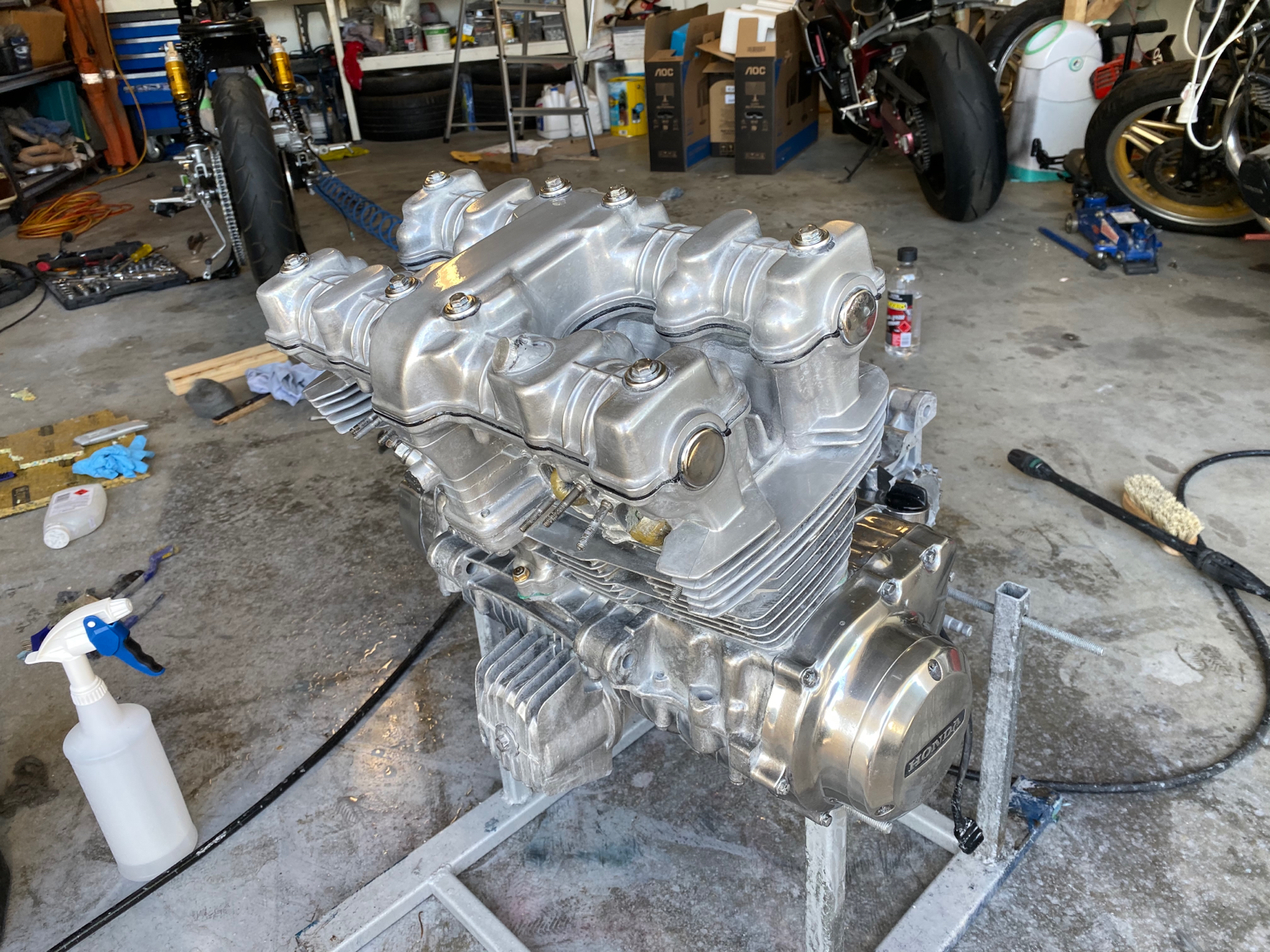

Well here we go again, thanks to Oldman Murphy and the wifey managed to get the motor out and back into the stand.
Next step wipe down with petrol to strip all the paint , then use oil and gas resistant paint before putting her back together again.
Hopefully I can get all this done in the next few days then hopefully off to the mechanics next week.

Old Man Murphy paid me a visit today and helped me get the motor back in.

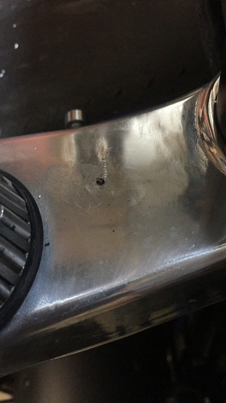

While the motor was out I thought I’d have a try a patching up the leak that was coming out from where the front cam tensioner bolt is. I used some JB weld and tried to make it look reasonable.

Next we manoeuvred the engine into place using a wooden stand we jerry rigged to stay in the jack.

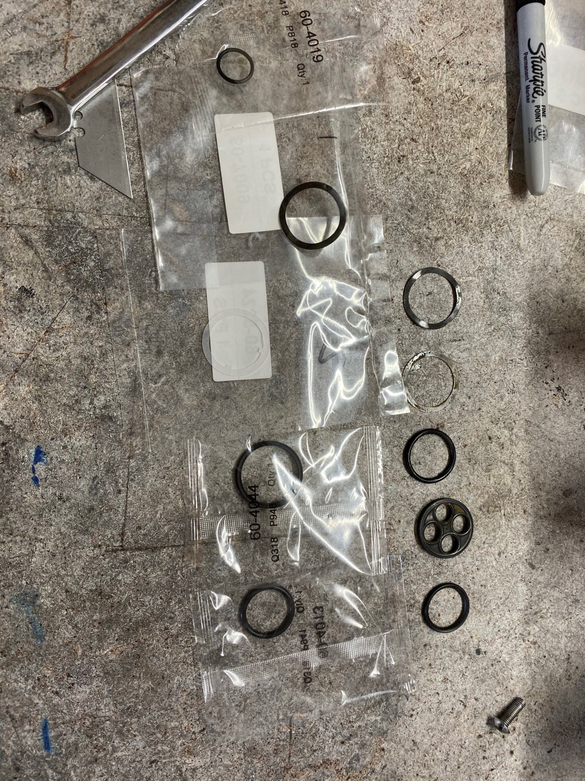

As OMM was leaving I checked the mail and found the all ballz petcock seal kit, so fingers crossed she doesn’t leak, and if it does fingers crossed this paint is actually fuel resistant.

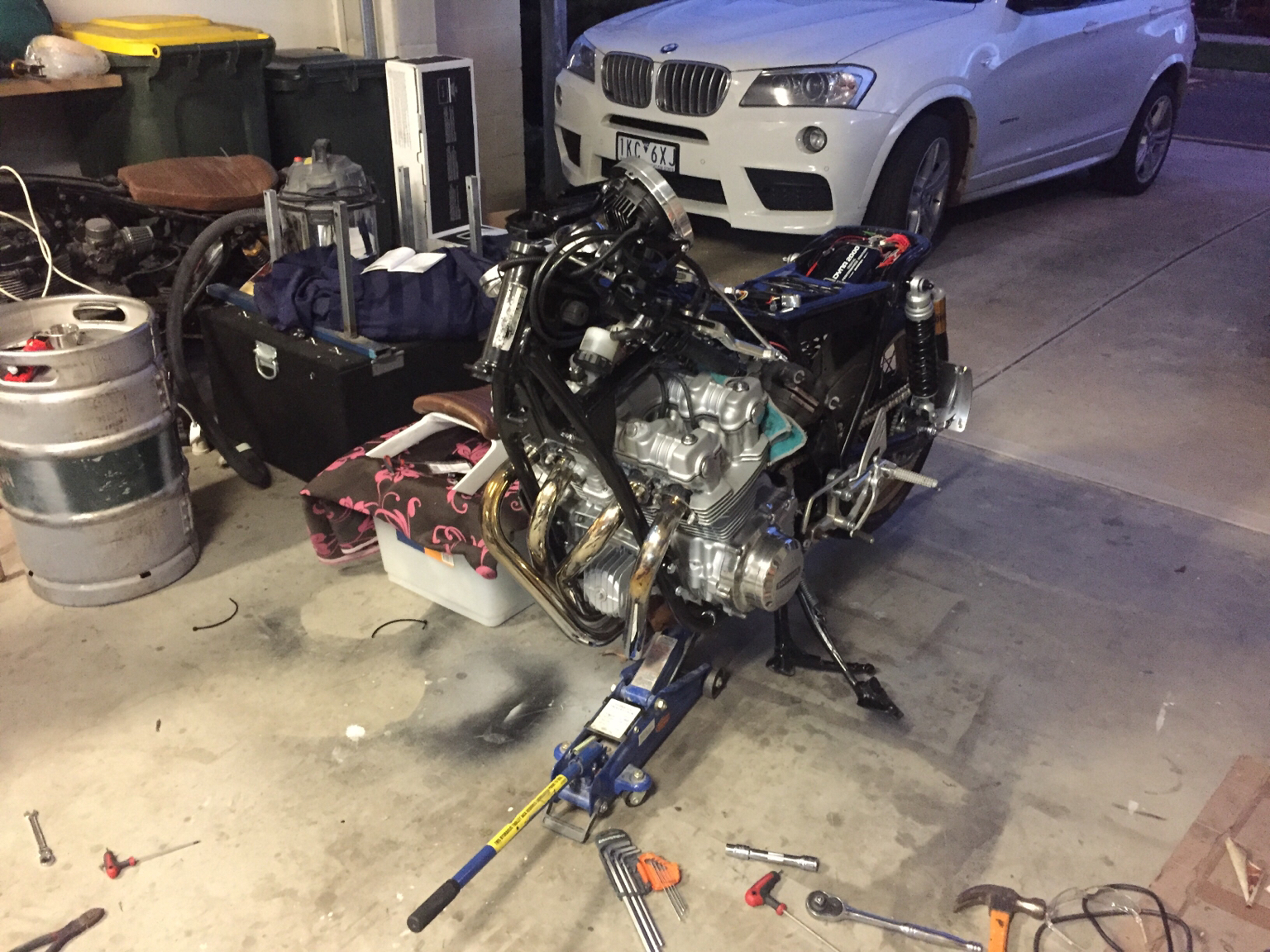

Pipes back on, and wiring all wrapped back up. Tomorrow I have to go interstate for the day, so I won’t be able to button her all up until the weekend depending on what the wifey, aka boss dog has planned.
Still waiting on my engine bolts to arrive in the mail, and I’ll have to go and get all the torque settings for the bike written down so I can cross each one off as I tighten them to spec.
