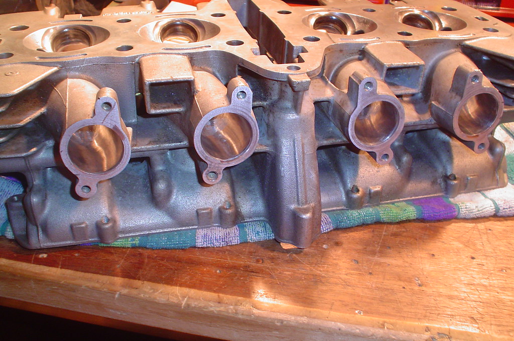

As soon as I got home I found another one on eBay, snagged it for $15 on a buy it now. Hopefully that'll show up soon, and in the meantime I plan to thoroughly clean the head, block, pistons and pan. Maybe I'll do some light porting, just to clean up casting flash & such, nothing radical.

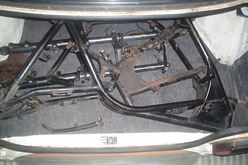

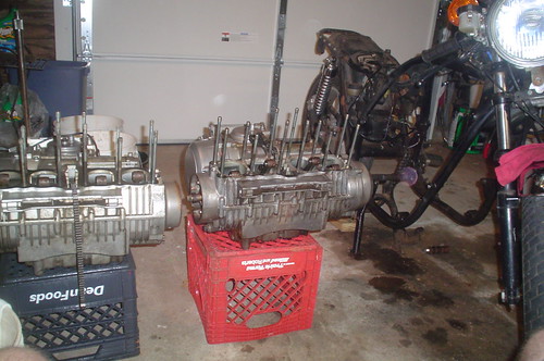

A couple days later, I worked a deal with a buddy in Kansas, then drove up there. It was a good haul:
This bottom end has a LOT fewer miles on it than mine.
Last night I pulled my bottom end, and damn near pulled my back:
Oh, my back...

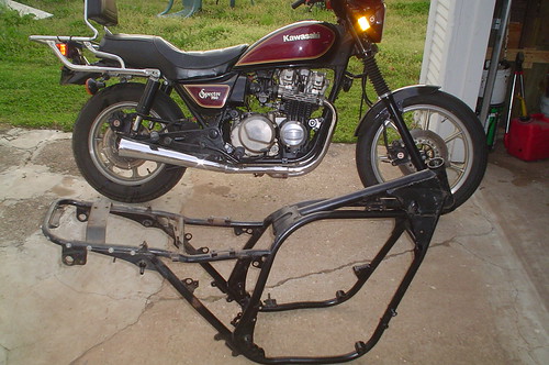

I decided that if I was going to remove my engine, I might as well take my bike completely apart and repaint the frame.
I took the plunge and started detabbing tonight:
There's no going back now...

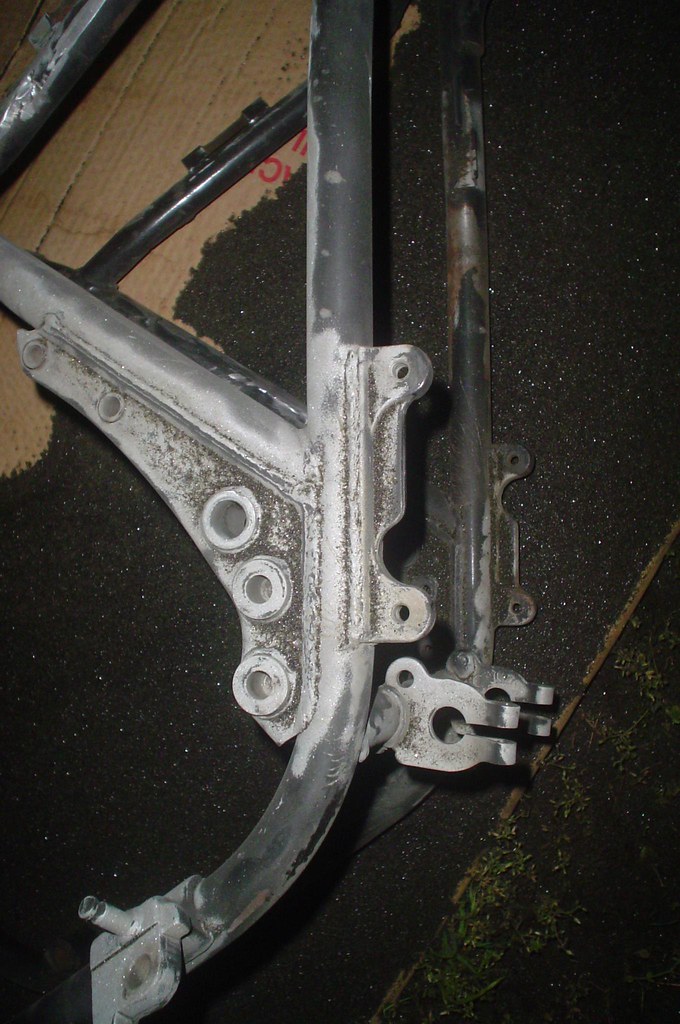

The frame's about 85% detabbed, but I ran out of sanding disks, so I gotta get some more before I can finish that part.

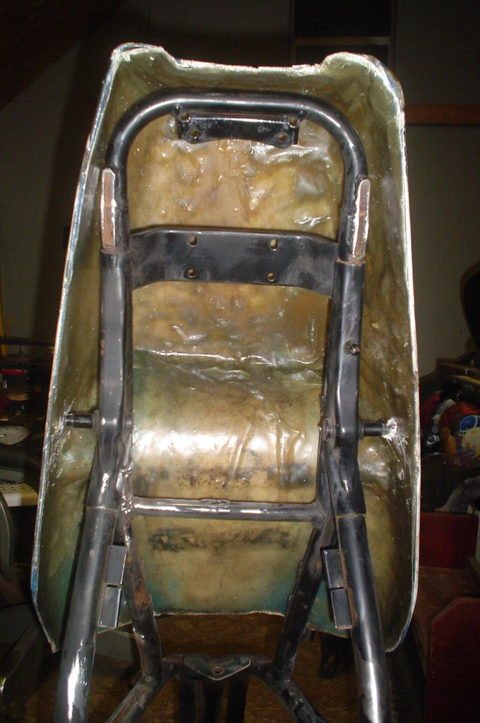

Meanwhile, I'm test fitting the seat, trying to figure out how best to attach it to the frame so as not to get poked by any bolts...

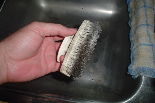

After that, I scrubbed various electrical components with dish soap and very hot water:
Guess which tool I've used the most so far in this venture.
It's not the grinder or saw, none of the wrenches or even a hammer...
It's this:
where did you get that seat? i like the racer style of it. looks like one of the seat i saw at Deus.
nice work with all the cutting. is that sandblaster have a cabinet? or do you just blow media everywhere?
eBay, it's an old Airtech Streamlining racing seat. I've looked on their site, but it seems they no longer make this one...
It's an actual racing seat from an actual racing bike that's actually been raced and crashed and patched and raced and crashed and patched. It had two dozen holes in it when I got it...

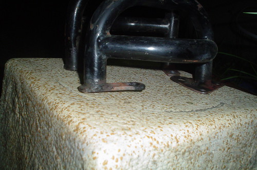

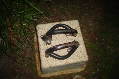

I broke out the oxyacetylene torch and heated up the tabs on my pre-crashed crash bars (they were like ten bucks for the pair, too cheap not to buy) and straightened them out.
Looks great. Food for thought... I've always heard the intake tract should remain coarse to add atomization and prevent "pooling" of gas while the exhaust should be smooth for flow.

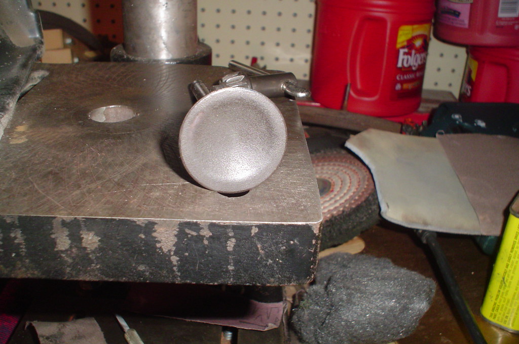

I cleaned and polished my valves. I used my drill press, an X-Acto knife for the worst of the
deposits, then emery cloth and 000 steel wool.
