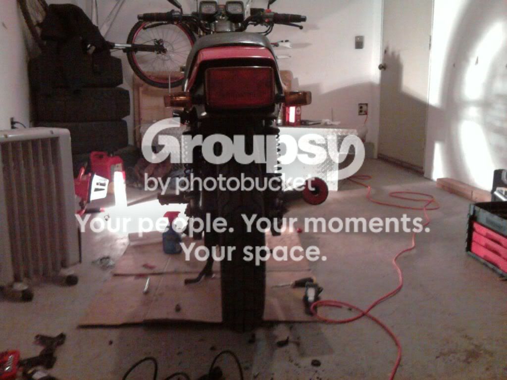

I have some ideas for the tail so i messed around in paint to see if it would look good. I think it looks real good! nice and clean. I plan on putting an LED tail light right under the tail. Not sure where to put the license plate just yet. (for reference look on the first page, its the same picture).

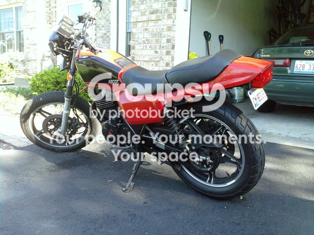

Worked on the tail a little bit. I hated how that huge brake light stuck out so far. I did some plastic magic and recessed it in a bit. I think I will cut a lot more plastic under the tail still but this is about the look i was going for.
you can see in this profile picture; i will cut the black plastic a little more so the lines work together.
