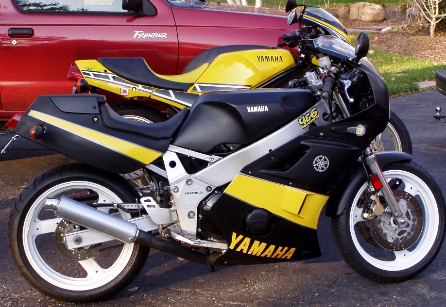

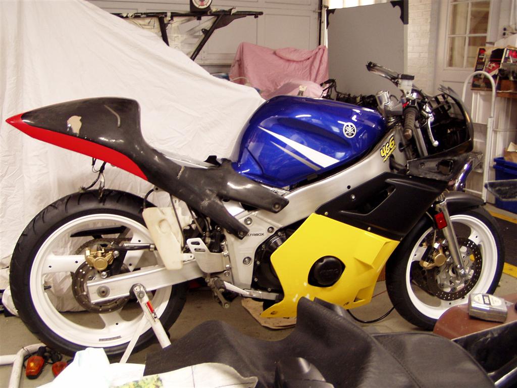

sep 2006 129.jpgseats.JPG FZR400 isn't the same as your FZ but aesthetics come from a similar era. Black and yellow is as it is at the moment. Blue tank was from a later 600 and seat is off a well crashed RS250 Aprilia cup bike. That was taken when we first got the bike and before I spent hours repairing the fairing. A more modern (slimmer) seat I think would sharpen up the look. Your FZ has a lot of square lines that could be softened but I wouldn't necessarily suggest a swoopy modern seat with that tank shape. Our FZR was sort of next generation so slightly less angular lines but clearly from the same design team. Something like the EX119x rear end might just work. It's square enough and looks less tail heavy than stock.
Aesthetics is a far off project on this bike lol, but i do appreciate everyone’s feedback and opinions. I think I’d like to do something similar to those two bikes, but maybe retain the passenger seat, just bring the side panels to a sharper point.
