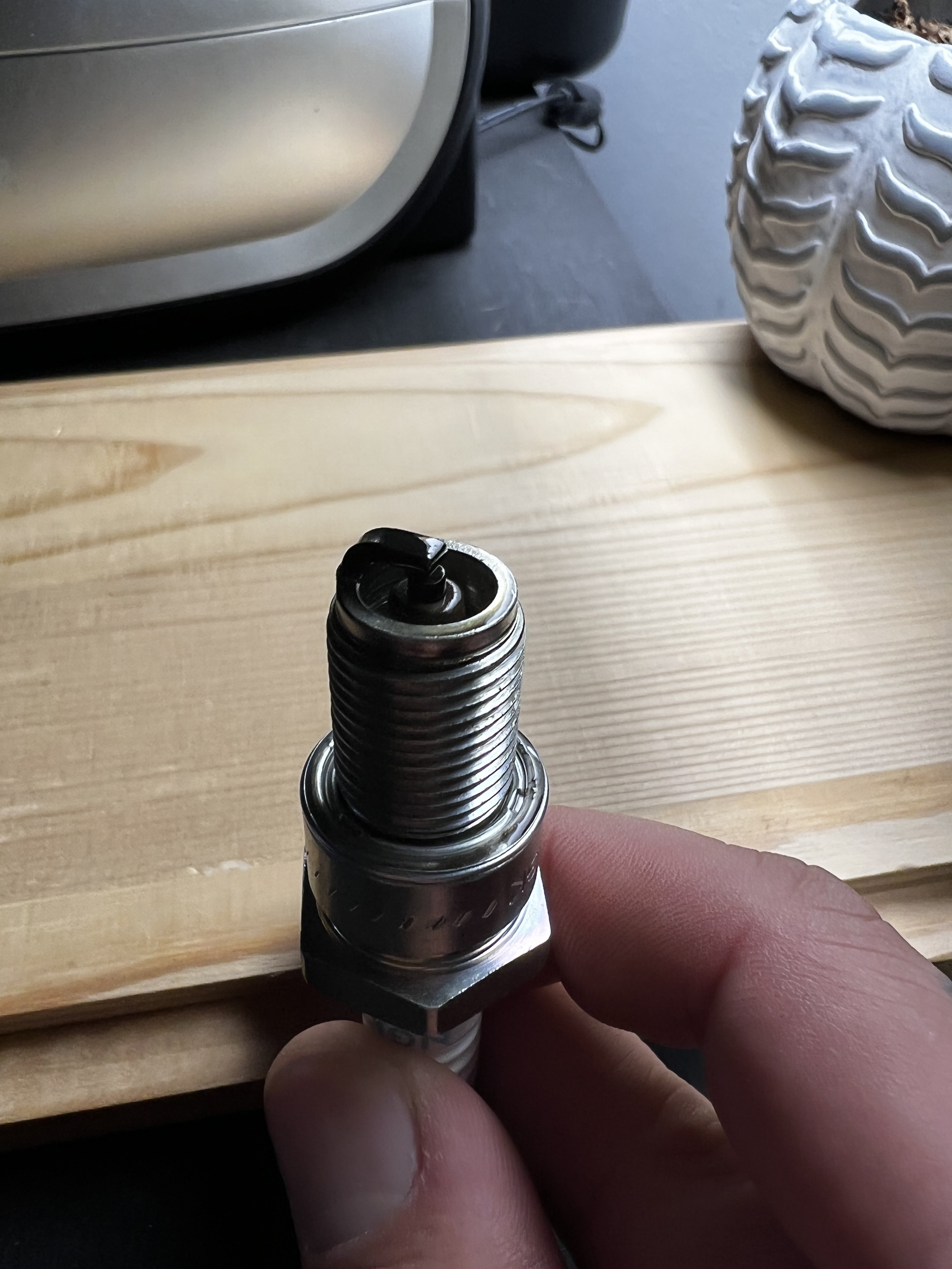

My question is, where do I start? I’d searched a few threads and have gotten mixed answers, any help is appreciated. I checked the plug on Sunday and it was covered in gas and black, used a dremel and cleaned it, threw it back in and went for a 20-30 minute ride, averaged around 40-50mph the entire time with stop and go’s in between. The picture below is after that single ride, doesn’t look too bad but it’s still wet and I can smell the gas. Also no gas in the oil, only on the plug. Thanks in advance for any replies!!

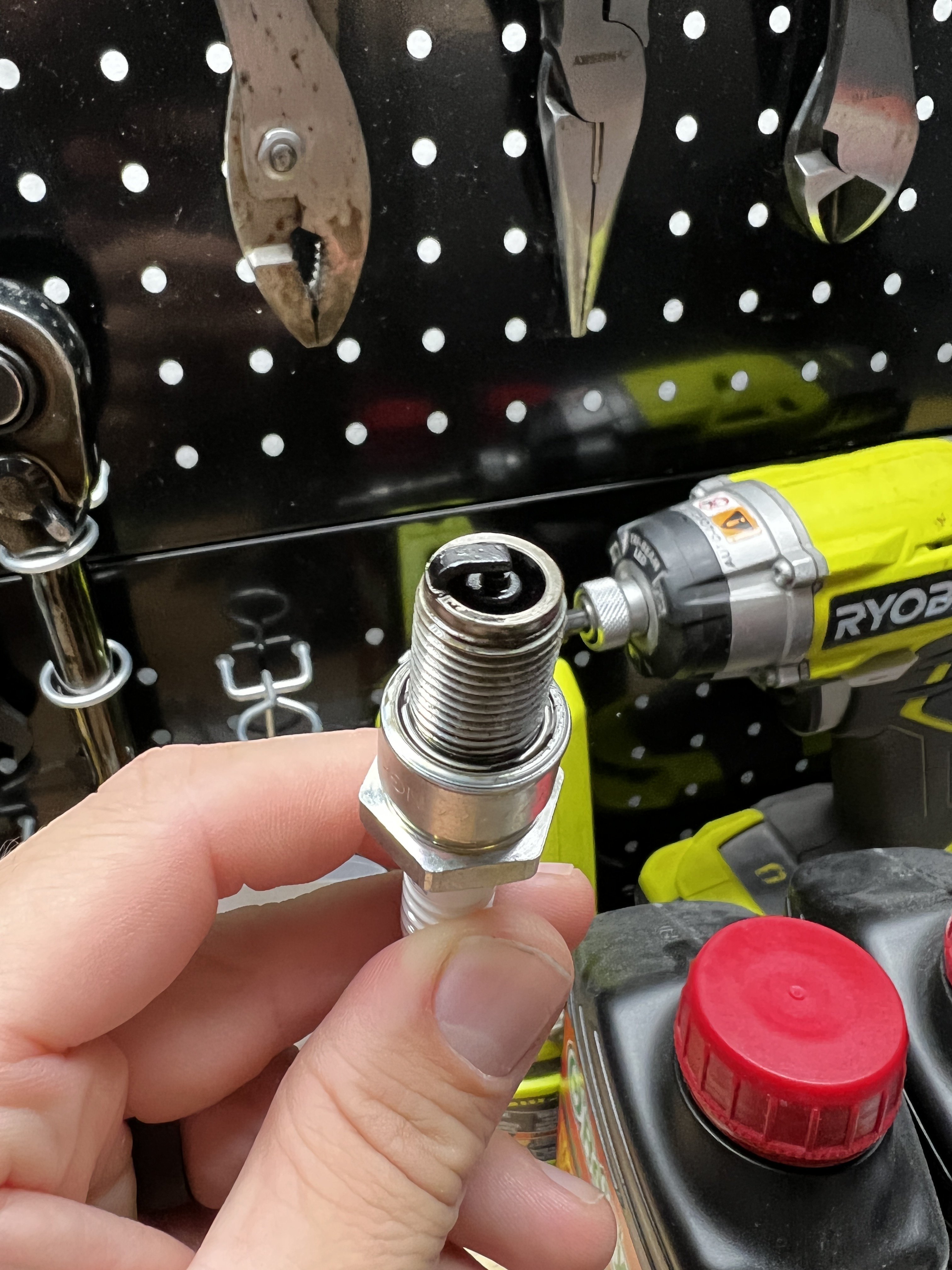

Installed new plugs, rode around for about 15 minutes and still smoking. Also smoke coming from the breather tube near the exhaust clamp (which I clearly need to shim and tighten down). Wondering if it’s actually oil and not gas, idk smells like gas for sure.
New plug after the 15 minute ride -

Your idle is really high. White smoke is oil. Oil will foul plugs too. Your tappets are pretty loud. I'd let it completely cool and go over all of your measurements first, then go from there.

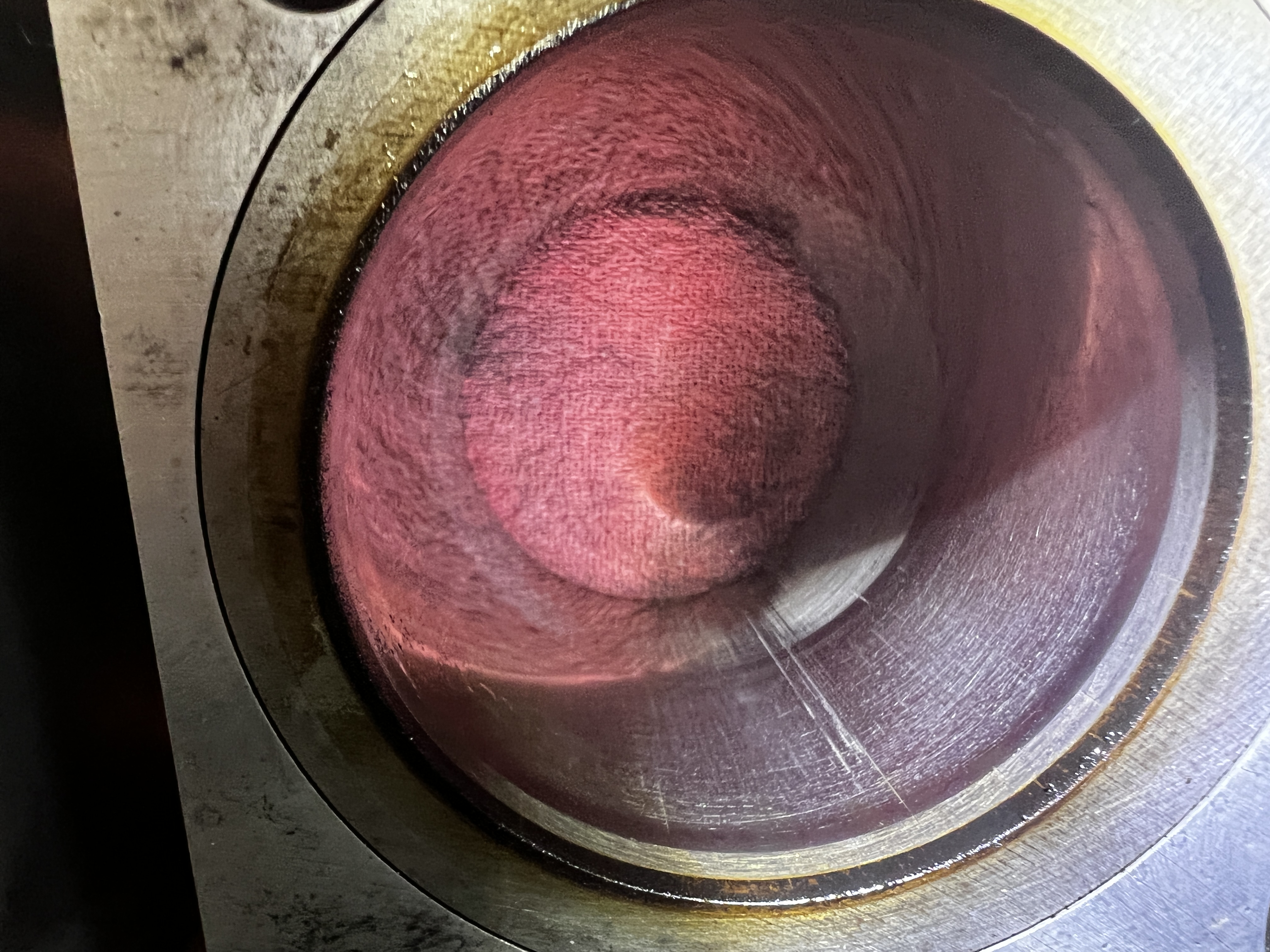

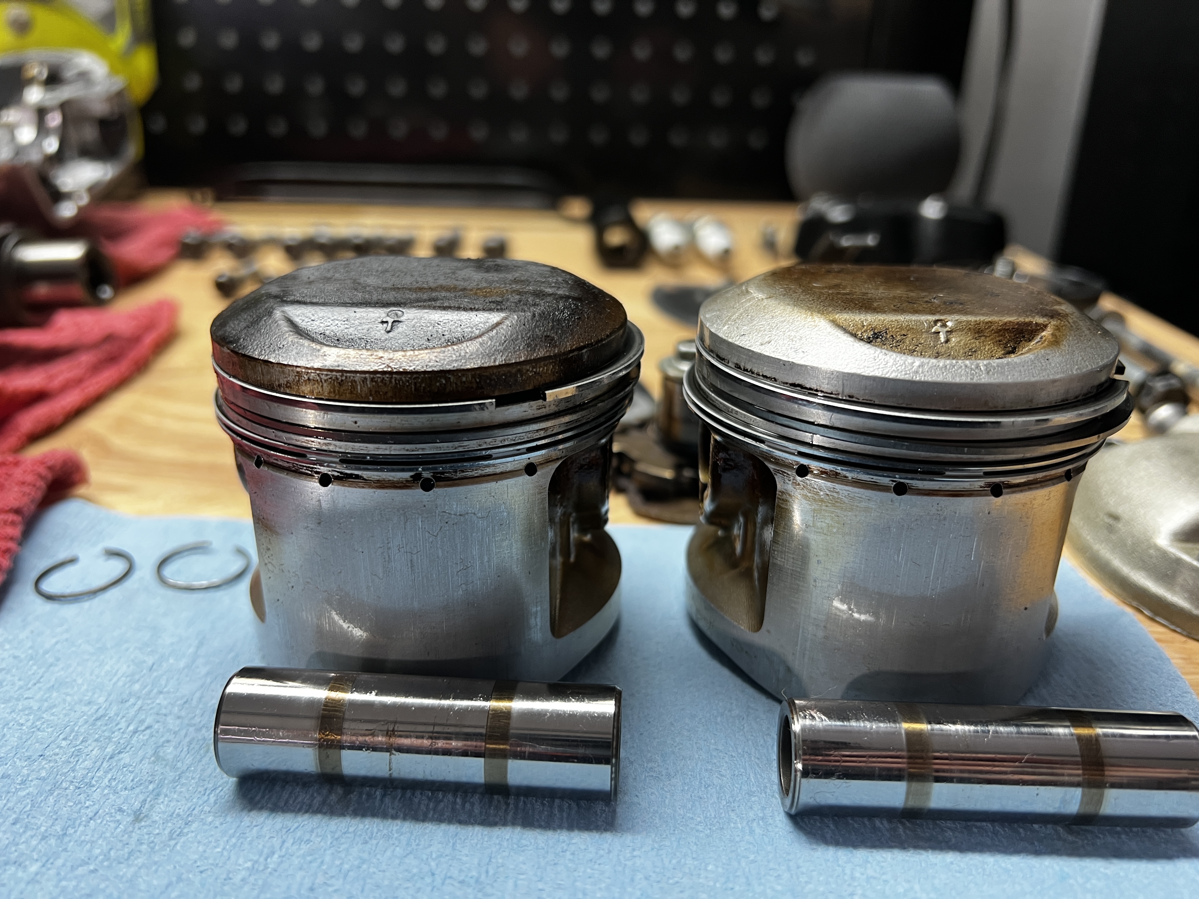

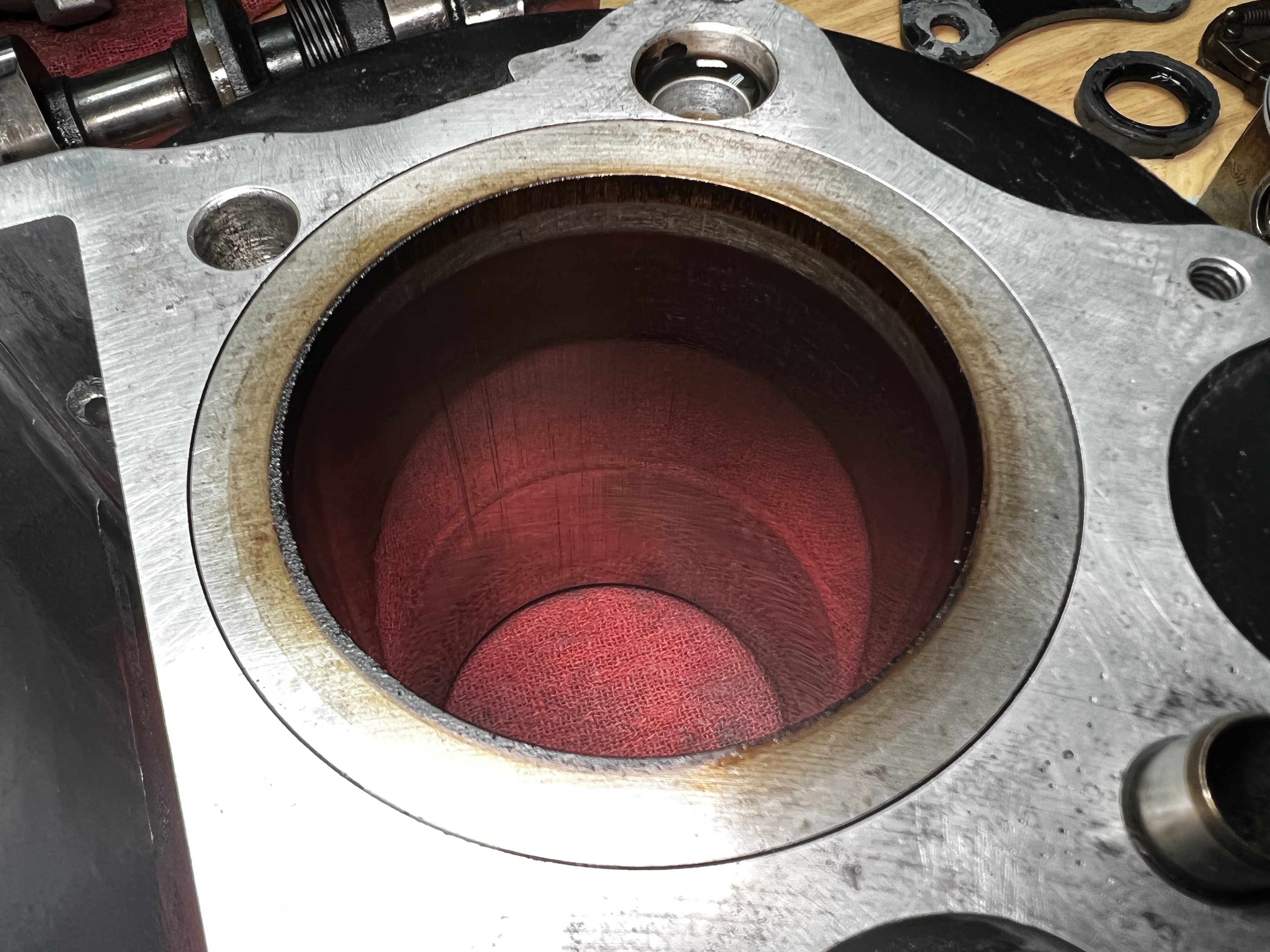

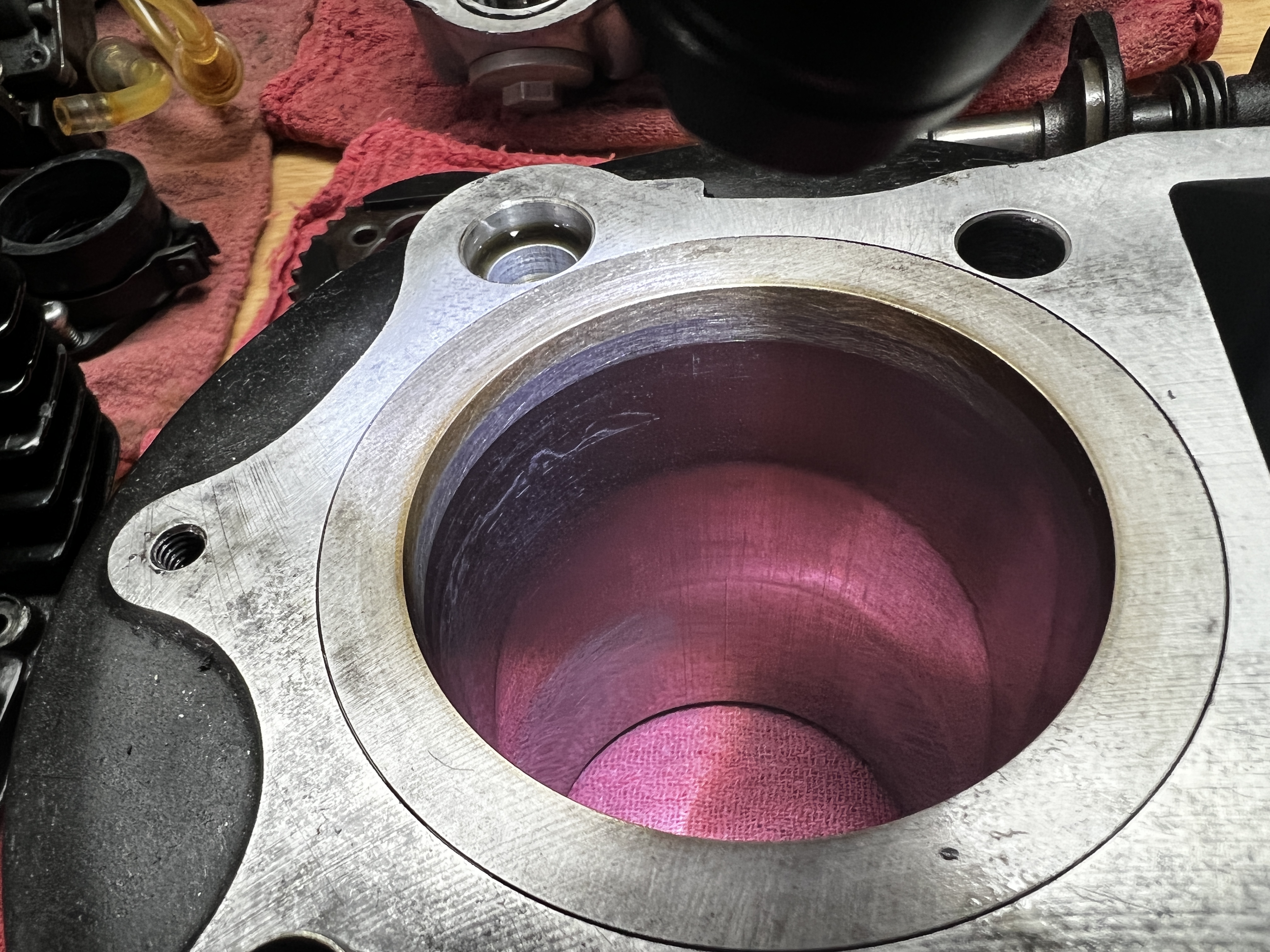

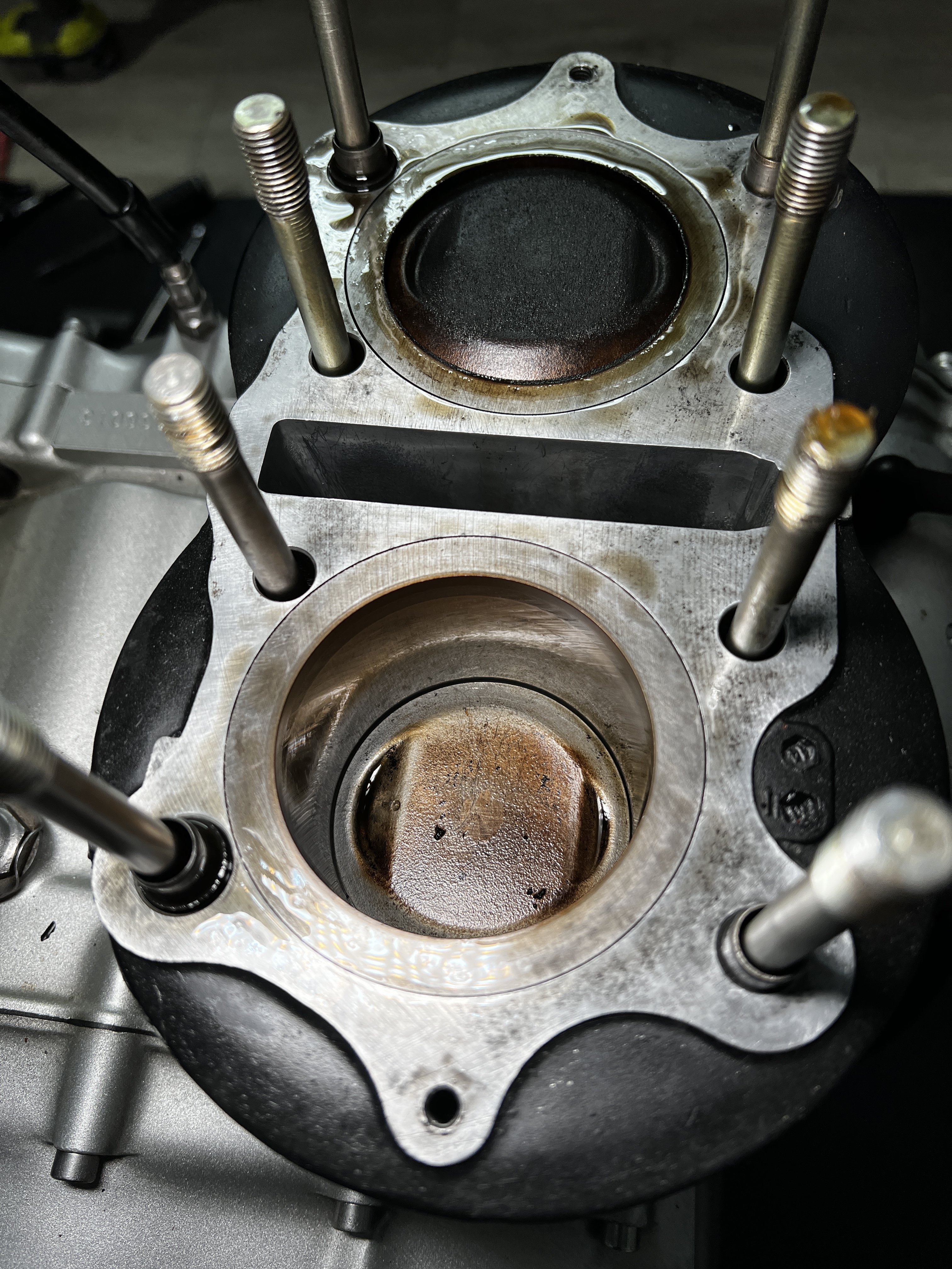

Okay, tore it all down today! Also filmed the whole thing and am going to upload it to the tube for everyone - here are a few pictures though, whats odd is how much oil reside is on the left piston and that spark plug was the dry one with no issues. This CLEARLY needed to be done! Some pitting in the cylinder, looks like it’s from the rings. Excited to get it bored, everything cleaned (going to re-paint as well) and already have all new gaskets - thinking about doing some oil mods while it’s all apart. Suggestions?

Do you have any idea of the actual mileage?
If it's below 30,000 it's doubtful that bores are worn and you probably just need rings?
Cylinders will normally last 60~80,000 miles or more but rings wear relatively quick if your using rpm correctly.
You don't need the CJ pick up unless your sloppy about checking oil level or leave bike idling on sidestand (and stand is bent so it leans further than normal) It's a simple upgrade though. Doing the oil transfer piece mod is probably the best thing you can do to make engine last a LOT longer. I did a picture write up over on Vintage Honda Twins on a CB350 a few months ago but 360 is almost identical (slightly more difficult as it doesn't have oil filter cover like 350)
Valve guide seals are pretty much shot due to age rather than wear, unless it was run excessivly with dirty or low oil the guides are probably OK (it's an expensive job to get them changed, particularly if you get bronze guides) If you go to the expense of doing guides, it's probably worth the extra to fit 35mm intake valves (I wouldn't bother with over size exhaust valves though, it doesn't need them)
Oh, as for the gas problem, probably need shut off valve or maybe just dirt in the shut off? Re-set float level to 21mm if you run E10 fuel (and being in Cali you probably can't get anything else?)

Hey crazypj! Thanks a ton for the reply and detailed info! This bike was rebuilt by the person I bought it from about 3 years ago - he also gave me a storage bin filled with parts, said he had 3 CB360 engines and rebuilt one solid one with all the parts - after about 6 months of driving a rocker arm bolt flew out on the freeway - from that point I had to buy new (will used but) rockers with very little pitting, a camshaft, new valve cover and all the gaskets - after that rebuild last year it was running great up until recently with the oil/gas problems I've been having on the spark plug - this is why I decided to tear it down and have revealed all the above - dropping the cylinder at a machine shop today with the new pistons (already have the oversized ones so why not?) - I've definitely seen your post on vintage Honda twins, will read through it again and most likely do the mod - I really only use this bike to putt around town but would love for it to be reliable enough to drive through the canyons on a nice Sunday!
Probably won't do the guides unless it's necessary! Also, I have a shut-off valve and using shut it off before I pull on my street so it burns off some of the gas in the bowls - I am going to rebuild the carbs since they are out - they do have pod filters, I am sure that isn't helping
Well, took the cylinder and head to a machine shop - looks like the head needs to be replaced, the journal is pretty bad and the machine guy would rather not work on it and charge me know it’s going to fail eventually, found one on eBay for $100 in good condition, going to pick it up and have him check the valves, guides and all that jazz - working with Kurt at Valley Cycles in Los Angeles
