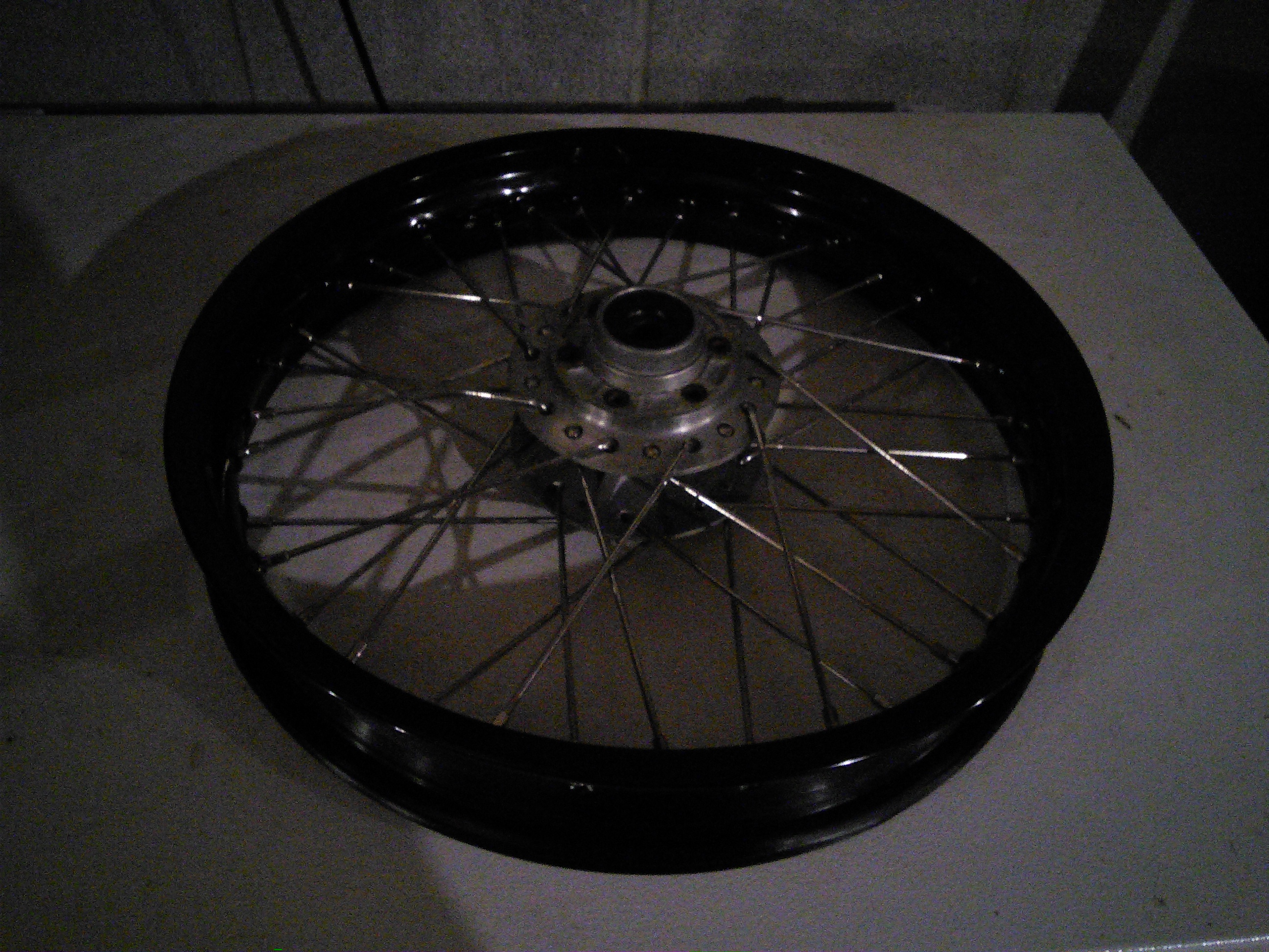

Minor update. My new front rim and spokes arrived today so I put it together which is a little foolish because I haven't polished the hub yet so it will have to come back apart.[/

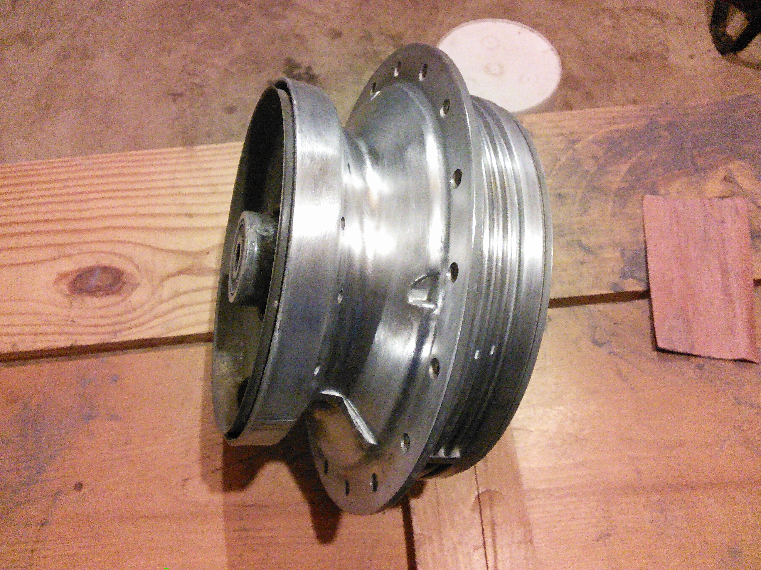

My new spokes for my rear wheel arrived so I finally pulled the wheel apart to clean up the hub and paint the rim. The hub looked like oxidized aluminum but it actually had a dull gray paint on it. I am going with polished hubs front and back so it had to come off. This is what it looked like before and after. Still a bit more to go but much closer. The 15 inch DID chrome rim had a fair amount of rust. It will be painted black but the chrome is almost salvageable.

I turned down the shoulder on the hub that prevented the coupler from the 920 from seating on the 535 hub. I laced rear wheel back up and scratched my newly painted rim pretty badly with the ends of the spokes. It was a dry run and I was planning on putting some more paint on the rim anyway but it was still a dissapointment. It really was an awkward job and the outer spokes on the drive side flange seem a about 1/8" longer than they need to be. I'm going to dissassembly it carefully and try another dry run before repainting the rim.

This last photo shows the shoulder/collar machined down to accept the coupler from the 920
Then I just pulled it all apart.
