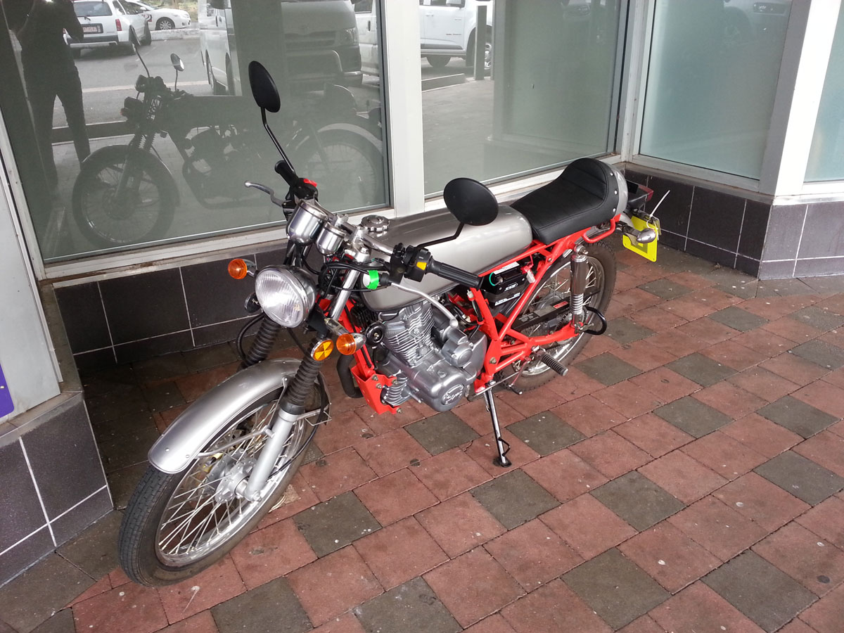

Get ace going after sitting for 3 months
Itssss alllliveeeeeeeeeeee.....
Now, to get some more power out of it...it does feel a little bit like I am riding a lawn mower....
So, new carby, EGR and exhaust first up?
