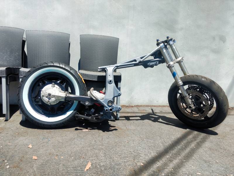

Finally! We have a roller!
Sitting on the ground... It won't actually be this low but looks amazing like this
