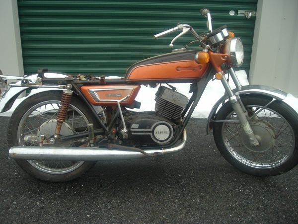

Good deal?
It looks like everything is there except the seat. The r5 motors are pretty simple to rebuild and parts are fairly easy to come by. If he has a title, then its a definite buy! Hell if it doesnt have a title, but it anyways. R5s are fun for sure!

Is this bike a rd350 or a r5? Or are those the same thing? Also what would you need to tell what it is (if you can't tell from the picture)?

That is an R5. There are some differences between the RD350 and the R5 motor.
RD350 is a 6 speed. R5 is a 5-speed.
RD350 has reed valves, R5 is piston ported.
RD350 has a disc front brake, R5 has a drum front brake.
RD350 top end will bolt up to a R5 bottom end.
^ what he said. You have an R5, the tank is for sure a 72', did you get a title, what does it say? Look on the steering stem for the VIN.
You can easily drop a late model RD 6 speed in, make sure to also get late model clutch assembly as the boss addresses clutch slip.

What they said. ill add the rd has a better fork (not much better, but better none the less) the seat are alittle different and the side cover are dressed up different but the cover them selves are the same you will find most all the visual parts ie tank fenders seat bla bla bla will swap between the ds7 r5 rd 250/350 and a lot of the 400 parts as well yamaha developed this bike for the better part of 12 years even longer if ya get in to the water cooled models rd350lc and rz350 and banshee quads till the 2000s my rd is A 74 and has a fair amount of banshee parts in the motor.its a if it ant broke run it til the epa kills it then make a bad ass 4 wheeler outta it kinda thing.
Yes, and don't go with the black, it's zinc and rust, I owned them. Are you missing case bolts? You can get those at Fastenal for about $8
