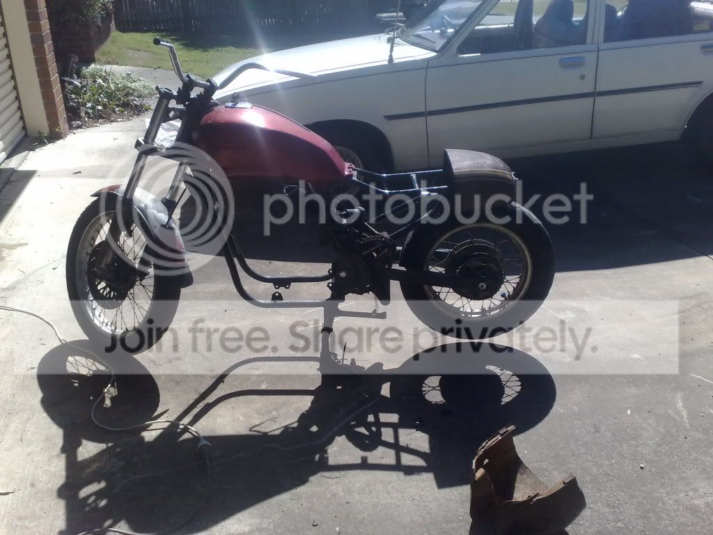

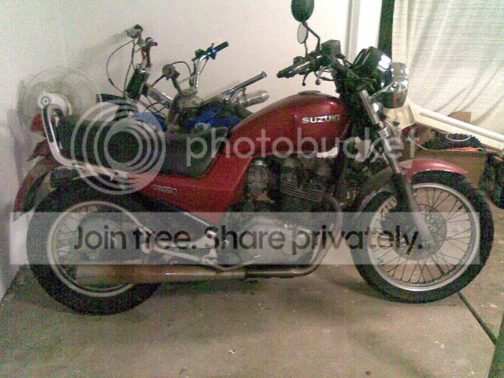

My names Dave, from Brisbane, Australia. This is my first bike build, a 1983 gr650 that I swapped a mate for my pit bike ;D
The bike was running and riding well when I got it apart from the battery not charging, I'm thinking its probably the rectifier regulator (did I get the right name?). Apart from that and a couple of oil leaks its in good condition mechanically and really only needs asthetics worked on.
I started stripping her down
trying to get some ideas how to shape the bike
I have a lot of cleaning and polishing to do too
Let me know what you guys think

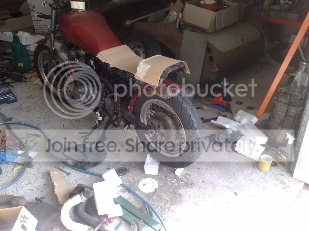

So I'm starting to look for a style for the rear as these things come from the factory with one of the ugliest seats ever!
So here's what I'm looking at, a single seat with a simple cowling over the back
I'm thinking that it needs to be pretty low line due to the angle of the rear of the tank
I'm also planning on running the rear fender with a couple of braces where it sits in these photo's (just above tyre) as I think it looks a lot cleaner than the origional set up.

I am thinking about taking a fibreglass mould of the back of the tank to make a rear cowling as I have been having a little trouble fabricating one out of steel (I haven't had much practise fabricting). I'm not going to use side covers on this bike as I think it will look a lot better with the plastic covers gone and the tabs ground off, plus they are broken anyway.

I finally got a little more done to the bike today, I've been having a bit of trouble working out what to do for a seat cowling. I didn't want to cut the frame at all in modifying this bike but I realised today that the upright on the rear of the bike was too wide and tall for what I am trying to achieve so I ground it off. I also chopped up a cheap ebay tank to see how it will look, on the back, I'm still undecided on it as I think it will need the lower section cut off to make it sit low enough and cut a strip out of the top down the middle to make it fit closer to the frame rails and get a cleaner look. I'm not sure how to go about this as it is my first time doing it but I guess its not a big deal as it only cost me about $20.
Here's some pics with the cut down tank/cowl mocked up
You can see here where the tank needs to be cut so the lower section sits around the same height as the frame rail
I will also have to clean up the back of it and possibly weld in some sheet to give it a cleaner look
Notice the little tab on the lower back section of the tank? I need to work out how to remove it without damaging the tank as I am not going to run side covers
you can see here how the tank cowl is a fair bit to wide for the frame, I need to wok out how to narrow it without wrecking the shape
I think there is only just going to be enough room between the tank and the cross brace for my bum as sitting on the frame like this seems a bit of a tight fit but I guess once the seat is on and padded etc. it will be enough as the seat will sit over where the tank bolts to the frame (it has a flange on the rear), otherwise I'm up a certain creek without a paddle.
I am still yet to work out how or where I will mount my battery and electricals, if anyone has any suiggestions on any of the problems I'm having I would love to hear them.

For the little tabs on the tank, you could paint them the same color as the frame to keep them "hidden".
As far as hiding all the electronics....thats gonna be a little tougher. These GR's are well known for destroying the batteries, so a smaller one may not be a good option. Could try to put as much as possible under the seat hump though.

You should find those back tabs have been sealed by a weld that follows the bottom line of the tank, and the tabs themselves are just spot welded around the edges. If you can find the seam, you should be able to cut below it without interfering with the seal. Or like rich says, paint 'em black.
