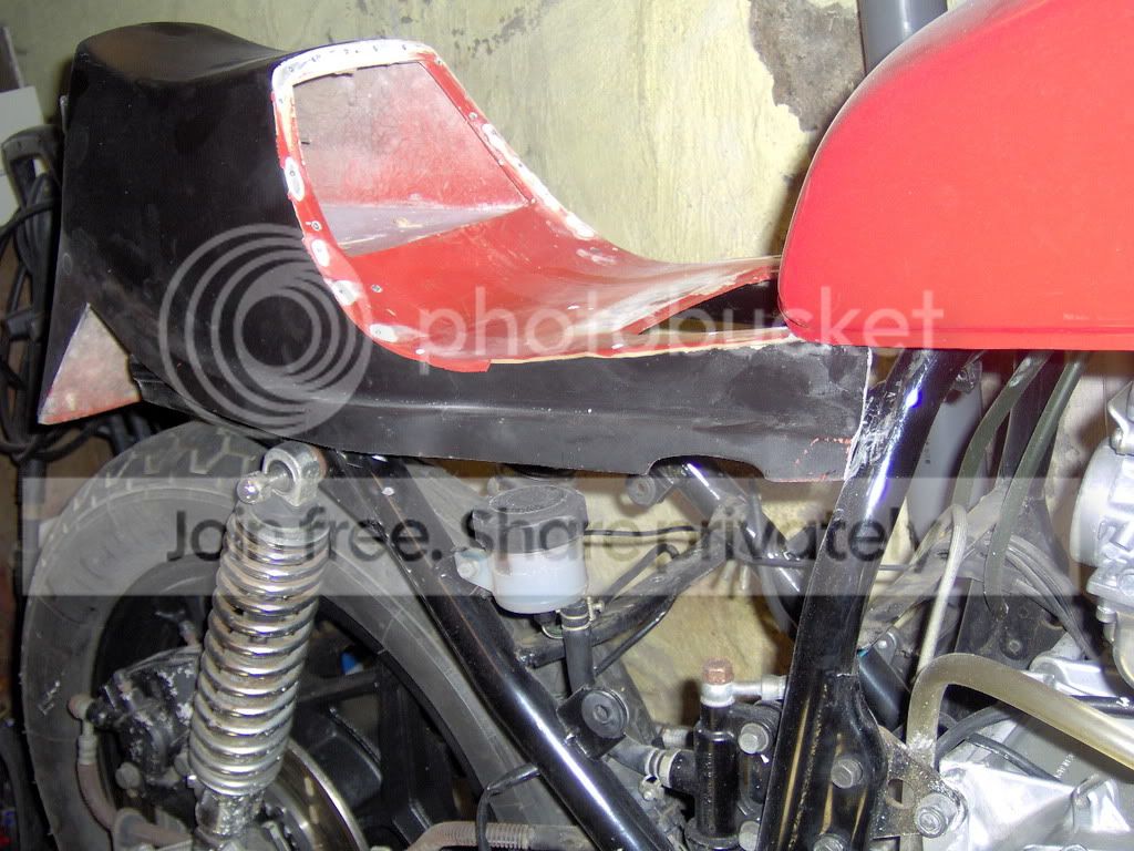

gs 1100 seat project oppinions please
tegera
Have to find a way to mount it to the frame
hmmm...
it def looks neat, but could you take a side view pic so we can see how it flows with the tank?
Hey there,
Are you sure that rear fender section is not going to hit the tyre when the suspension is fully loaded. Looks a little close to me. You might have to move the seat back a bit.
