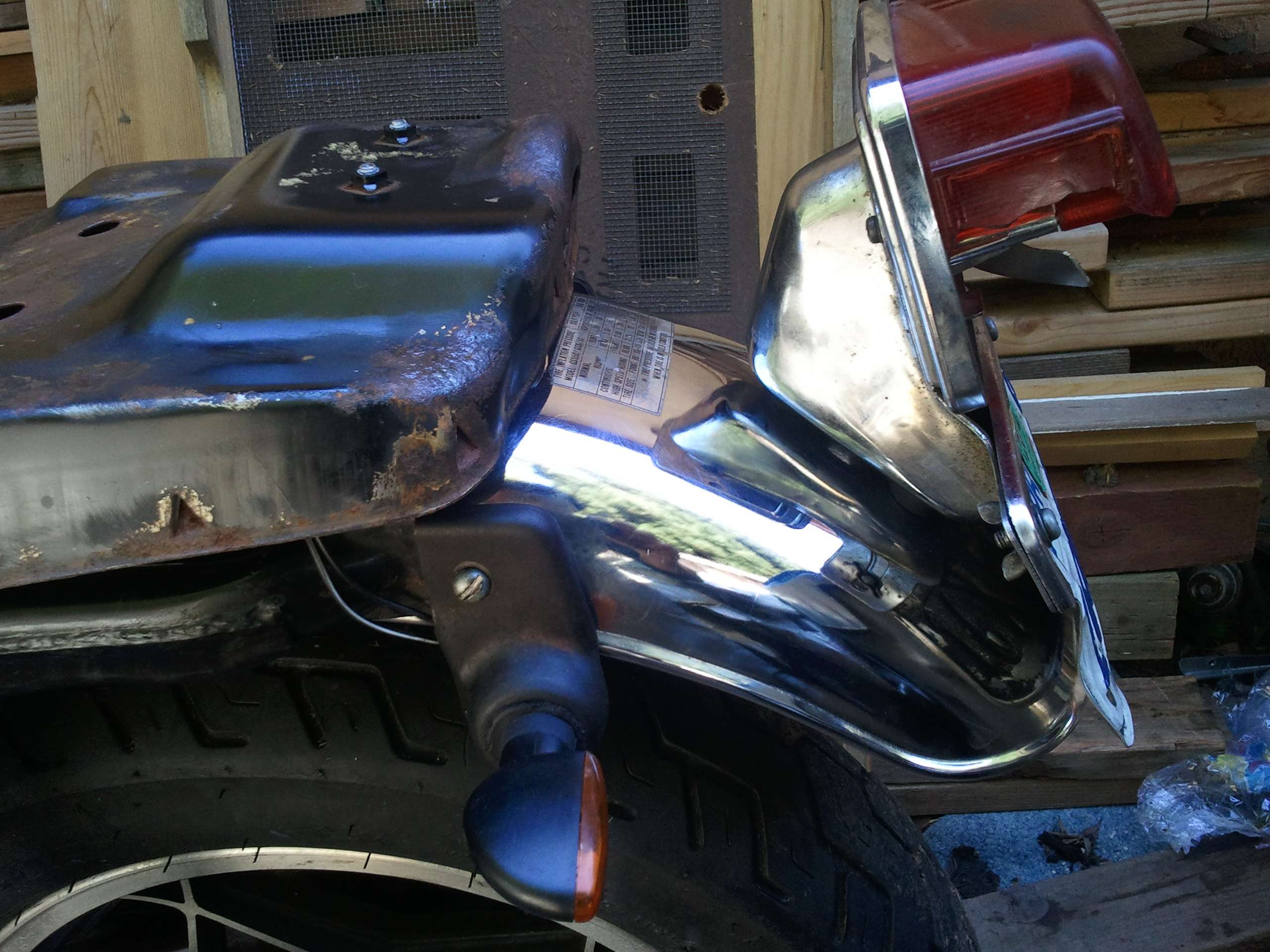

The seat was covered in duct tape and looked terrible, I was originally going to try and reuse the stock seat pan and foam.
Under all the tape
Rusted
Seat foam trimmed

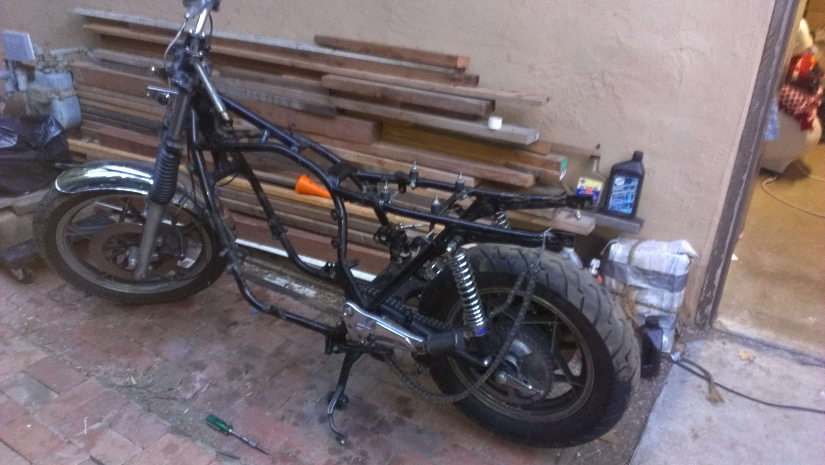

The tank got primered as well, I got sick of looking at the peeling paint.
Re: GS-550L Cafe Project

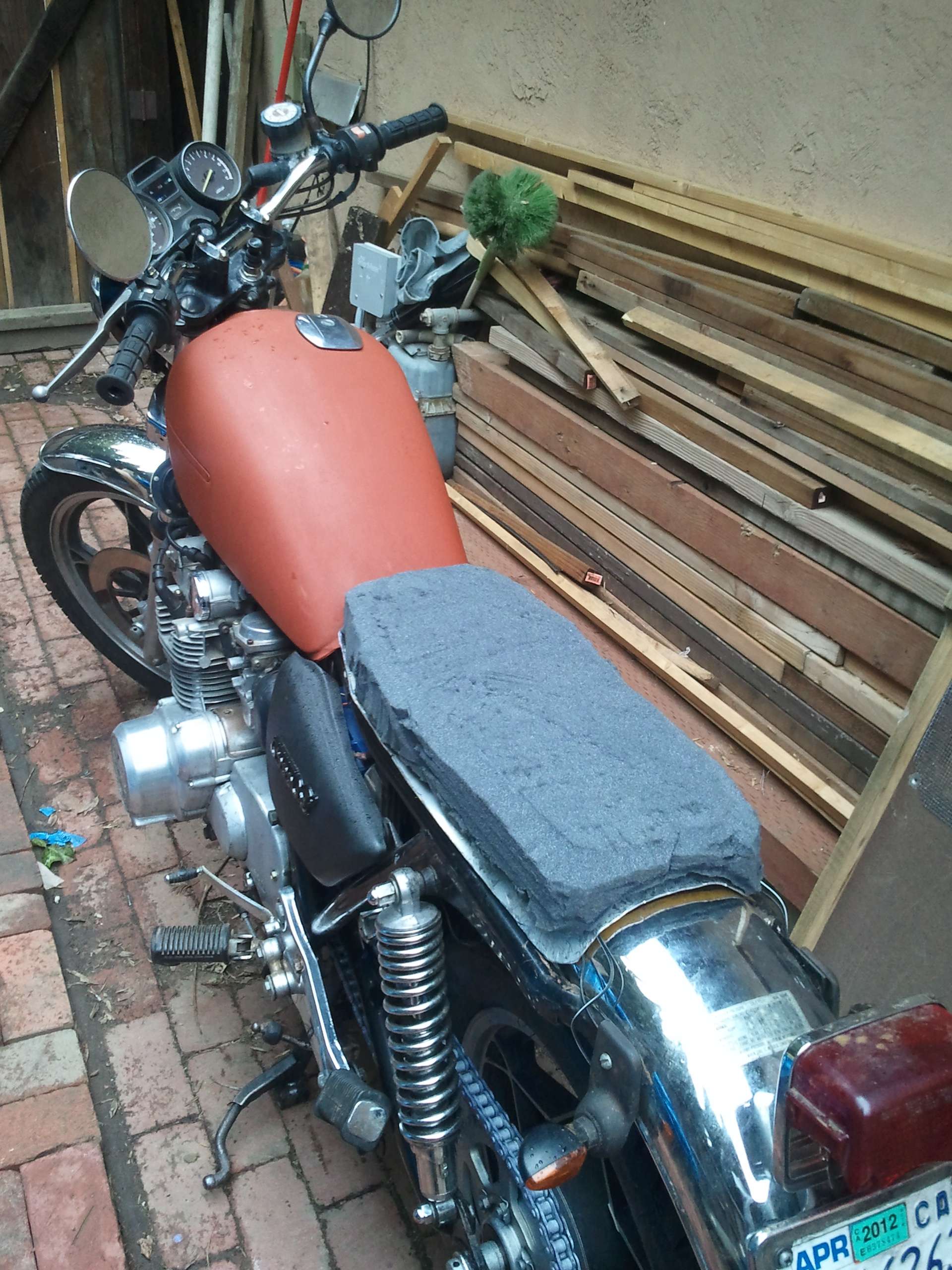

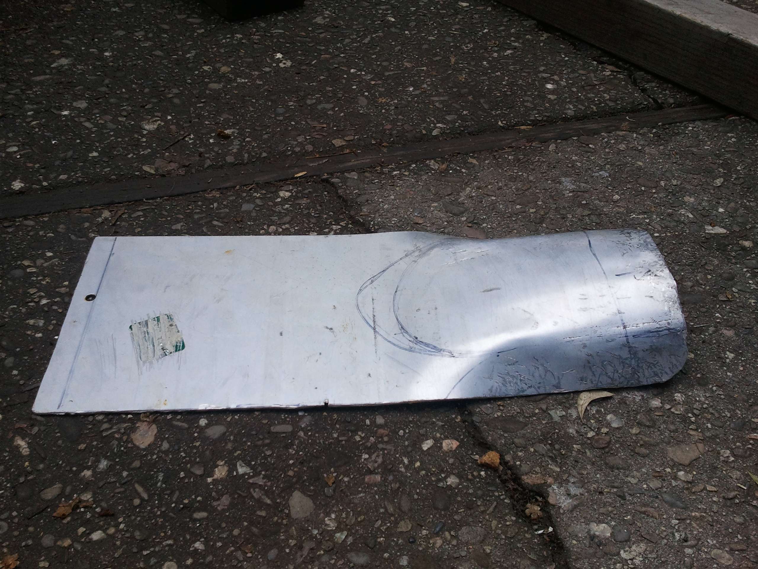

I ended up giving up on trying to use the stock seat pan, it was so rusty and I didn't have a good way to mount a new cover. Plus it was such an odd shape I didn't think I could easily make a new pattern for it anyway.

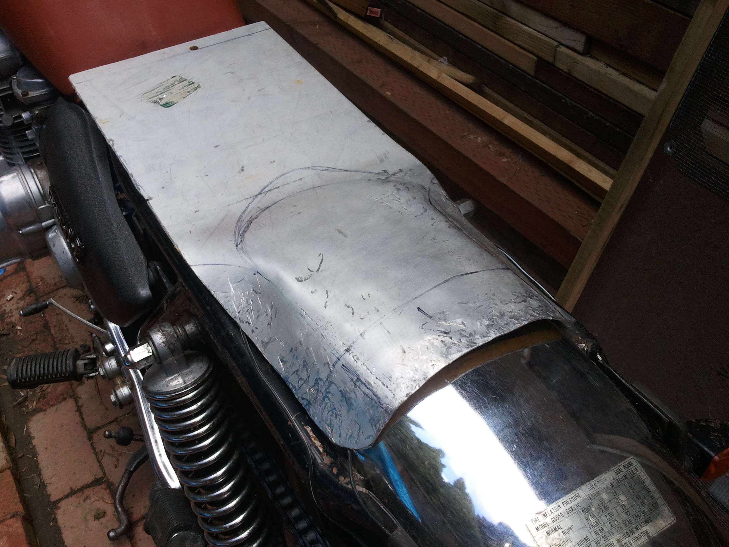

I had an old road sign in the backyard that I used as a base for the seat. This is after an hour of hammering. Ive never formed anything before so I think it turned out okay.
Got some extra foam from work and cut it down to fit.
I found some thick leather look vinyl at a local fabric store and paid my sister a couple bucks to stitch in some lines and batting. The bike also got some superbike bars and Oury grips (comfy!!) and smaller indicators to get rid of those giant lollipops. The 4 into 1 got sanded down and sprayed with BBQ black.

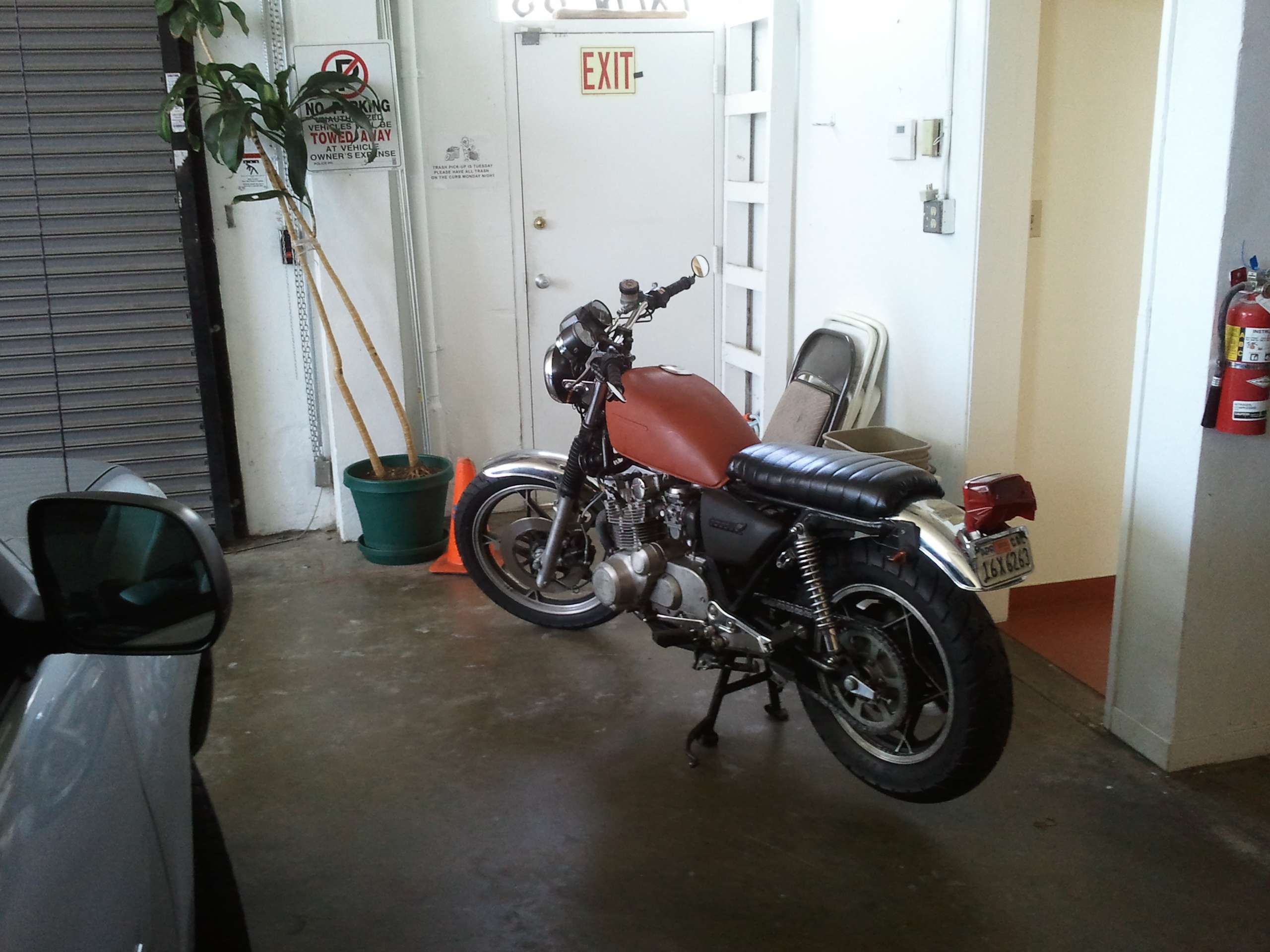

The tires got installed and bike earned my trust enough to take it work. I work in San Francisco and it's a 120 mile round trip, nothing in a car but it's an epic journey on a bike.
Made it!

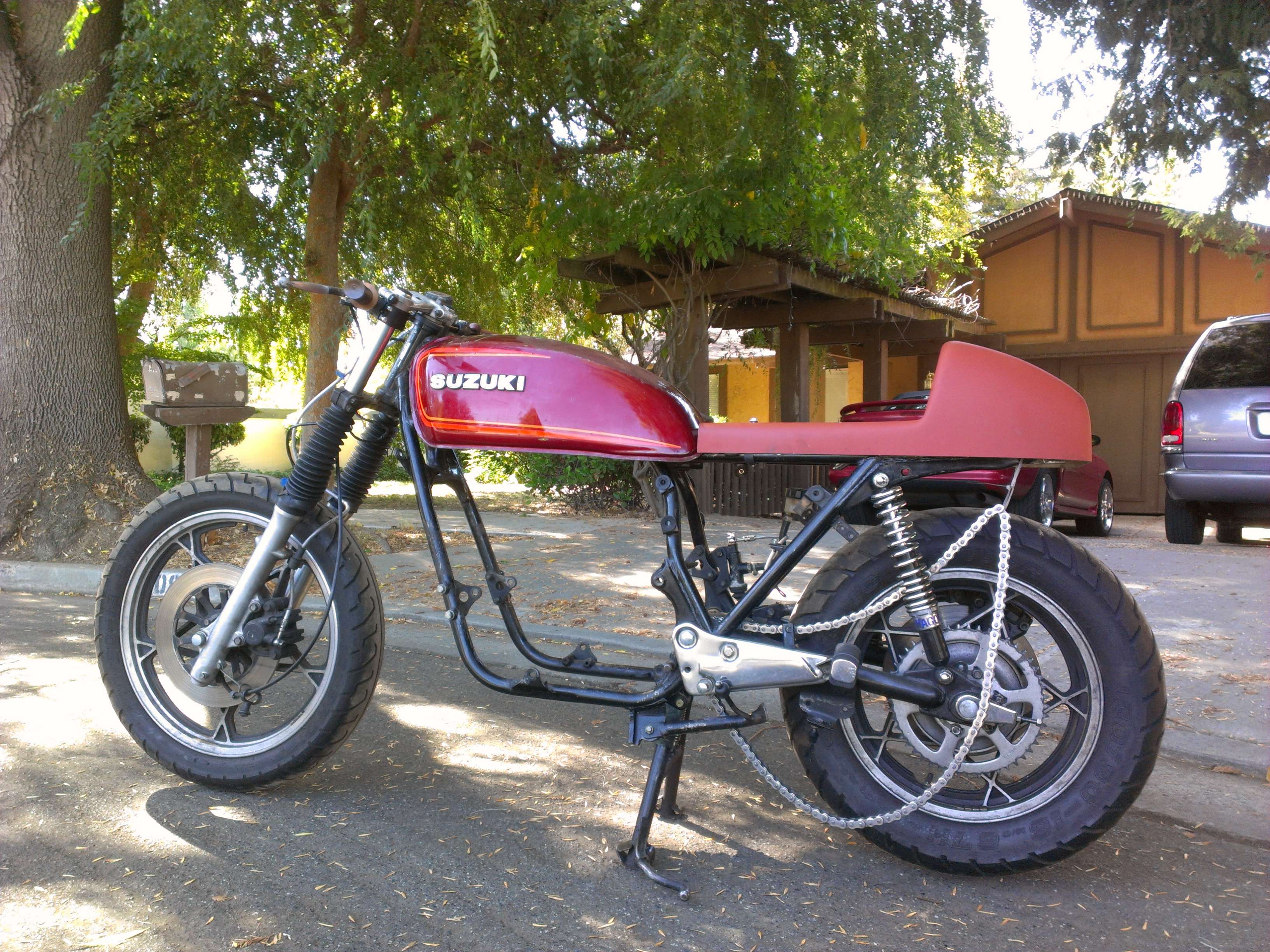

More stuff!
The seat from Roc City came in, man it's like a work of art. Roc City makes some legit fiberglass parts.
I also found an XV920 tank on ebay to try and modify to fit the bike.
Mocked up

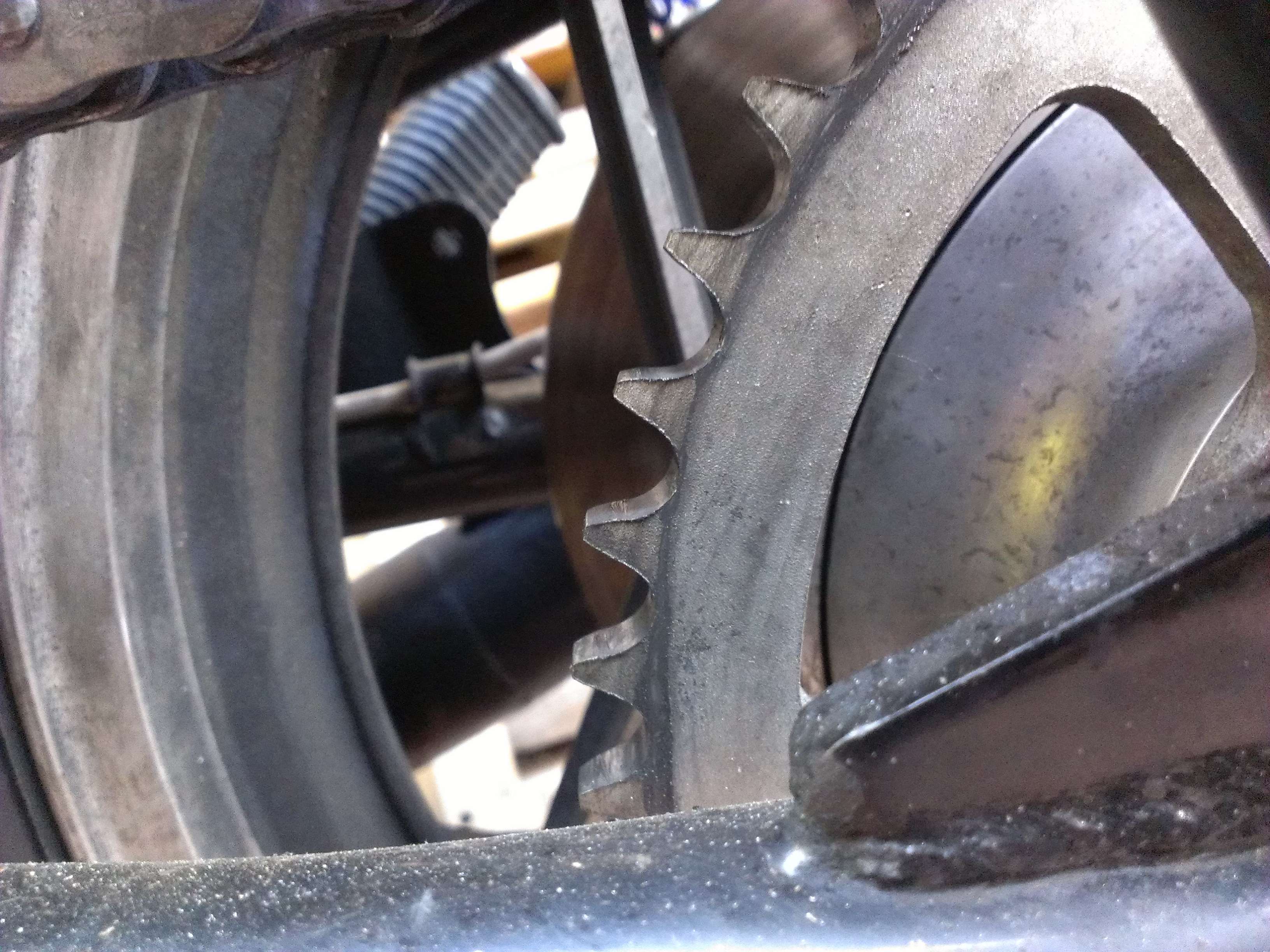

The chain and sprockets where in pretty sorry shape. I had adjusted the chain slack after I bought the bike but the PO had apparently been running it REALLY tight. You can see some flashing on the sides and the teeth look mashed. I got new sprockets and an X-ring chain from Z1 and installed those.

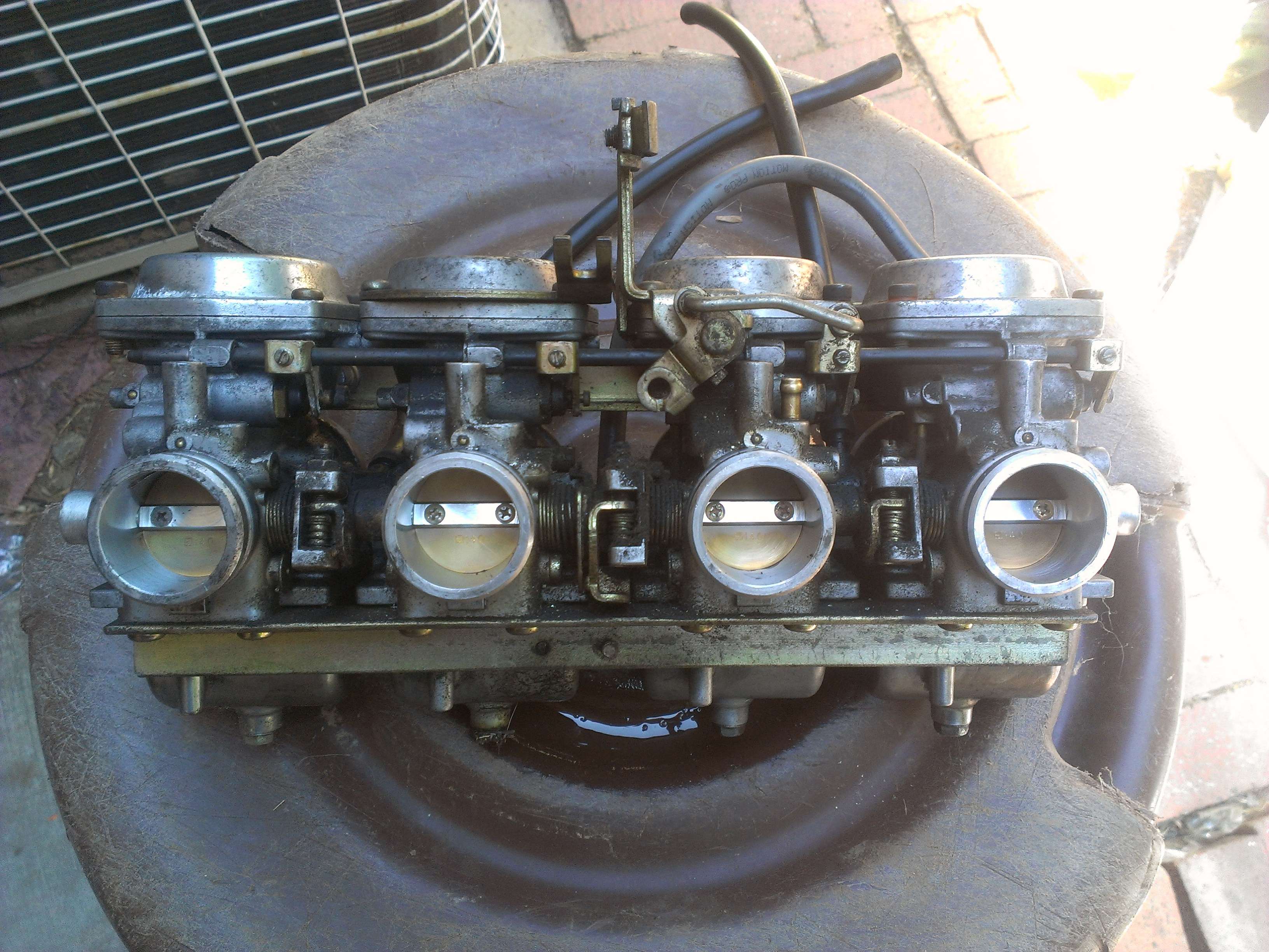

The carbs needed to be cleaned, it was running lean and had a hanging idle.
Before:
After:

I ended up finally mounting the seat. I didn't want to be shooting screws through the frame and I don't have a welder so I used a different method. I don't have pics of the mounts but I saw this on another forum. Get a hose clamp, a rubber stopper/foot thing from the hardware store, a carriage bolt and some shrink wrap. Drill the rubber foot top to bottom, drill a hole in the clamp, stick the carriage bolt through both and clamp to the frame. You can use the shrink wrap to blend in with the frame and keep from scratching it. The bolts stick up and have a thick rubber base and it worked pretty well. I used a thick plastic I got from TAP to mount the seat to so it wouldn't crack.
I sprayed it to match the old tank for now. I lost one of my bar end mirrors on the freeway so I went back to long stem ones, I can see better with those anyway.

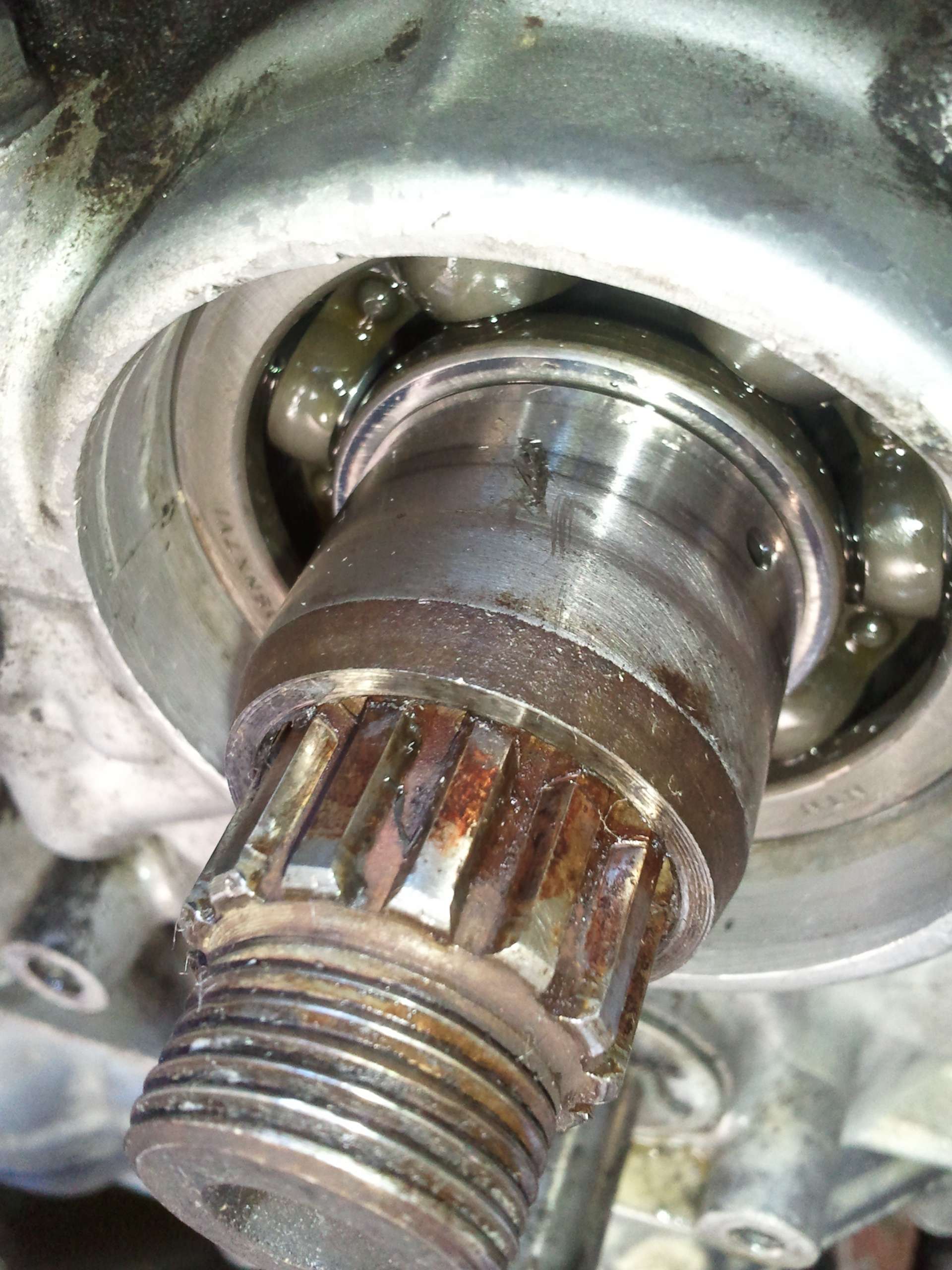

I'm pretty much caught up now. As of a few weeks ago I got sick of the terrible oil leak it had, after every ride I would have to wipe off the bottom of the bike and the drop or two that got on the rear tire (I know...). After I came home one night and saw the rear tire was covered in oil on the left side I parked the bike.
Some PO sometime in the past had tried to replace the output shaft seal with a chisel or something and gouged the heck out of it. I replaced that seal once but it chewed through it again. A real bummer since I had FINALLY got the bike running reliably.
I would need to split the cases to fix it legitimately so I bit the bullet and pulled the motor.

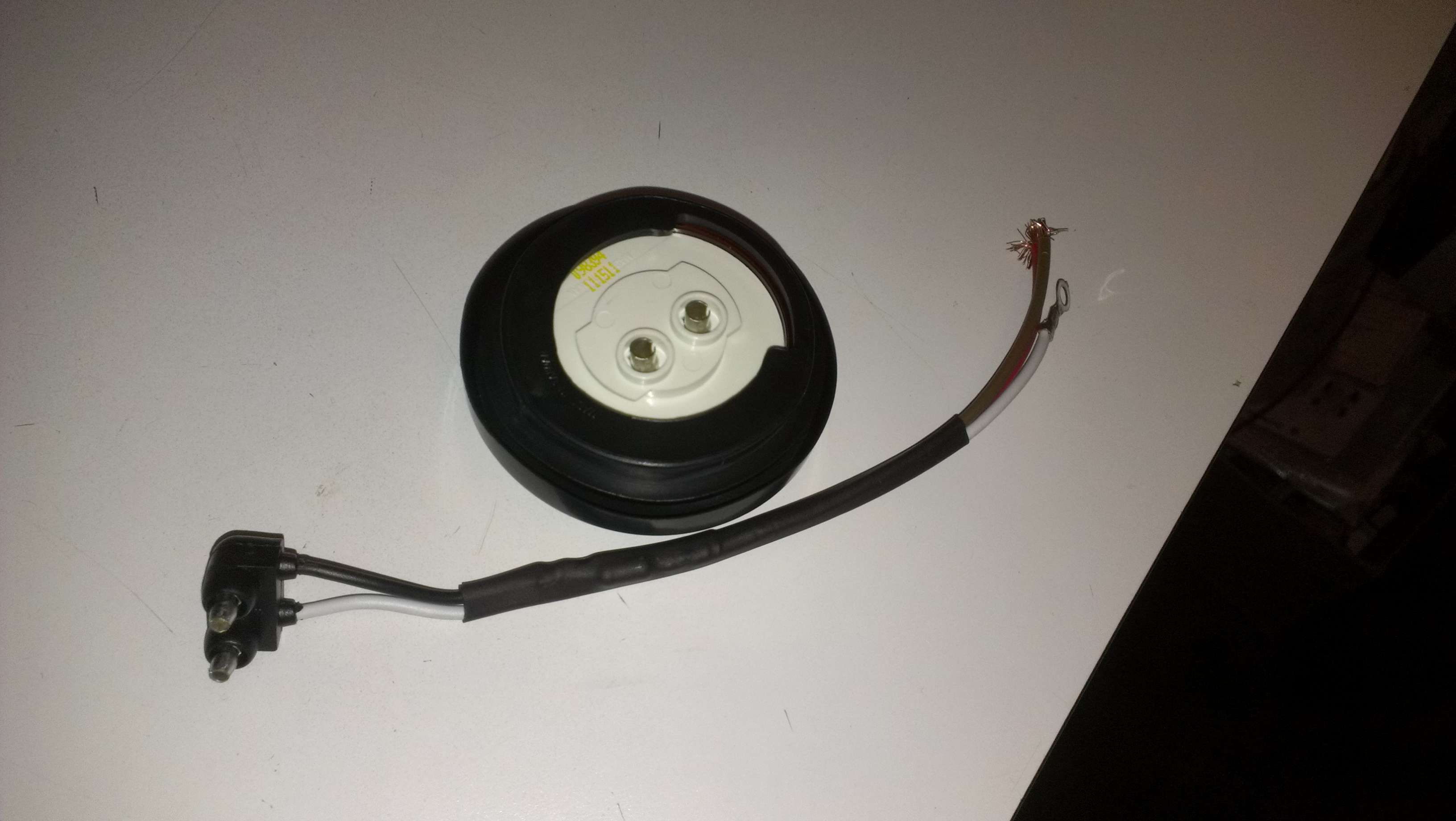

LED tail light from Lossa Engineering (DOT approved)

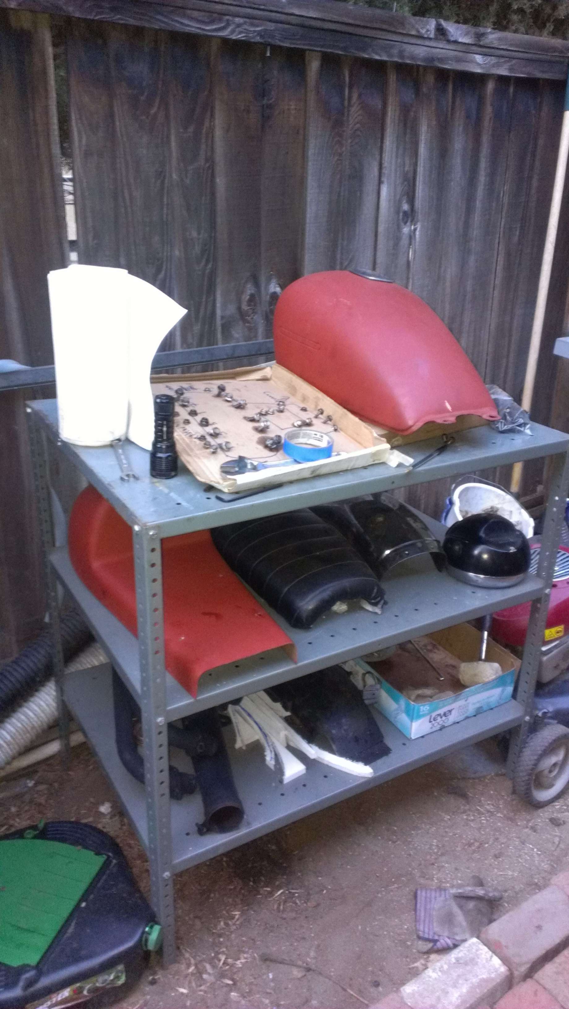

Stripping the bike more. Stuff in boxes and racked.
Looking at the tank for inspiration.

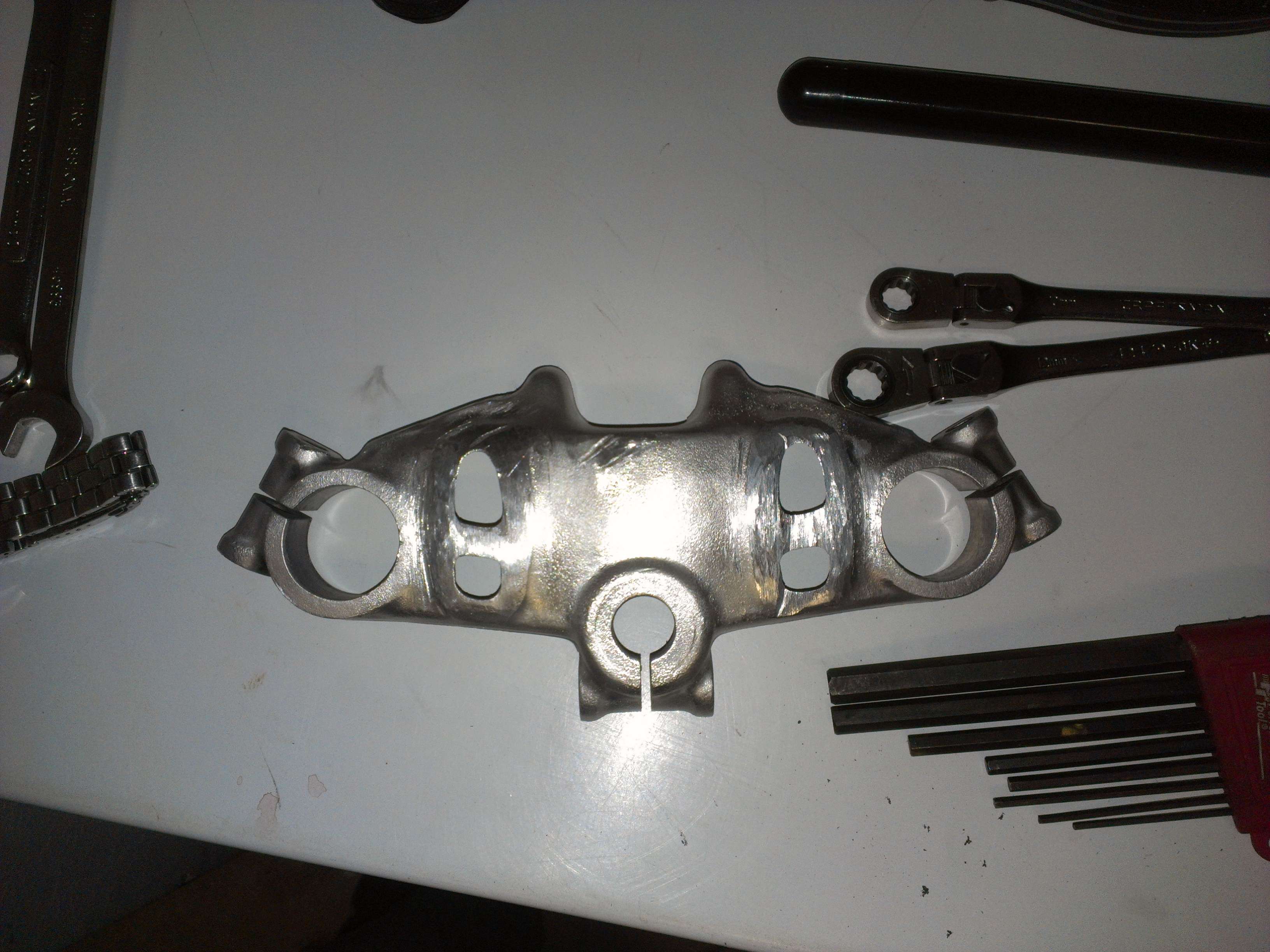

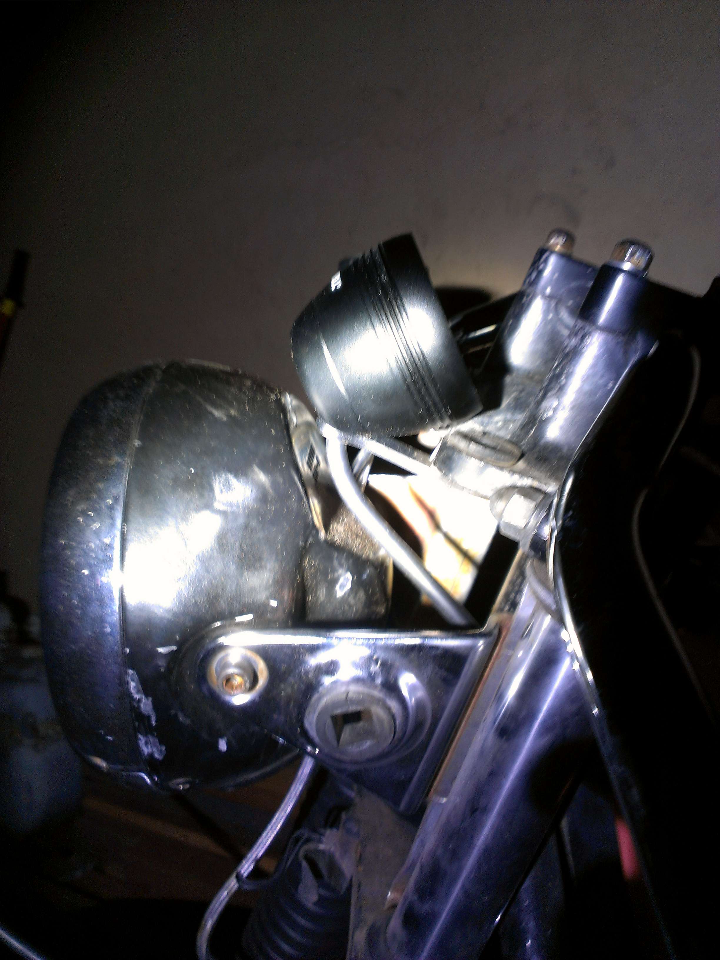

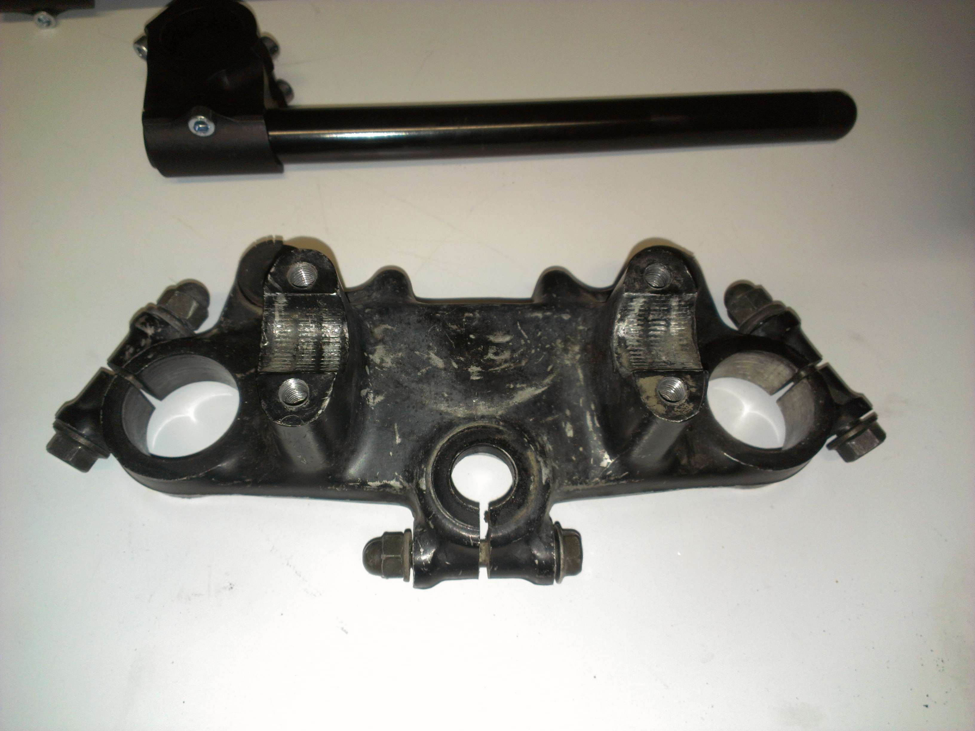

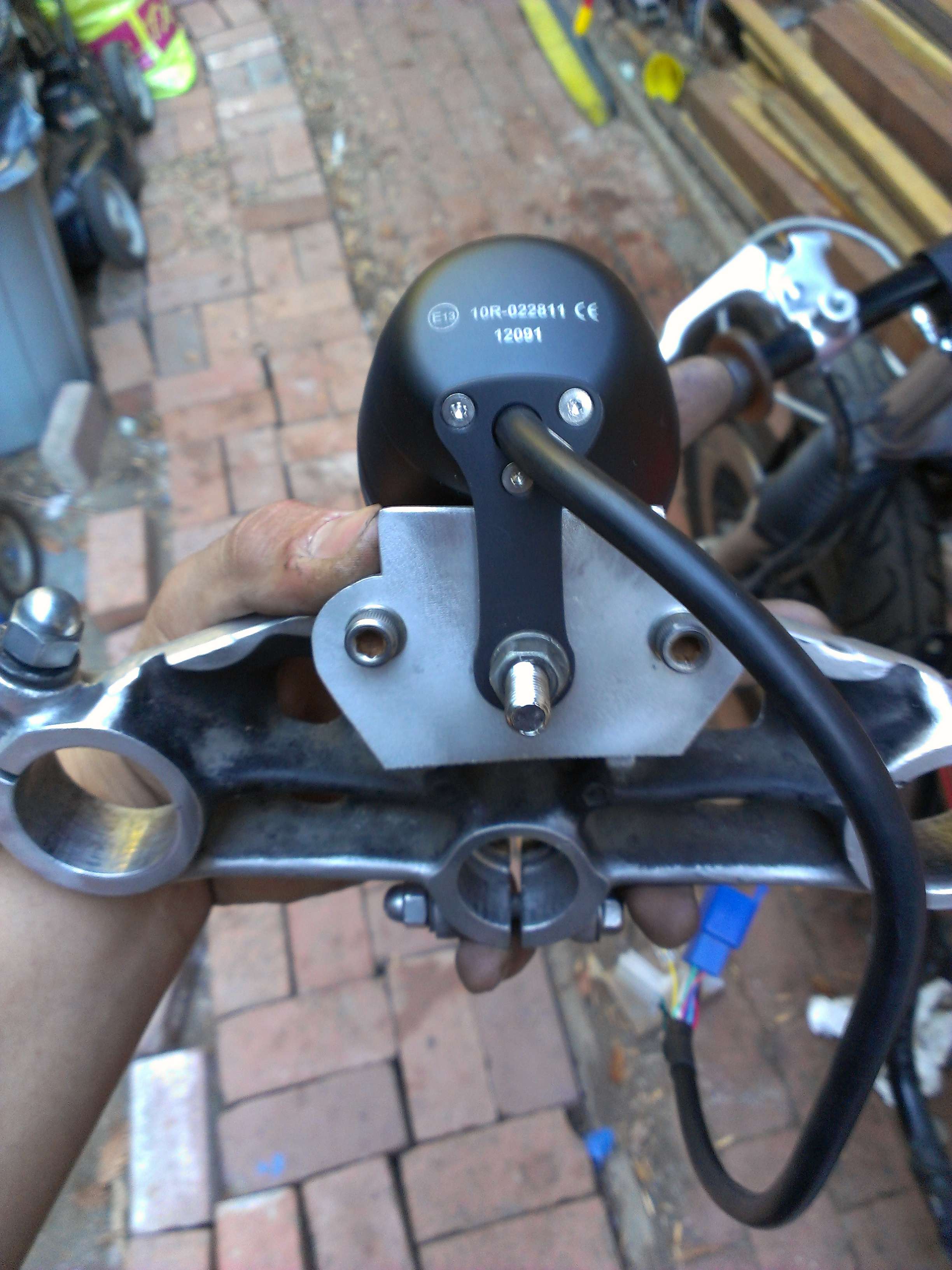

They hit the bar mounts when I install them on top of the triple, and the stock headlight ears wont let me install it below.
Either way the bar mounts needed to come off. I had some time when I got home from work last night and I started on it. It is so much harder then I thought it was gonna be...
One side cut
I couldn't get a good angle with my cutoff wheel so I had to do it all with a hacksaw. The aluminum is way tougher then you'd think.
I ground down as much of the metal as I could, used my big wire wheel/grinder and started filing.
Good enough, it was midnight.
I want to clean it up a bit more and prep the upper and lower for paint since it's supposed to be nice today.

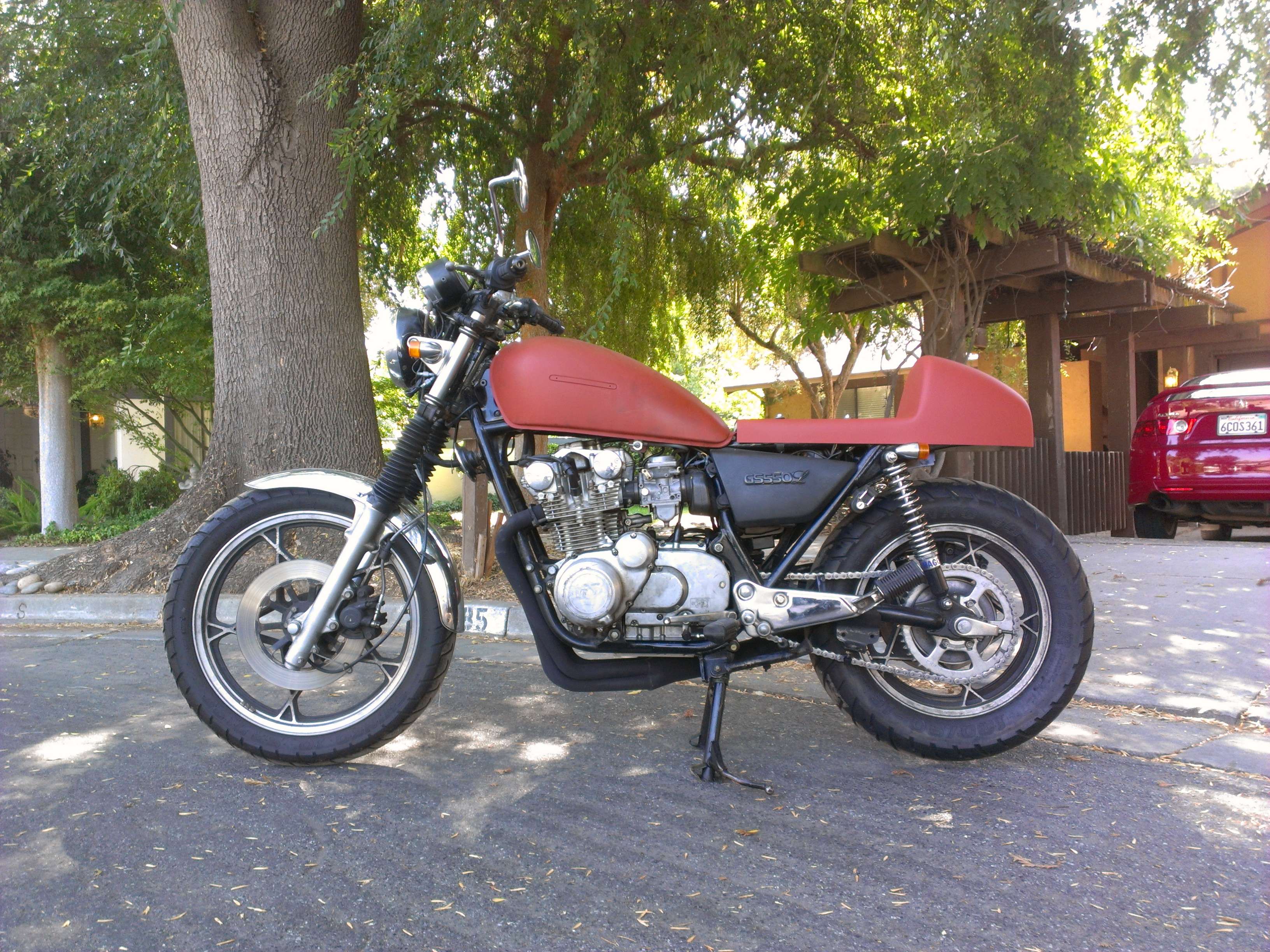

I still want to use the Yamaha tank, but it's gonna take wayy more fabrication then I first thought. Pretty much nothing on the frame lines up at all so I'm gonna have to make and weld in front and rear mounts for it, plus make clearance in the front for the top triple. So until I get a welder and better fabricating skills Im gonna go with an easier tank to mount.
I put on the clip ons and the 650E tank I got and wheeled her out front.

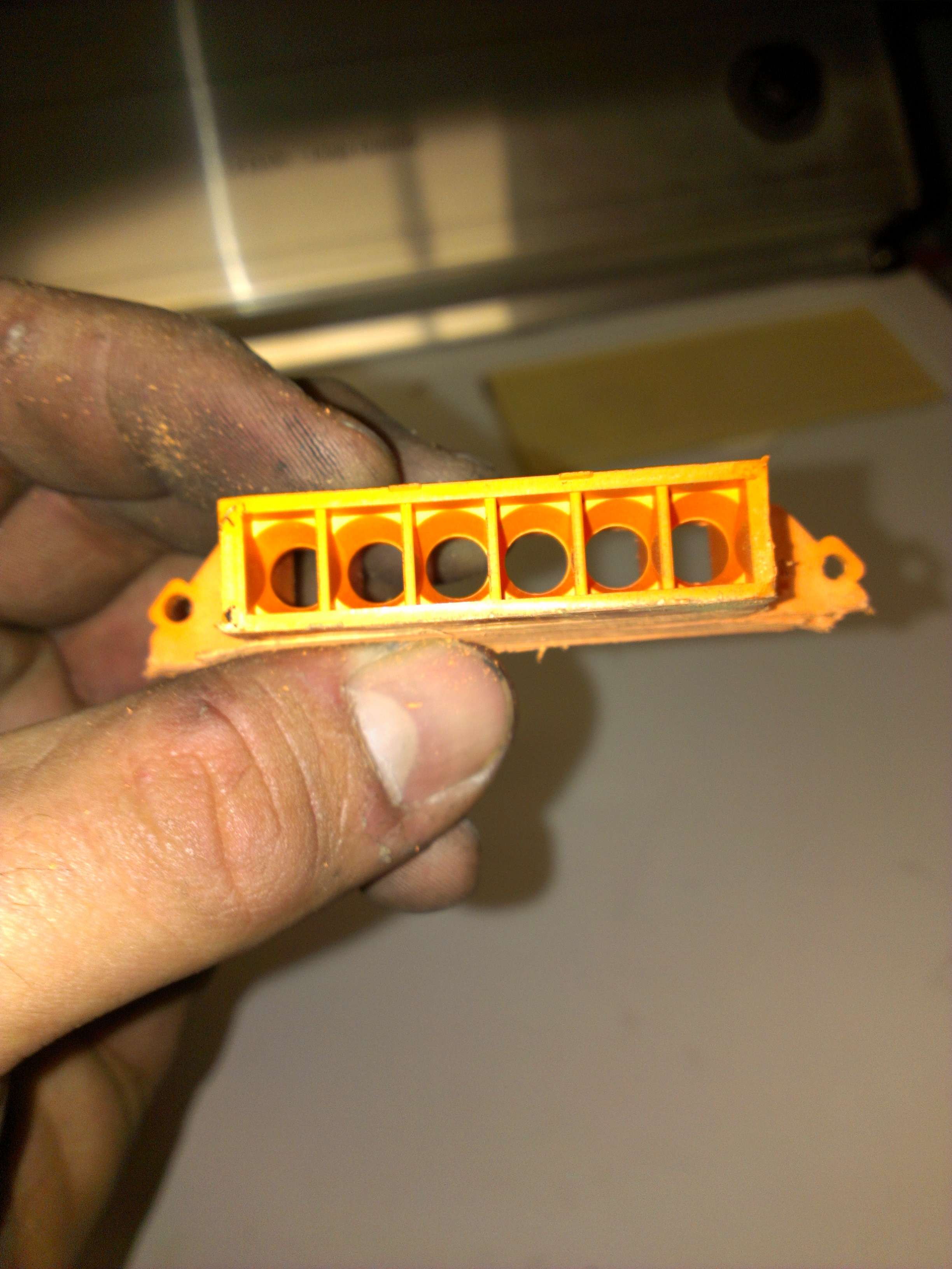

I wanted to make a bracket for my Acewell, I was toying with the idea of putting the gear indicator lights on it.
Cut away, the red 1-2-3-4-5-6 inlay sits on top of that
The lights themselves
There wasn't any room to mount it with the plastic housing so the first bracket I made I made a window for the bulbs to poke through. It ended up looking like ass so I made another mount and left that out. I'll find somewhere to use it, when I put a half fairing on it I'll probably stick it some where on that. I know the bottom is crooked, it was too long and hitting the steering lock. I'll file it down straight later.
The aluminum controls and levers got hit with the big wire wheel. I was thinking of buying a new pair but all I can find is Emgo ones and they aren't nearly as quality as the stock units. Once the old paint and yellowed clearcoat got taken off they looked pretty good. The semi shiny machine brushed look is nice I think. The Tomaselli grips are on there too.
I don't have the clip ons angled way down and back because it's so much more comfortable this way.

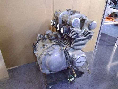

I found a decent deal on a complete GS650G engine, it's getting crated to me as I speak. The top end is getting put on the 550 block so I can keep the 6 speed tranny 8) . My little 550 is getting bumped up to 674 cc's, and getting an additional 24hp+. This should be fun.

So a 650's cylinder/ pistons and head on a 550 gets you 674 cc's, this I did not know. So the 550's rods are longer to increase the stoke over the stock 650? and a 24hp gain to boot? DAMN!
I want to do the 7/11 swap (1100 engine for my 750) so I can make some BIG numbers... someday. ;)
650 top end will basically bolt on, you'll have to bore the top cases to accept larger sleeves... I did one with a 650 top end resleeved with cb350 sleeves which were machined a bit to fit properly, then bored for gs750 pistons, went from 550 to around 730
