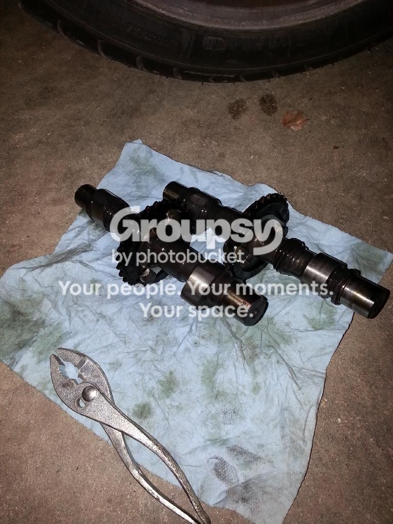

Ok, probably the last upgrade to this one for a little while:
Doesn't look like much, huh? Well, those are the stock 450 camshafts. I swapped in some cams from a GS500E (.015" more lift on the intake side, and .004" more on the exhaust side) since I was checking valve clearances and I had the cams laying around.
Ok, back to work ......
Re: GS450 "Sport" - Yep.......progress. Resto-mod just went out the door.
Neener neener :P My 569cc GS engine has Mega Cycle street strip cams.LOL
So which cams are you running now,GS5?What is the red line on the 450?I know my 89 GS5 has the red line marked at 11,500rpm,but all my other GS5 have the red line at 11,000rpm,IIRC. Dgyver on GST ran some aftermarket valve springs.They can rev to 13,000 before valve float sets in,but I think the engine has to be converted to run shim under bucket. BobB over there has done it on race bikes before,I believe.
Haha! Megacycle would be nice, but the GS500 cams were FREE!
I'm running the GS5 cams now. The 450's redline is 9500 rpm, but this bike has only seen that once or twice. It's my daily driver!
I was reading up on camshafts recently, and Bob's name came up a few times. His, Mekanix, and Burning1. Tons of great info around......

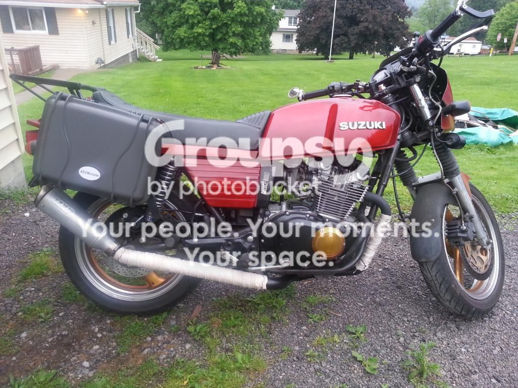

I'm happy to say this project is basically finished. Some bolts will get swapped out for stainless ones, gas tank will probably get a fresh coat of paint over winter, etc., but I'm calling it done. Got back from a 150 mile ride today and here's how it looks:
I shortened down the exhaust a good bit since the last picture, and finally got the jetting down 99%. I was having a huge flat spot around 4k rpm because the floats were WAY off (my fault - I bent the tab while messing with the main jets). Here are my notes about jetting in case anybody finds this on a Google search or something:
First generation GS500 carbs on a GS450:
K&N lunchbox filter (part # RU-2970)
Pilot jets: stock 37.5
Mixture screws: 4 turns out
Jet needle: raised by .040" with washers (2 washers per needle)
Main jets: 132.5
MAC 2-1 exhaust with a 3" Supertrapp universal muffler (with 9 discs installed)
That being said, I need to get some #40 pilot jets and I might try 135 mains. And I'd like to get rid of the Supertrapp for a modern stock muffler, but I'm in no rush at the moment.
