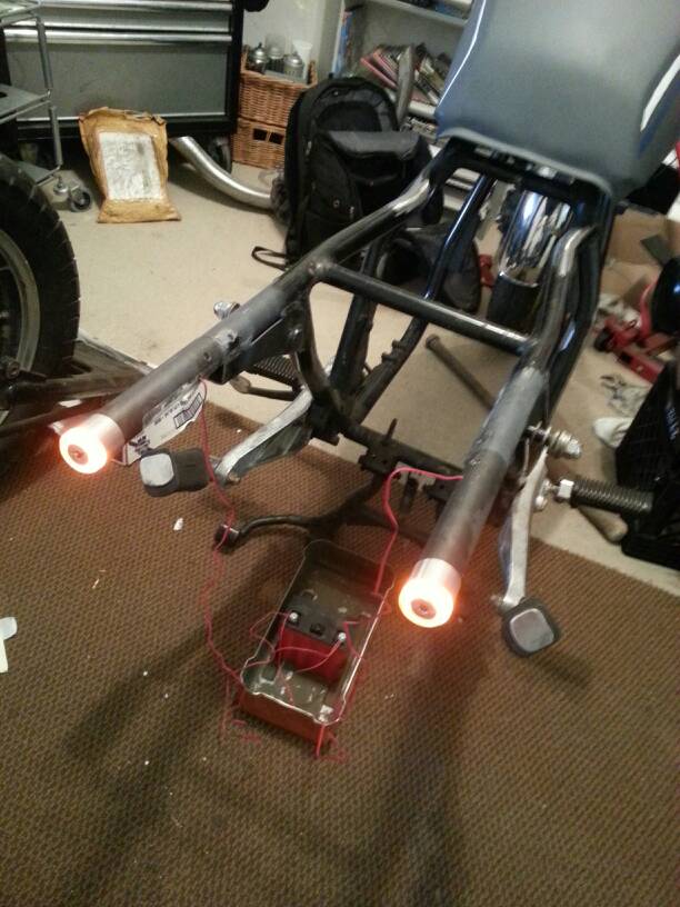

Proper frame slugs from dime city, easy to get a perfect fit, drilled holes and tapered the tubing to get better welds
The frame is almost done, have threaded bungs to weld on that are going to hold the fender, also matching diameter bar end turn signals are going to be fitted in the ends of the frame for a clean a functional rear end
Next up before I can mount the fender I have to mount my battery/electric junk box first
Here's a little taste, I'll post more later when I get the batt/electrics box cleaned/mounted up and let me tell you its pretty unique and 70 years old

WW2 50.cal ammo tin, cut down for the battery/electrics box, couldn't be more of a perfect fit, I will hopefully have it mounted by monday
