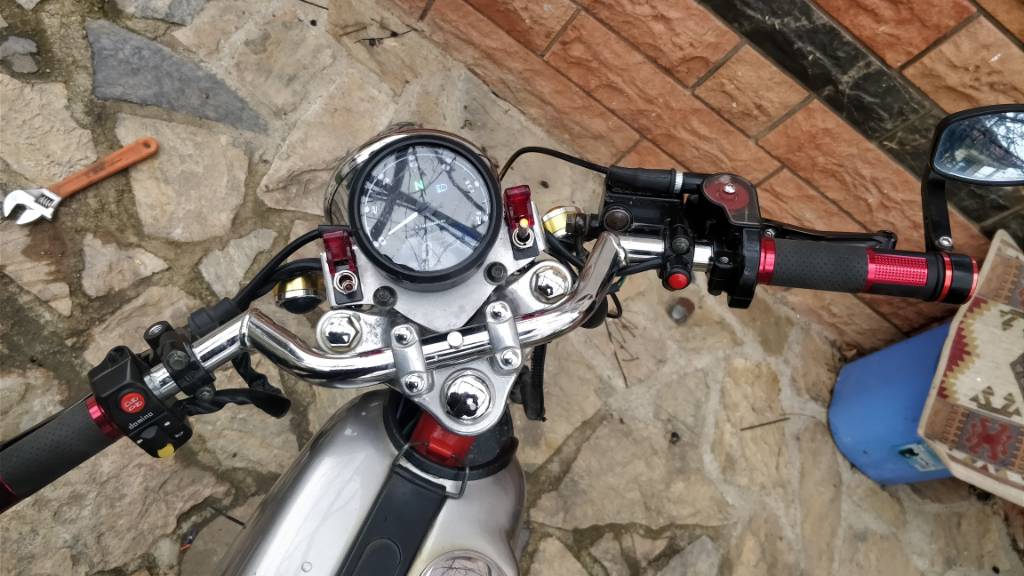

Got a few days off work now, but the weather has turned to cold so progress is slow. Thought I'd tidy up the front controls. Ordered a load of stuff from China a while back. Had grand plans for a rectangular box fitted on top of the fuel tank but scrapped that cos of the leaky fuel so slowly just replacing the forward controls
One for the lefthand side, metal...and smaller, wiring was just a case of matching the old colours to the new
Doesn't have a main beam flasher but it is a small price to pay for not accidently hitting the horn
Other side/speedo is still in progress...hopefully get a few days of not rain to get it finished.

Finally got the beastie and put back together and working again...basically when I had her apart I rejetted the carb with a 45 and 100 (didn't have any smaller main jet and she's derestricted with a pod). So after all the electrical work tried firing her up and she was sparking but not starting so I immediately thought I had ballsed something up (broke a safety switch or wired it wrong) so pulled everything apart and double checked all my work and still the same. Eventually bumped her and she started but running horribly. Will only do one thing at a time and then test from now on. Jetting was easy but the 100 was way to big, horrible bogging around 4500rpm so went back to stock (90d?) and she's back to life ;)
Anyway, took a couple of pics of the electrics, like the all in one speedo (about 40us) and just moved some switches around to make way for the fast throttle.
