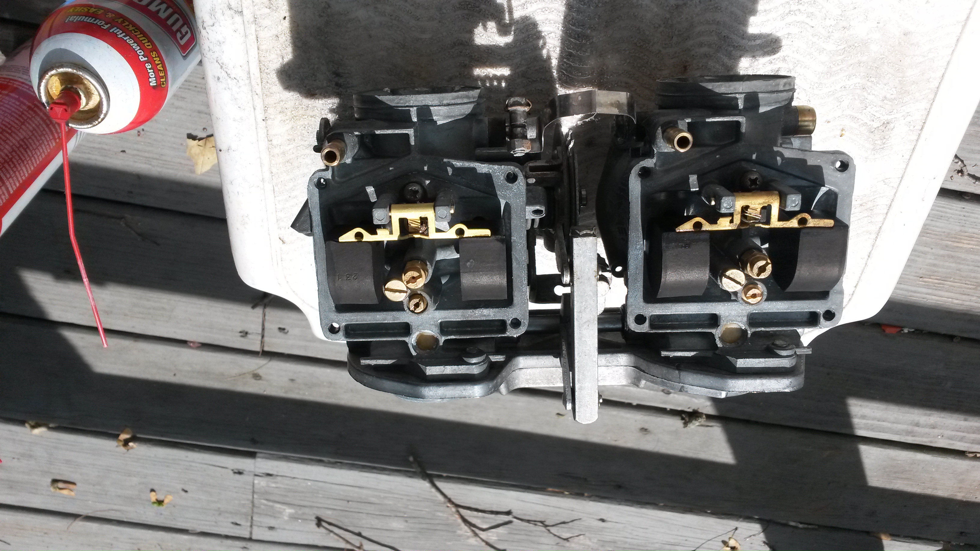

Alright I checked and all of the jets are in the correct locations and turned the slides back around so that the holes are facing the airbox. When spraying carb cleaner through all the holes and passageways I noticed that I have an leak on the side of the carbs for (I think) the primary circuit. See the picture. This doesn't explain why it is running rich on both cylinders though.

What is that thing the leak is coming from? Neither of the sets of cabs I have has that knob thingy. :o
There is a boss with a brass ball blocking it, all the 360 carbs have them
You could probably put some JB Weld on it as long as you use 24hr stuff it shouldn't block passage to pilot jet
Well I think the passageway was already blocked from the initial damage. None of the carb cleaner was coming out in the in the venturi like it was for the other right carb. I already ordered a new set from ebay.
If they arrive w the original diaphragms. Give them a try to see if that helps the midrange rpm richness w the stock filters. Then try the JBMs and see if it worsens.
After you go through them w a fine toothed comb and get em cleaned up properly, of course.
Some reason that thing looked like a knob to me, had to go back and look at the full size pic to figure it out. That's nuts. :o

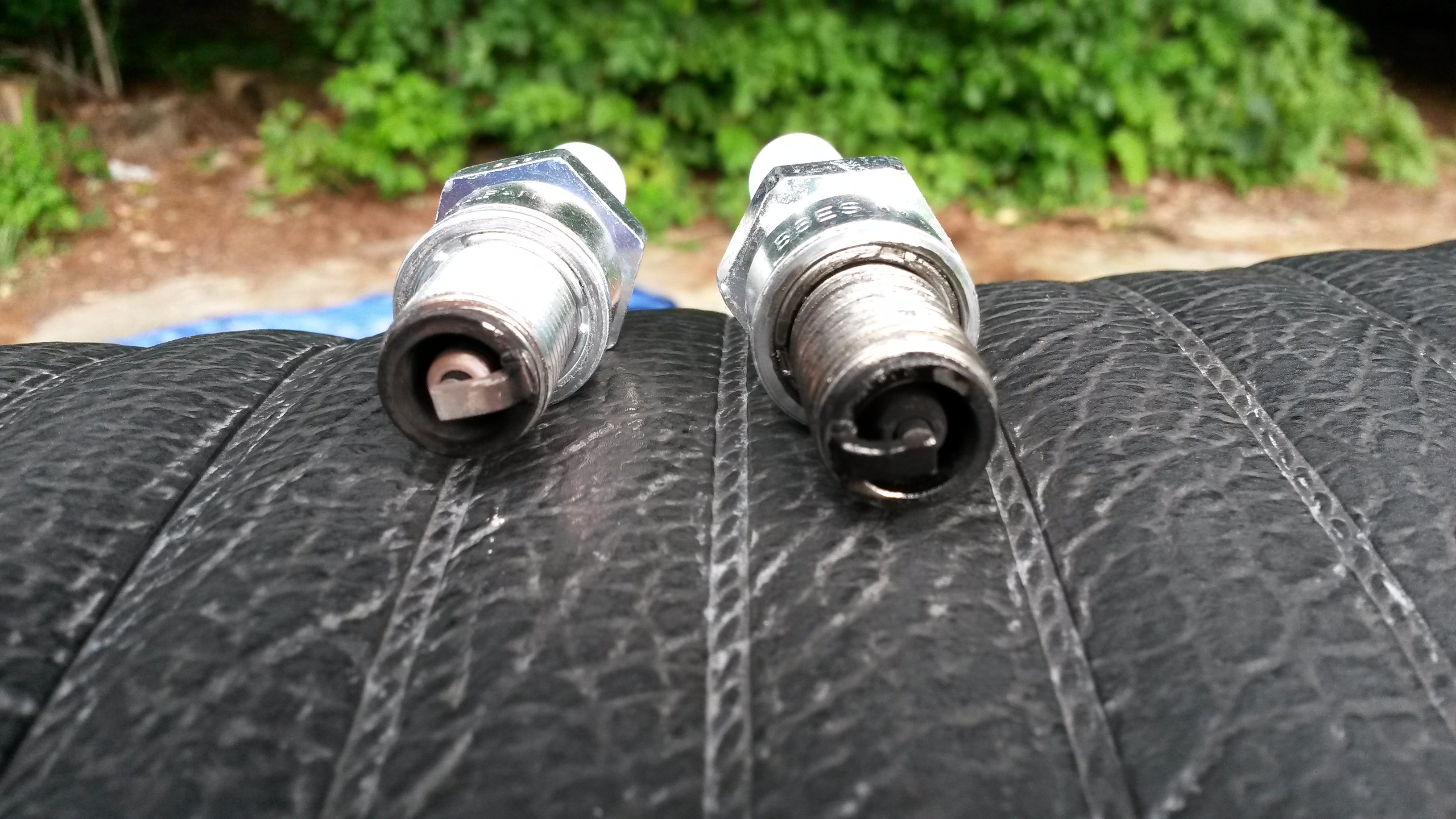

Well I got the new carbs off of ebay and got them cleaned up and installed. The diaphragms were intact so I used them. Also the floats are set at 21mm. The bike seems to be running much better now. But now that it is running much leaner I can tell that I am getting oil on the right sparkplug. Hear are some pictures.

probably time to check valves and compression.
what rpm were you running when you killed it for that pic ?
I would be very careful and do a few chops working her up to higher rpms w 100 secondaries installed she could get too lean.
You got stock filters and boxes installed correct?
w the stock filters and diaphragms maybe the 100s is exactly what she wants...I never tried that combo.
If the exhaust starts sounding flat, lacks power, pipes start glowing red hot, engine metal pings when you shut her off after riding at higher rpm acceleration or running 70 + mph in 6th you will need to increase secondary size.
