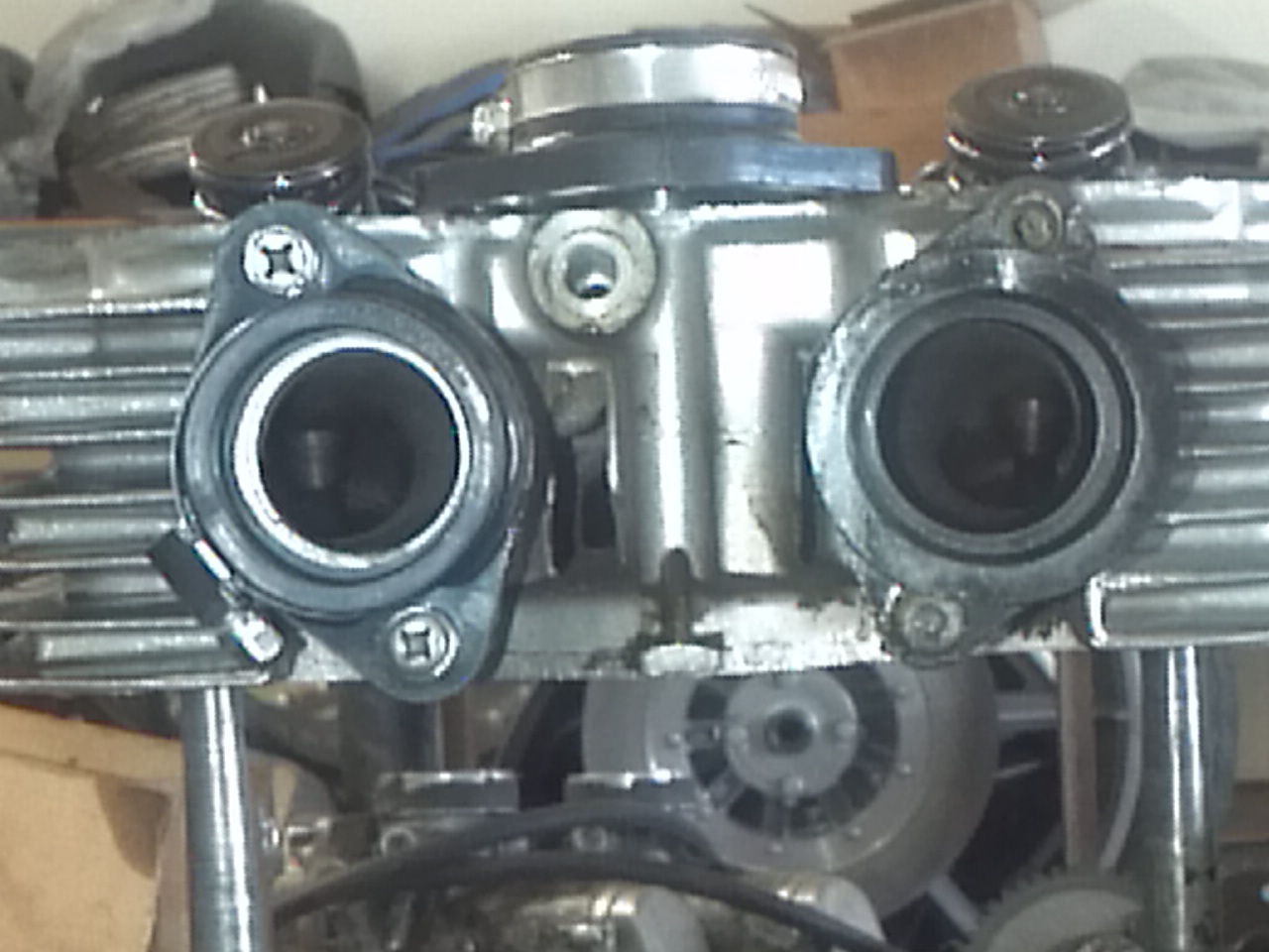

Stock carb boots will not work with Mikuni VM carbs.
Check out the location of the groove on the stock Keihin carbs vs a Mikuni vm34.
The VM series has more space from the groove to the end.
Also included is a pic of a Mikuni carb boot that fits a vm34 to a KZ440.

Then why were you installing bigger carbs and unwilling to do a little port matching.
The boots in the pics are only slightly larger than than the vm34s.
I dought your making enough power to notice the difference with an .080 step in the port.
And who said anything about a damn Yamaha 650?
Machining? I'd rather not until I take the head off when I rebuild at a later date. As most people who will be buying a "universal" intake boot will probably be expecting a direct bolt on application. Some people may not have the head off and no one wants to attempt to do it with a dremel and get metal shavings all in their engine.
I think we were all talking about the VM32's not the 34's. So your boots are larger than the vm34 boots?.. I may not be making enough power to notice any difference but so what? I want it to line up perfectly regardless of how it performs, I may not notice the difference at the throttle but I know the difference in my head... And for the honda 450's its about a .3-.4mm.. From the pics it looks like yours is about the same.
I was under the impression that the mikuni "universal" intake boots were only a perfect fitting, direct bolt on for the xs650 models and all other models would need work. I could be incorrect on that though as I can't recall where I read/heard that and I cannot find that information at the moment.
I used them on a cl450 and had to modify the mounting holes as they were too narrow or close together and they also had a gap or step around where they mount.
well, fuck i didn't even think about the difference in lip of the carbs..
anyone know of a specific universal boot for the vm32 that will work on the kz440... i just thought that a stock boot would do the job...
looks like i mkight be well wrong...

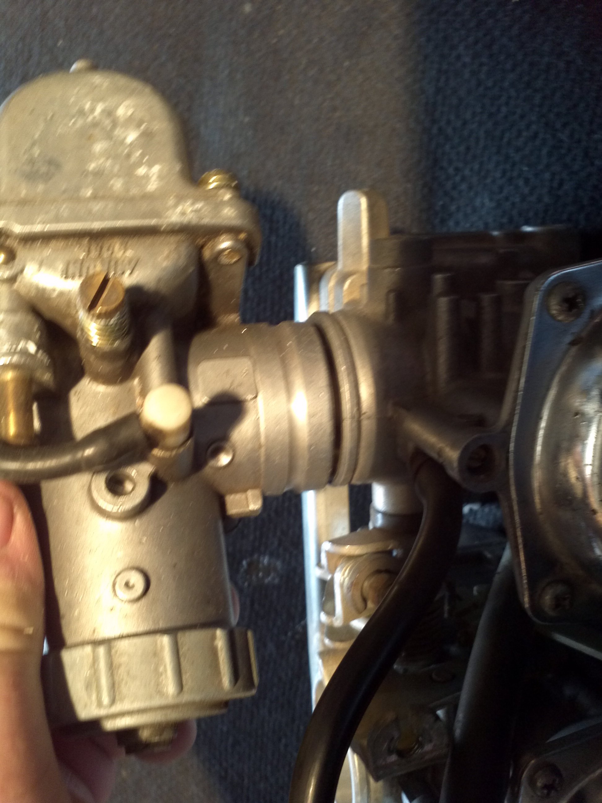

so my carbs have arrived all sweet and well....
my brother in law runs these on his xt500 with some a home made alloy intake/ rubber hose mount...
If these are clamped up tight to my kz440 intake boots, whats the chances of air getting in?? could even use a gasket seal for the groove in existing boot??
