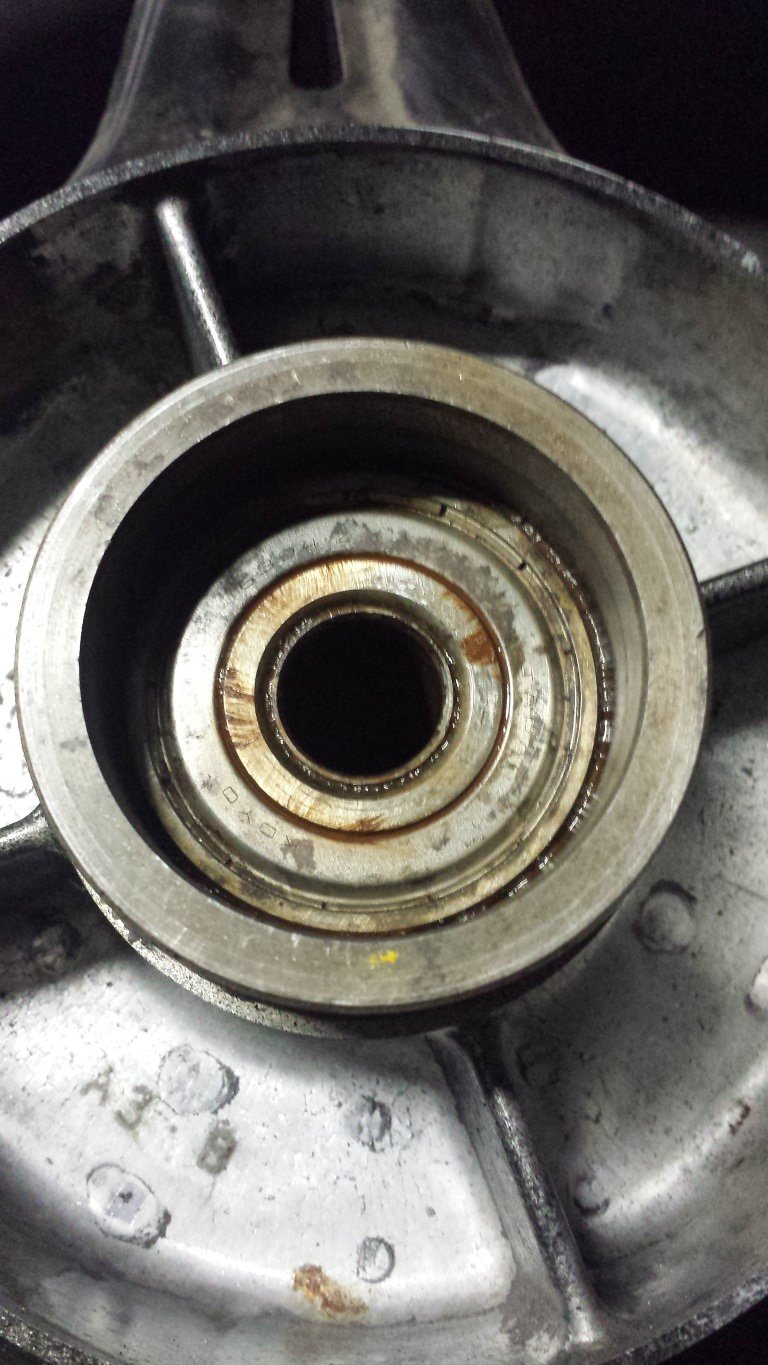

I've attached pics of both sides the thing that is making it harder is the full length sleeve so you can't get a punch from the inside to tap out.

Usually that sleeve will move around a small amount giving you a small ledge on the inner race to put a drift against. You will have to move back and forth across the race, a couple whacks on one side then move across.
Well what a nightmare......I finally got them out, there wasn't enough of a lip on the RH bearing with the sleeve to have a good go so I ended up having to pull the bearing apart by dremaling the centre and splitting then they just tapped out.
