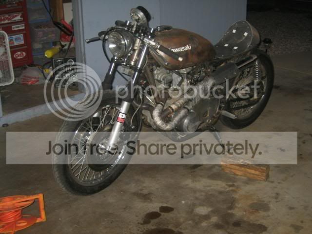

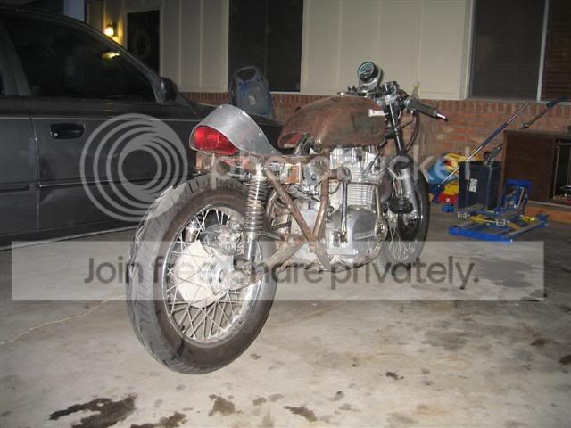

Hi everybody. Name's Matt. I like to build old bikes and old VW's. Current project is a '78 KZ750 twin that I bought for $40 off of Craigslist. She weighs in at 410lbs wet after everything I've stripped off of her. I still have to convert my rear brake over to the Yamaha R6 disc and caliper and purchase an XS650 front hub so I can run FZR discs and my 4 piston Nissins that i have laying around. I'd like to fit some alloy rims, but who knows when that'll happen. Those stock rear shocks are crap and I'm saving to get some works shocks. The forks are rebuilt with heavier oil and preload spacers. She is a LOT of fun to ride, and actually really fast now that she's soo much lighter. Anyway, enjoy the pics!

Hey Matt,
Welcome to the board!!.. I love the bike especially in its raw form.
What kind of exhaust are you running?
Welcome Matt, that bike looks badass.
Should be a blast with the modern brakes and with all the weight stripped off.
You should keep a photo-log and post it on here for others to see how to do a brake conversion - a popular topic that doesn't seem to get a whole lot of airtime.

Newman said:
Nice Job. I like any motorcycle better stripped to it's bare essentials.
Thanks man, I really love that ride of yours. I've poured over your photobucket album checking it out. Very creative.
locOleoN said:
Hey Matt,
Hi Leon, thanks! That exhaust is a 2 into 1 header that I built out of a VW Bug 1 5/8" merged header that I had laying around. The muffler is a Sportster muffler that I turned around backwards and cut the baffle out of.
It seems to work pretty well!
