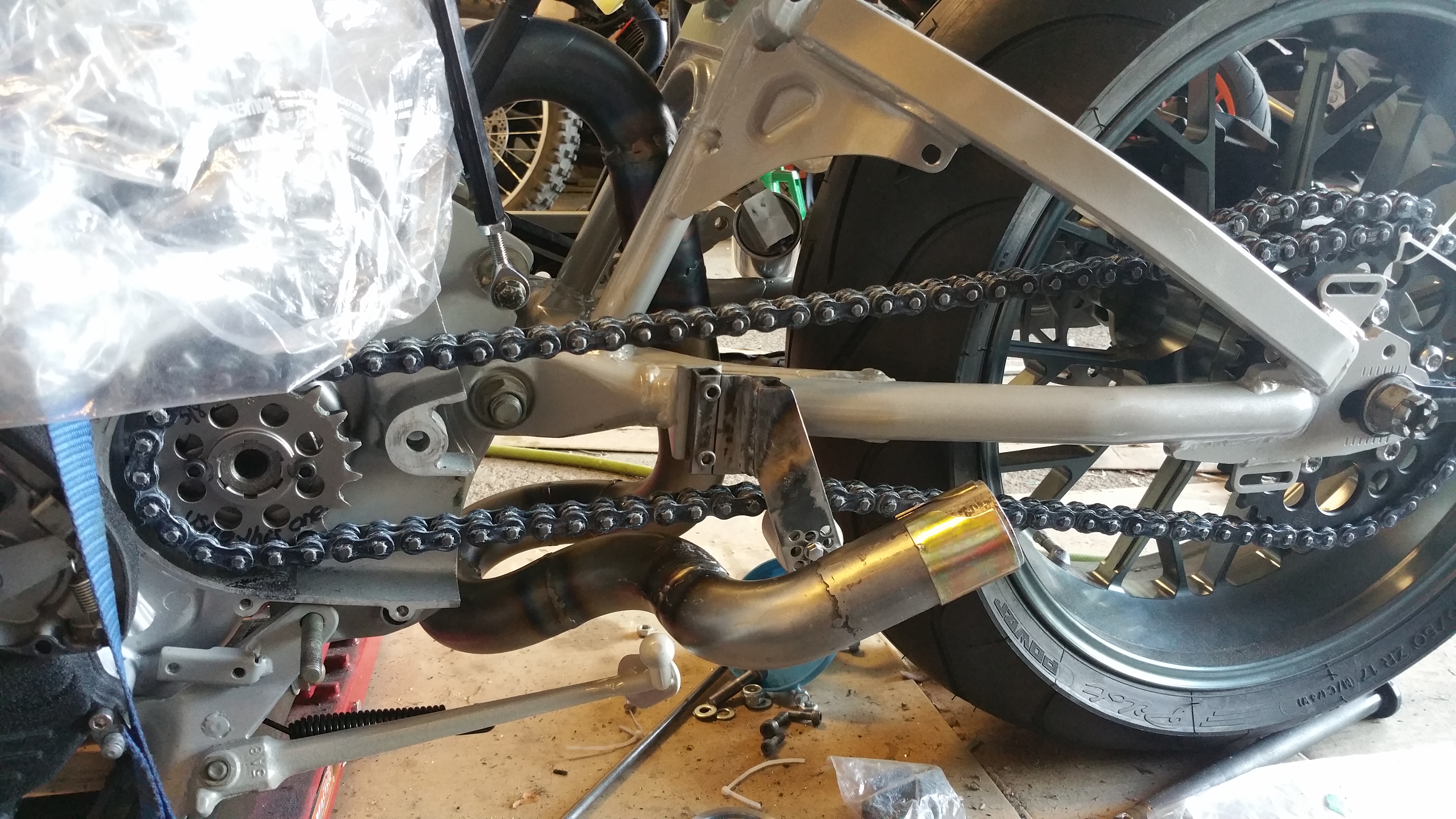

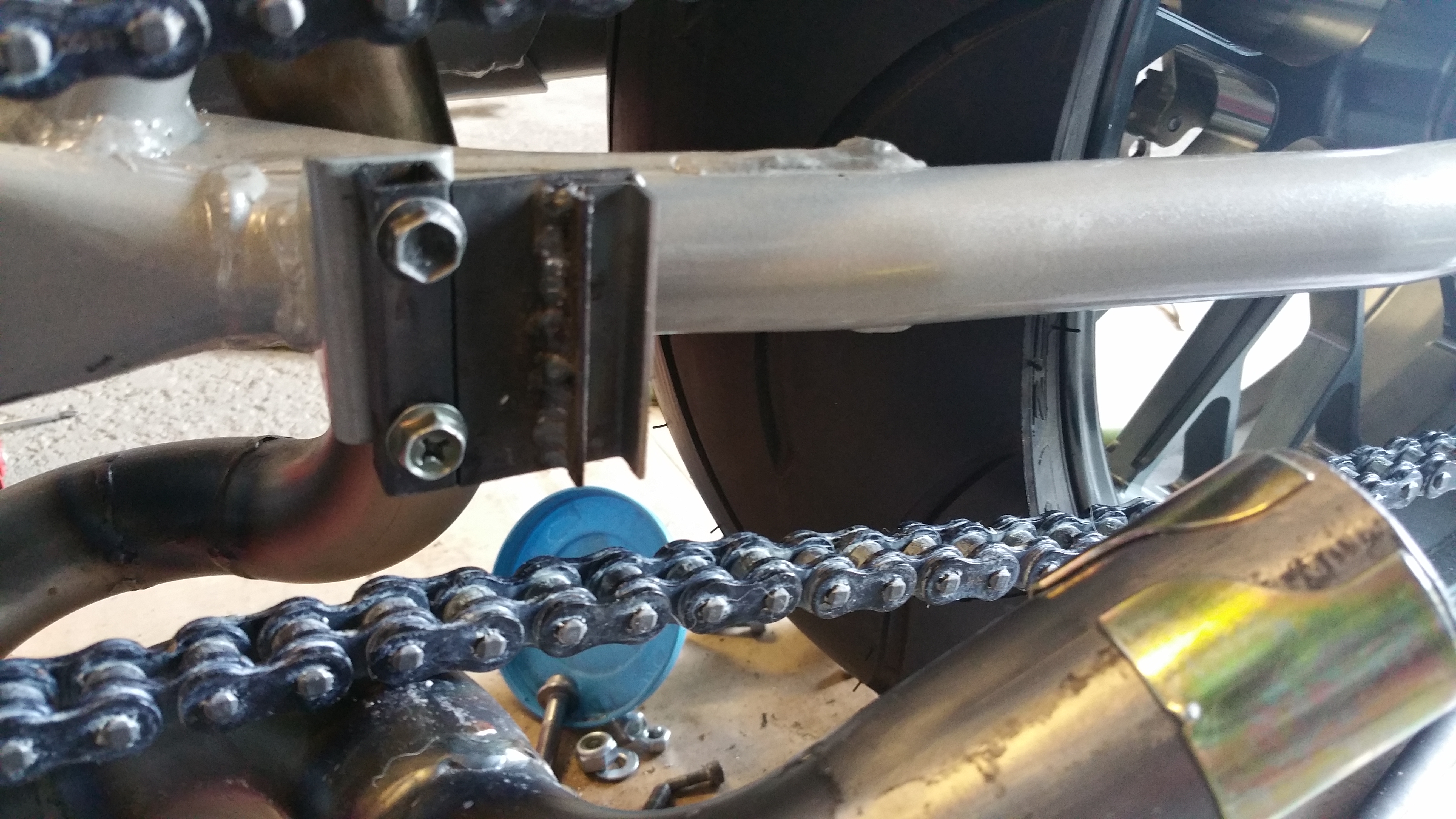

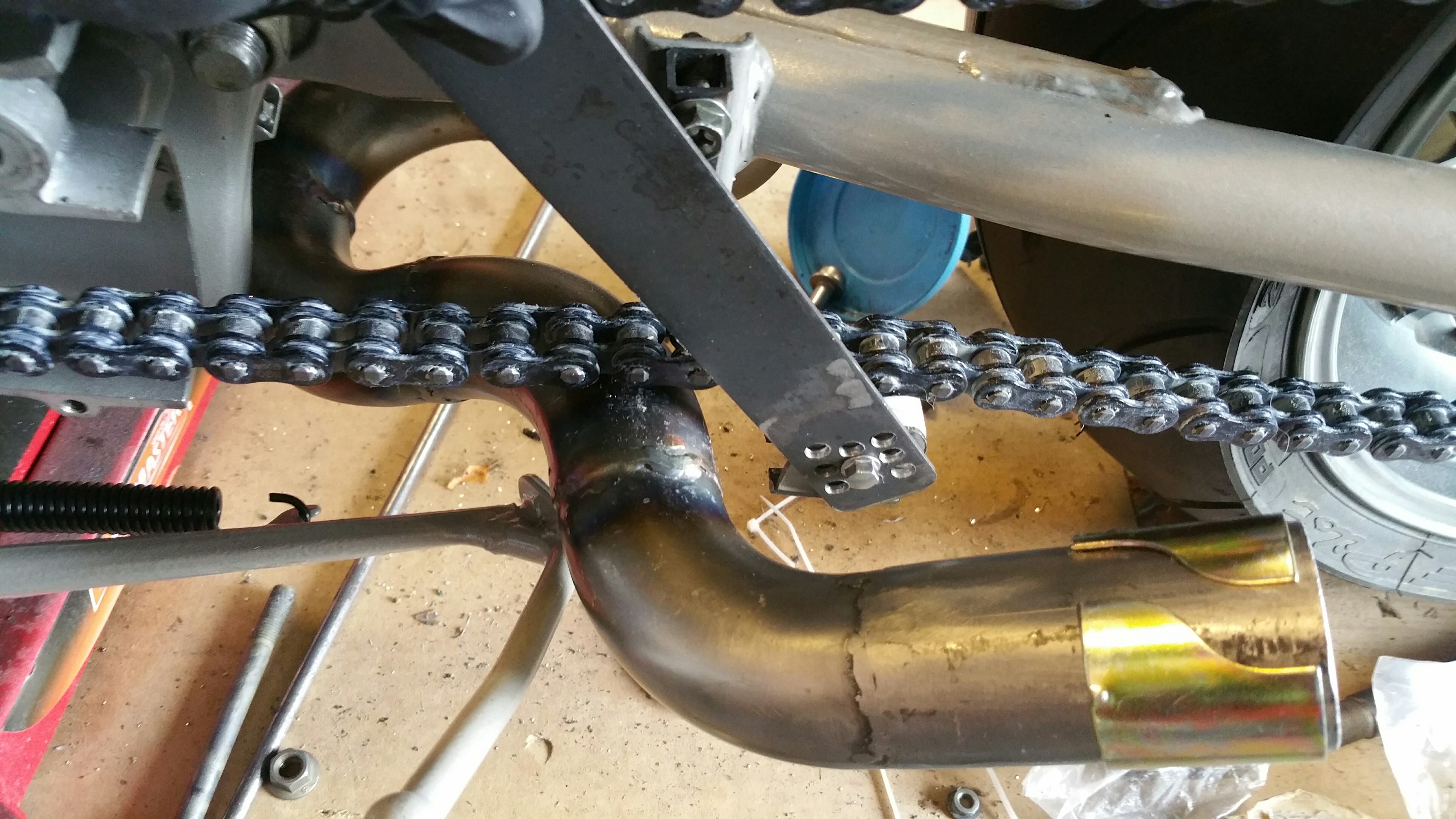

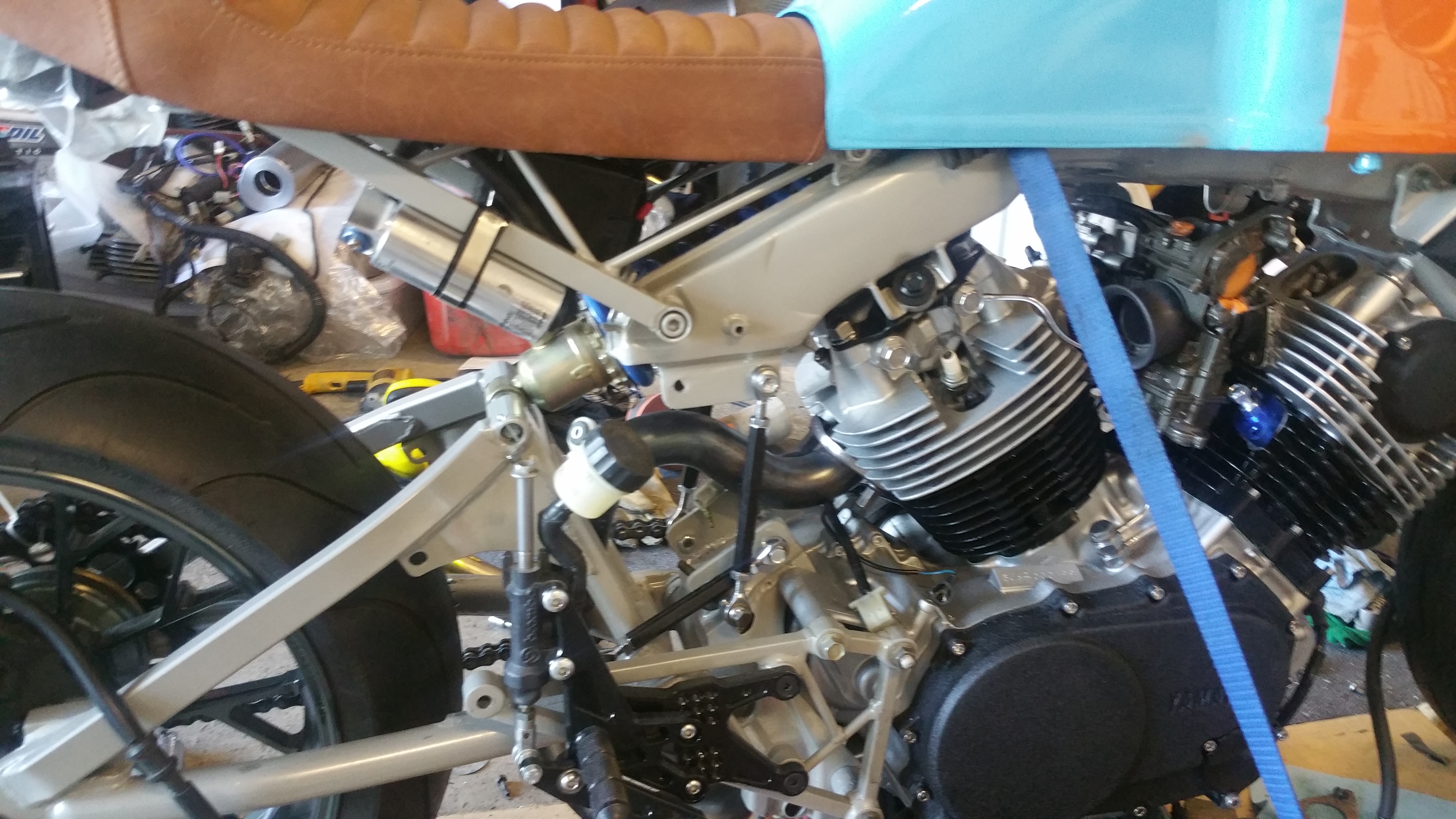

Got the chain hitting problem solved.

Looks like a good solution. Can't see from the pics, but do you have the suspension fully extended? Looks like clearance could be reduced since your roller is attached to the swingarm. Also can't really tell what material you used, but I would think the assembly would have to endure some pretty huge loads on deceleration. Don't have any experience with an XV, but I would expect engine braking on decel to be pretty strong. That arm will see a lot of repetition getting loaded up when ever you slow down. Loving your build - glad to see you back at it!
The idea is it moves with the swingarm. The rear shock doesn't compress much it's pretty stiff. It's made of steel square tubing and steel plate. The arm on its own allows for some flex. Dirt bikes have them on the swingarm too for donkeys years.
I don't think it will be as stressed as you think. But a test ride will tell.

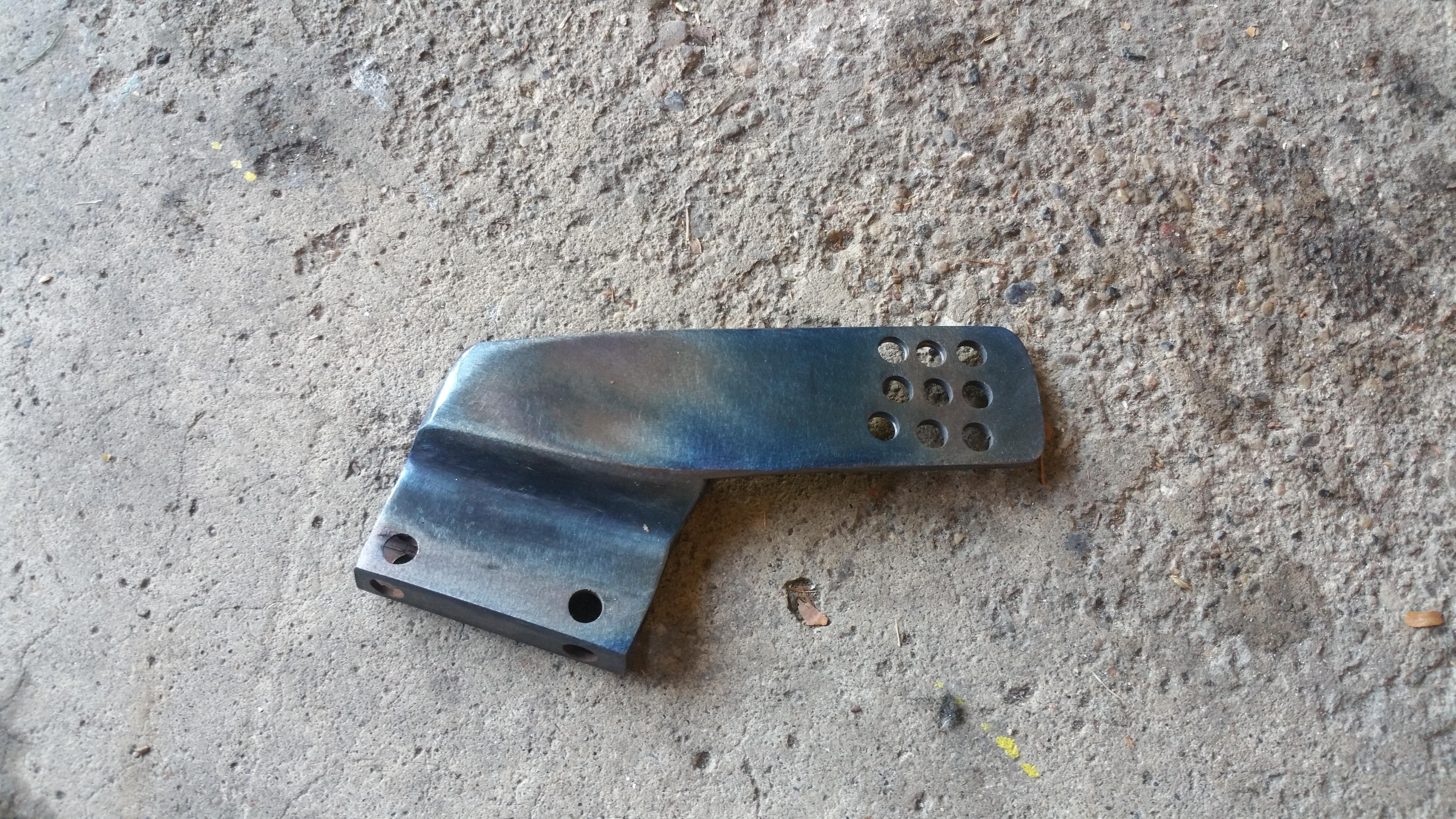

I reinforced the welds on the chain tensioner too, then in Hollywood fashion I hid the welds cause I couldn't handle seeing them. It's a tedious process as well.

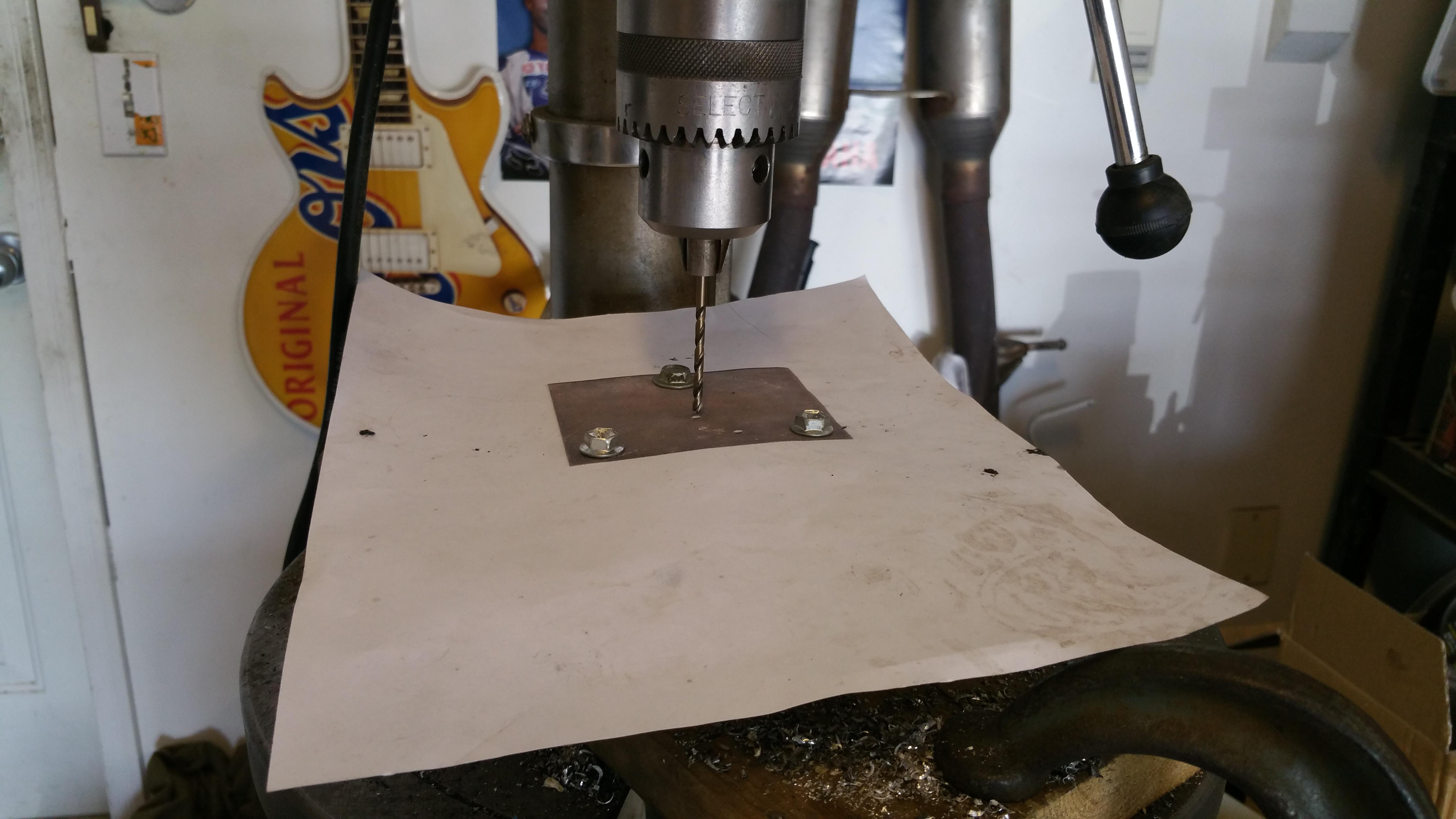

How the heck did you drill and tap the holes in the countershaft sprocket? The Mike's XS sprocket I'm using was case hardened and a Ti coated drill wouldn't even touch it. In the end, I was able to use the original XV sprocket retainer with 2 drilled aerospace-grade bolts through a couple of the existing sprocket holes, with castellated nuts and cotter keys. Even this wasn't a slam dunk, as I had to take a stone in the Dremel and touch the sprocket holes lightly so the bolts would line up with the retainer.
Something I looked at was a big external C-clip on the countershaft sprocket - there is standard industrial part that has the right ID and thickness for the XV shaft - but never got around to sourcing one from a bearing supply company. I got the idea when I was at a bike shop that works on KTM's; they had a little MX'er in for repairs and that's what it had. It would retain the sprocket, but I was never too sure that some sort of (nylon?) bushing between the sprocket and the cases would be needed or not to stop sprocket movement inward, though as one mechanic said, if the chain alignment is correct, the sprocket shouldn't move.

The only thing that's going to touch the case hardening is carbide. Ive thought about turning off the small hardened layer on a lathe with a carbide tool. Just the area around where the holes would be drilled. If you can get carbide drill bits that should work too. Taping it shouldn't be a problem once the holes are drilled.

Actually my industrial machinist did the work. He said it was really tough stuff to drill. It ended up at 7/16 offset all said and done. I used the retainer clip but got rid of the tabs. He's a smart guy and made the holes slightly bigger to get perfect alignment.
I think I ended up with 18, 38? It's been so long since I got the rear sprocket made. It was custom made for me by driven.

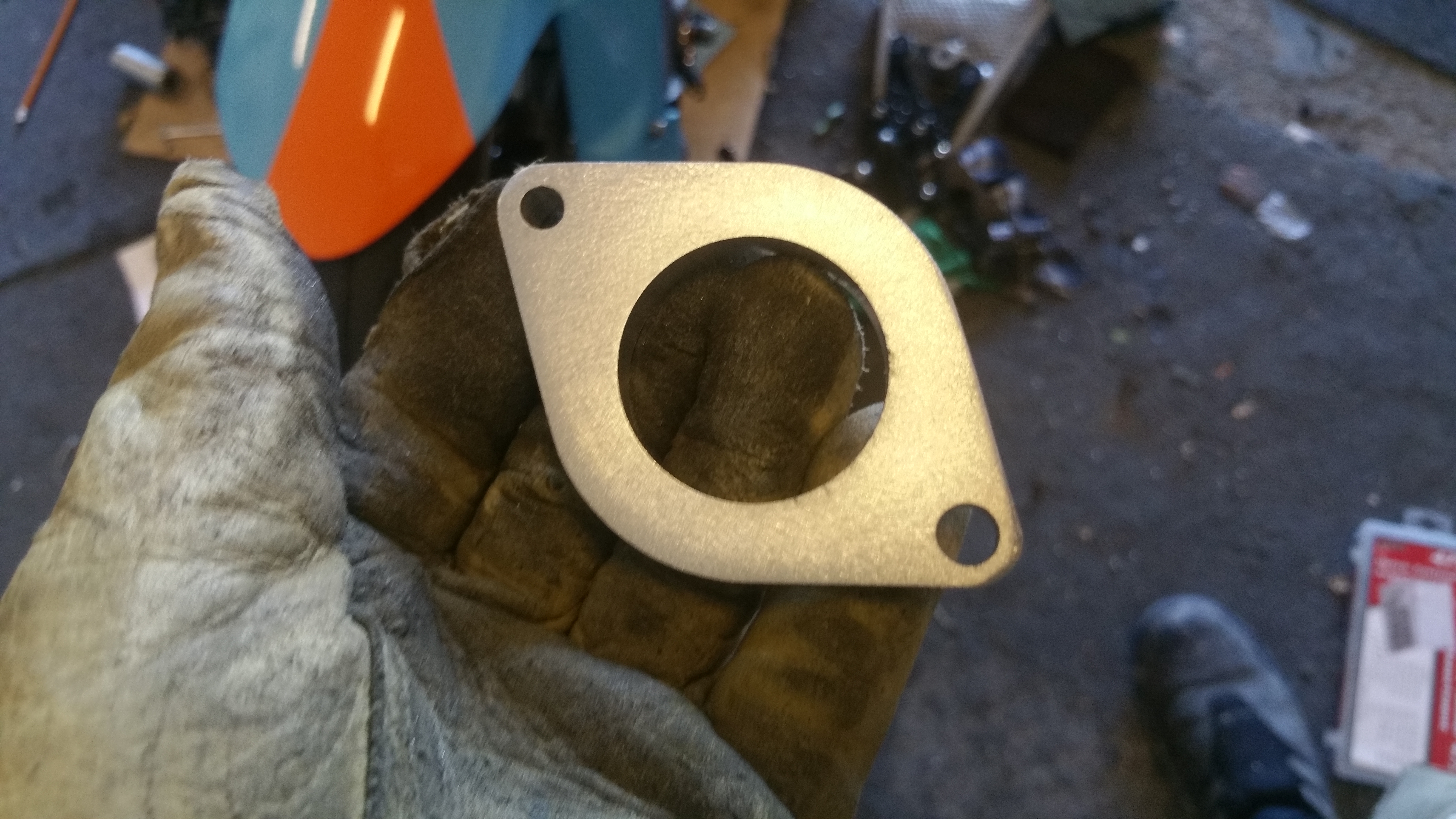

Ok work3d on the carb extension manifolds and tapered them to avoid the carb bumb fight. That worked.

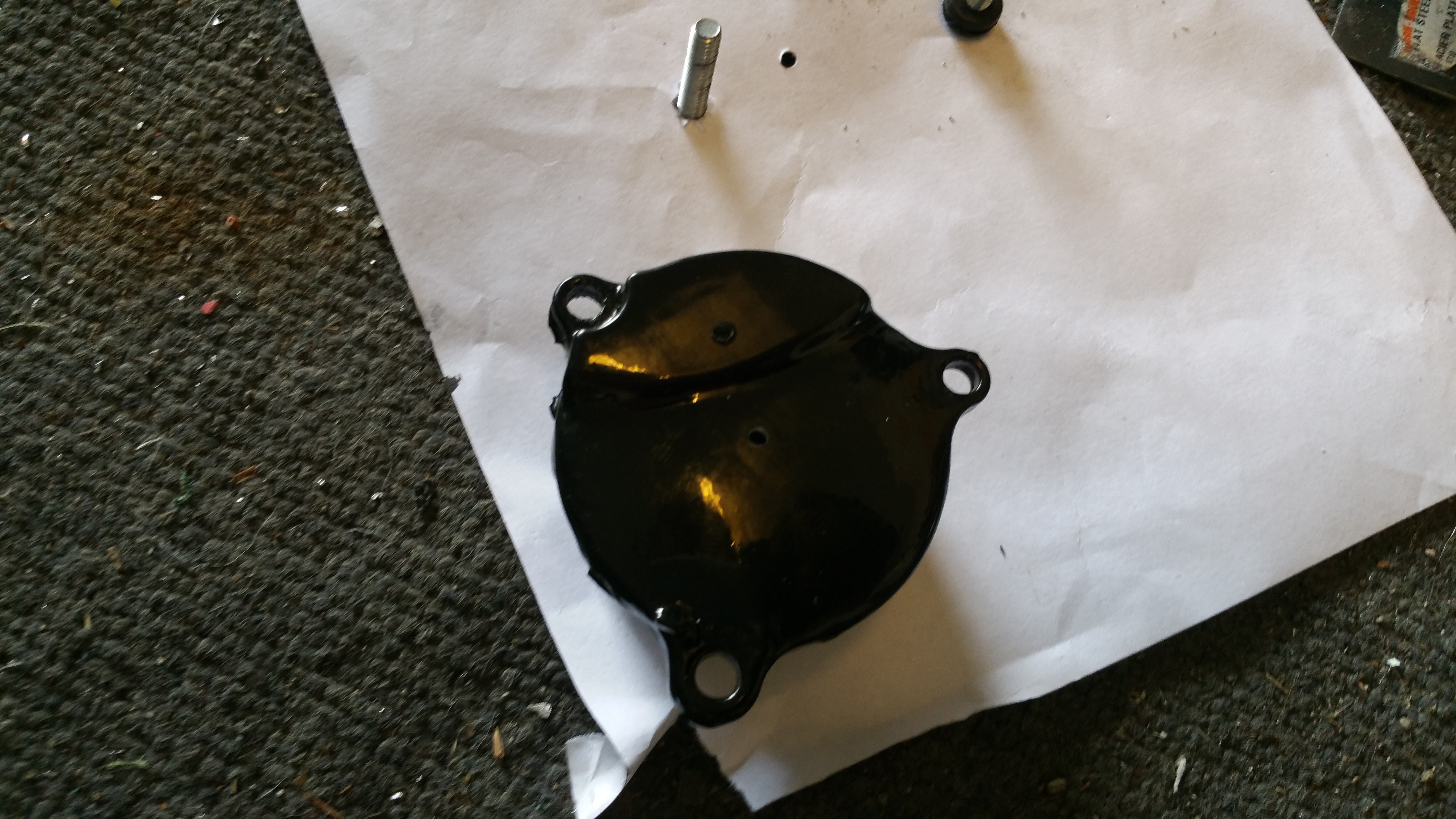

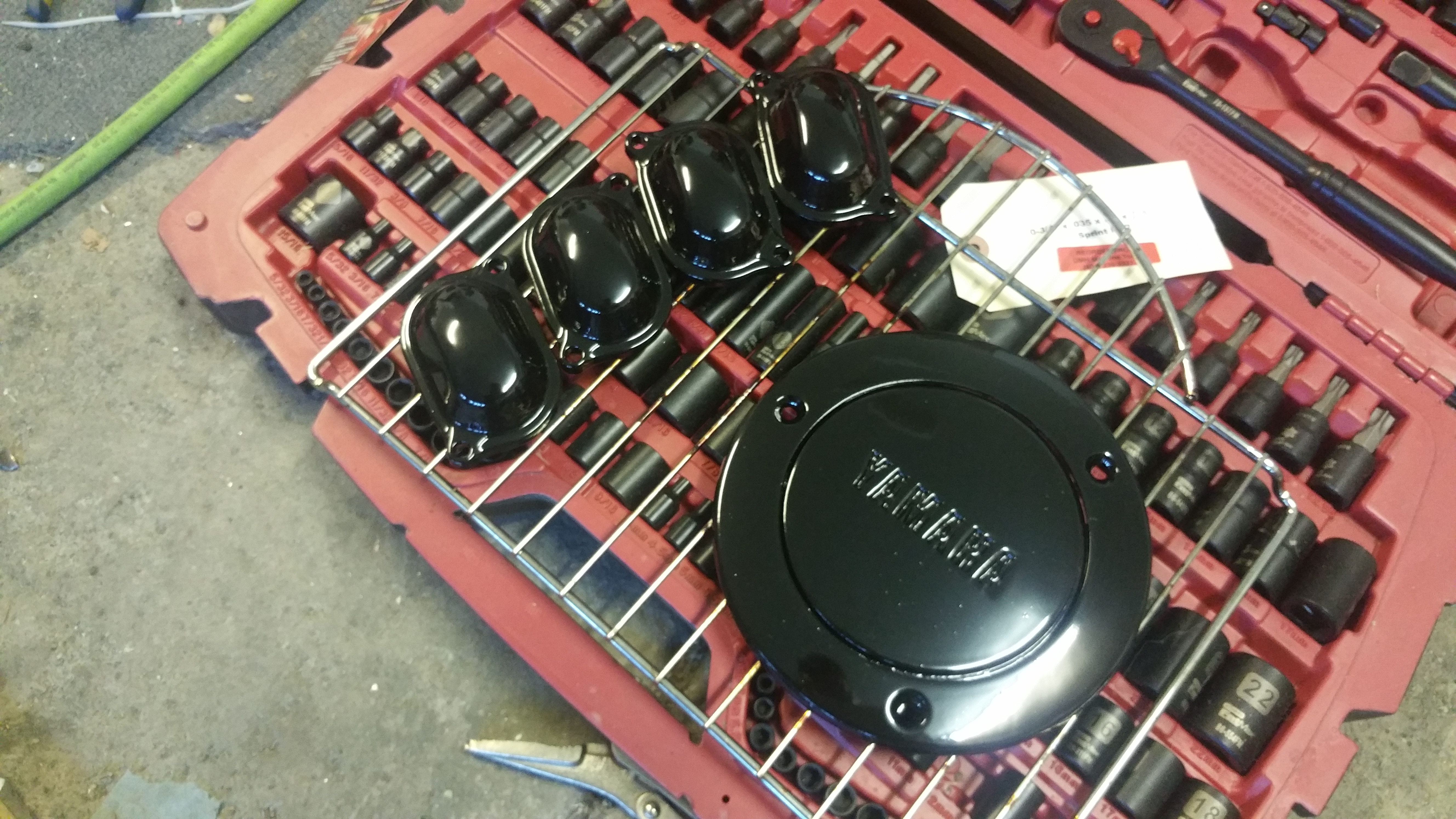

Got the engine covers re painted. Not good enough for me but will do. I need to get this project moving.

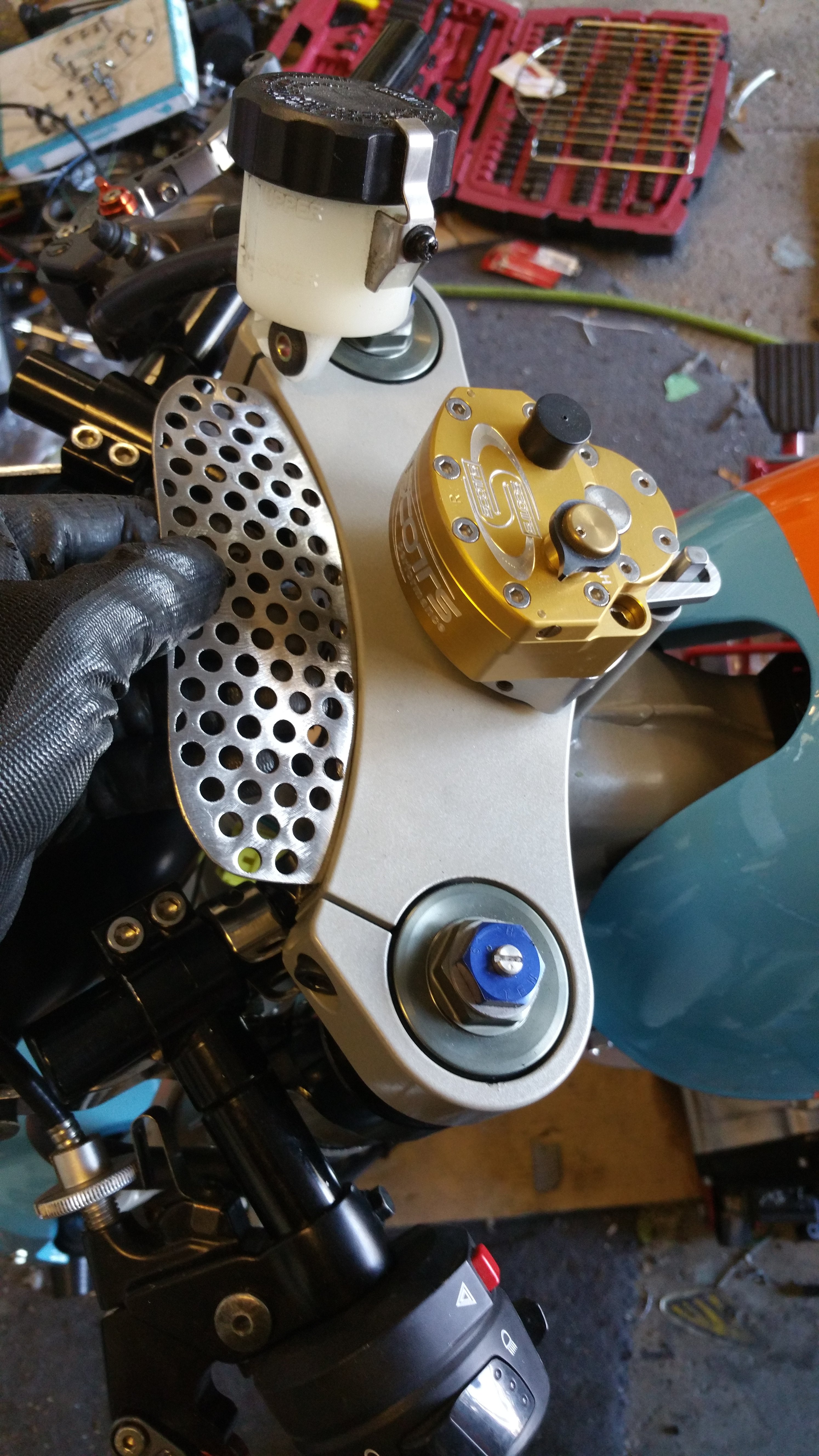

Now I need to start finding places to mount electronics and controls. I tried various locations then decided to make a bracket for my ignition key and starter and voltage meter. Got the newly painted covers installed as well. It's getting close as now I'm focusing on the little things. Also tried some filter ideas and figured out the plan for the headlight mounts.

Controls mounted in the custom mount.

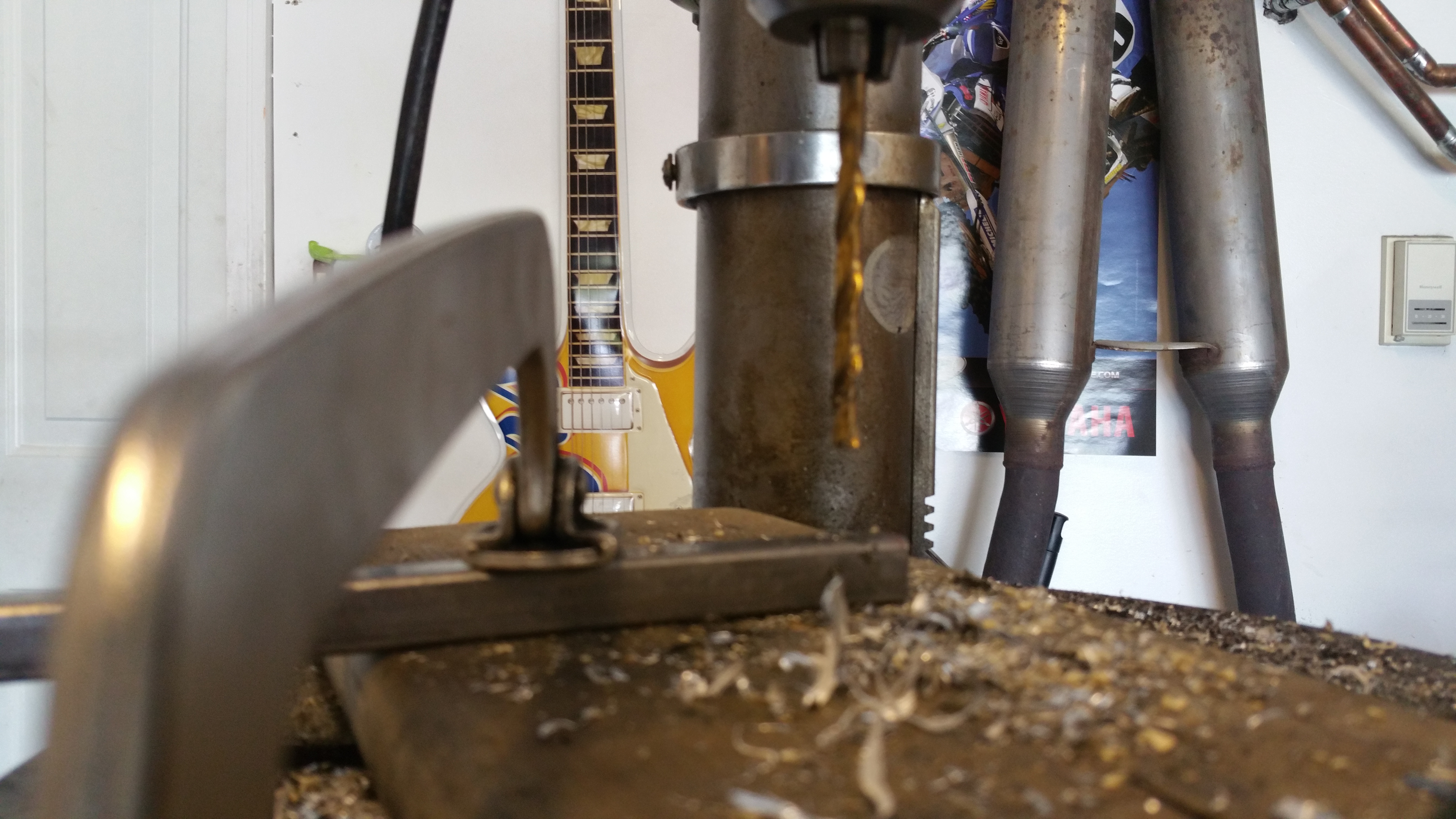

After we did the exhaust comparison neither option sat with me overly well. So I made a custom muffler. Now I have to do the other side, lol.

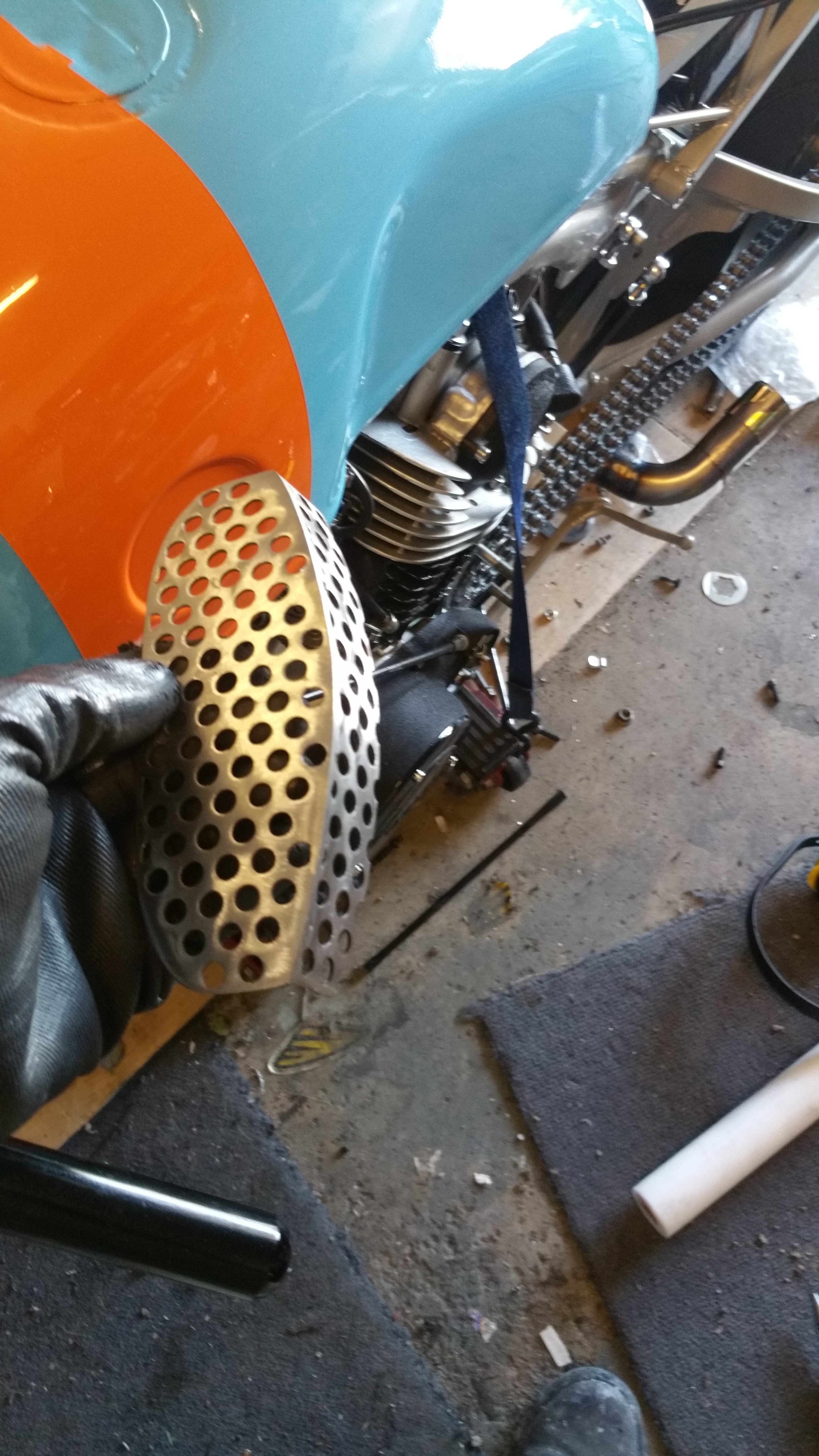

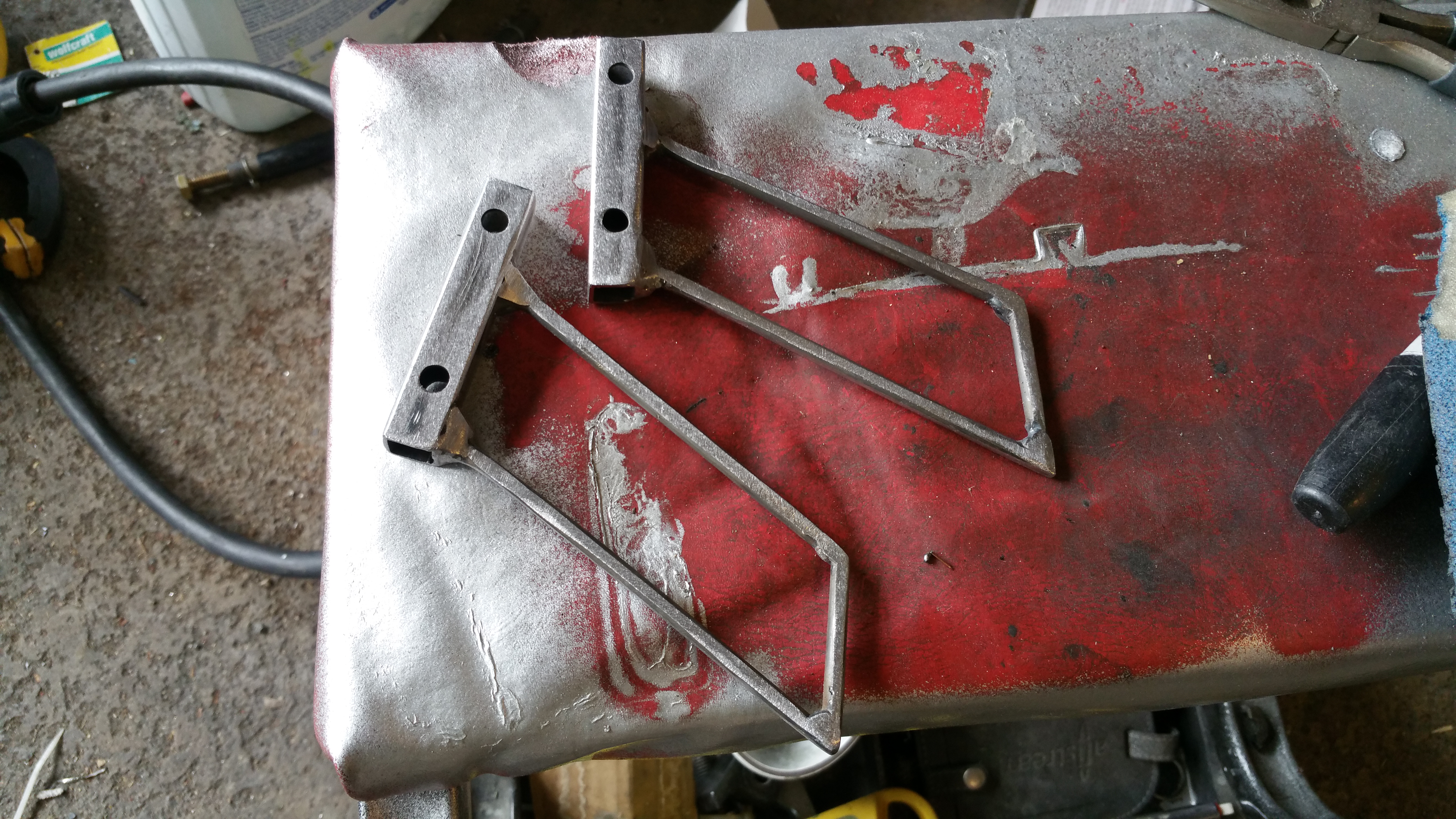

I didn't like the headlight mounts I bought so I made new ones. Still deciding on the final mounting though.

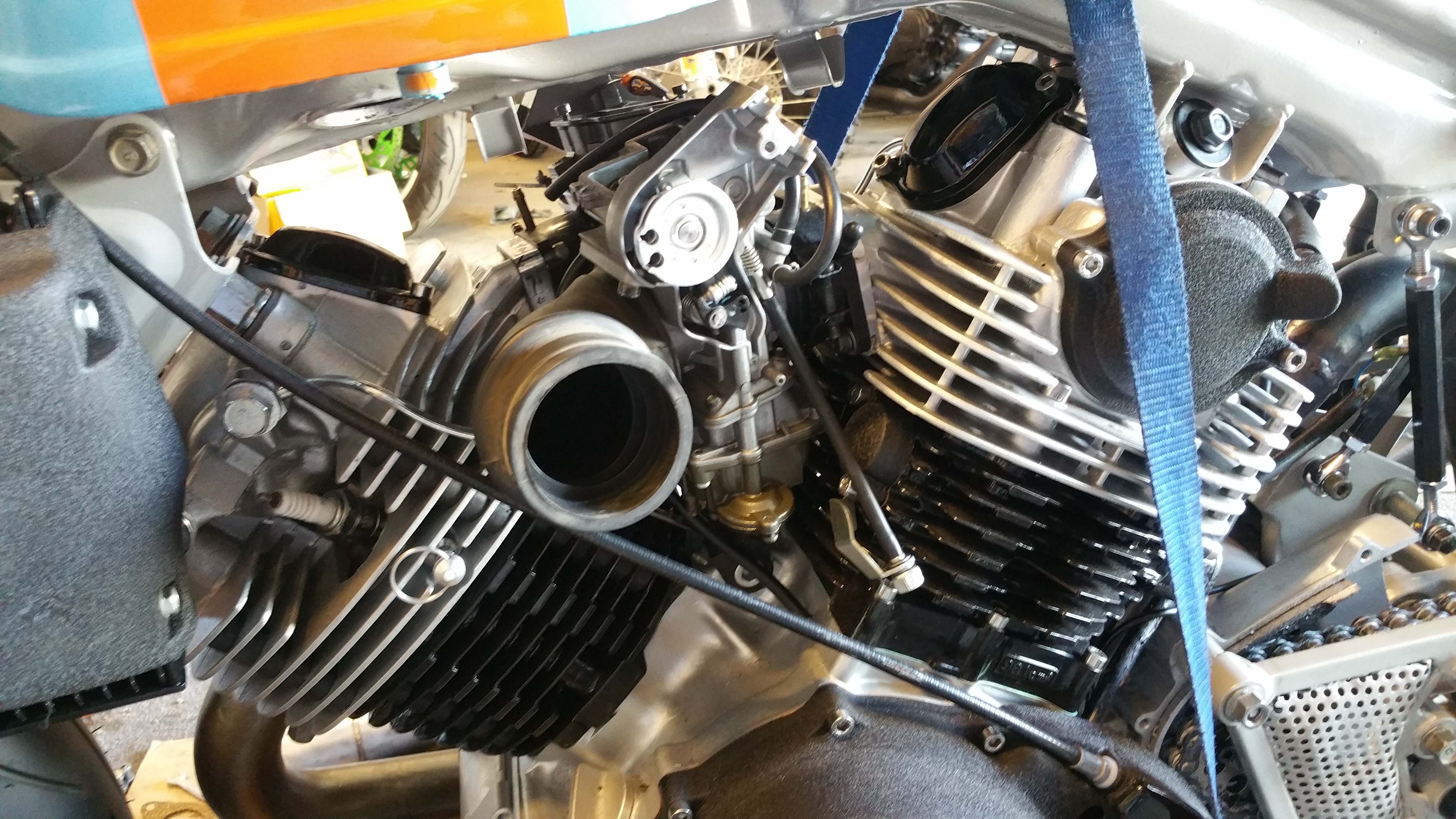

For the carbs I'm in a bit in trouble trying to fit some filters. I'm working through it, got some ideas. I'm thinking about making intakes..

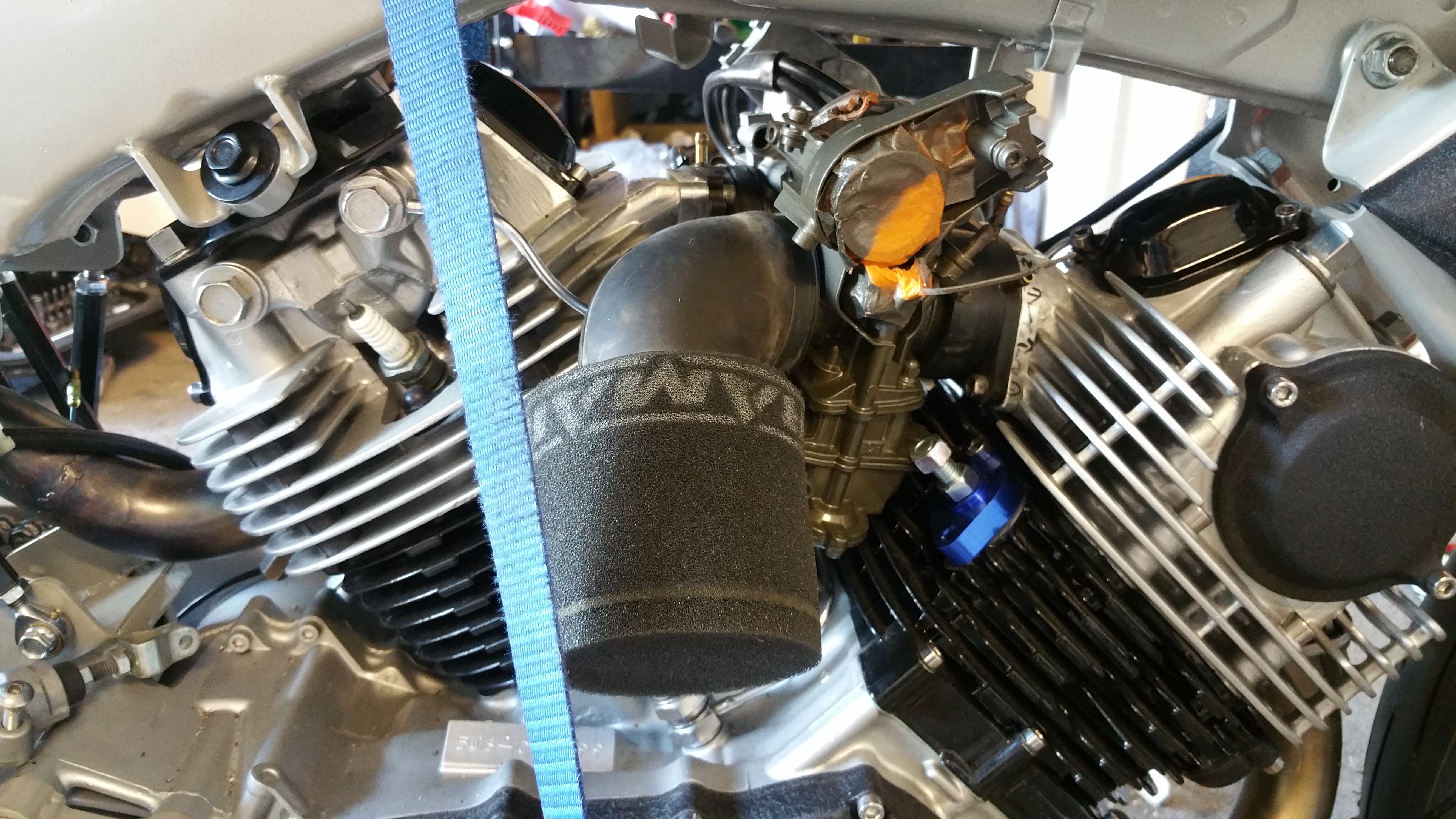

Ok I spent a bunch of time to think about what to do with the intakes and the really crammed space on the clutch side. I was looking at velocity stacks, pods, velocity stacks w/pods, and tube intakes. In the end I decided I will make a ram air setup. Out of metal or carbon fiber. I actually hope carbon fiber, just trying to get some from a buddy. Im not gonna lie, I'm a bit worried about jetting with the ram air but we will see.
Another problem with ram air is its gains will never show on a regular dyno setup, neither will the actual street A/F ratio. Luck for me I bought a wide band for when it hits the streets. :)

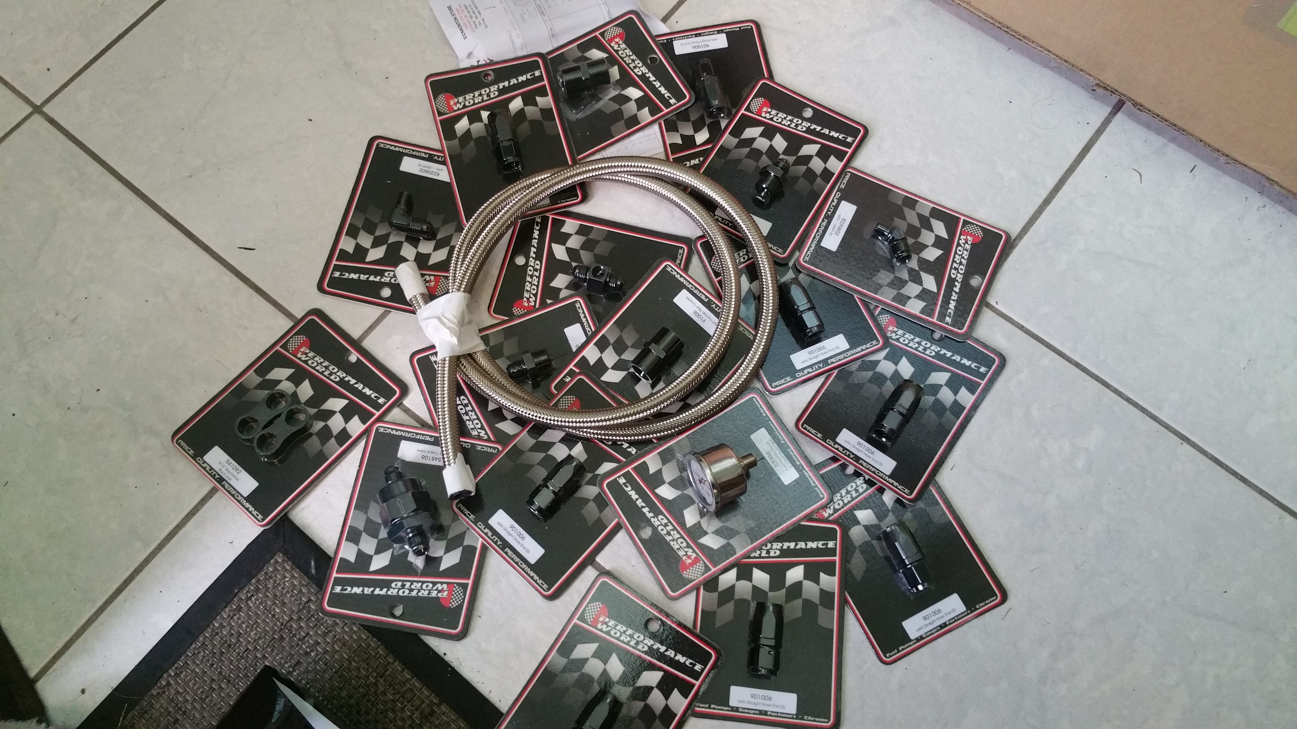

All set for the oil cooler! In line oil pressure and check valve too.
I figure I will wait till she's running before installing in case I have any leaks and I plan on swapping the oil real early so no point having the extra volume.
Man the fittings were PRICEY!
