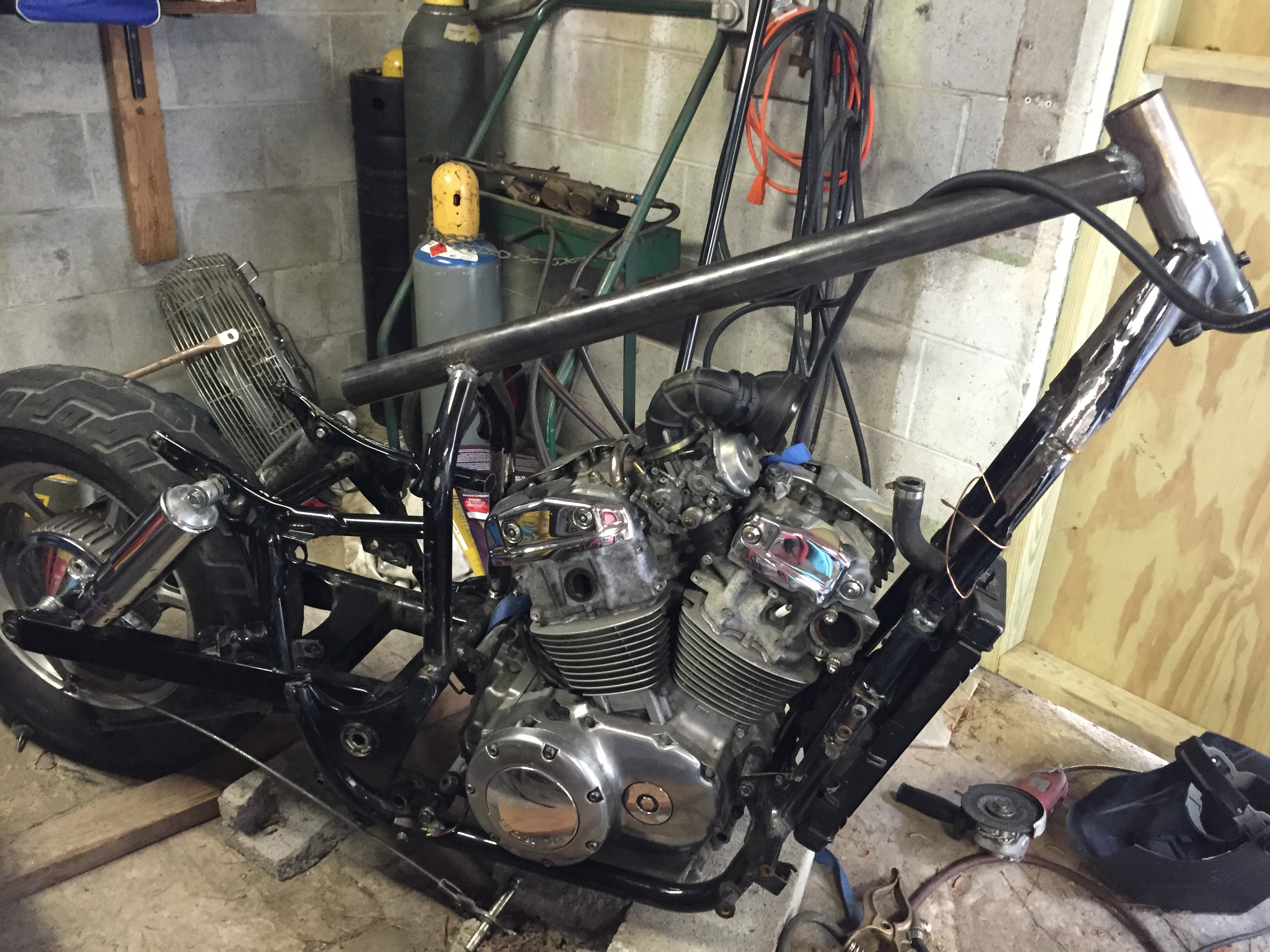

Honda 1100 chop

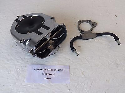

Like I said frame is messy right now but will clean up nicely . The filter box I just bought today used
So I'm building the front end and was wondering what strength difference if any there is between tig welding the front end with 308 filler or if I should use regular steel filler
i wouldn't use stainless steel filler on steel unless it was some kinda art only deal,for an effect ,or welding ss to steel which i have done ...but ,for a very critical structural deal ,i think it would be wise to use correct steel filler
True. So far front legs coming out ok . Moving slow and double checking measurements before proceeding
