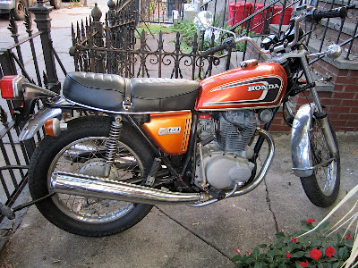

Long time reader of the forums, basically educating myself, preparing to buy my first bike. This is the winter that I intended to build my first project, for better or worse. After prowling craigslist and Ebay, it seems I've found it around the corner from my house. As I was walking to dinner with my girlfriend to celebrate our one year anniversary; we walked past a house with a beautiful '74 360 sitting in the front yard. I should say that if she hadn't forgotten her jacket in the car we probably never would have seen it. Anyway, I called the number on the For Sale sign and I'm meeting him tomorrow afternoon to take an "official look" at the bike and to chat about its history, even though I already jumped his fence and did a quick inspection by streetlamp.
My question is that aside from hearing the engine which may not even run, what should I look for to gauge the viability for a build. If he can't get it to turn over, what can I look at to asses the bike? From our quick conversation on the phone; the mileage is low, and from what I saw the body is in good shape, minimal rust, a few dents etc. I've been reading the forums for a while and admire the knowledge of this community. Look forward to joining the discussion soon. Thanks for your time.

Thanks for the fast input, I am now the proud owner of a '74 CB360. Some surface rust and general wear. The tank is clean, oil was clean, it shifted through the gears after some work, the clutch cable was loose. The guy I bought it from was the second owner and put some money into it a few years back, rode it up until three years ago and its been sitting since then. Now I'm chomping at the bit to get started. See you soon.
Great bike. I picked up a 360T earlier this year in about the same condition. I pretty much went through all the stuff you're going to go through. Let me know if I can help at all.
