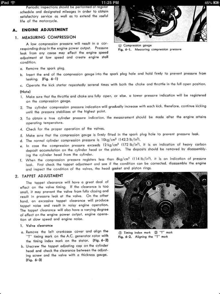

What were the compression numbers. We need plenty of squeeze... Fine to a shop that doesn't know that our cb's need to be 150-170 may be a problem. Don't give up! You can do it. How do you have your pet cock set? We leave ours on reserve. Have you tried running it on reserve? We changed to see through fuel line. It is a really simple solution to make sure your carbs are getting fuel. Have you checked the screen in the bottom of the petcock? We also run dual filters.
Lets make sure we are getting plenty suck and squeeze...then we will address the bang. Do you have the stock carbs? If so pull the mikunis off...and put the keihins back on. if they are Chinese mikunis you will have a problem tuning them for our cb from what I have read.
Get the compression numbers and we will go from there...

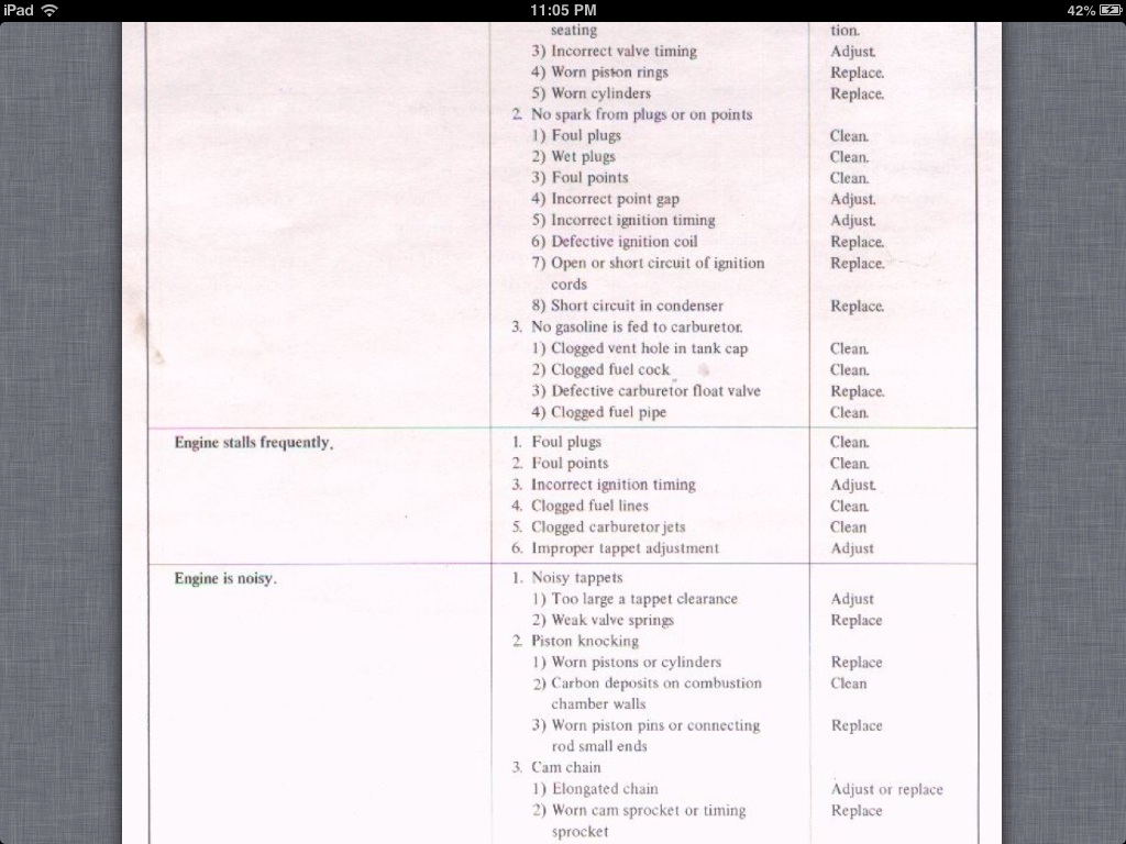

I put this video up for you. This is 100 jets in our Cb200 and she won't even hit the redline. We were 1500 rpms short of our redline!!!! Lucky was so rich it didn't even register on the graph.

Anything below 114psi and she will not run right. Hang in their caveman your gal is just playing hard to get. Follow the procedure above and it will tell you where you are.
http://youtu.be/ntNw5dj6DtA now watch what happens when we are jetted slightly rich with 88 jets. We are running open cl pipes. Watch how fast she gets to 11k. This is after we addressed everything surrounding BANG! Compare the 3rd gear speed difference between the two videos. 15mph and 3000 rpm difference. Now we are running a racing timing chain and racing valve springs so I don't recommend you try this with stock components. When she is jetted right it is sucking and squeezing and bangin' and blowing baby! When we took her home we put the 85 jets in her and ran 82 in 4th gear...with 215 lbs on her back.

Thanks for the info. I won't give up it's keeping me busy so I don't fall back into a depression with the fibromyalgia. Compression on left 112 no oil and 135 with oil. The right is 112 with no oil and 137 with oil. I also did a leak down although it may have not been done right but the leak down was good maybe 10% loss. But again I don't know if I did the leak down right but the compression test is good. I also made sure there was spark on both sides and there is. But interestingly only the exhaust gases on the left cylinder got hot the right side was basically blowing cold air. Each side also put out different pressures at the muffler. There is also some misfiring and I am assuming that's mostly coming from the right side. To me it seems like the left side fires every time but the right is not.
So with those compression numbers I am looking at ring and valve issue, correct? And/or a top end rebuild? What do you think? I will get her running perfectly one day :). I should probably make a build thread out of it at some point.

Way to go caveman! Now you are talking! Now you know what she is doing! She is suffering from depression compression. Working on a bike is not only a metaphysical experience but it can be transcendent even spiritual and sometimes take you to somewhere outside of your pain. We won't let you sink into depression but the best way to stay out of it yourself is to help someone else. And she needs you!
So it is time to start a build string...get the manual... read it and start the build. But to build you need to break her down...and see what is going on in the inside and the way we do that is by examination...hang in there you are in for a journey!
If we can build a bike...anybody can and so can you! So let's see what will get you more squeeze! Hone, rings, valve job...no problem! The measurements will tell you what you need. Go read How to build a functional cafe racer by Sonreir and Suck, Squeeze, Bang, Blow by Kop! Congrats!
