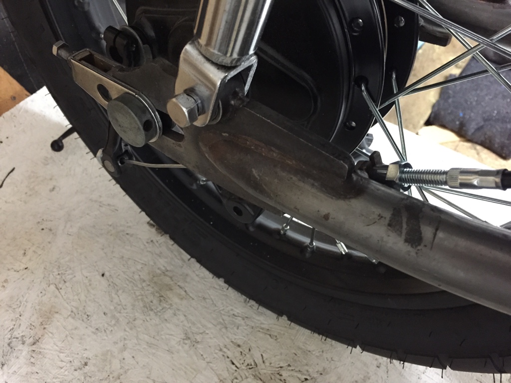

Run a cable. Its a better way to configure a rear drum with rearsets.
Thanks for the quick reply advCo. I like that. So it looks like I'd just have to mount tabs to support the cable housing? And the cable connects directly to the drum brake arm?

I don't have a great picture of how it fits into the drum, but I used the stock actuator, pivot pin and adjuster nut. I counter bored the nut to accept a 1/4" cable ferrule which I soldered onto the end of the cable. I added a tiny set screw into the adjuster nut to prevent the cable from ever coming loose. I used 2 1/8" tabs for the front and rear mounting points, and a small metal piece to keep the cable pinned against the frame.
