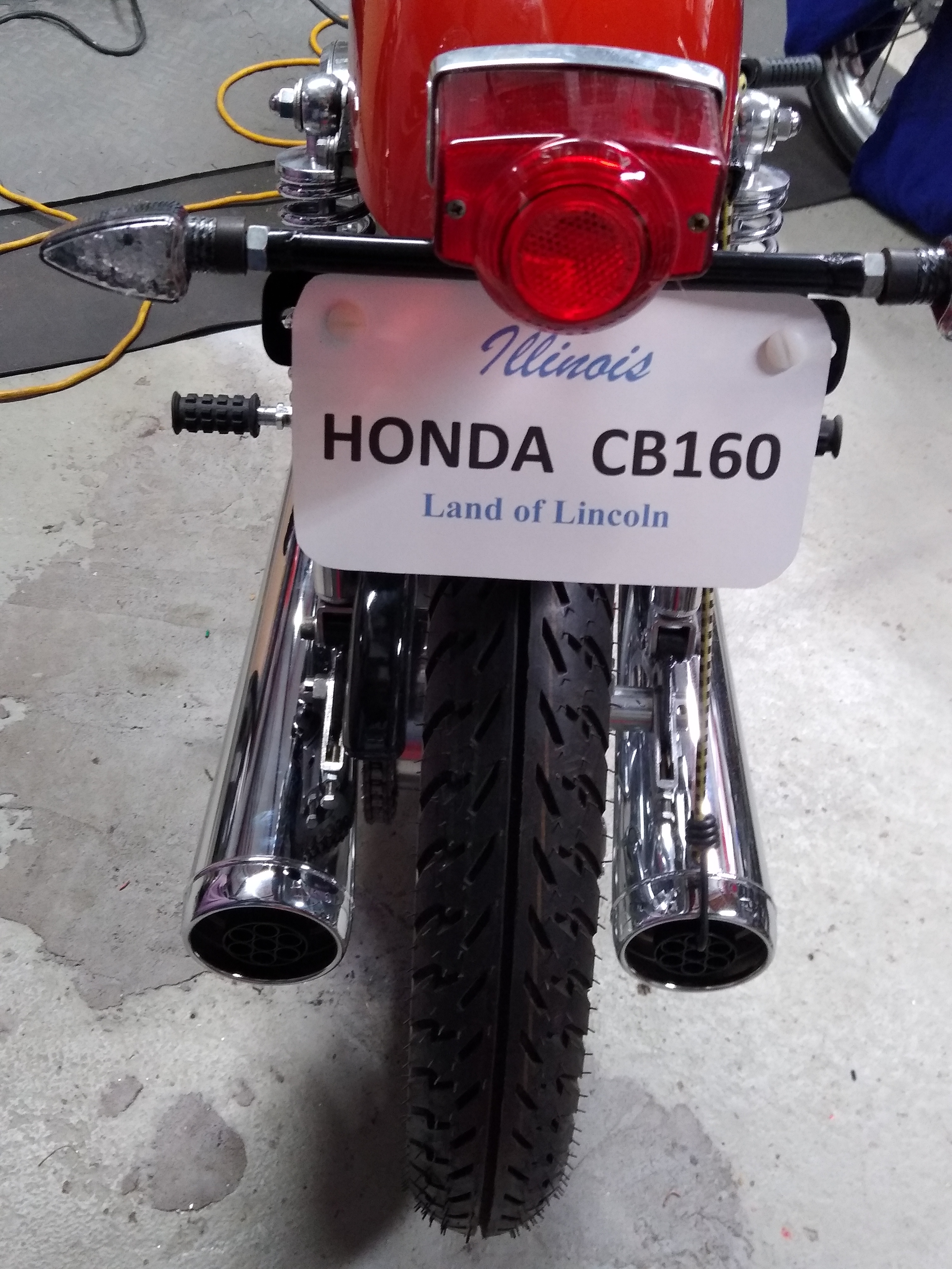

I just fitted a similar set of replica Dunstall mufflers to a CB160. The foot levers had to be carefully sculpted and bent to clear and I needed a very different kickstarter, but the sounds is so mellow. The bike sounds more like a Triumph or BSA twin than the itsy bitsy twin that it really is - without being obnoxiously loud. The picture was early on in the build process making things fit in some sort of logical sequence.
Did you end up using the included mounting bracket or did you have to fabricate one? I used similar mufflers on my CB77 but the included mounting brackets kept vibrating loose.
I used teh flat bracket that came with the pipes, but I suspect that will need to be replaced with a traingular bracket to provide more stiffness.
