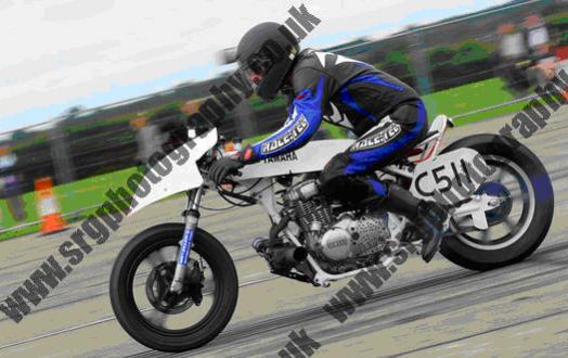

sounds like a nice project. here's a pic of a turbo'd xs400 drag bike. I've tried to track down owner/builder to find out the spec but not turned anything up as yet
