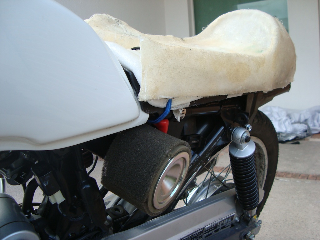

Nice work you've done there. What material did you use for the seat ?
And after you just put the fabric on top of it to dry?
I used a mix between floral foam, sound insulator foam and the original seat pan to give the seat the shape I wanted; then I covered everything with masking tape and waxed it.
To give it the rigidity, I used fiberglass. Theres a pretty good tutorial on how to do it in youtube. Just search for "cafe racer seat" and look for the Dime City Cycles video!

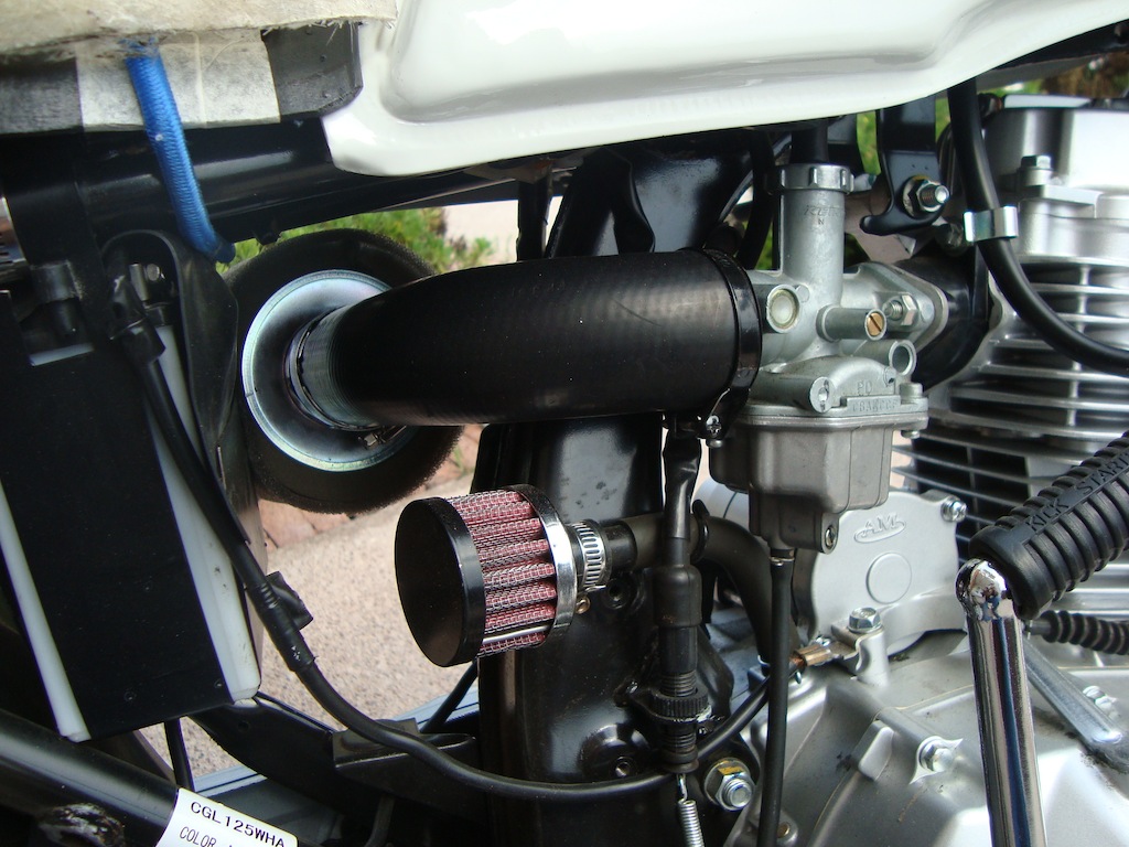

good progress. Im going trough hell since I changed by box filter for a pod as well. I'll be following to see if you solve your problem.
I managed to solve the problem without having to re-jet. I added a radiator hose to the carb and connected a foam filter on the other end. The hose makes almost a U turn and the filter ends up being on the other side of the bike (the chain side). It looks kind of weird but it doesnt look bad and it works excellent. My sparkplug has the nicest color of them all!
Let me go grab the camera so I can post a pic...
"theconjuring"
Here's a look at the filter mod. I'll run her that way for now. At the end of the build, I'll try to make her prettier in that department, but she runs quite well!!!

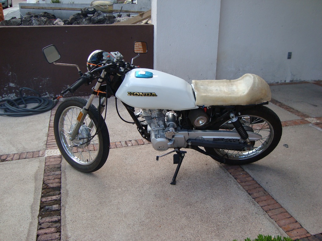

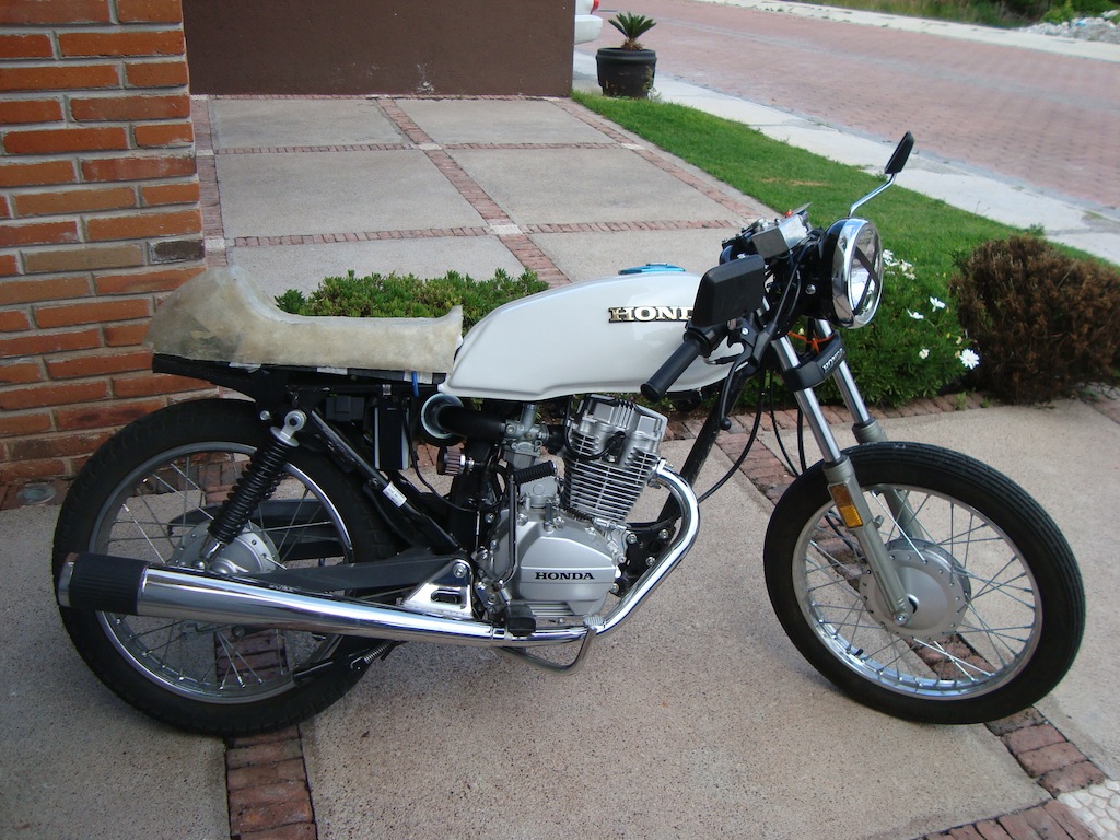

I changed the headlight mounts I made in 15 minutes to something much much better. The headlight is kind of big though, so I will have to modify some stuff for the new mounts to work.
In the pics you can see the almost finished fiberglass seat. I will probably add one more layer just to be sure everything is nice and sturdy. The seat will fit about an inch lower, so it will look much better!

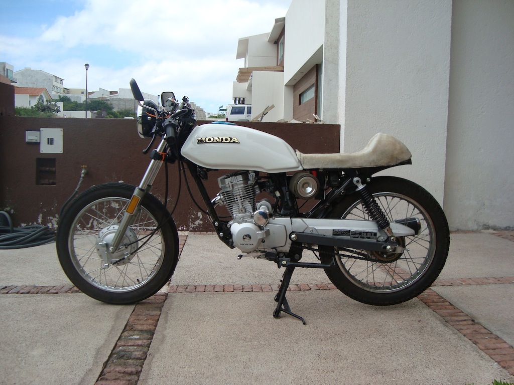

Finally the fiberglass seat is mounted on the bike with the final shape; It turned out great for my first time with fiberglass.
I also adjusted the headlight brackets and started to paint some things, The bike is actually running like a dream! It tops out at around 120 km/h (75 mph) and pops willies (thing I discovered at a traffic light this morning).

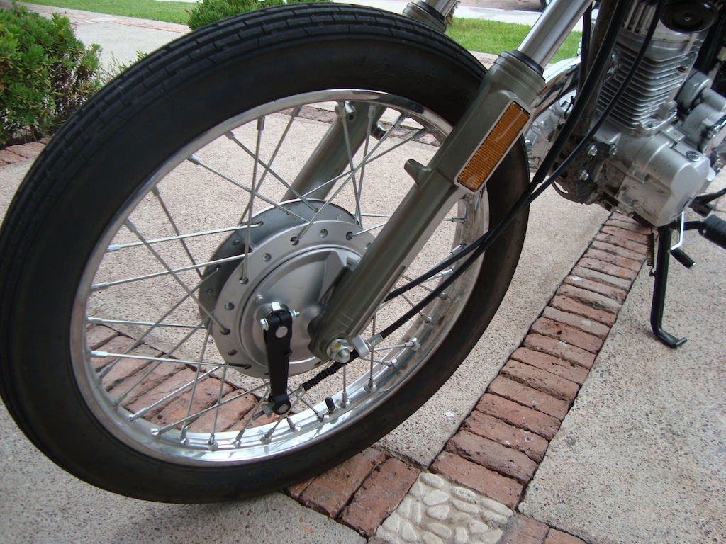

Looking great!
Seriously recommend putting some kind of brace on the forks, even if you just get a second hand mudguard and chop it into a brace shape (keep your original whole). It will make a big difference esp to get the most benefit from your 1" fork drop ;)

Whats exactly the function of a fork brace? It prevents the forks from lateral-twisting right? Wouldn't I need something a little bit "bulkier"? I mean a steal or aluminum one (not a mudguard)?

The brace keeps the fork legs moving in line and working as a single hydraulic unit, both up and down at the same time and helps prevent flexing side to side. If you go to a scrapyard and get an old metal guard, the stronger the better, that will fit inbetween the forks, cut it down, job done :)
