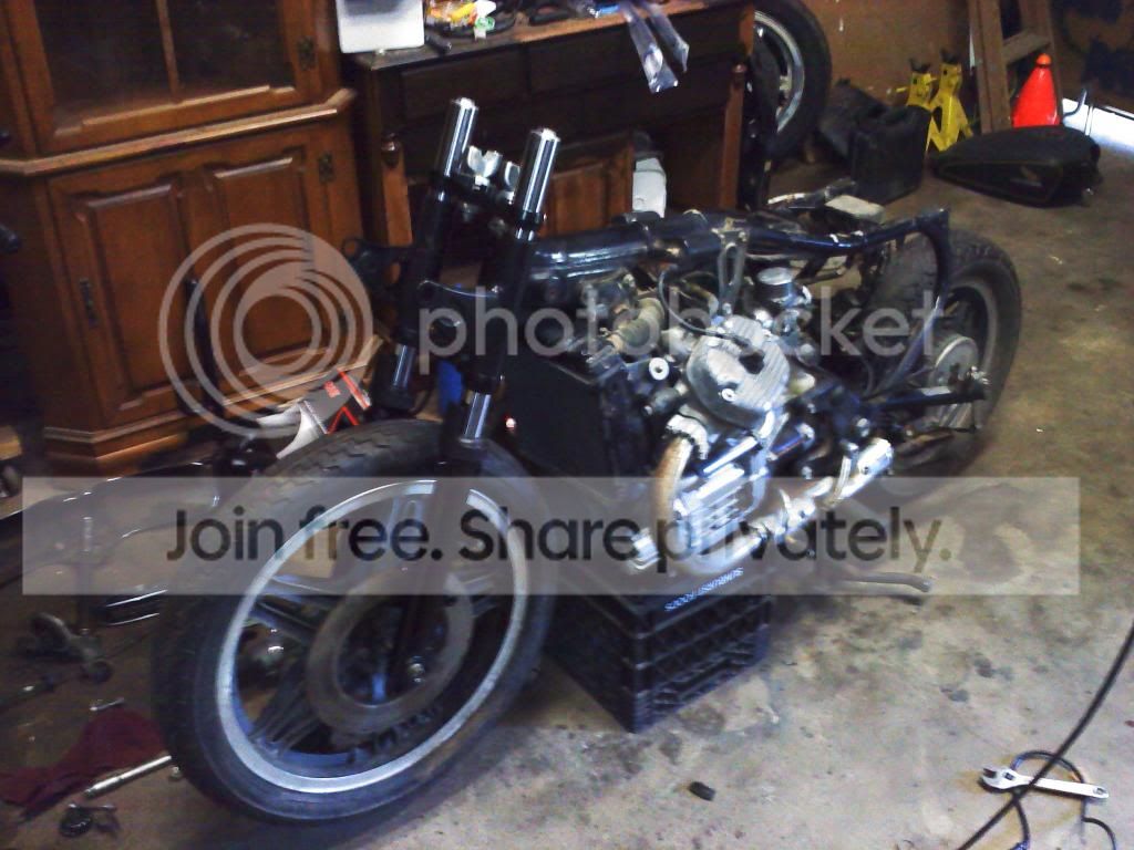

Starting to tear it down

front end off to install tapered bearing kit, along with bonnie front end and rear shock towers cut off

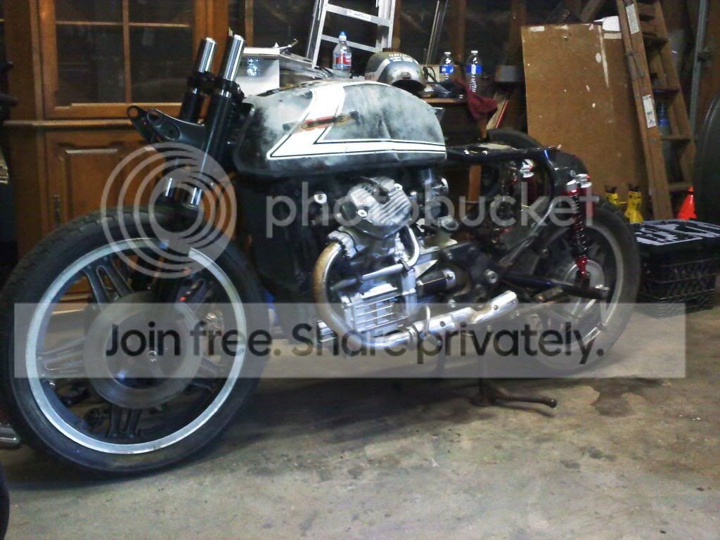

front end installed and looking beefy

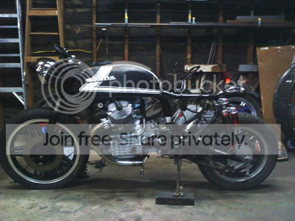

the finished product as it sat today, as you can see, the kick stand isn't touching the ground and the center stand is doing all the work, this will need to be fixed eventually haha
I like the stance although the front end has to come up a bit in order for the forks to not bottom out on the trees. Next tasks are rear frame tube, seat pan and tail section. There is a tank in the back ground that I wanted to use for the tail, but it is too narrow and more than likely will not fit the frame hoop. Also wiring and or re-wiring. THis bike is only going to have a tail light, headlight, and ignition system, so it will be pretty bare of wiring. battery will be hidden in the seat hump along with other electricals under the seat. rear sets are another item on the to do list, but not aftermarket ones, I'll make my own... Hope you enjoyed the work thus far. Trying to make this one different than the other cx's but also not trying to dump a bunch of money into a $300 bike. There is no way in hell I'd spend $900 on Ohlins shocks or something like that for this thing, Im not building it for anyone but myself, so I'm keeping it cheap, you've all heard the one about lipstick on a pig, well...this is a pig, but it's my pig ;D. Credit to my uncle for the welding, I don't have much experience with MIG, but he welded the shock mounts on for me. I will be doing some welding on this thing eventually since there's only 1 way to learn, haha.
Looks nice but there's no way that your gonna keep the front end that low. it looks great though , why did you opt to change the stock forks out. I got an awesome stance on my CX with the stock front end just lowered a bit . One thing about the stock forks I was lookin in to doing was getting a front end with the dual disks, off a european model CX and then I could have duals up front. Nice job though , looking good! I may have a tank of an xs400 already cut down if you are intersted , Not sure if I am gonna get one of the new Roc City fiberglass pans made for flared frames, or do it myself with this spare tank I cut . Will be watching this one , if you have any CX questions hit me up I learned a bit with mine...
Swingarm droop looks to be a little too steep and may cause problems with the drive train. Better forks a good idea. Better brakes might work well too.

Also concerning the angle of the swing arm, I'm not too worried about it, if you notice-99% of cx cafes slope downward at the back, think of what it will look like when a 180lb person is sitting on it, suspension will compress and it will be lower. I'm also going to be mounting an 18" comstar in back. I've sourced a 18" reverse comstar form out of the country, but I'm toying with the idea of digging up a regular 18" comstar at the local bike graveyard and running two different wheels.... probably look weird, but you don't know until you try it.
The problem in this case is the fact you're running a drive shaft output and not a chain drive. It's not that much of an issue with chain drive but at that angle, even when it compresses a bit the uni join up by the engine will be under a lot of stresses. It wont help the transfer of power to the rear wheel either as it isn't designed to be running off centre all the time. What you'll notice at stock height is when the swingarm is at its lowest point it is angled down a bit, but as it compresses, almost immediately it straightens up. It's only when bumps and compression past the point of human weight and a few irregularities in the road are encountered that the uni joint bends again this time allowing the swingarm to point up, which very quickly then returns back to its "normal" state in a near straight axis to the output shaft. My $0.02

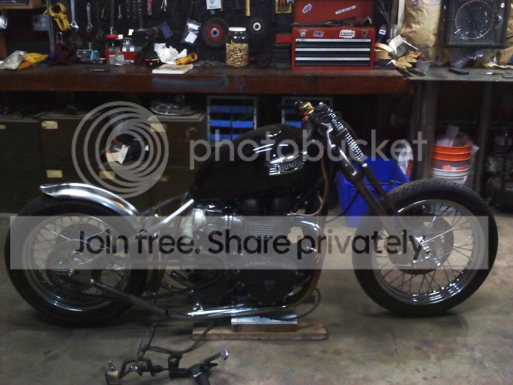

Some eyecandy, My uncle's 2005 Triumph Bonneville that has approx 3,700miles on it. Hand made hard tail and DNA springer up front, he is a handy guy to have around haha.
