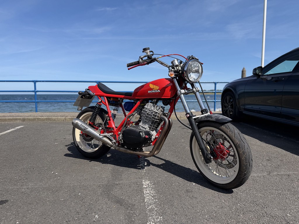

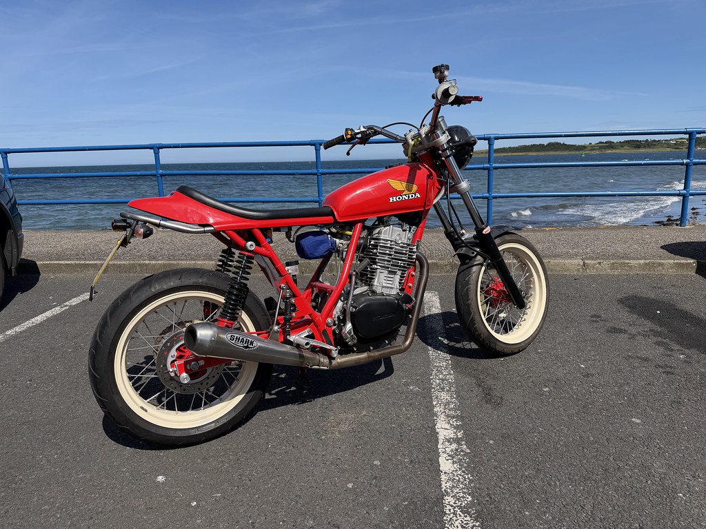

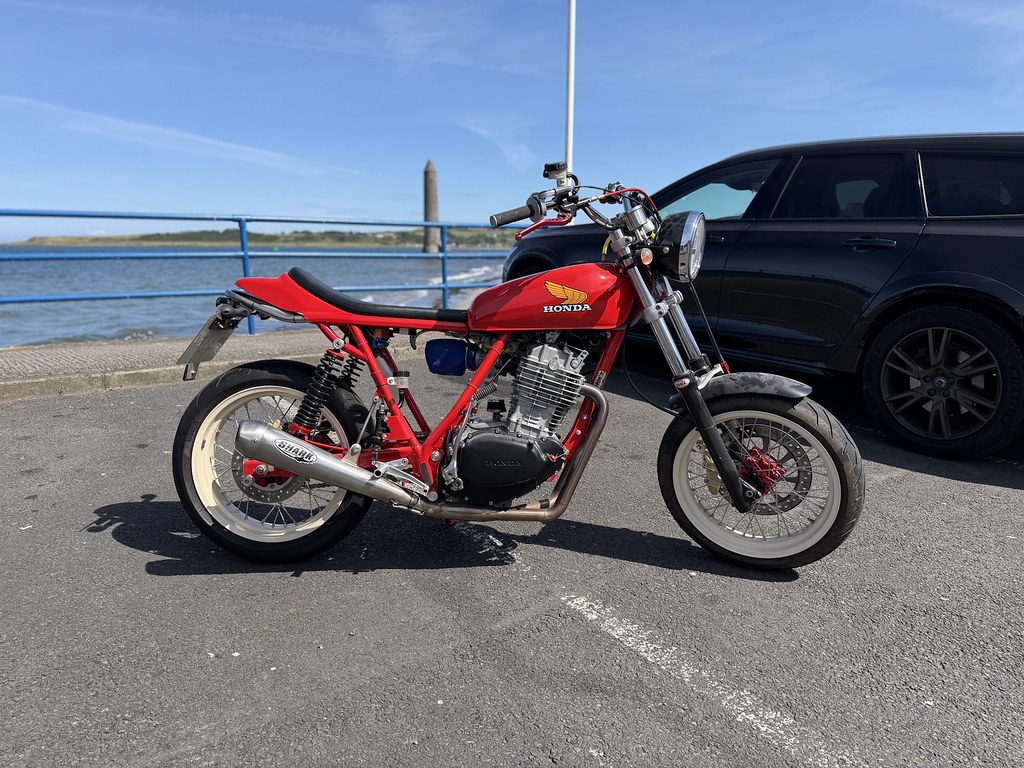

Just picked up this lovely tracker/street tracker build based off an '82 FT500 Ascot after around a 12hr drive and a ferry to Northern Ireland and back!
This is a bike I've known of for a while, as the owner has machined some engine pieces for my own 500 engine being used in my cafe racer project (project is a bit of a stretch considering I've made no progress in the last 5 years or so!). I was offered this bike last year but the timing wasn't great having just bought another bike. I randomly reached out to the owner a few months ago and found he'd never ended up selling it, and now... it's mine.
I am still learning what's been done to the bike, as there's a lot! But here's what I know of it so far:
Engine:
FT500 single, converted to kickstart using XL/XR parts. Manual decompression lever added. Bored to 540cc. Head ported and polished. 250 flywheel. Balance shafts removed. 36mm Mikuni carb and allegedly dyno tuned at 47bhp.
Chassis:
Front end from a BMW F650GS with an upgraded ducati Brembo. Genuine Woods flat track seat, CG125 (I think) tank, matching rear brembo brake, rear seat loop hand bent out of stainless steel, lithium battery, trimmed loom etc.
Couple of immediate jobs to do - smaller headlight/indicators, preferably in a number board style, rear end tidy up (smaller plate, reflector etc) and it needs the headstock bearings tightening/replacing. It also needs the crankcase breather filter removing and a proper pipe fitting. The crankcase pressure on these engines is too much for those filters and they end up spraying mists of oil out of them all over your boots.
Eventually, I'll probably shorten the fork legs and fit some 19" wheels. It handles lovely as it is, but if I ever want to try it on the dirt... 17's just aren't the go.
