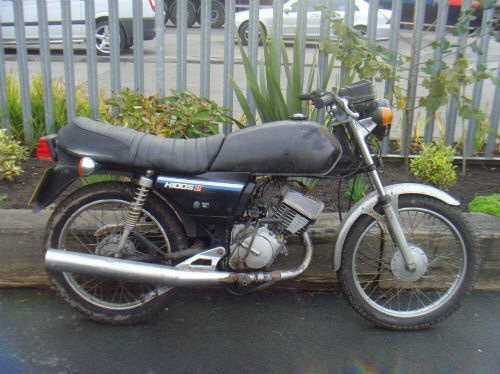

The day I got it. It was a horrible day so I hid it inside amongst the boxes.

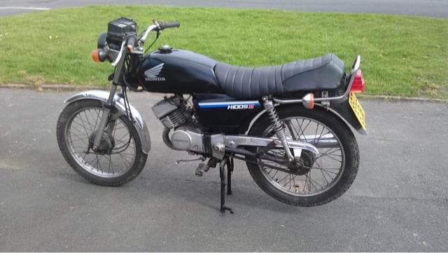

Here's mine before and after
All the best
